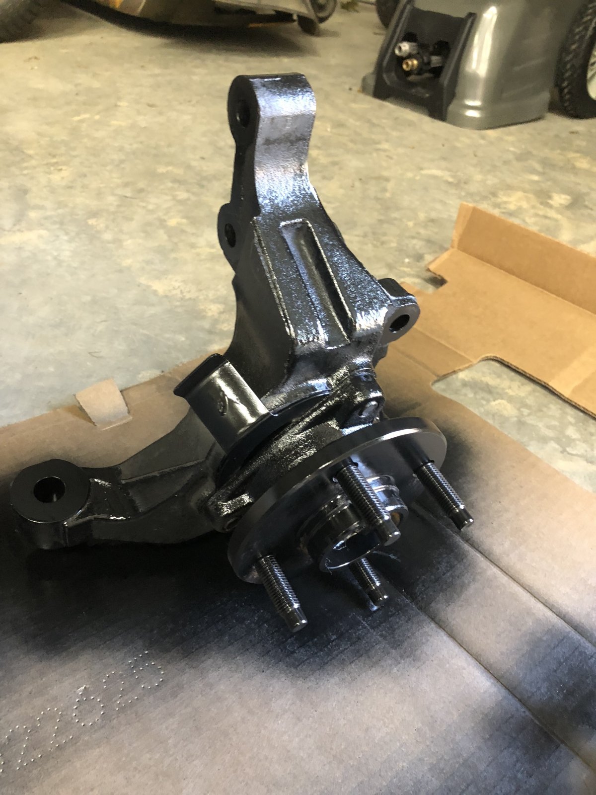

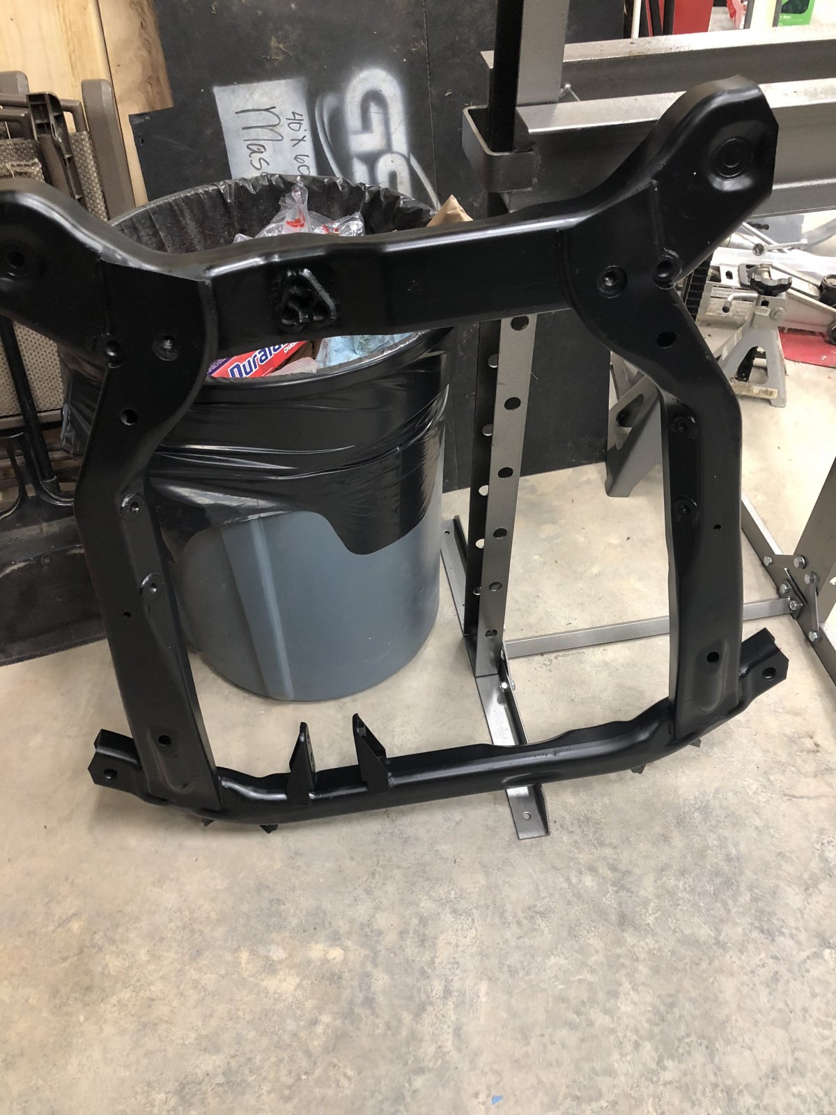

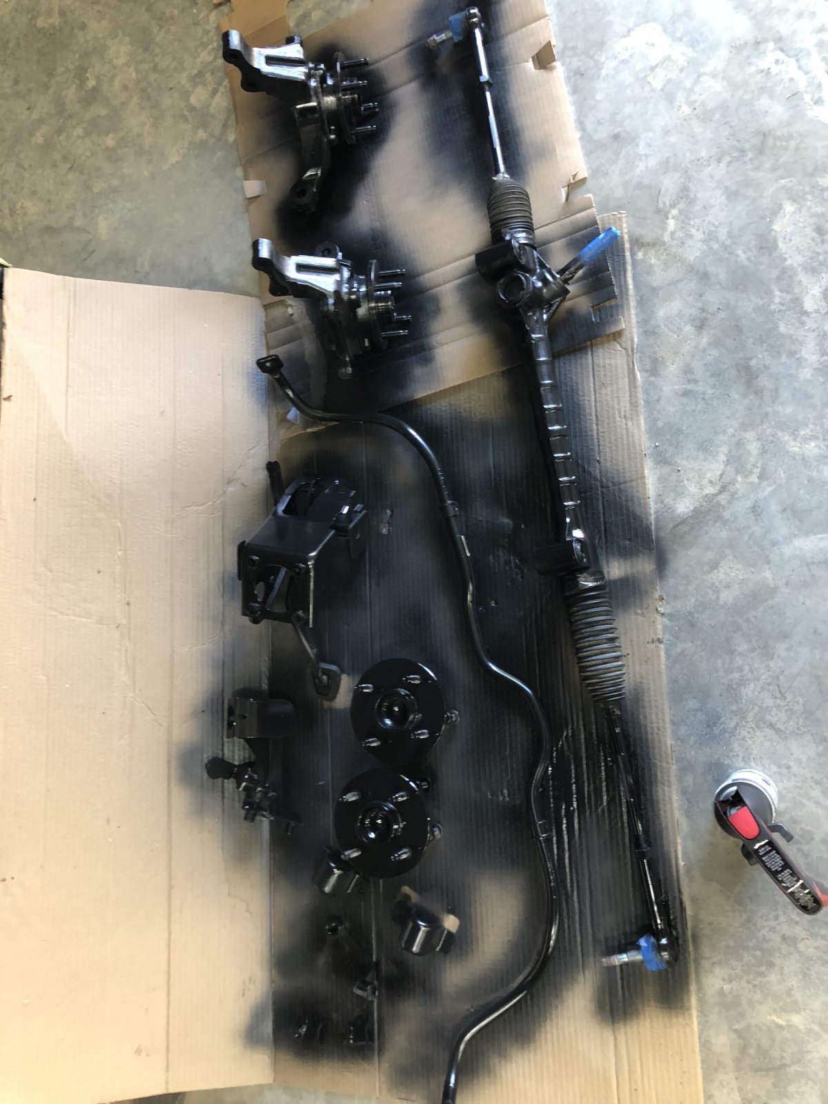

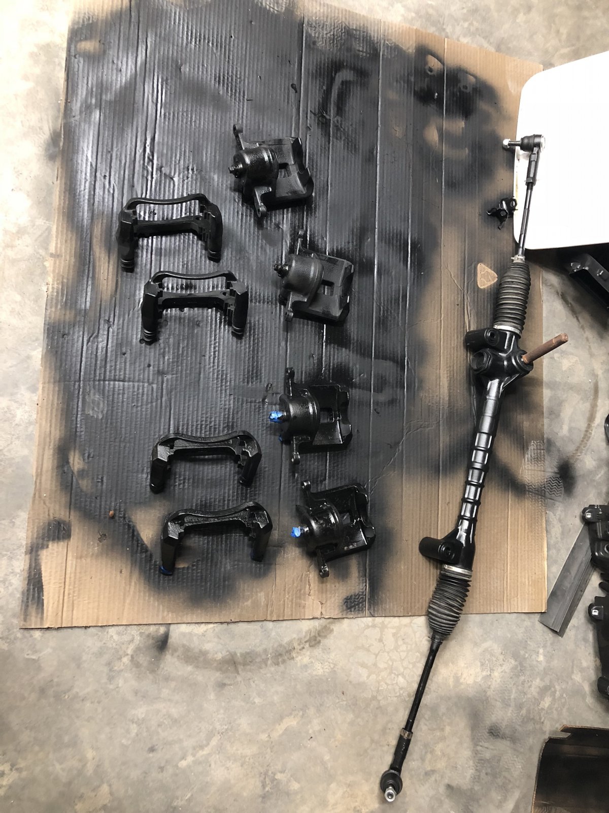

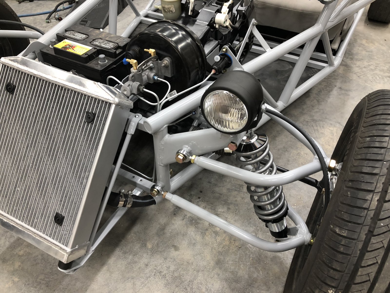

Finished cleaning/prepping/painting donor parts

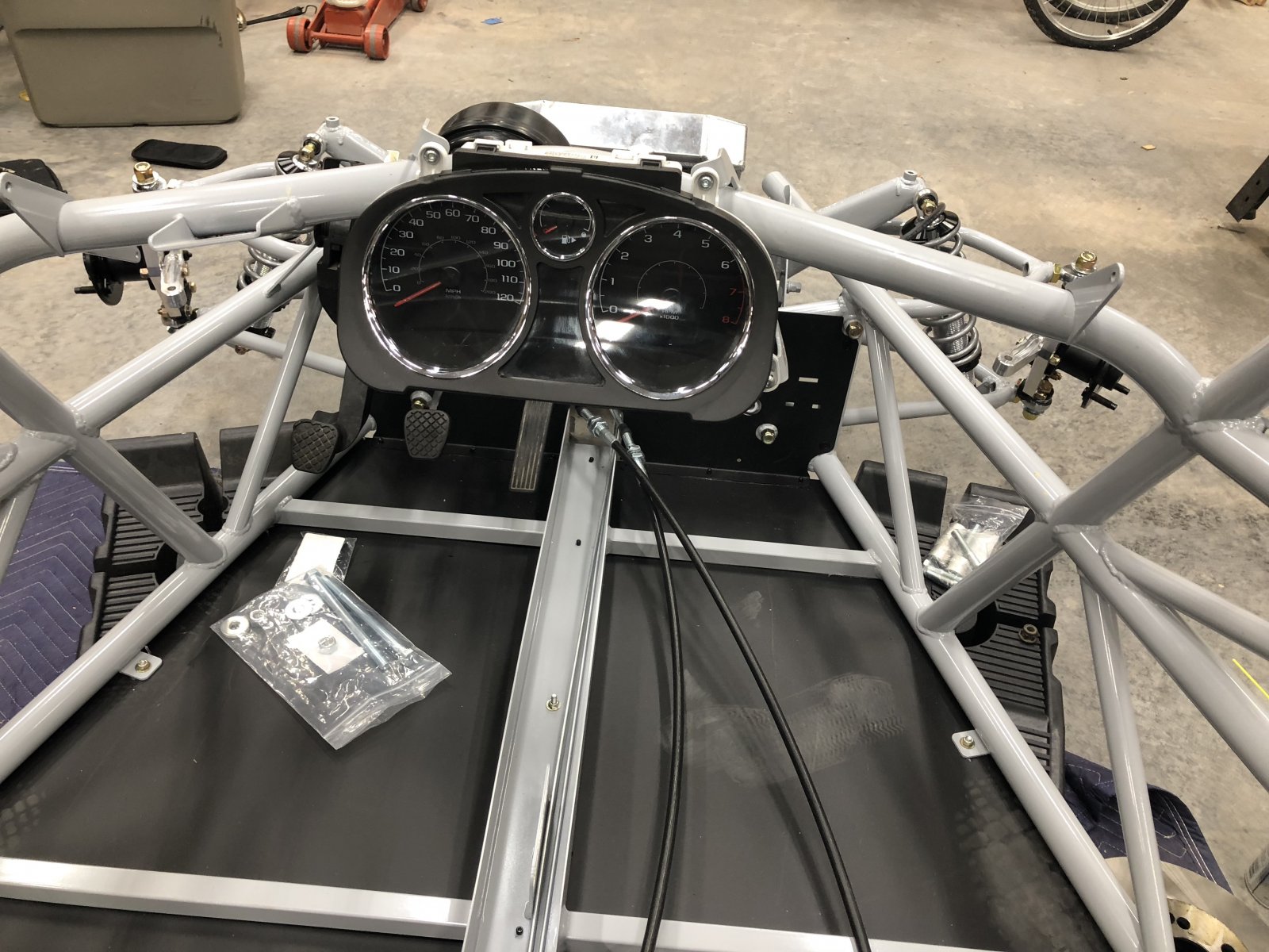

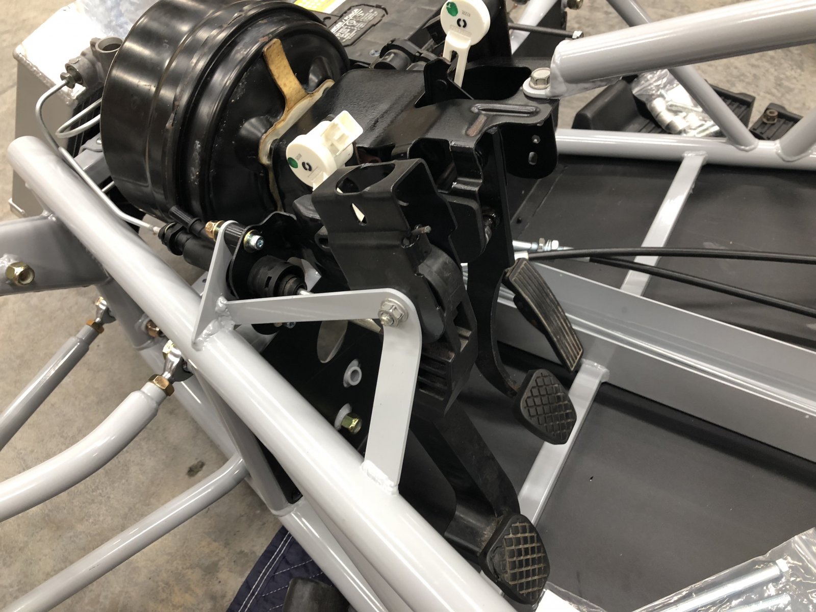

Installed pedal box

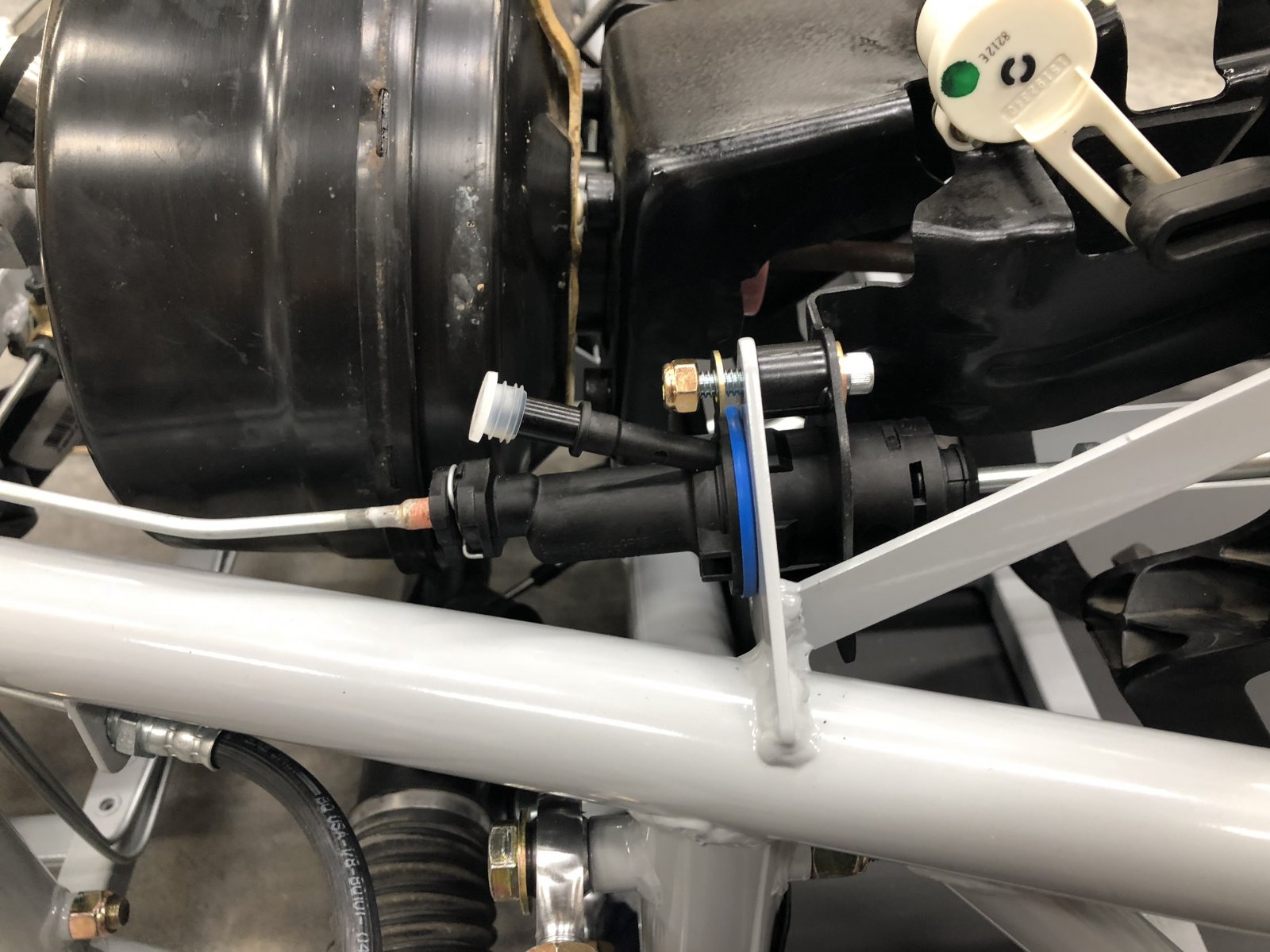

Installed brake booster, master cylinder, and reservoir
Installed clutch master cylinder

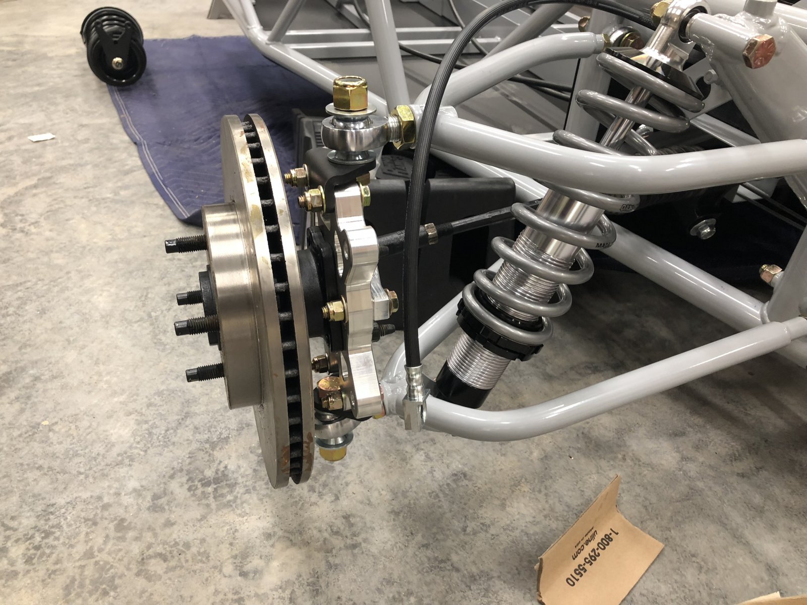

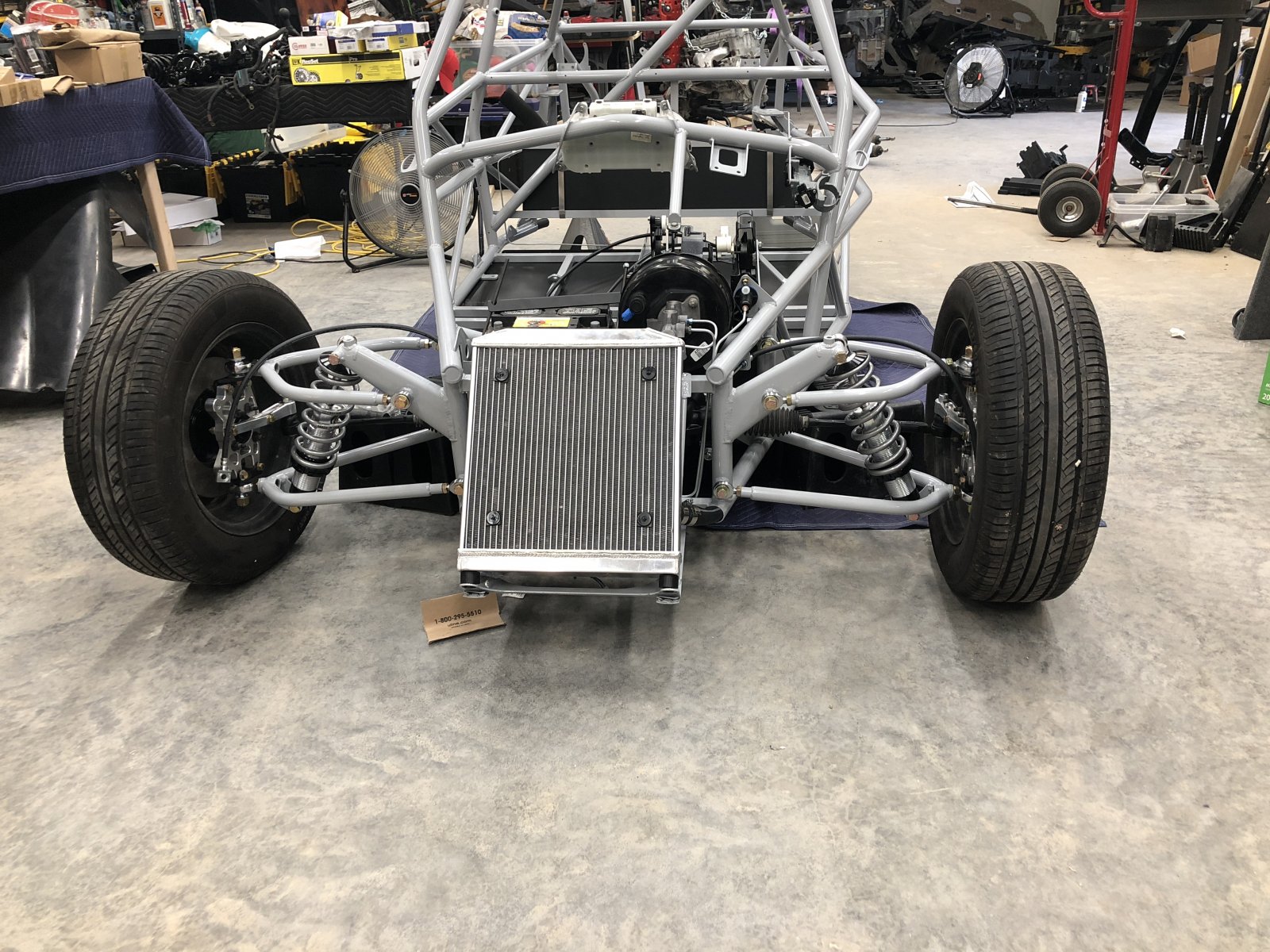

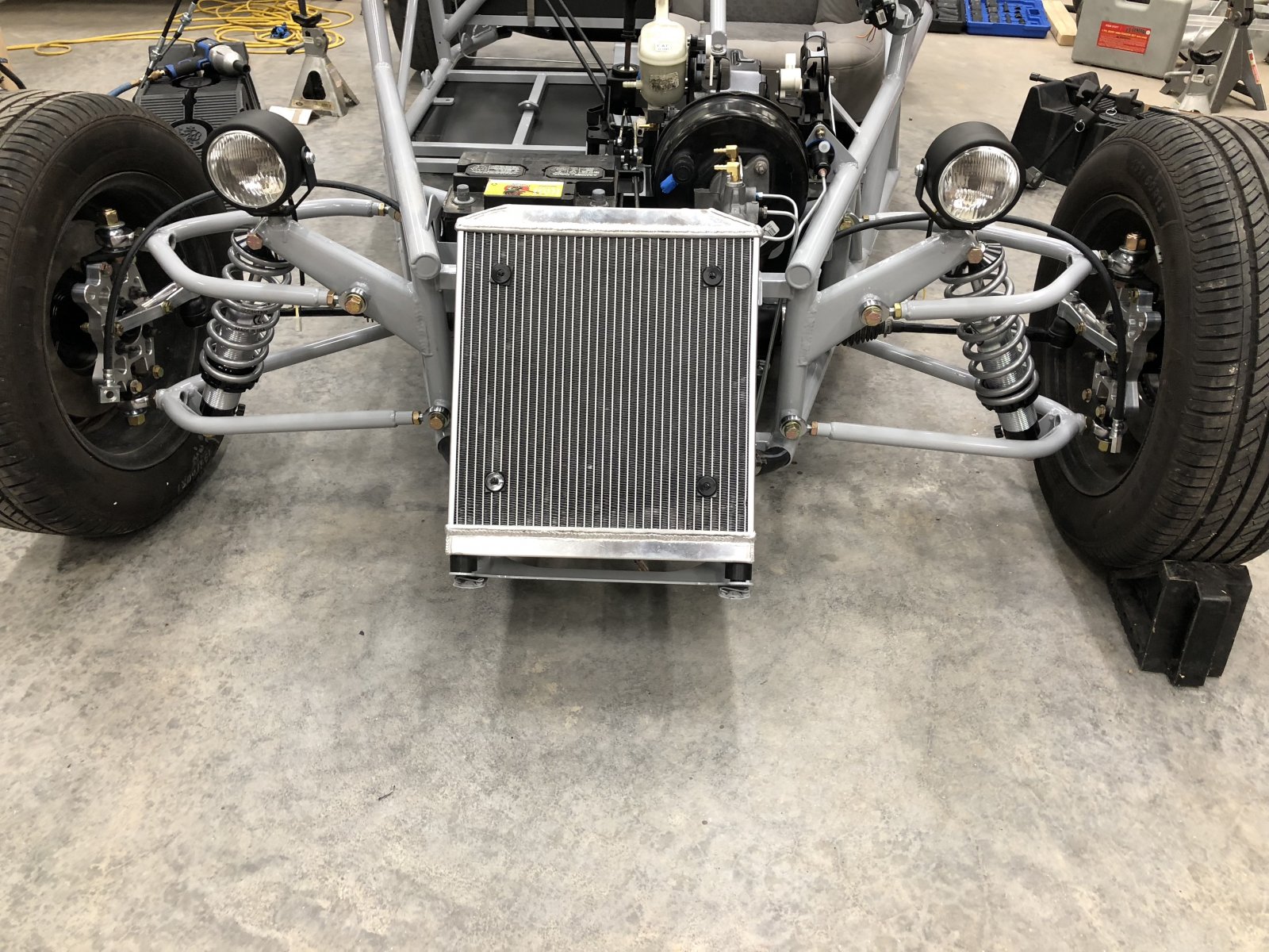

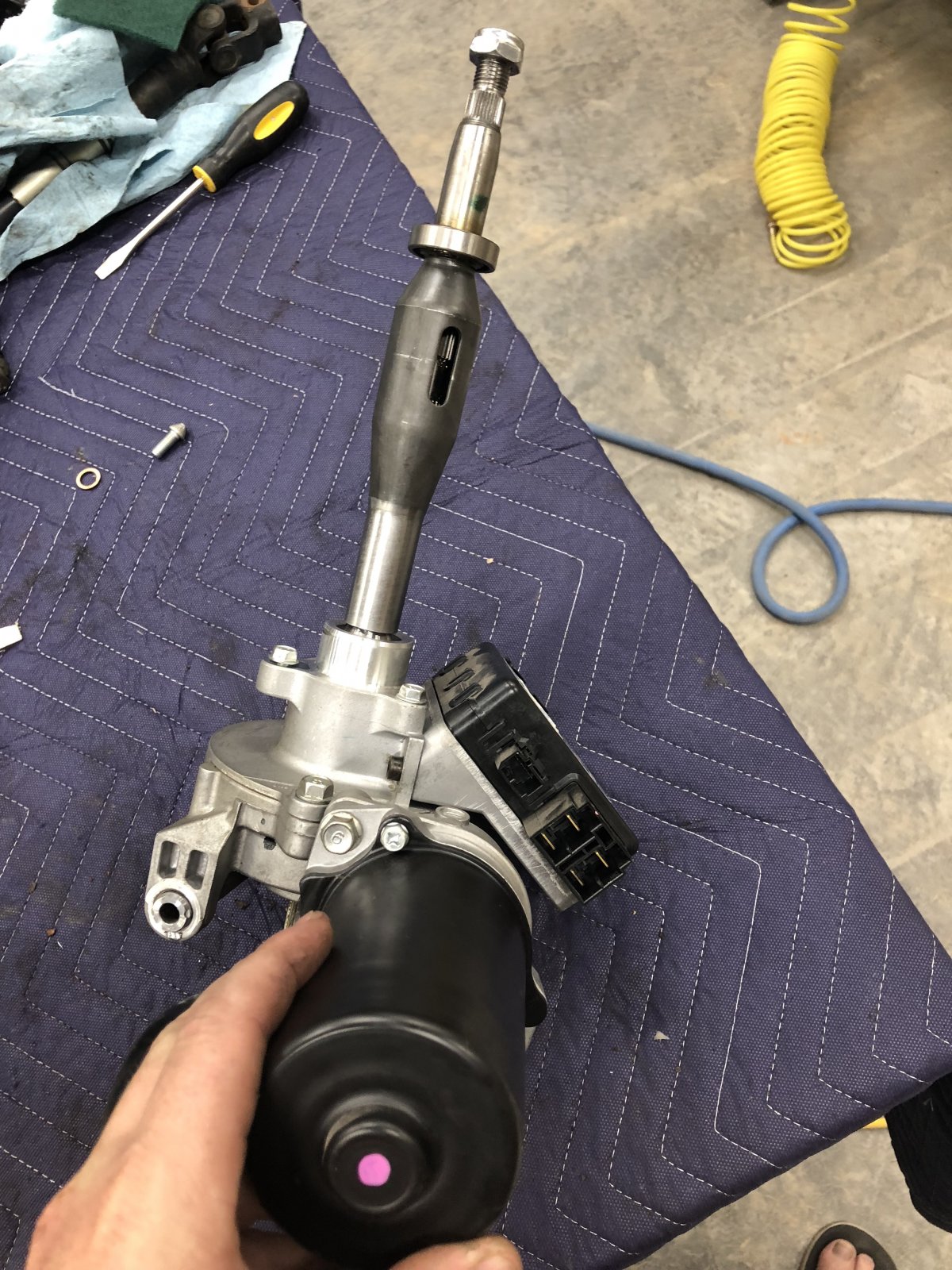

Installed steering rack, remaining front end components, and temp installed tires

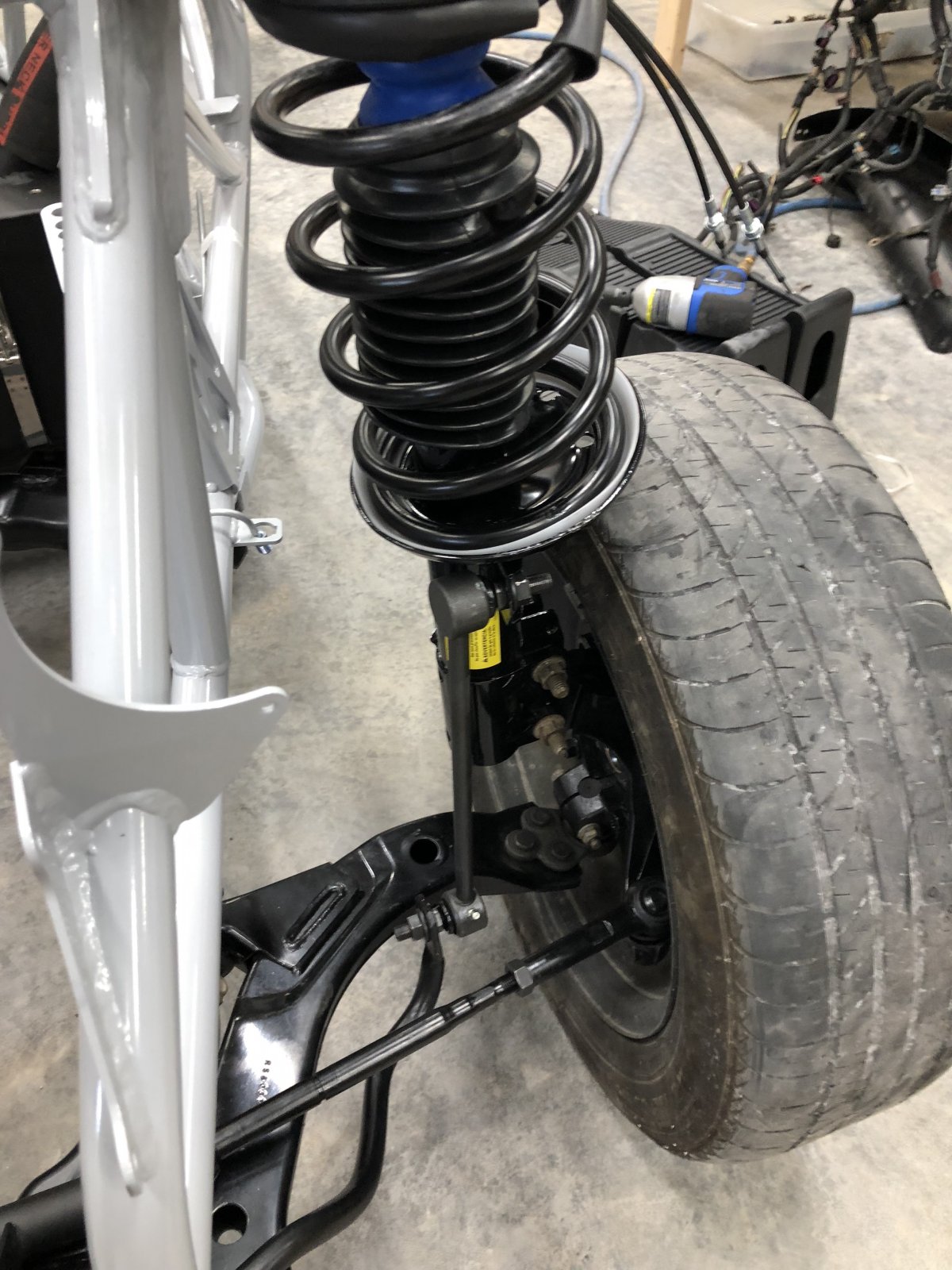

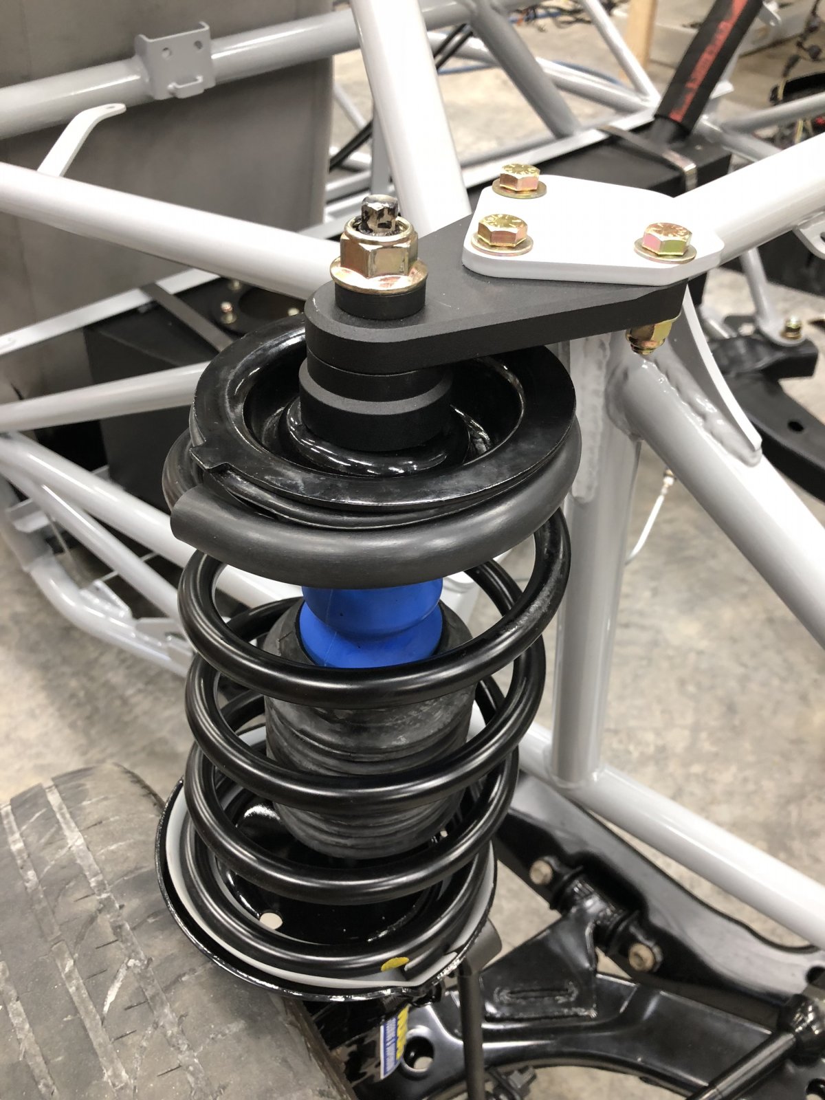

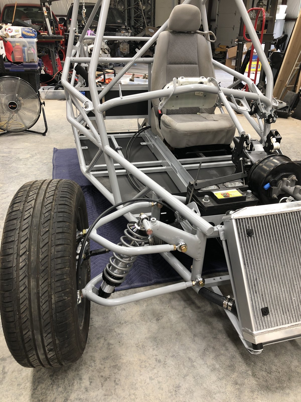

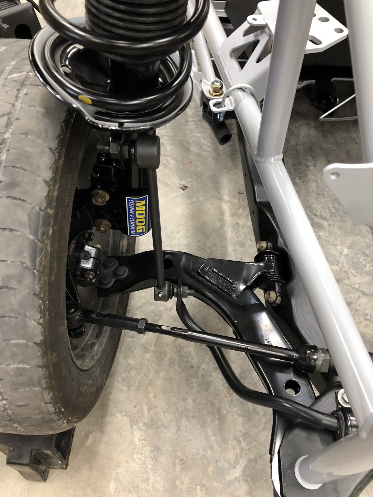

Assembled/Installed rear suspension (I know I'll have to take some of it out to install the engine but I had to see it sitting on all 4 wheels...)
Mostly completed shifter install (still have one link to finish)

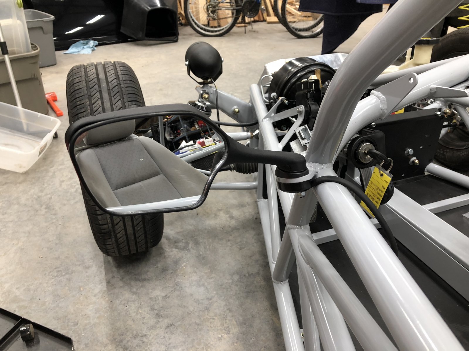

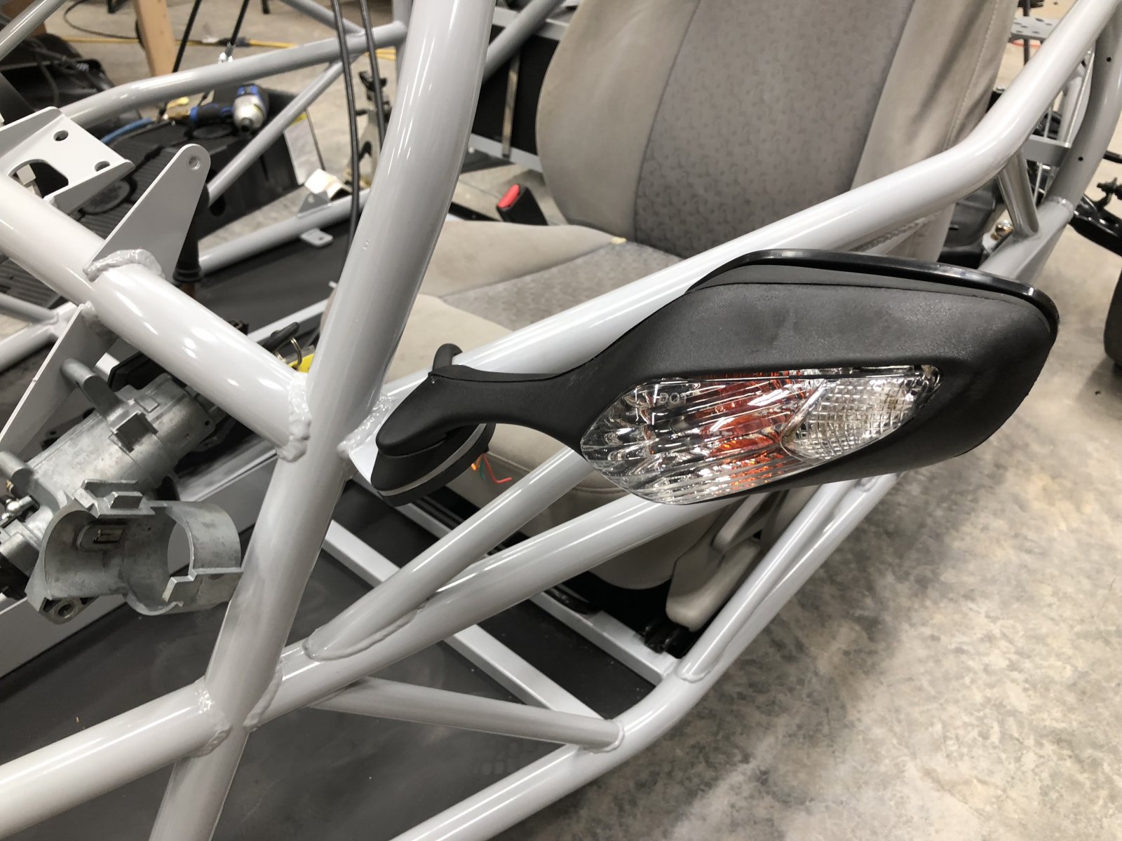

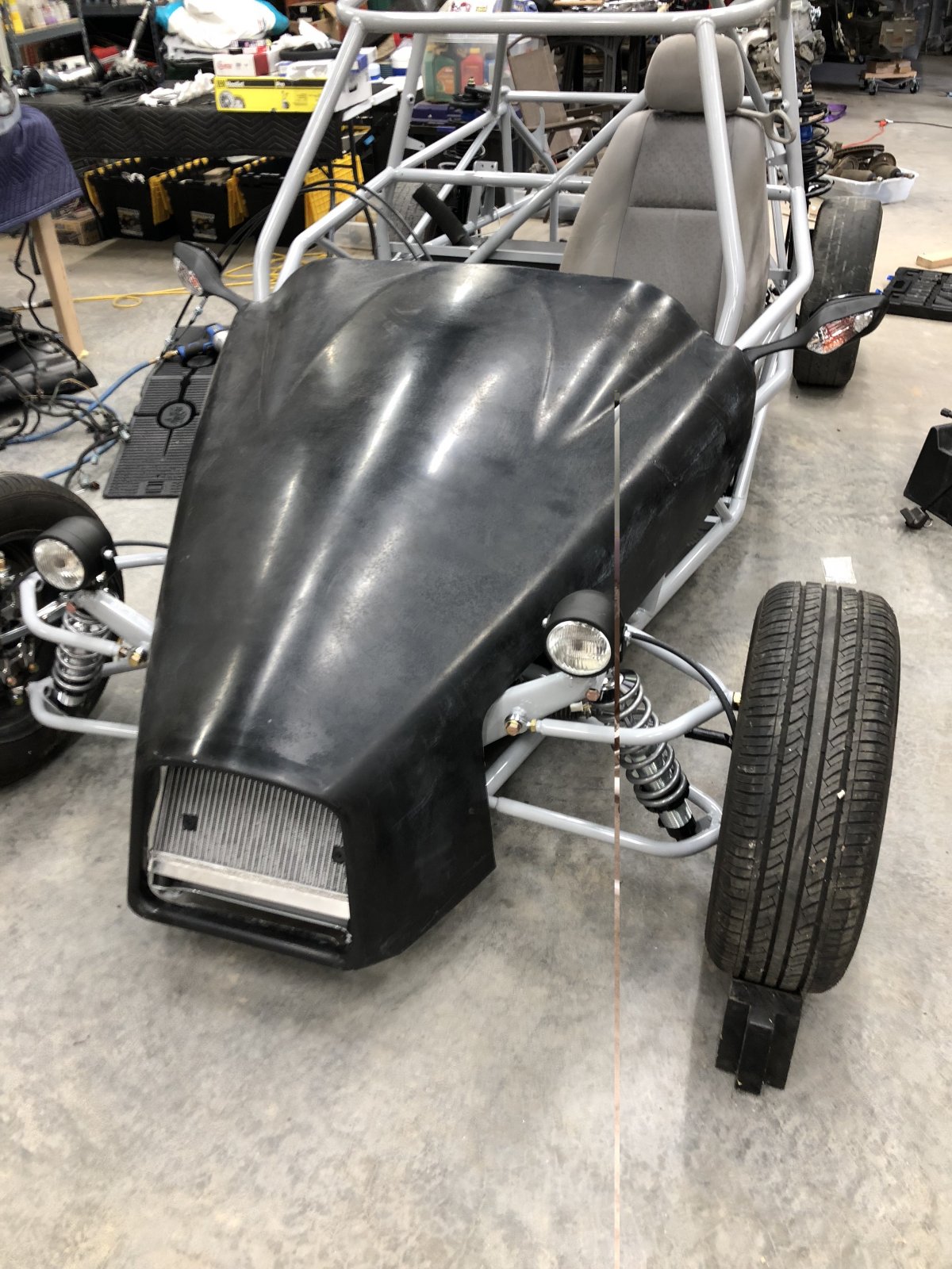

Installed headlights, taillights, and side mirrors

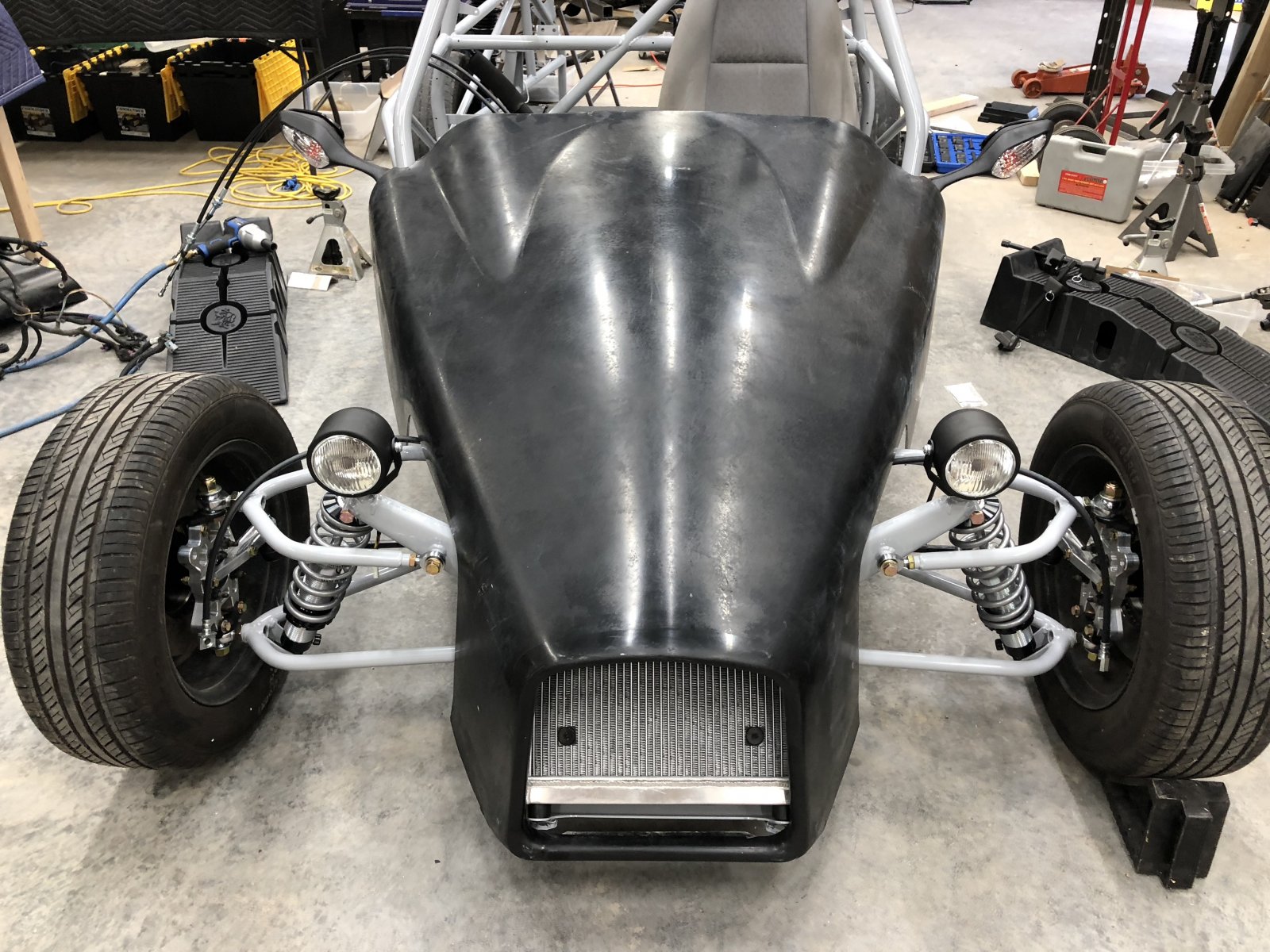

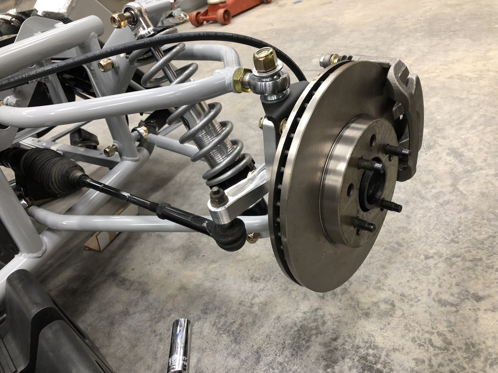

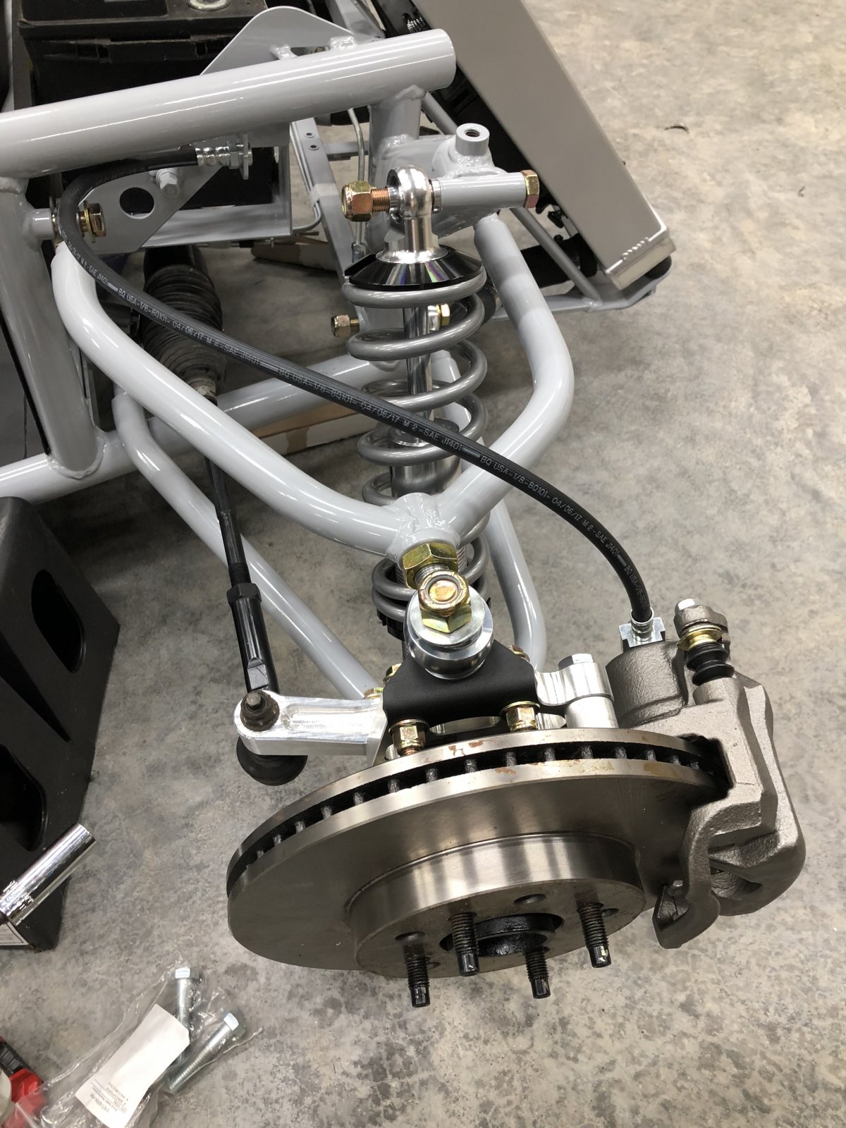

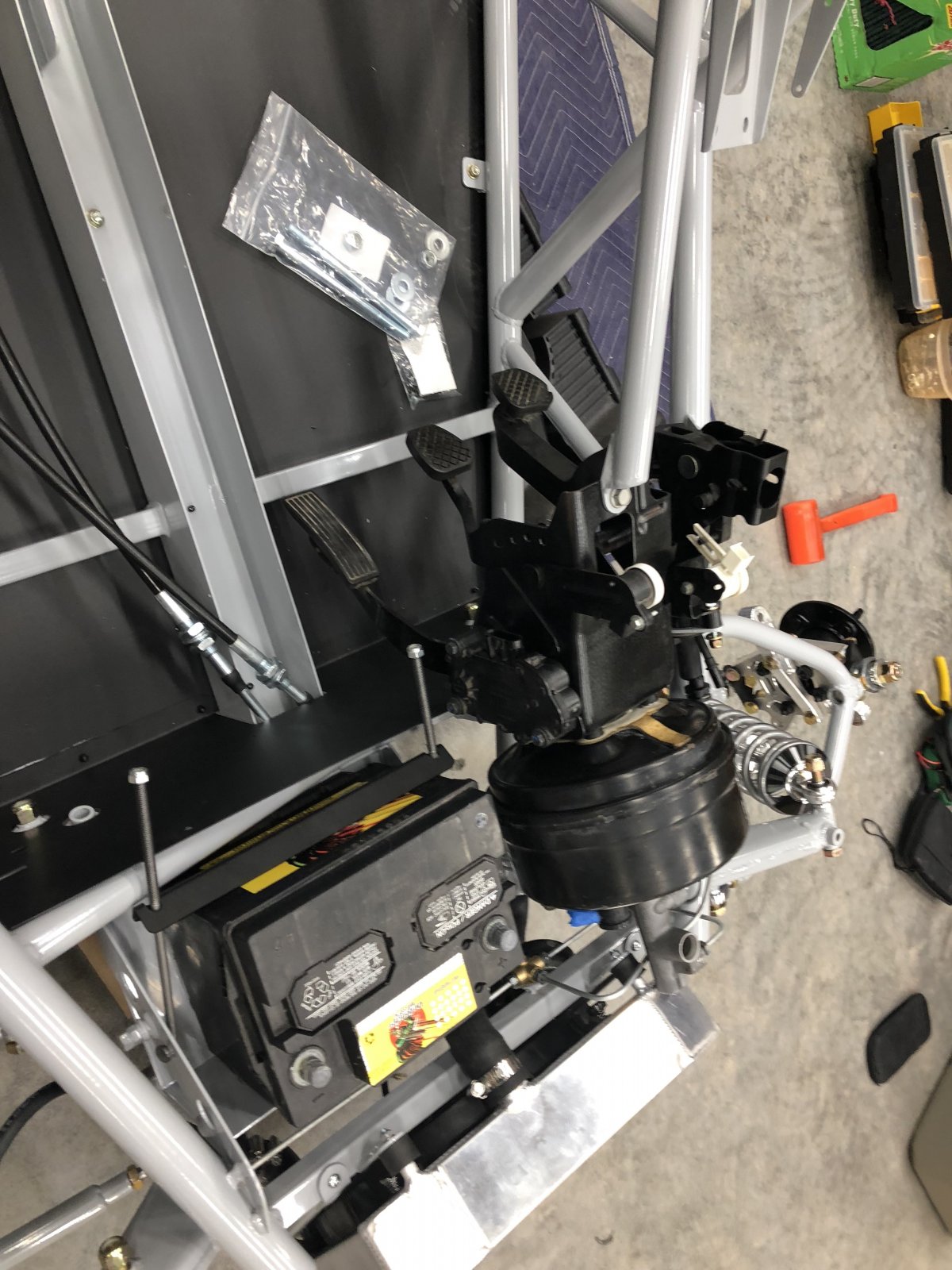

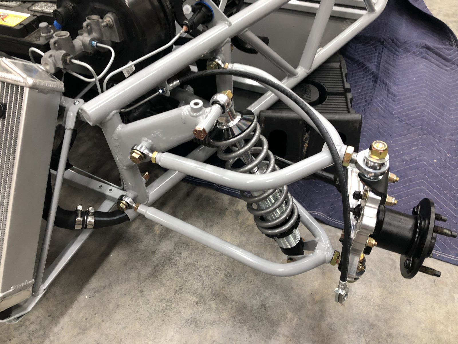

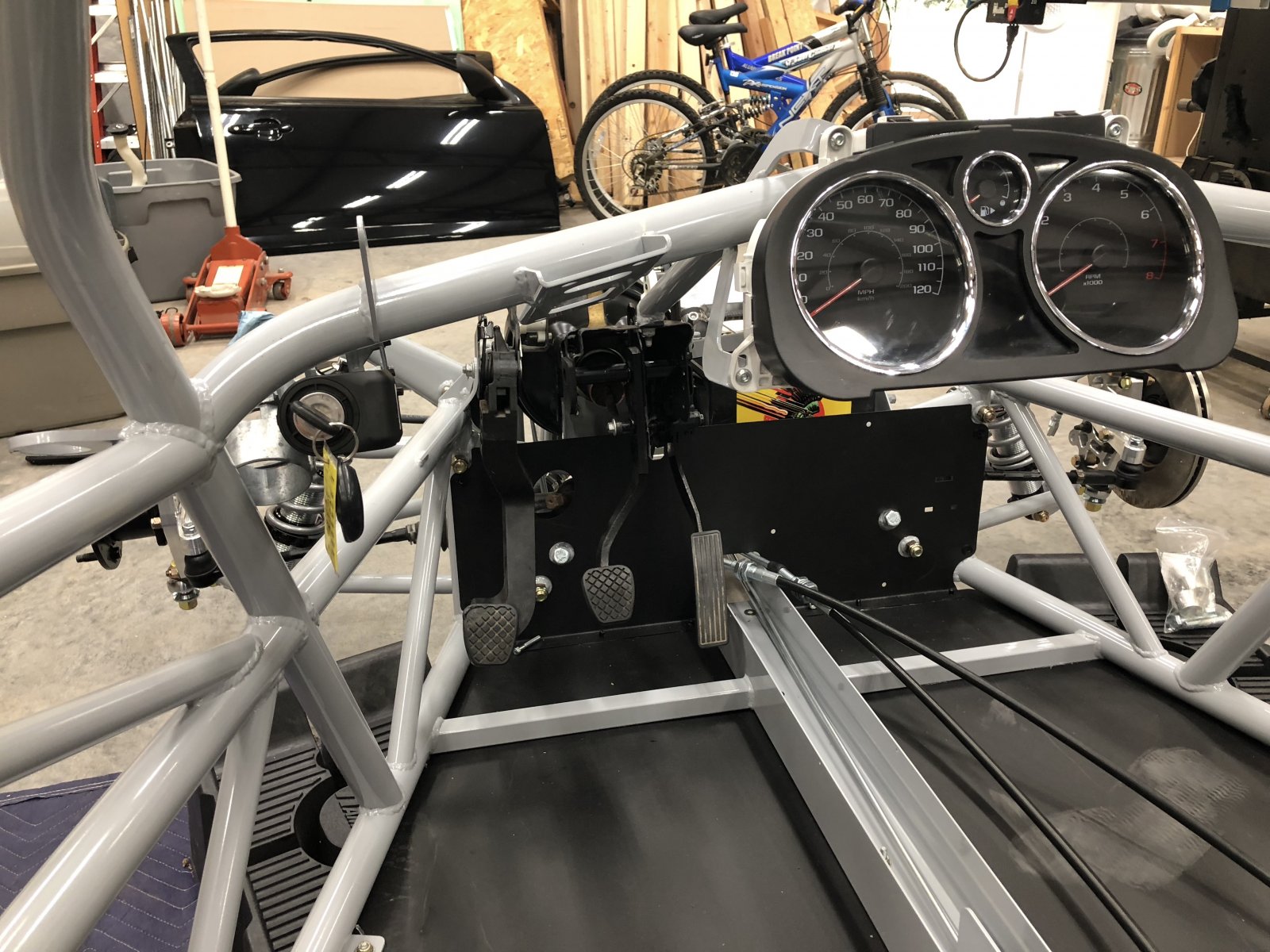

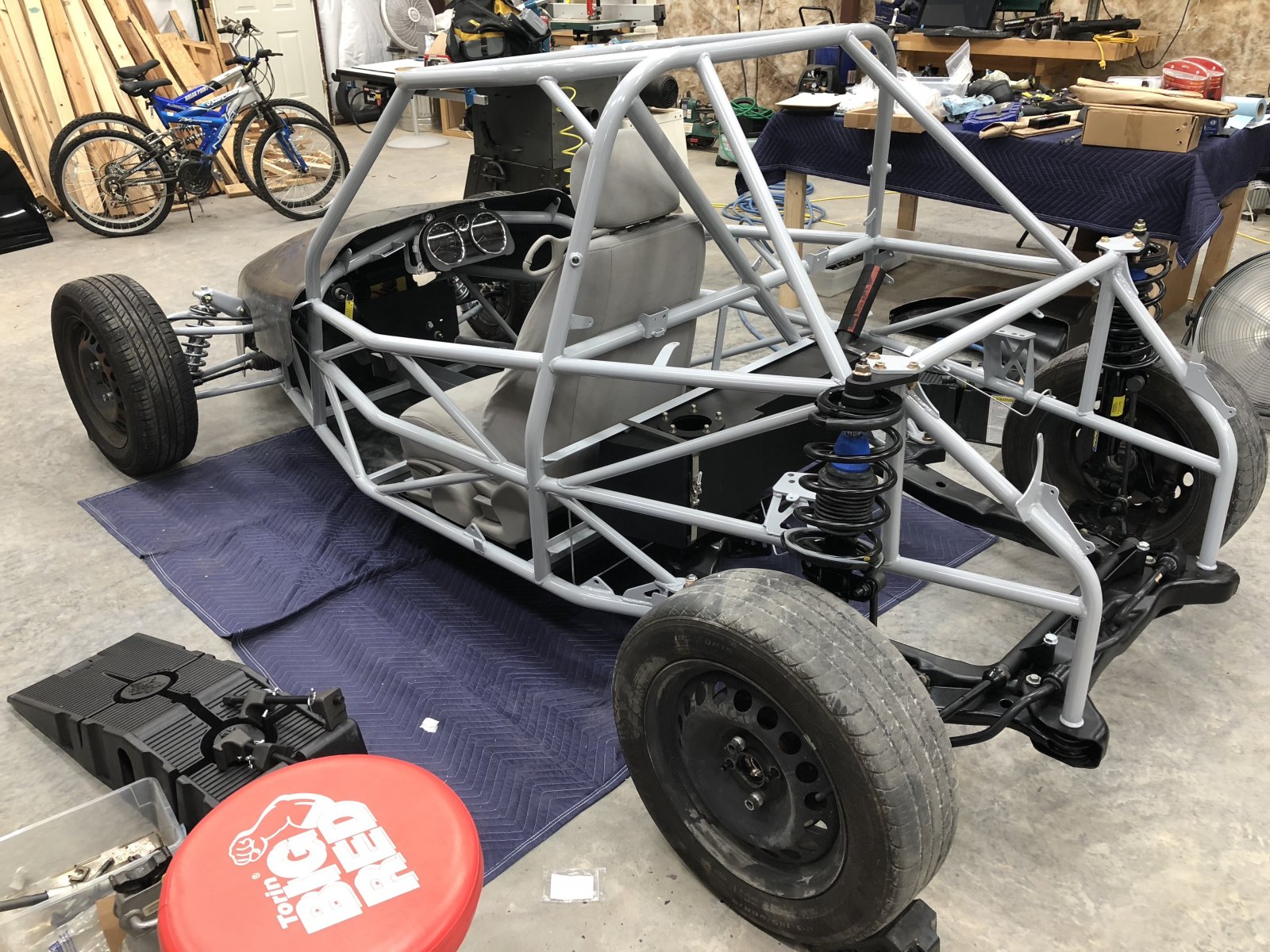

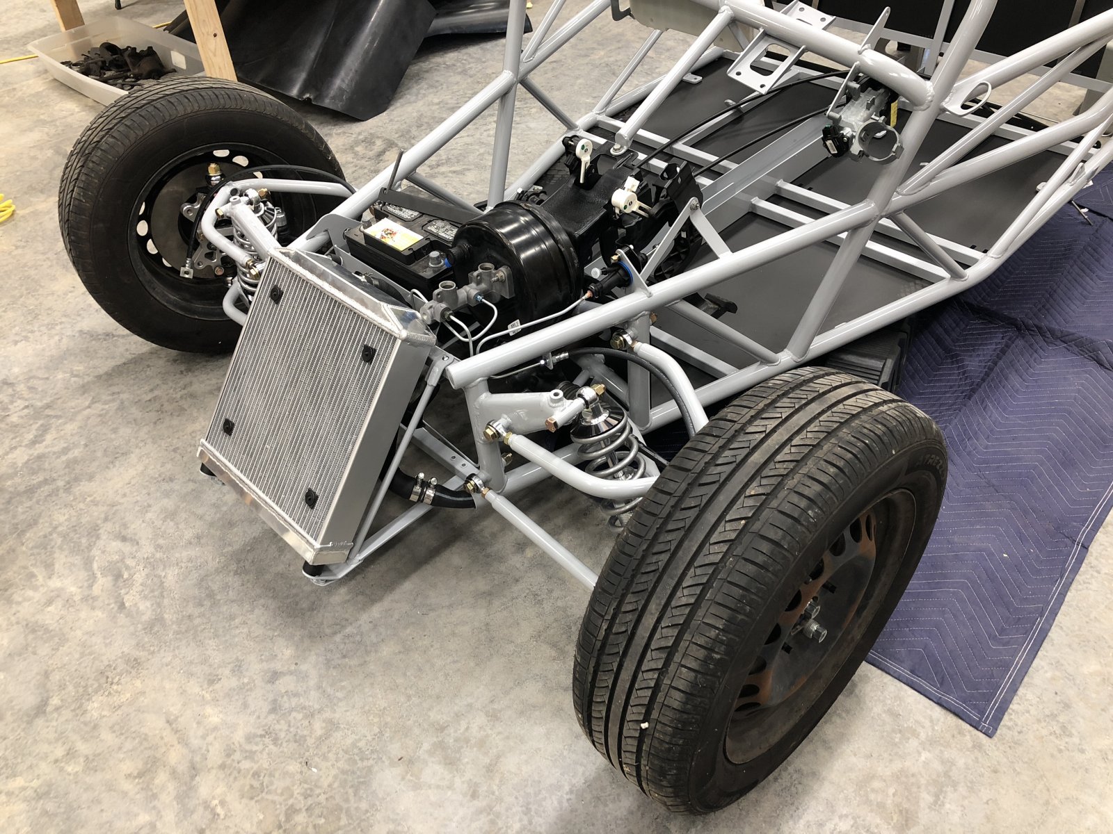

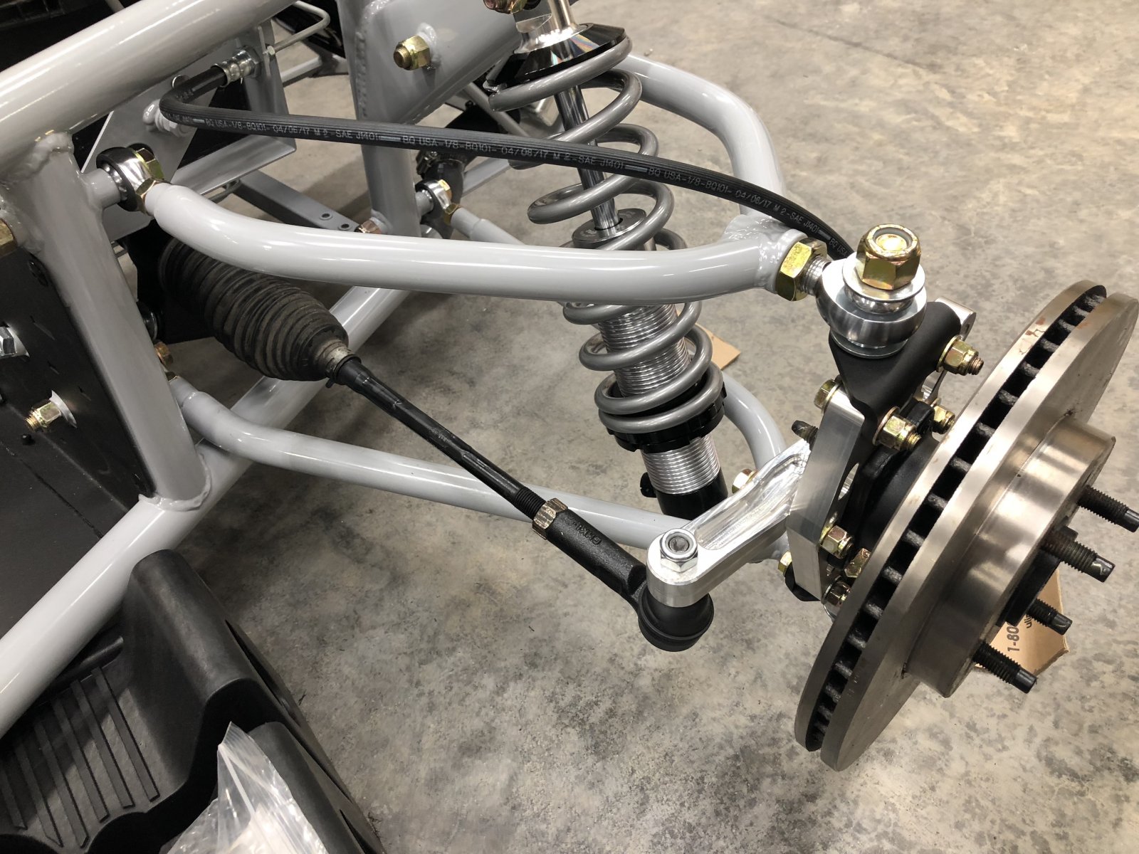

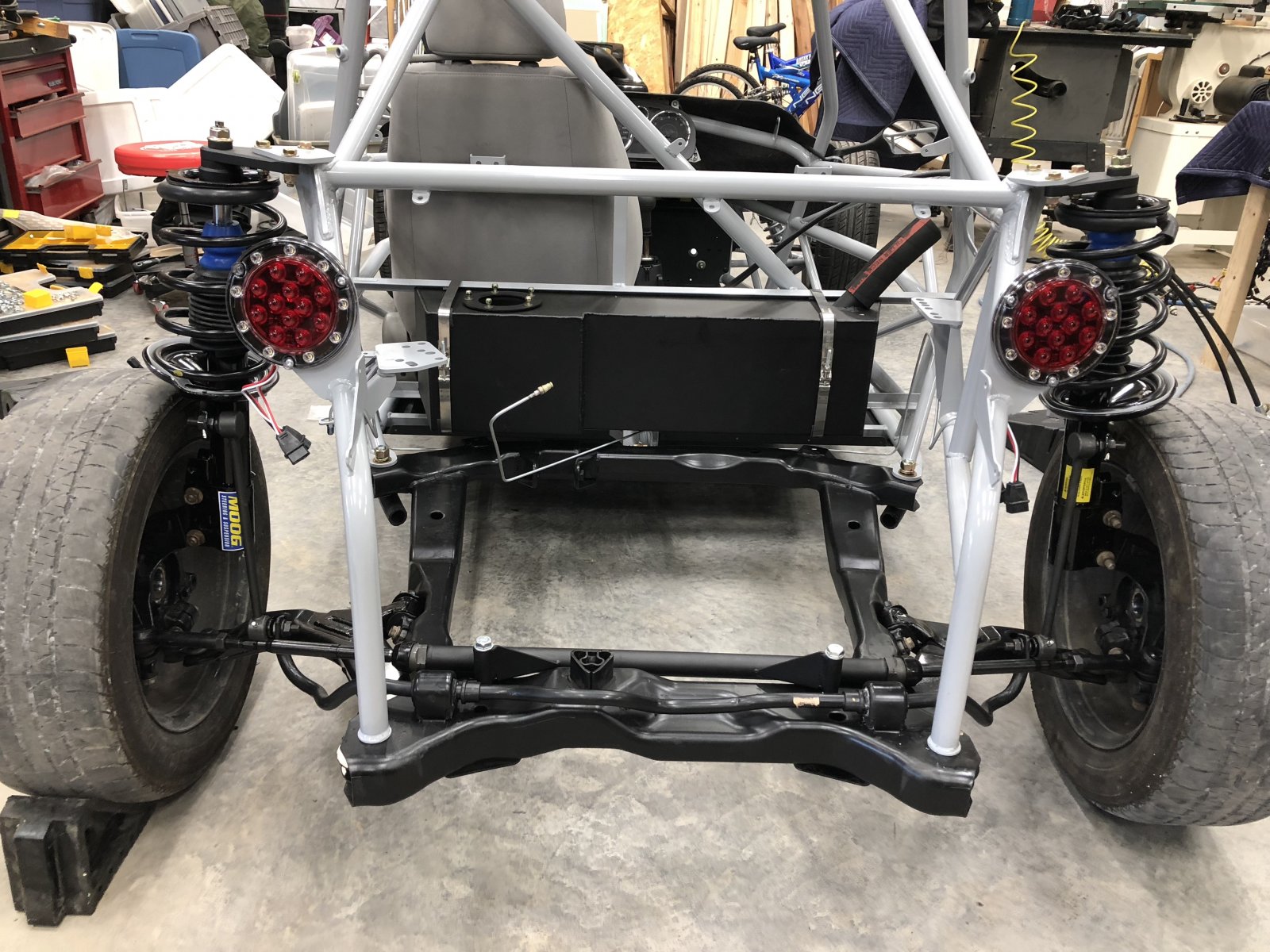

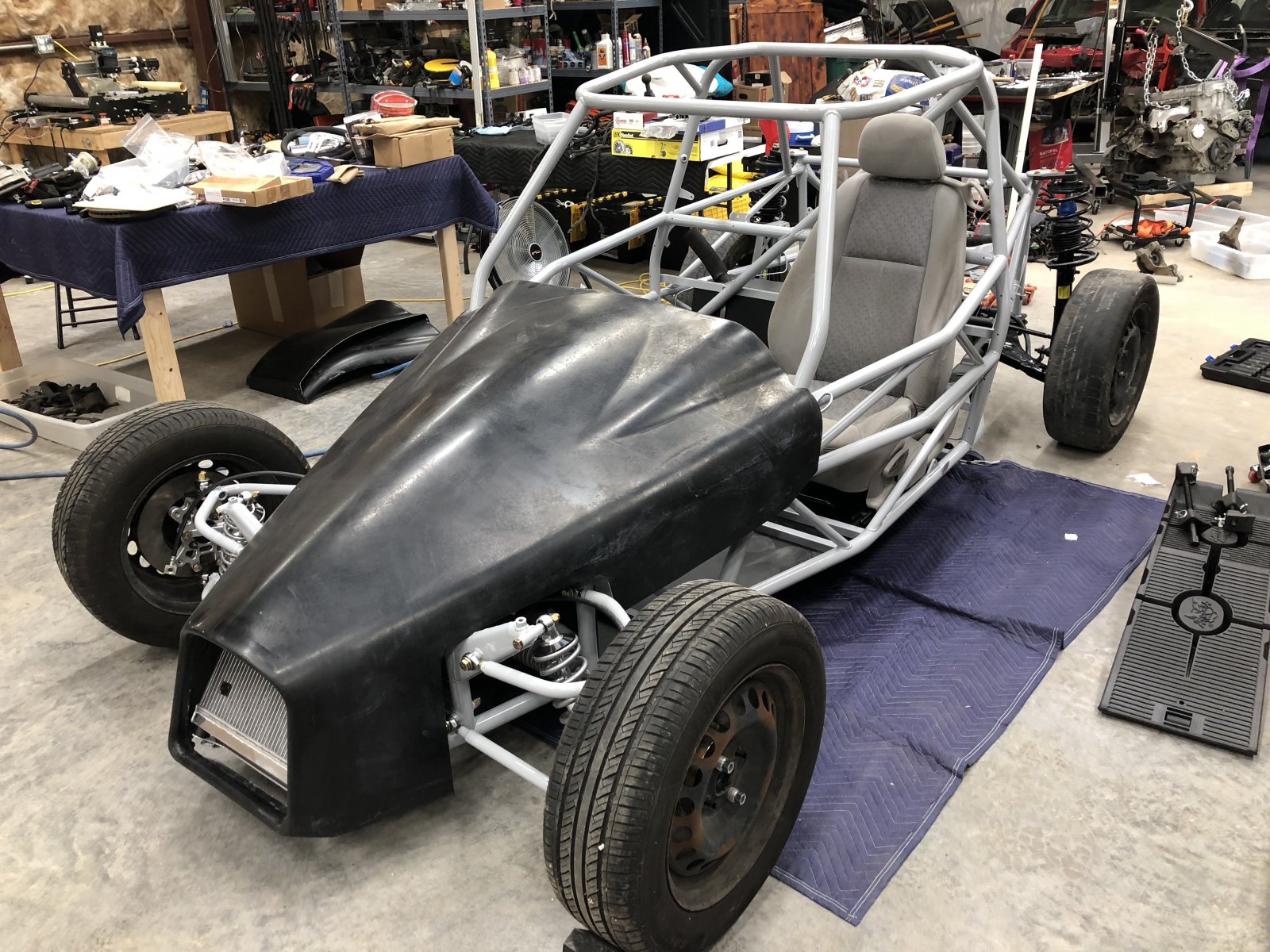

Photos from the last couple days.

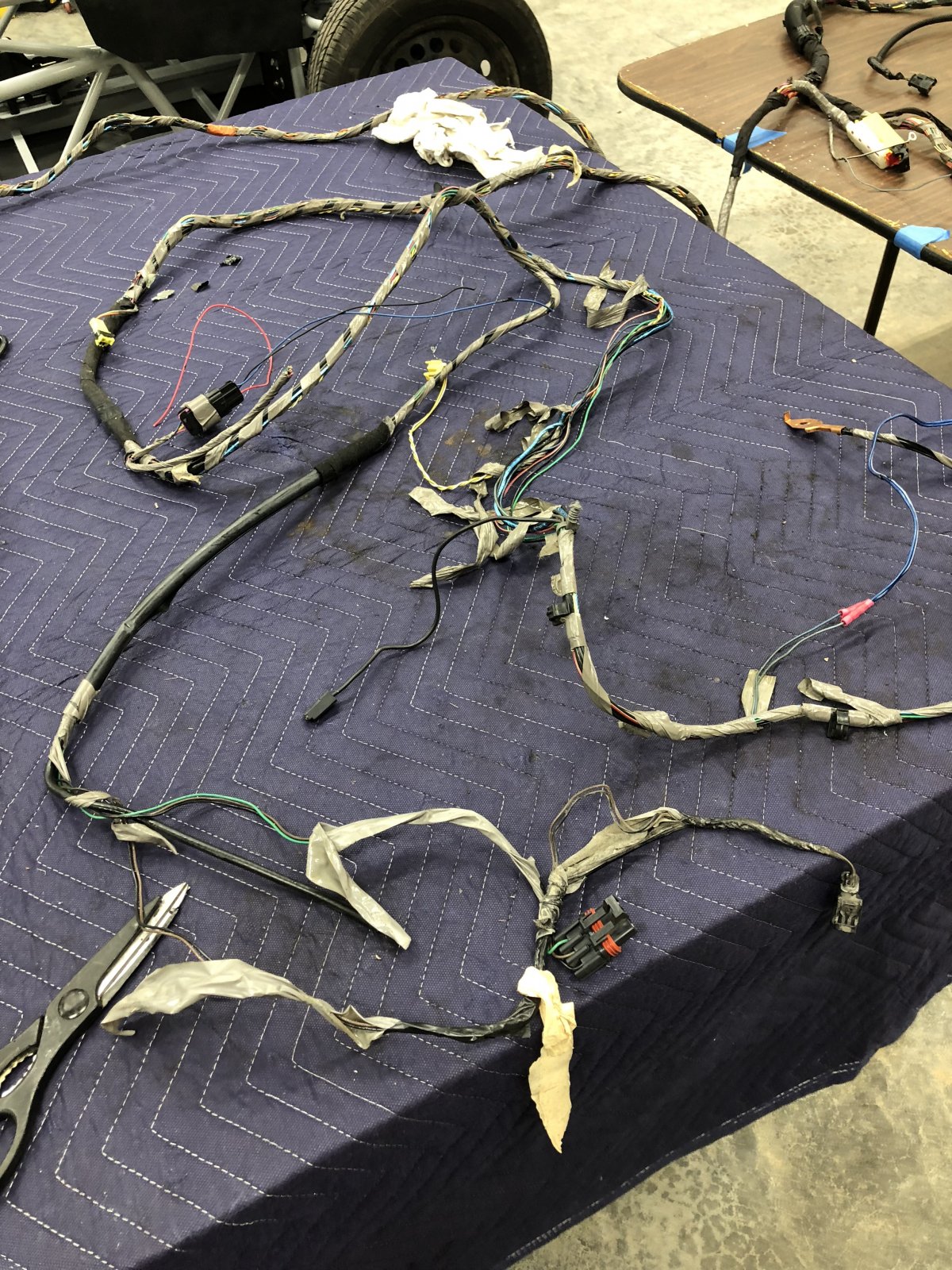

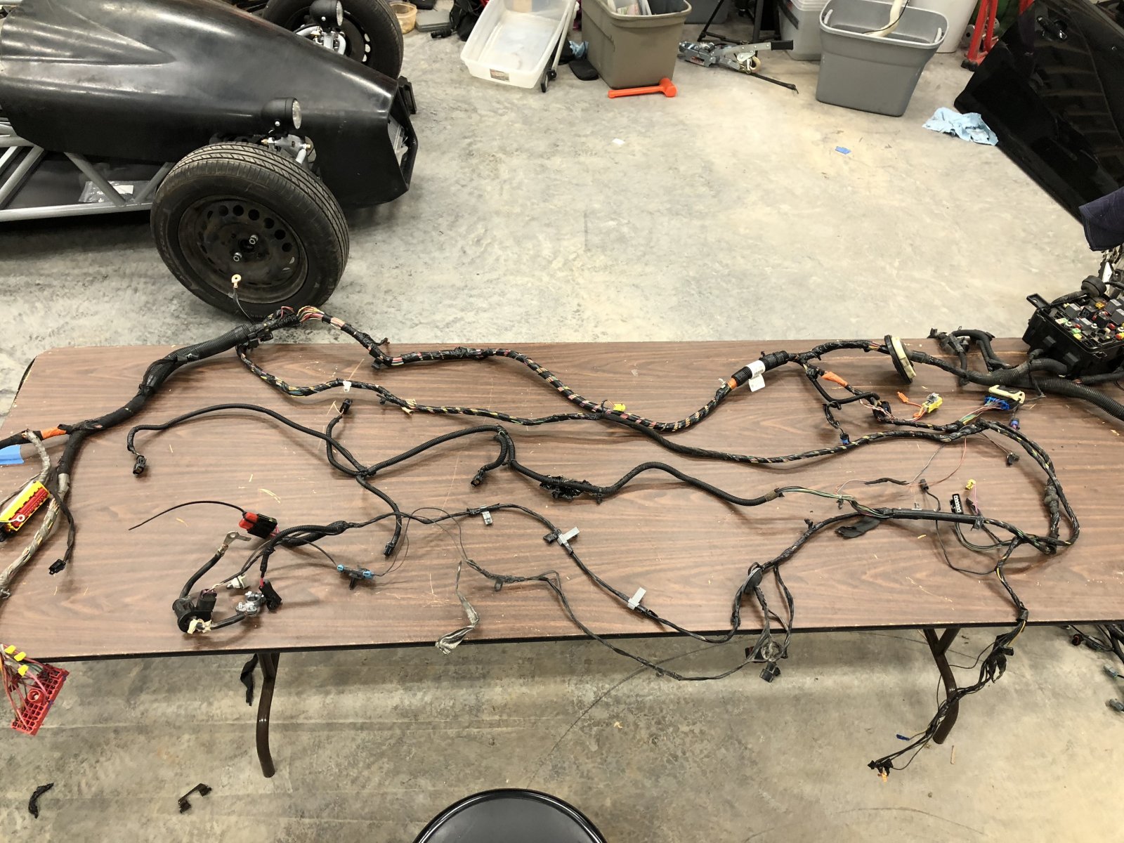

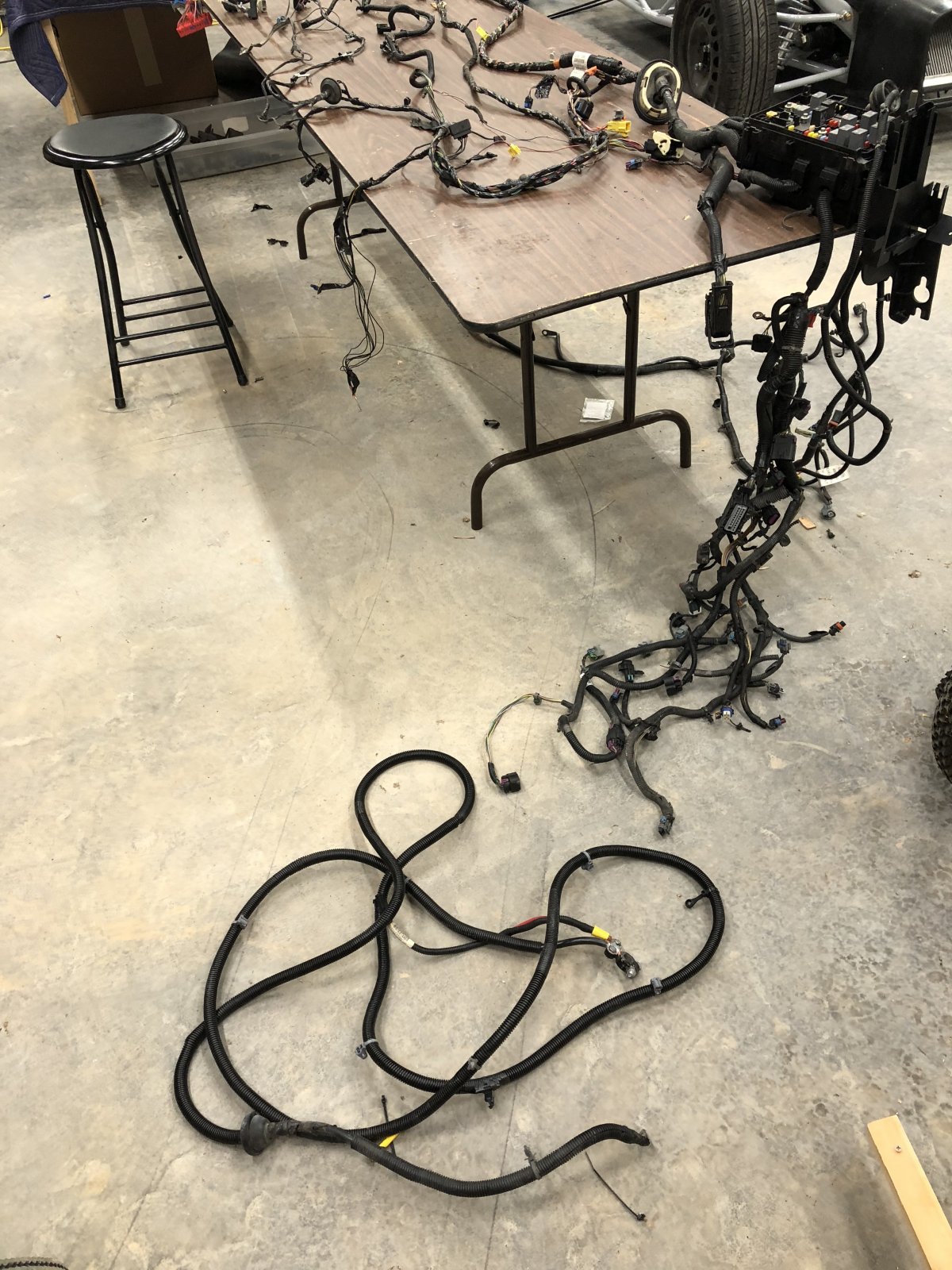

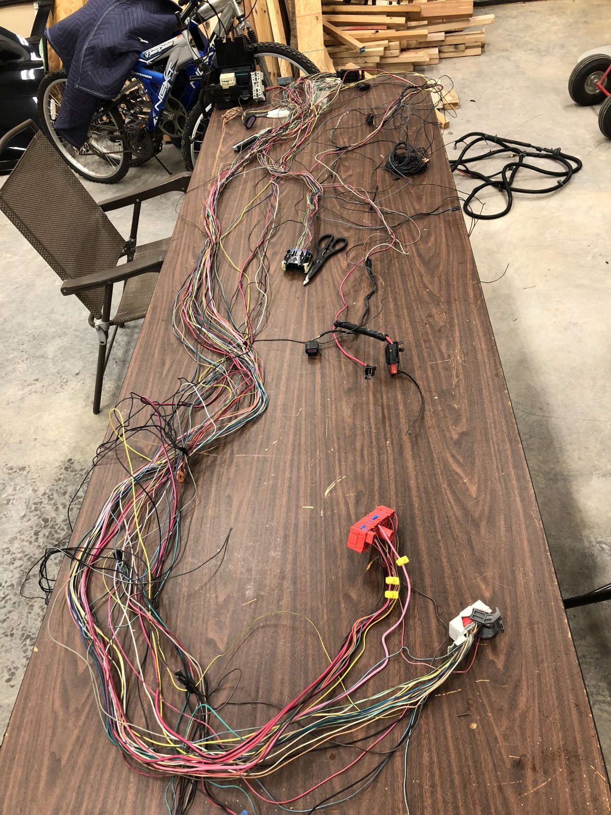

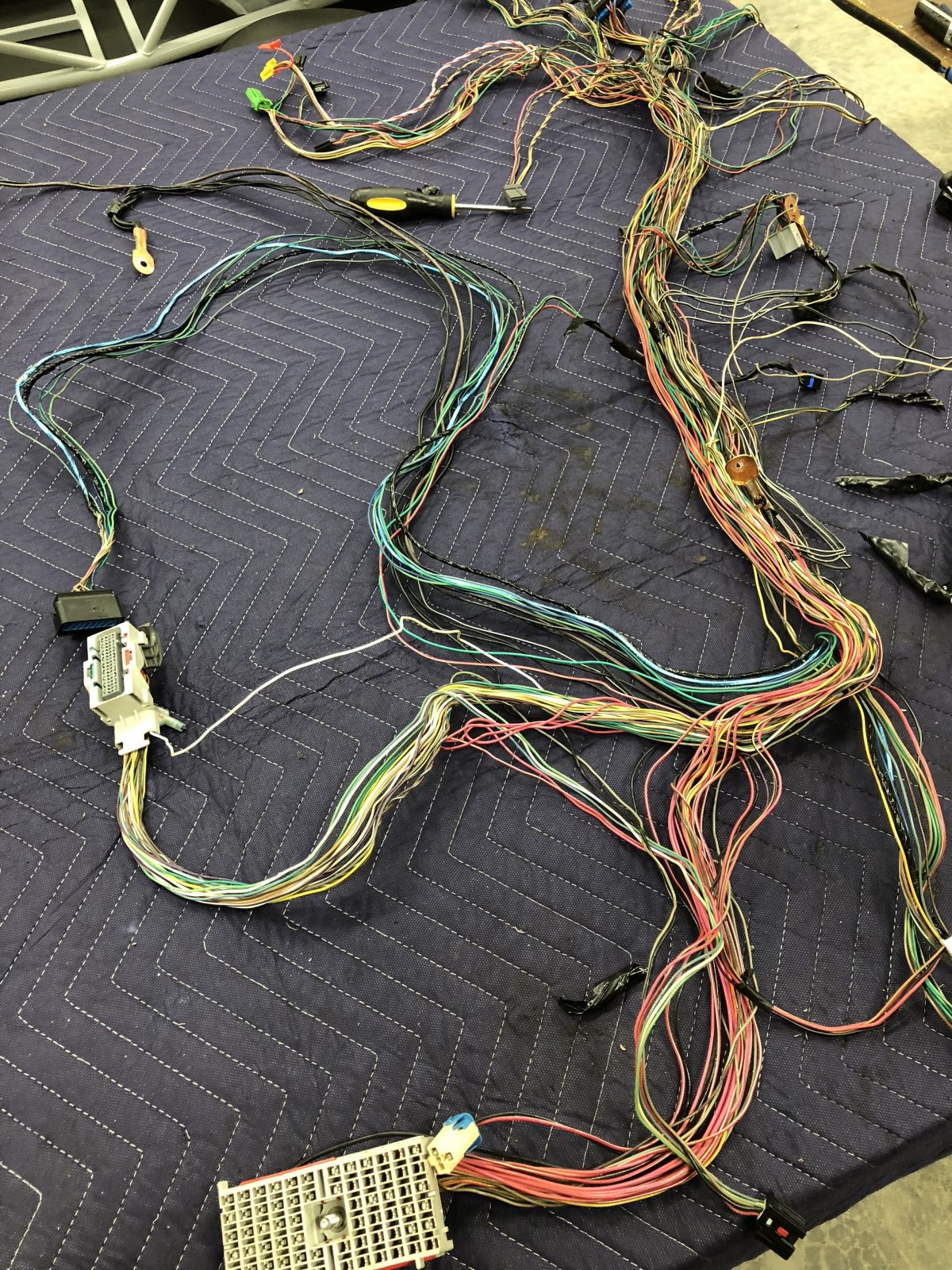

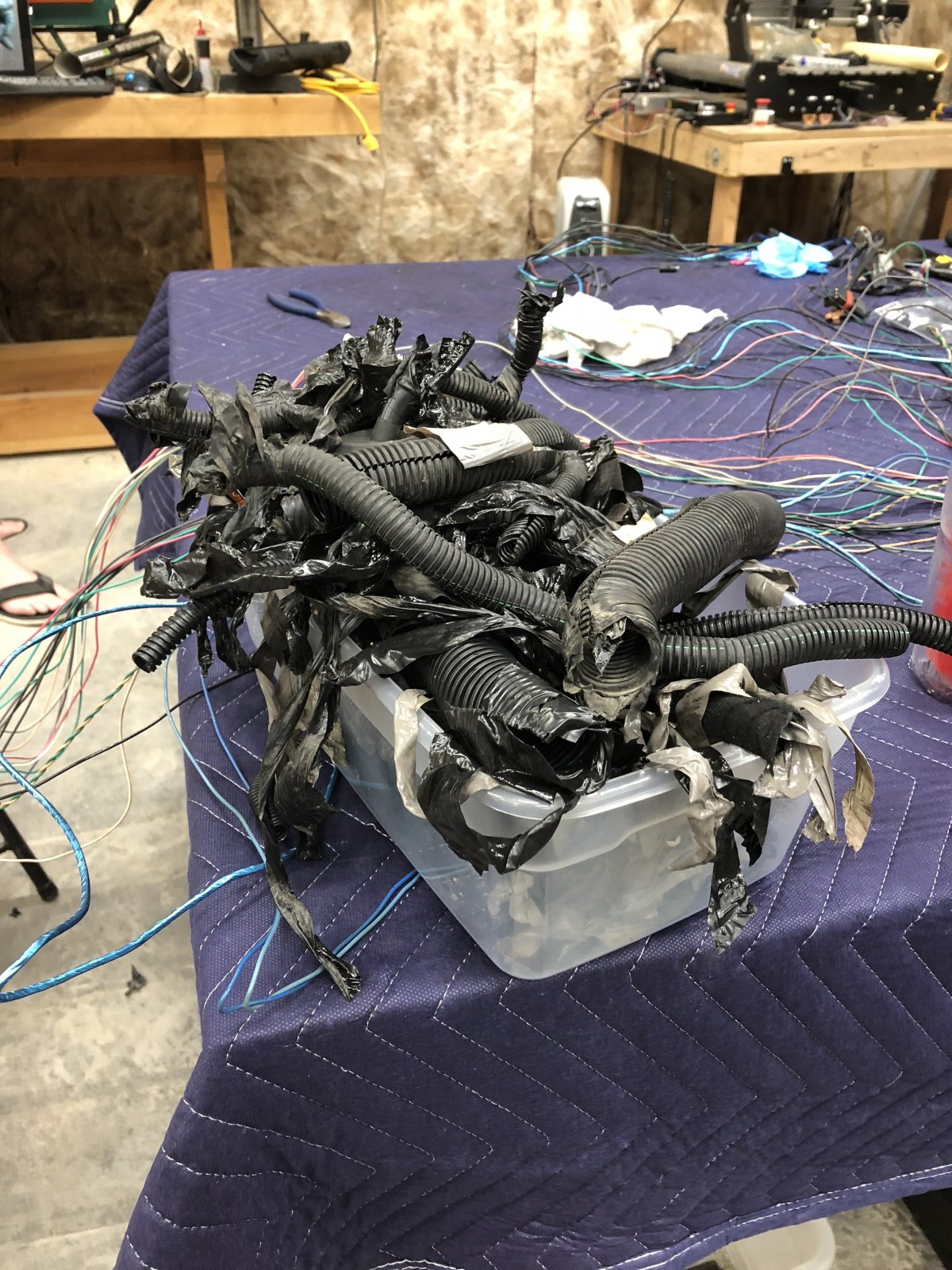

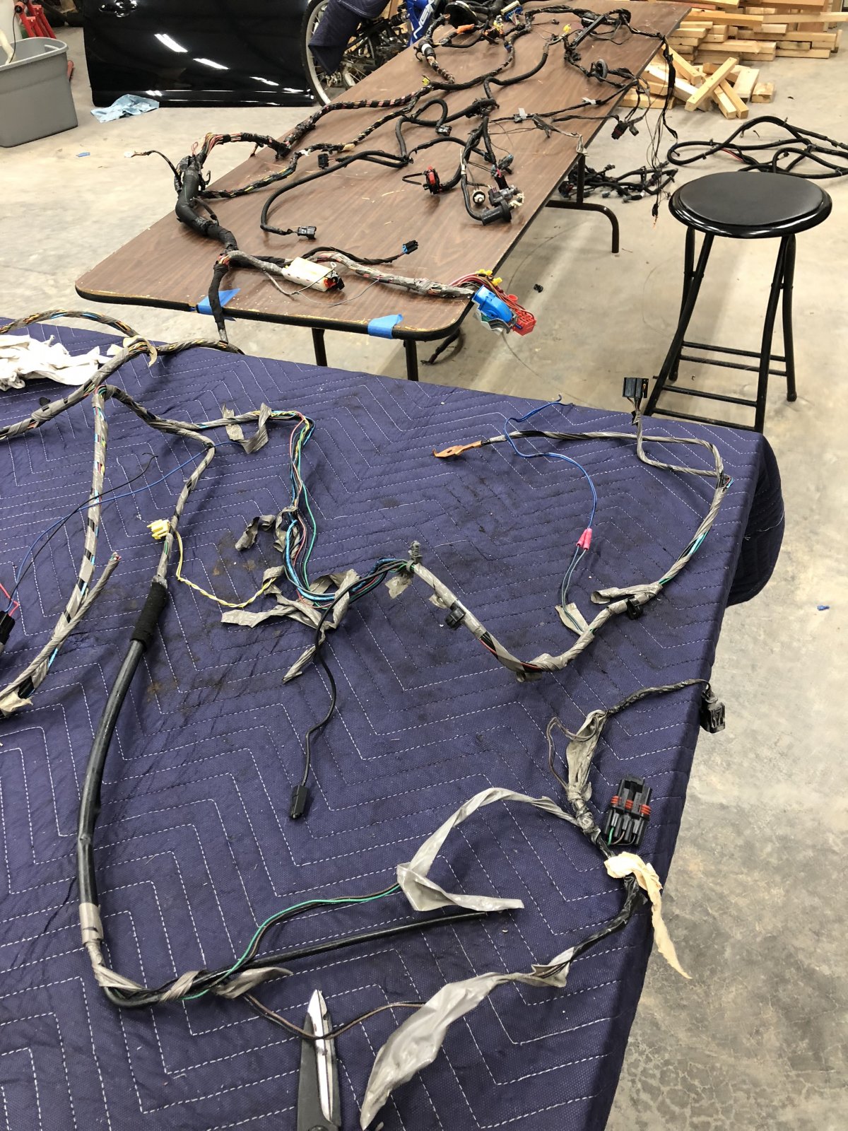

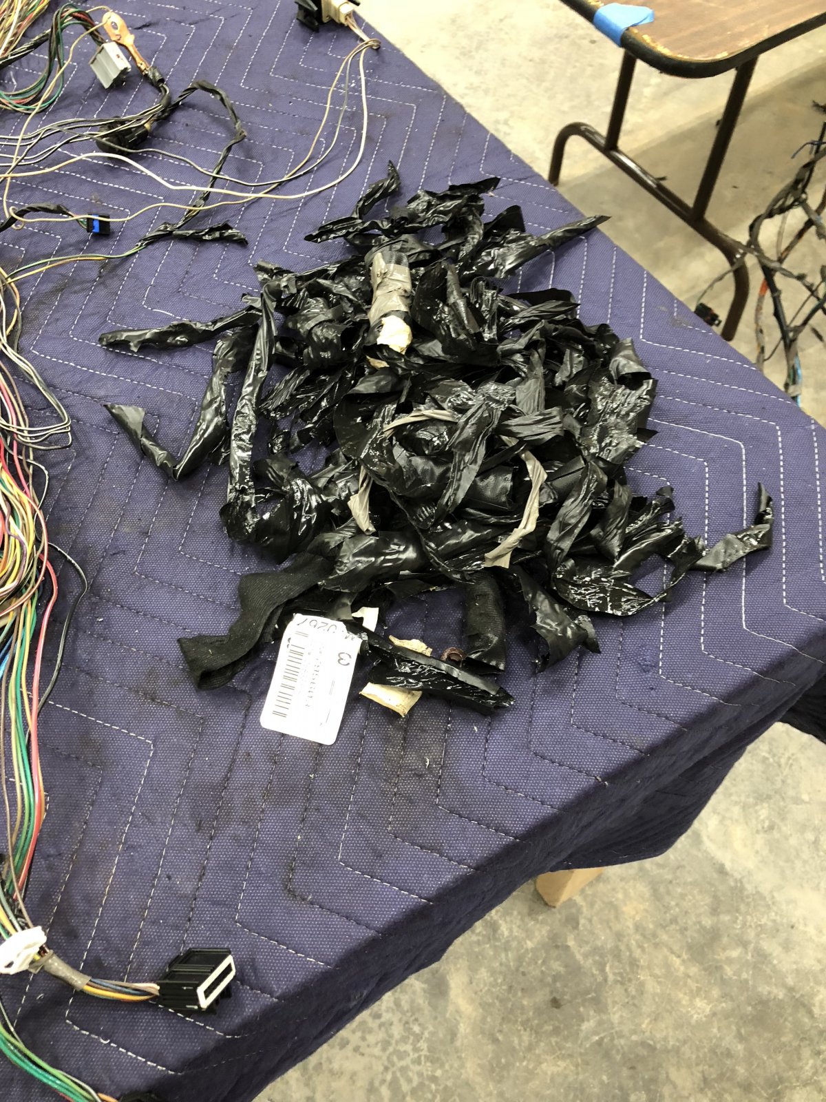

So the wiring harness got a trim tonight. I made it through both thinning videos. I have this bad feeling that I trimmed too much in one spot and not enough in another spot... I guess we'll find out when I put it in and start testing...
Dash harness and all the tape and loom... a nasty sticky mess...
Getting started on the body harness
KpvxDGgGTHyqJ5dkhDpt%A.jpg wzLogmeTQHyob6RXl2WH2g.jpg hqQ+SwFMQleq7gTYkNzxEQ.jpg TrmNtD9WRIukbJNt05QsLA.jpg
Another giant pile of sticky tape and loom

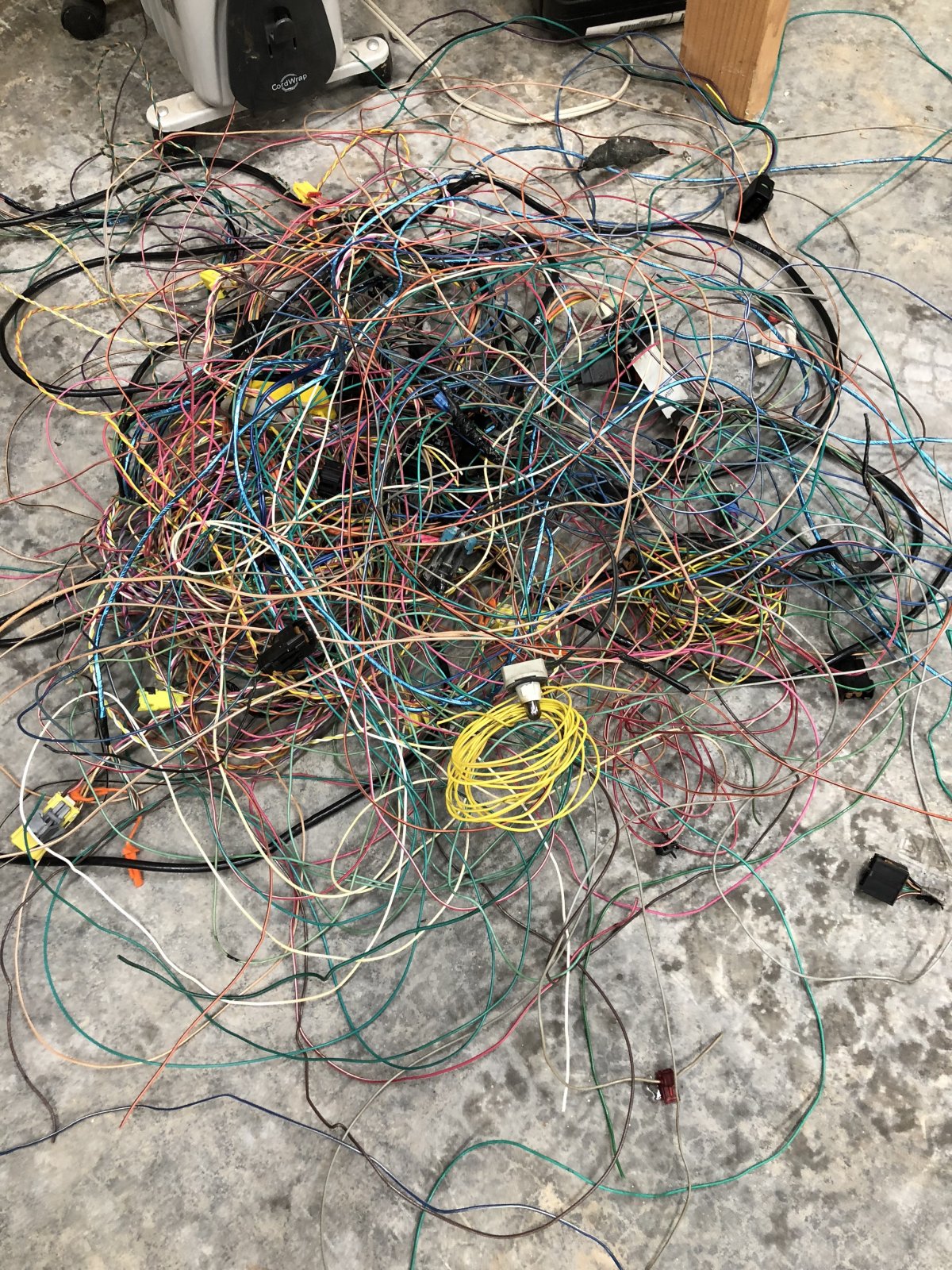

All the wire that got removed
Finished thinning (I hope...)

I'm not sure you could get the engine in with the subframe installed. I don't have it all bolted down to torque yet as I planned on taking it back out.
I'm just impatient and wanted to see it sitting on all 4 wheels :)

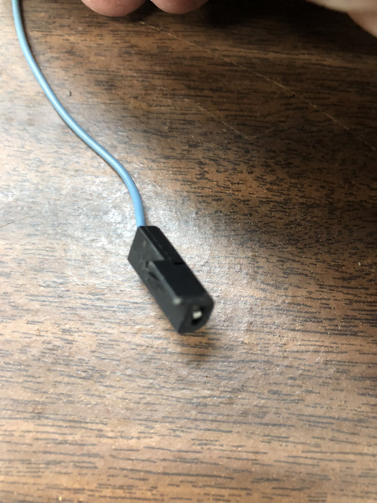

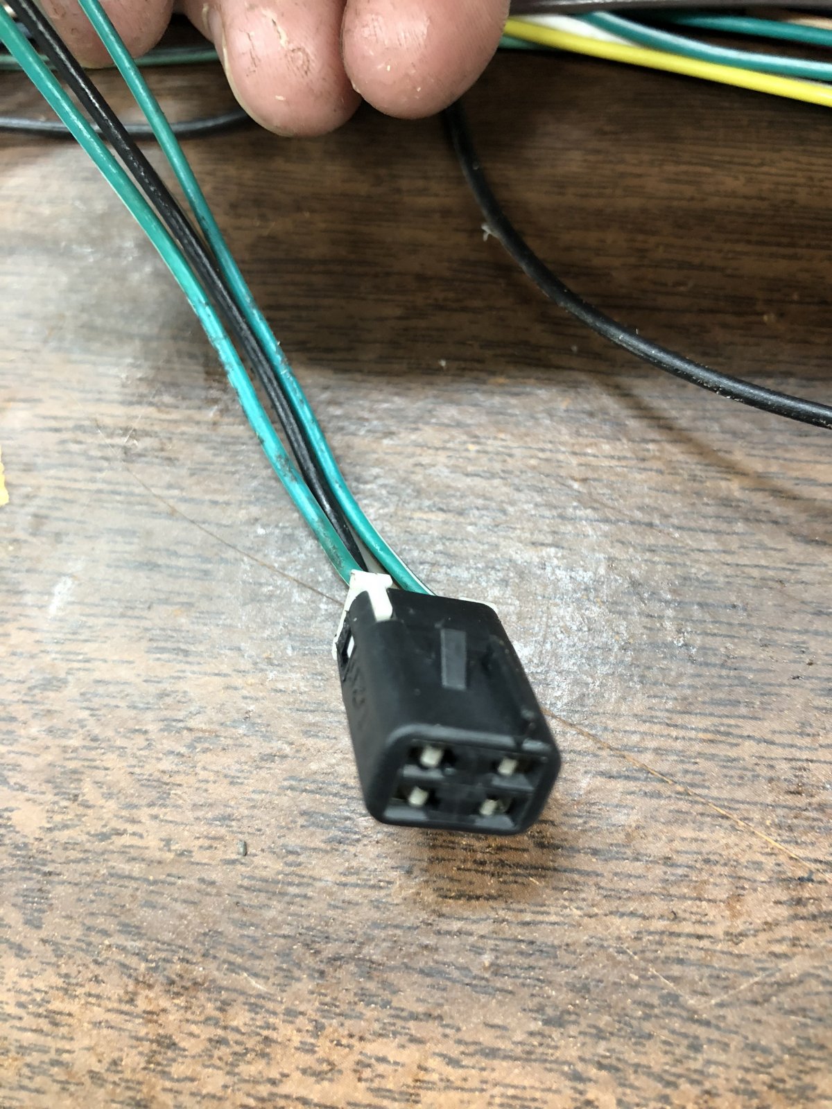

I was pretty relieved to make it through video 11. Turns out a lot of the stuff that I thought I had wrongly removed ended up getting removed anyway. I did find that I accidentally removed the light green backup light wire so I'll have to get the wiring diagram and put that wire back in... I guess worse things have happened... ¯\_(ツ)_/¯
I do still have two connectors that I can't identify.
k.rollin
I'm probably wrong, but they look kinda like they're for the automatic transmission shifter and the parking brake. Someone else will probably chime in with a better answer; I'm working from foggy memories.
I was thinking parking brake also for the single-wire connector. The four-wire does not ring a bell with me and could be for the automatic as I only have the manual. The only other connector that looked like that was for the boost gauge but I don't think the wire colors are correct without looking them up.
jennam
I watched the next video and Lonny calls the single connector wire the parking brake wire. That other one may be for an auto trans. It seriously wouldn't surprise me if the previous owner changed it... I've found all kinds of splices and random connectors in the wiring harness...
