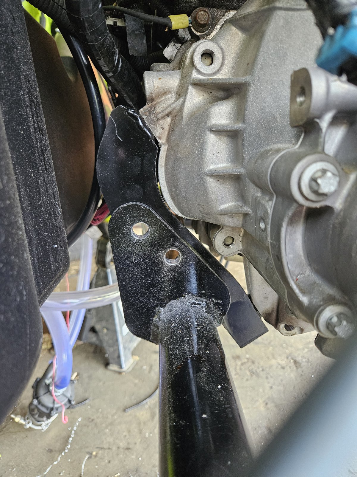

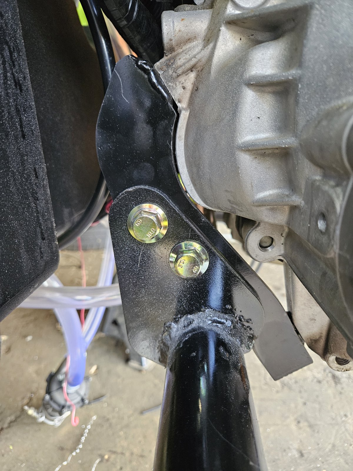

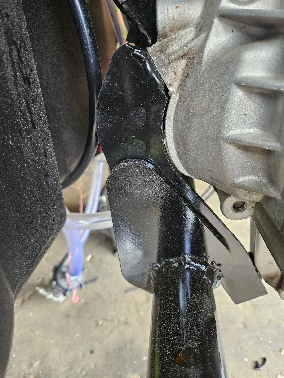

Front transmission mount installed. Kind of a shame that it will be hidden, but Im happy with how it turned out. Upside-down left-handed drilling to get the job done.
Drivers wheel is back on. With rain the next 4-5 days on the menu I kinda hustled to get things done the last two days. Pushing to get it mobile so I can trailer it to the local PD so they can do the VIN verification so I can get my paperwork in.

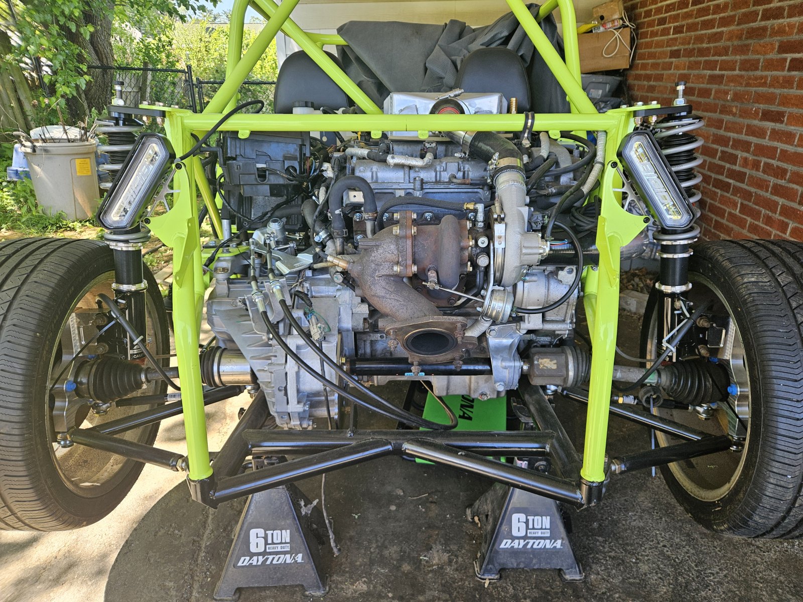

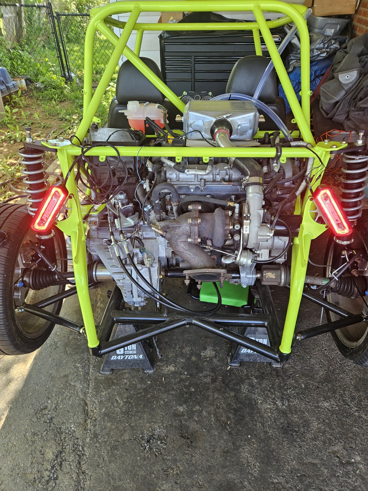

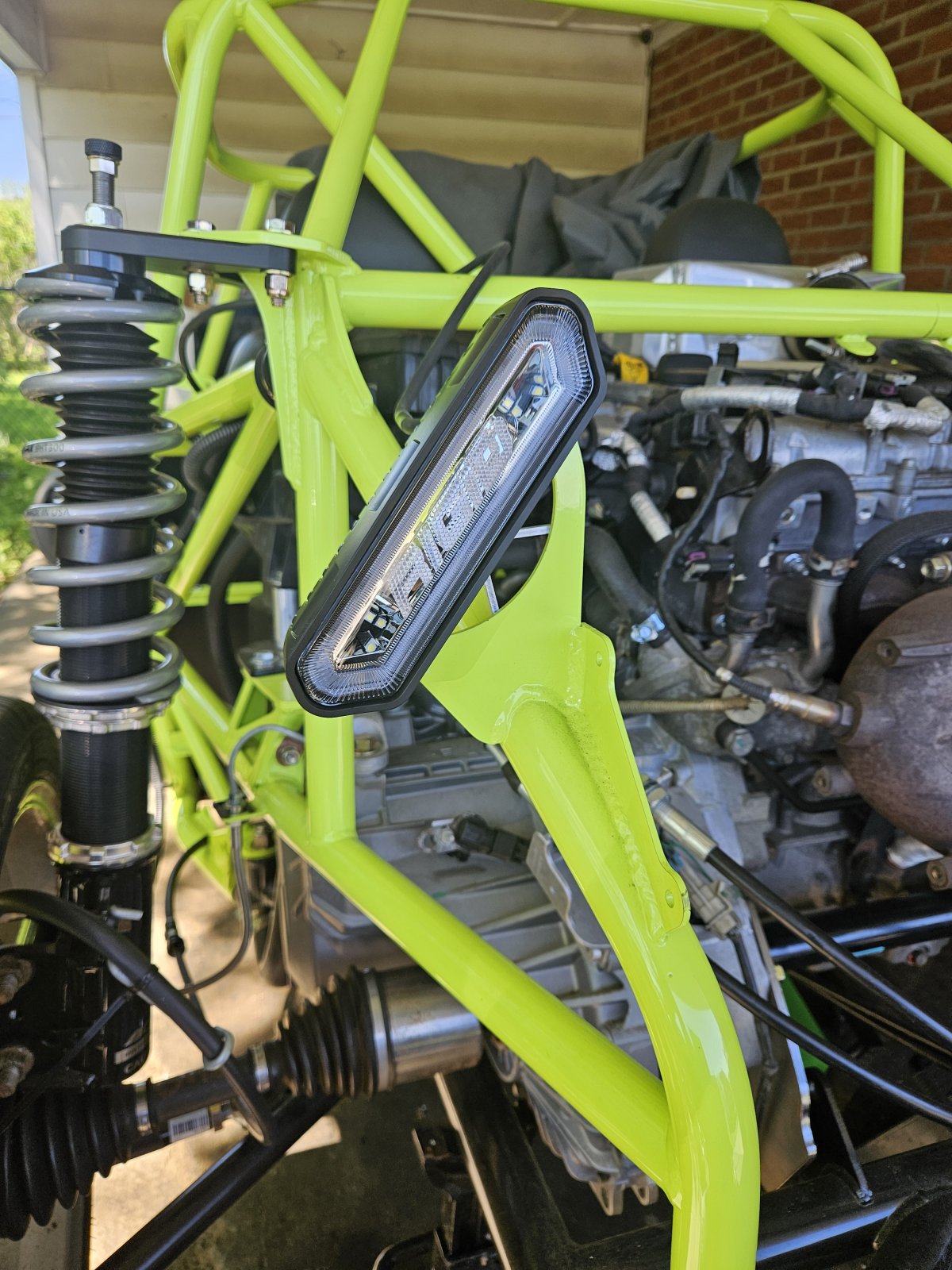

So I wired up these sick Rigid lights, but I keep getting an issue where they blink once and then stay lit solid like my brakes are on. It comes and goes, mostly gone but happens. But my brakes lights seem to stay on, even with the switch unplugged. Again, its not constant and comes and goes. I cans hear relays clicking when turn signals and brakes are applied. Is something wrong with the BCM? Oor...What gives?
I'm 99.9% sure they're wired correctly.
Ive got Reverse, I've got a low powered red running light, turn signals work with the switch (tried two different stalks), brakes work if I press and release the brake pedal. I tried easing up pressure on that foam pad nut on the brake lever/arm, but I don't think that helped.
Also. I bought these awesome headlights with DRL halos like Ive seen many do before, but when I hook up the turn signal wire and switch the stalk, nothing happens, but the parking light just stays illuminated. I've got my buddy Scott helping me, so Im sure we'll figure something out. I just thought maybe someone's run into this issue before.

Brake lights are wired in.
When head lights are turned on, the tails come on soft like they're supposed to. Then they Brake lights come on and stay on until I hit the pedal. The brake lights turn off for a couple seconds and then they come back on and stay on until I repeat the process.
Anyone have any actual experience? Not just a guess? This is something the BCM is controlling and its not a pedal hanging up.
Is it because I don't have my headlights hooked up?
*I dont have have brake lights when the car is off.
*The brake lights will stay on as a last act of defiance when I turn the key off. Seemingly indefinitely. Surely to drain the battery if I dont tap the pedal one last time before I exit the car.
--- lies, they come back on no matter what. Key in, on, or off and out of the car
---- maybe it is a pedal, after they came on the last time, I ripped up on the pedal hard and they havent come back on with the key off.
Joebob
Try loosening the little screw that holds the brake light sensor to the brake pedal. Add a little bit of play to relieve the stress should allow the brake light to turn off.
