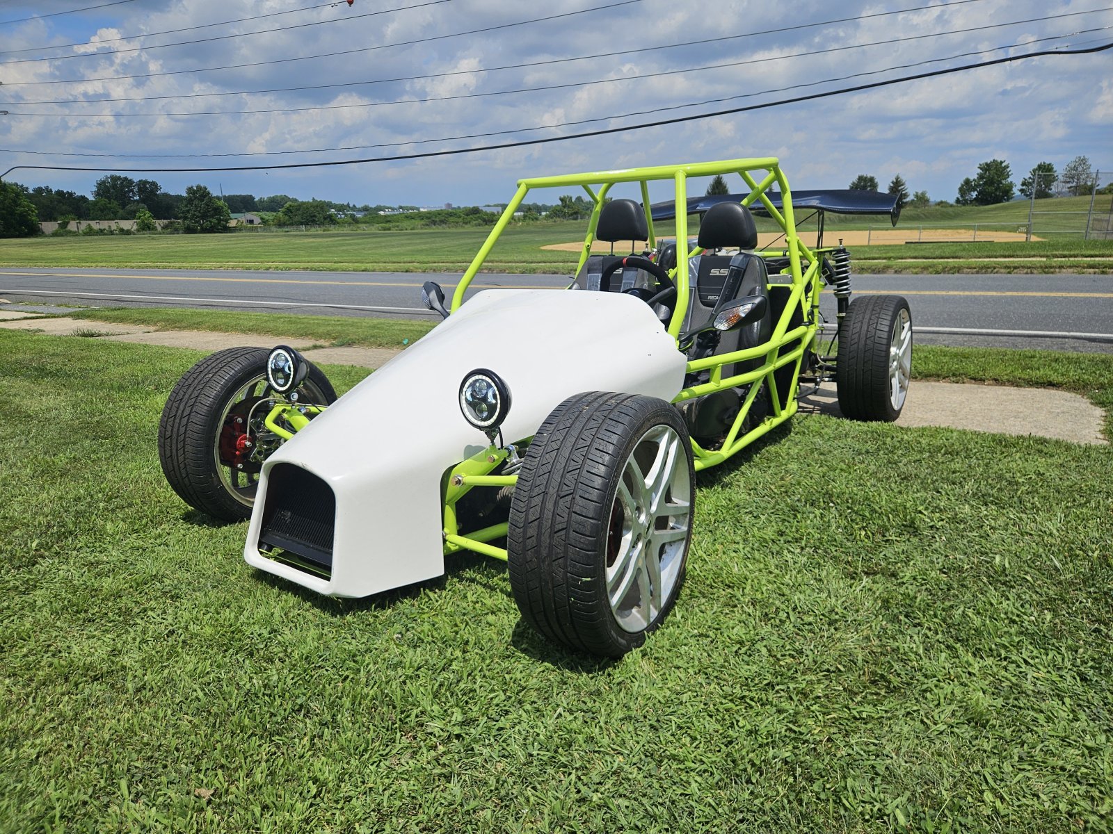

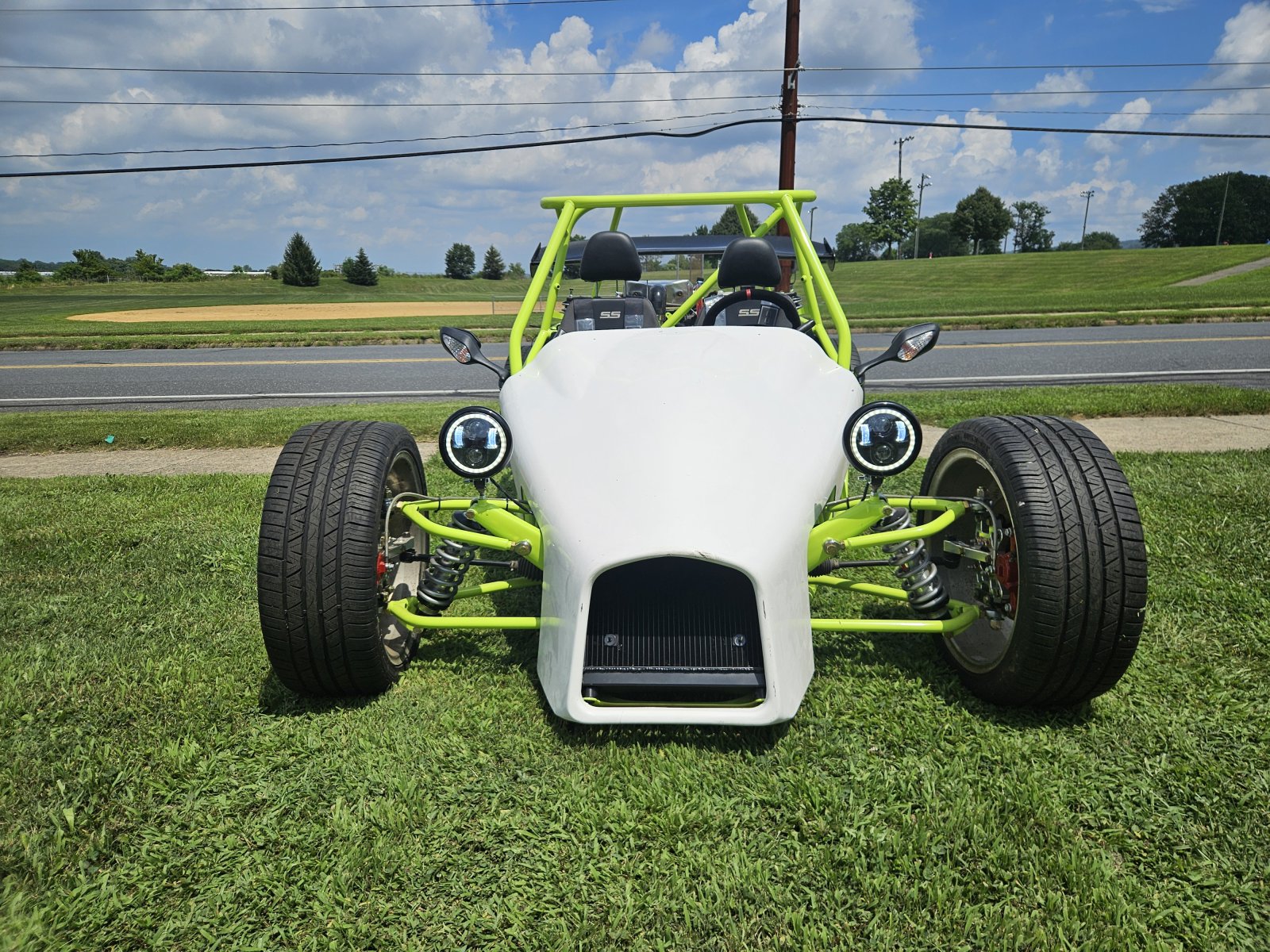

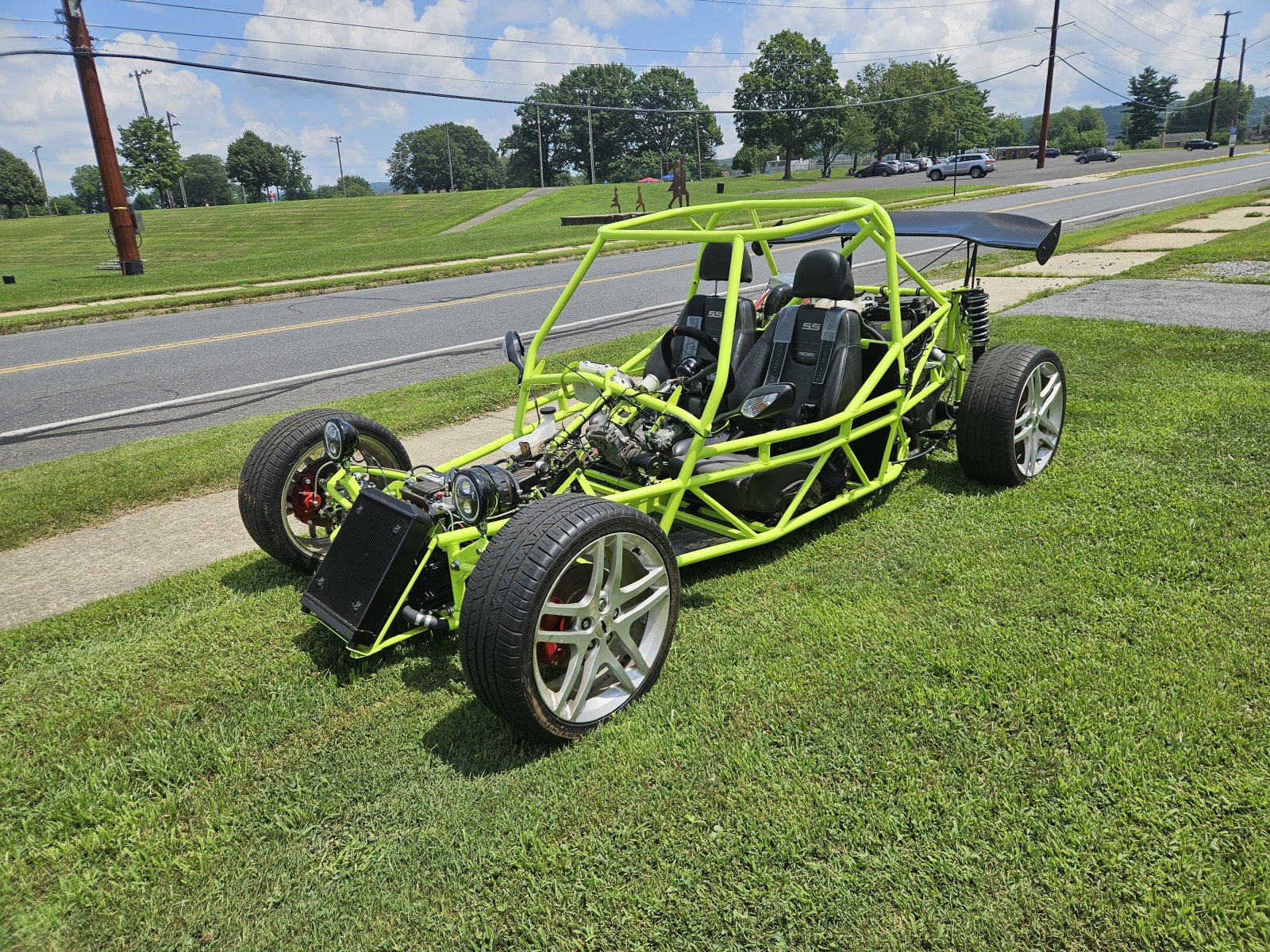

Got the car out of it's hole for a little today for some pictures and a 180° in the front yard. I kinda regret the 180 as I can see the grass dying already :rolleyes:

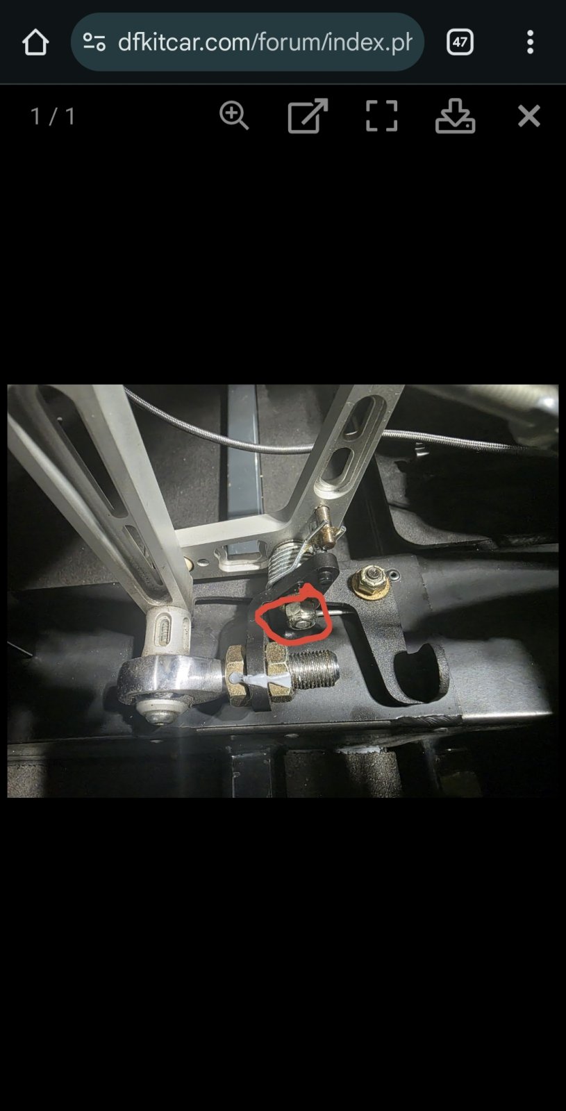

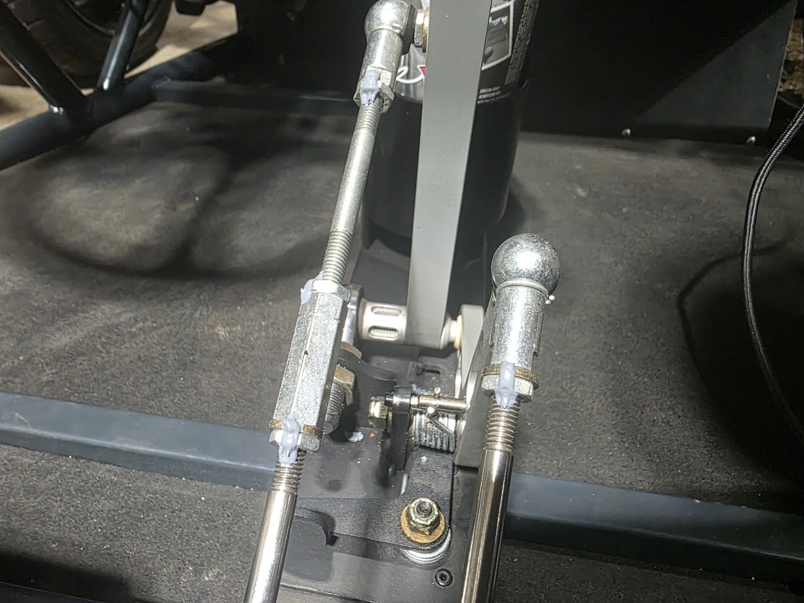

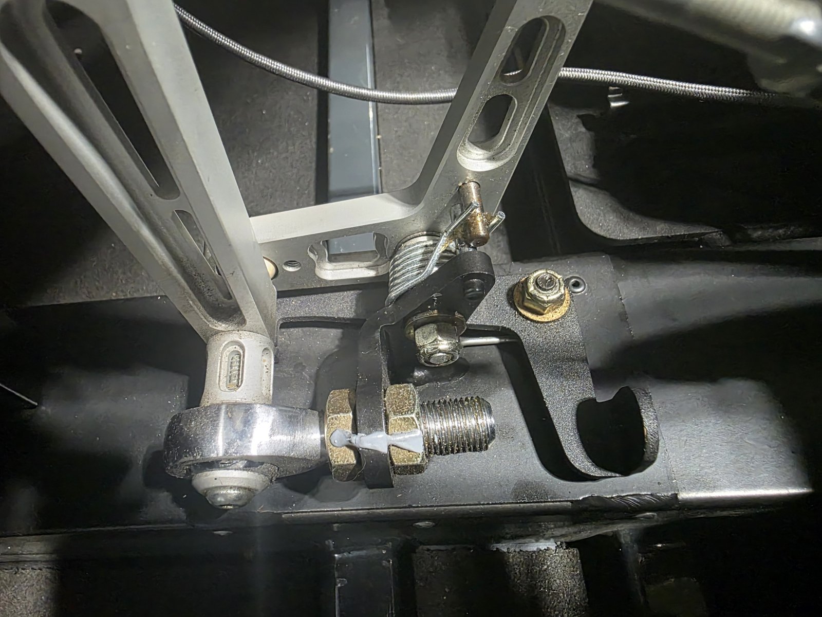

-This DF shifter is either garbage (not the general consensus) , mine isnt set up right or I did something wrong because mine stays in nuetral left and nuetral right without returning. Can someone snap me a Pic of what that spiral spring looks like installed? Forward and back is crisp, but that left to right is wonky. I wonder if my shifter is clear on the trans... hmmmm

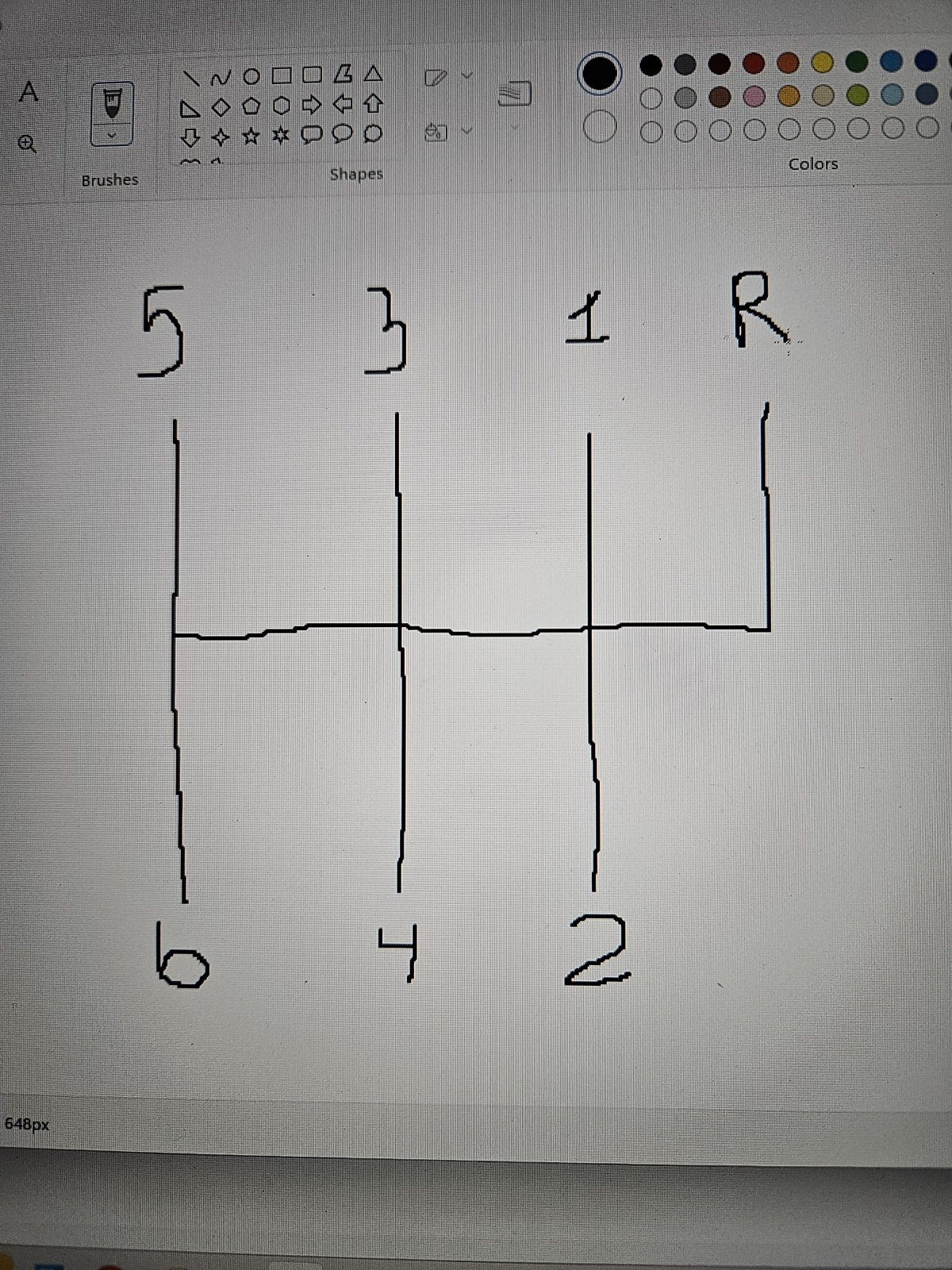

-this mirrored shift pattern, not bad, but this finding 1st is very difficult without some sort of Reverse lockout on the F40. Either I need to figure out how to get that RSX shifter setup or fab up something to stop me at limit in nuetral before I get to reverse.

Congrats on the first drive! When you say the shift pattern is mirrored, describe which gear is where in the double H pattern?

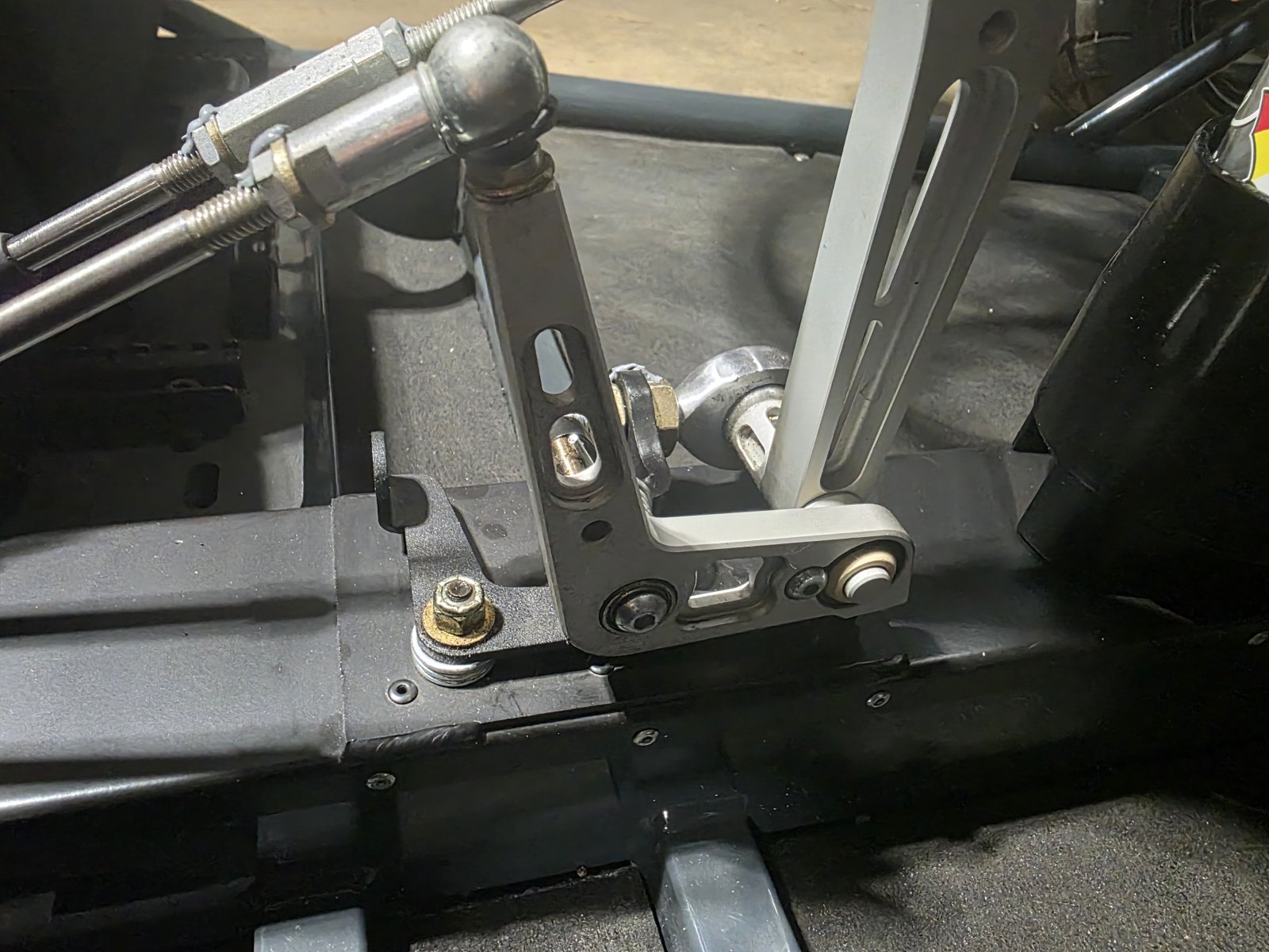

Shifter/Spring pics. My shifter is crisp and returns w/o issue.

They look the same to me. I followed instructions. That spring in the middle. When I move to one side and it opens that spring, the spring doesnt always push back. I will have to have a second look this weekend. Thank you for the pictures.
Its been a while since I assembled the shifter so I dont remember all the steps but this nut on mine is into the lock portion of the nut but not tightened down tight. I wonder if you have it cranked down and its binding it up.
Mahkoi
I will check that tomorrow. Its a good possibility as ai didnt know that was a possibility.
Well, now you have me rethinking things. I just rewatched parts of the shifter install video and Lonnie's soothing voice doesn't mention to snug that one and back it off like he does for the reverse lockout. Come to find out mine had just loosened up from the past 3 seasons. I tightened it down and it still returns to center just fine. So my guess about it being too tight is wrong.

I wish I had more experience to draw from on your shift pattern, that is most peculiar!................... A quick check, side to side motion makes the shift shaft plunger go up and down on the trans(which chooses a row), front to back throws the big counterweight swing thing(chooses a gear). Swapped cables would give a really strange(but oddly functional) shift pattern, installing the shifter(turned 180*, front in the back) would give similar strange function/results....... Strangely if both cables are hooked up on both ends I imagine you will have "shift action" of some kind!............ I'm really curious about how all this concludes!..........(Caution: TMI ahead!) I crafted my own shifter out of a Cavalier shifter inspired by the design of the 2nd and 3rd gen Toyota MR2 shifter. The shift handle's pivot ball is nearly on the floor, the rod that stuck down I hacked off at the ball. The Gear select cable mount is now on the shift handle above the ball the same distance it hung below the ball. The Row selector "L" shaped lever that originally hung down, I cut it off below it's pivot point and welded it back on directly above that pivot point. Made it into an actual "L". I think this is my fifth design, AND it seems to work, so there is that.
If you look at Mahkoi's pictures, my cable for left to right needs to be on the bottom of the pivot, not the top. Then I would have a traditional pattern, I think.
I just need to go reread how Sqwatch did his shifter and see how all the group buy guys connected theirs, which ends and what not.
From my discussion points made a while back about the shifter for the F40, the key point is the side-to-side cable movement needs the cable to move forward when pulling the lever to the left (toward your knee) to get the correct R, 1-2, 3-4, 5-6 H pattern. The DF shifter set up in your photo moves the side-to-side cable rearward with the up/down pivot on the RH side. If the shifter assembly mounting was turned around 180 degrees with the up/down pivot on the LH side of tge shifter assy the side-to-side cable motion would be correct.
