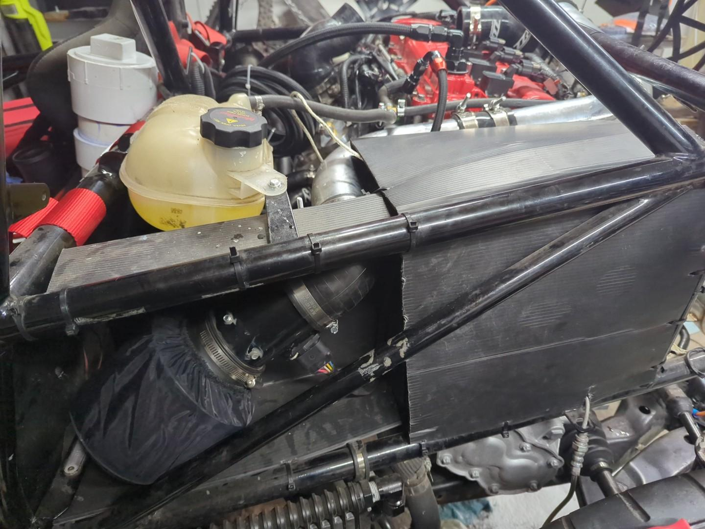

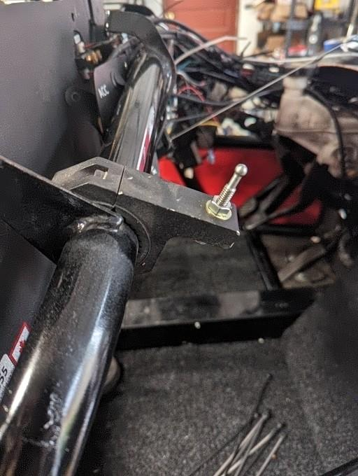

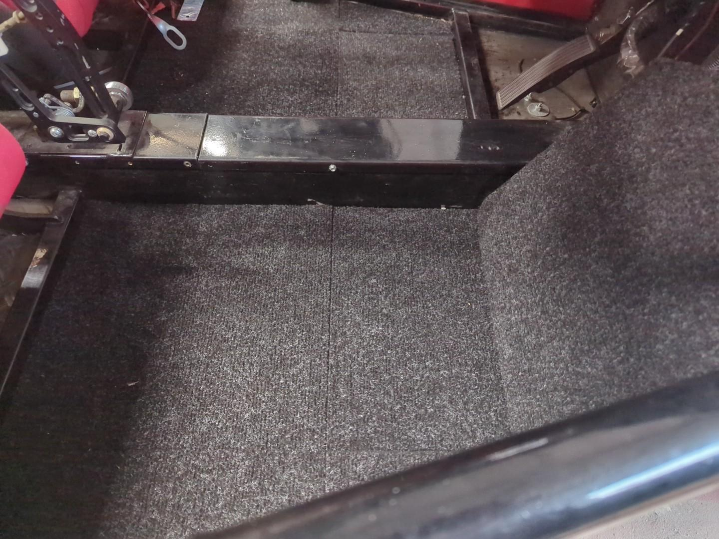

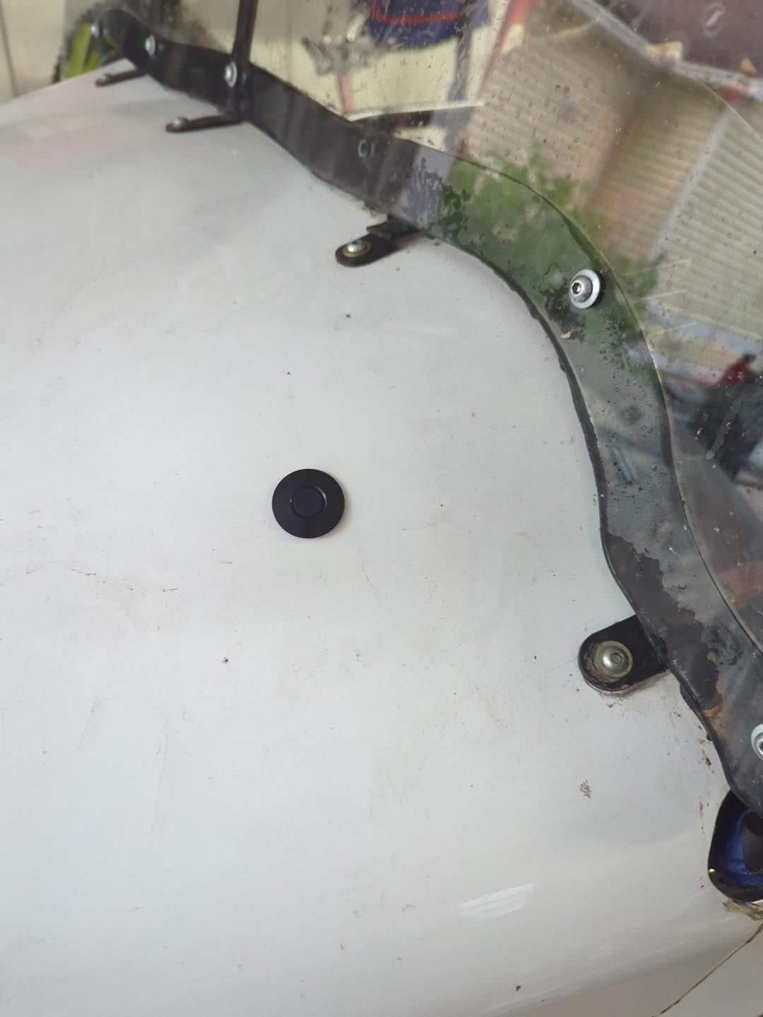

Well I decided to try to salvage what I have and just send it. Today I got a lot done.
  • Got an adapter setup to make the intake N/A if needed
  • Put push buttons down to affix my hinge hood (finally!)
  • Added an oil pressure sensor to the turbo (will test idling tomorrow)
  • Installed peel and stick carpet from Home Depot on the floor, cheap and turned out really nice
  • Put in 2027 SFI belts
  • Did some mild waterproofing of the fusebox area
Tomorrow I plan on finishing up redoing the e-track in my trailer and packing. I painted the whole interior and added a solar panel earlier this summer, but I haven't shown it here yet. Really happy how it turned out!

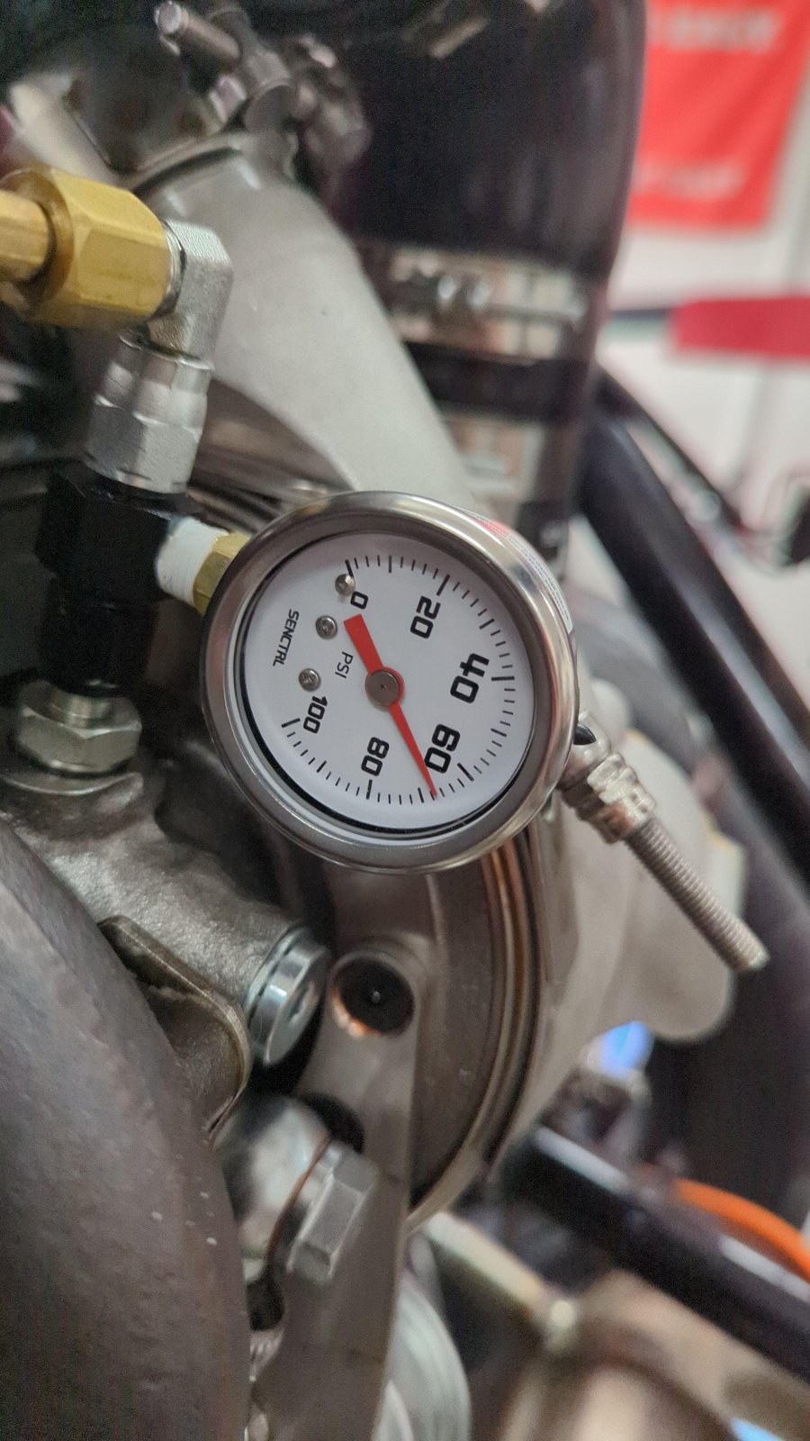

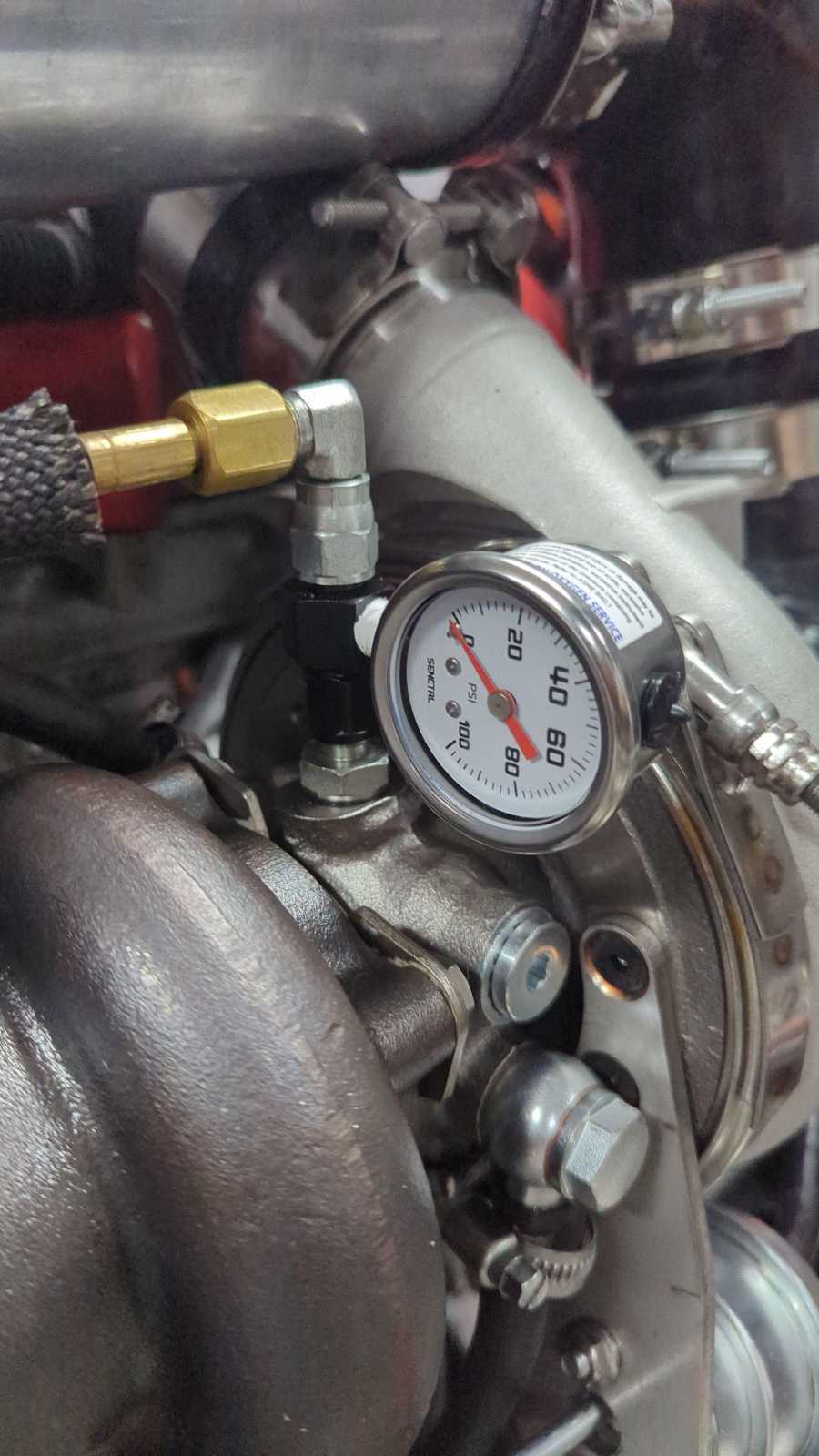

70psi at the turbo oil feed on cold start. I'll try with both restrictors after lunch to see if there's a difference
I didn’t check cold idle yesterday, but I was definitely getting 70+ psi at Hwy speed at full temp yesterday. Measured at the factory oil pressure switch location.
Joebob
60psi at the turbo with 0.035" restrictor (before the gauge). I just think bad turbo at this point

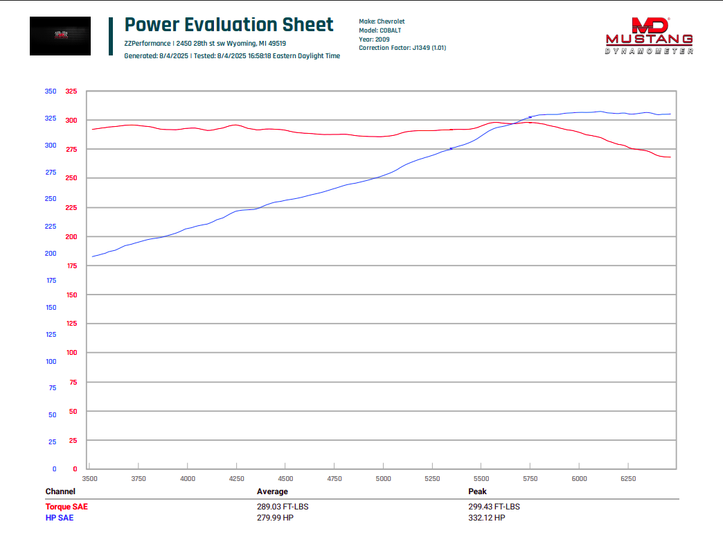

ZZP said they put a new center section on the turbo and its now working. Its on the dyno as we speak and I should be able to pick it up by 5. Serious props to them for squeezing me in last minute. Not a lot of companies would do that.
