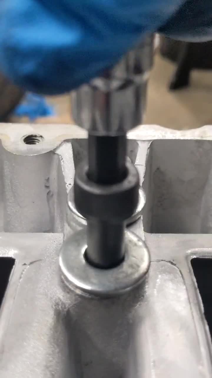

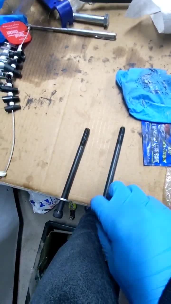

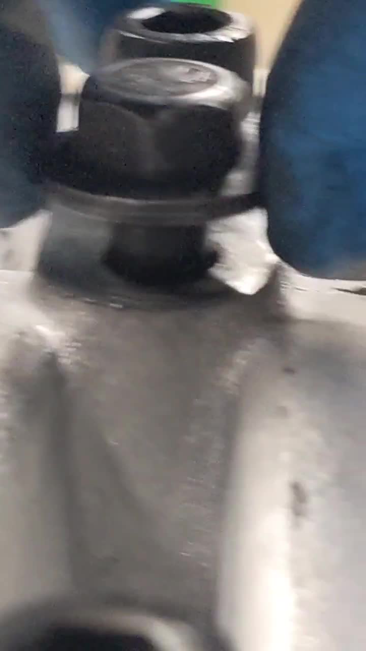

Update on the main bolts... here is some video showing what's going on.
@Desert Sasqwatch I will be contacting OTTP to see what they think of the whole ordeal. One of the bolts has a cracked head too. I had heard bad things about OTTP, but I guess this is what I get for cheaping out and not getting the ARPs.

Gotta learn the hard way I guess. I'm going to see if they'll replace the two I'm having trouble with, or if they'll just take them all back. ZZP doesn't sell the ARP main studs, and I can't find the stock ones on Rock Auto. OTTP does sell the ARP's but how they handle this situation will determine what I do regarding that. I really just wanted reusable ones so I can measure bearing clearances without having to use a new set of TTY bolts the second time.

Couple updates. Talked to OTTP and it sounds like they're going to take care of my main bolt issue. Gotta call again tomorrow.

OTTP's going to ship me 3 replacement bolts (2 bent, one head cracked). Hopefully they get to me by the weekend so I can start getting this thing assembled!

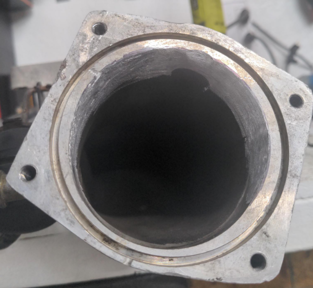

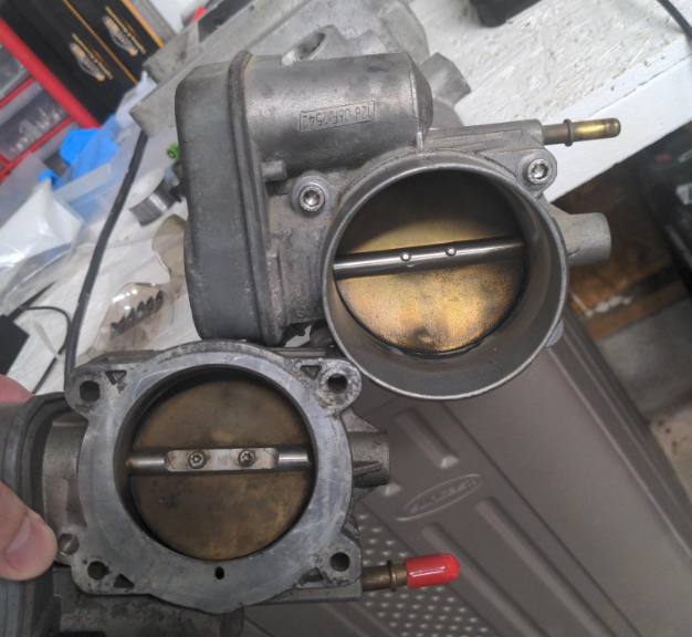

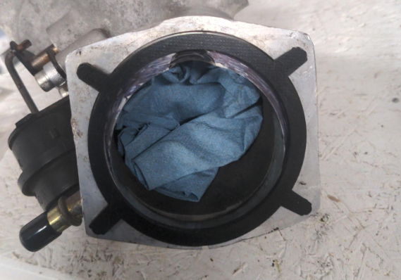

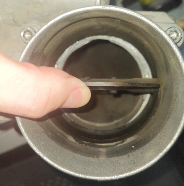

In the mean time, I snagged an LS4 TB for $25 bucks. I had to do a shitty port of my M62 inlet to get the butterfly to fit in the inlet. I 3D printed a little adapter doo-dad thats the size of the LS4 TB so I could stencil out the area I needed to grind off. It looks like **** but its fairly smooth. Good enough for me anyway, and the butterfly fits! Glad I didn't try to port my head myself. Not easy! I don't think I'll be trying the "Christmas Tree Port" myself.
Stencil:
39375
LS4 vs LSJ TB
39376
Shitty port:
39377
39378

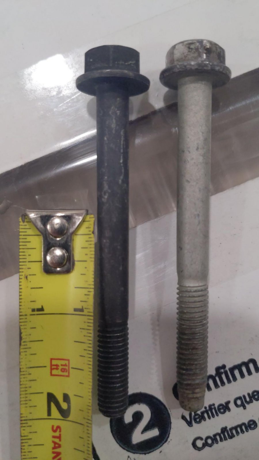

@snirtman I don't think the 10 girdle bolts GM# 11588733 is right. The RockAuto description says 0.9" of thread. Here is a picture with one of the actual bolts (right) and with one that I tried to replace it with that's grade 10 (left). The grade 10 doesn't have enough thread. The one you listed also looks like it would be around the same size. Where did you find the part number?

A couple of OEM parts websites call out the part number, but neither calls out the length:
1. GM Parts Direct shows only a generic image of a bolt
2. GM Parts Giant shows an actual bolt
A listing on Amazon says its a M8 x 1.25 x 80.8., same as Rock Auto, and both picture a bolt that appears to be the same as the GM Parts Giant bolt.
However a listing on Crate Engine Depot says its M8 x 1.25 x 90.5, with 21.6mm of thread, so not sure what to make of that.
Hope that helps?

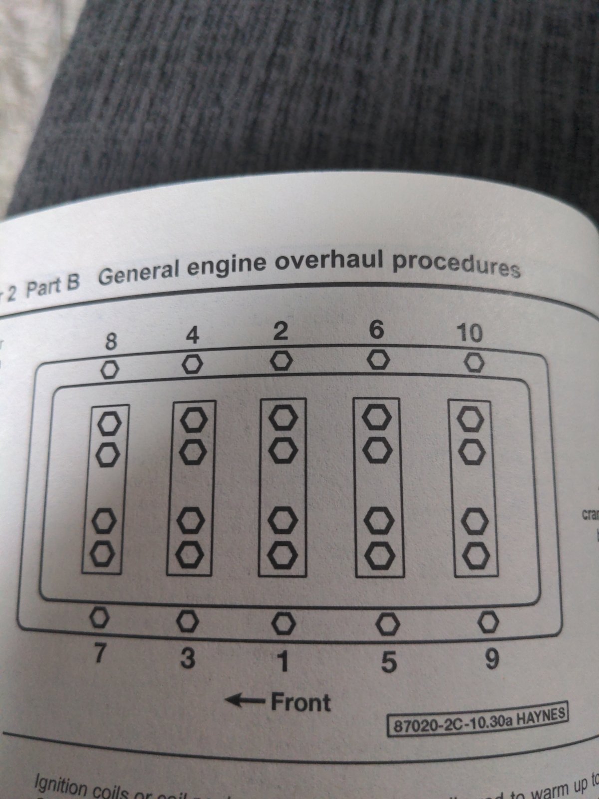

You guys think there's any reason I can't use some grade 8 all thread bolts? Being all thread shouldn't mess with the TTY aspect should it? Its only like 20 ft lbs plus 70 degrees or something
You are asking if you can replace the Engine Crankshaft Main Bearing Cap Bolts with grade 8 all thread bolts?
The Engine Crankshaft Main Bearing Cap Bolts is not one area I would cut corners.
Can you even find all thread bolts in grade 8? Grade 8 is standard, and your engine is metric.
There are several grades of bolts but the three common grades for SAE are 2, 5 and 8.
The common class (grades) for metric are 5.8, 8.8, 10.9 and 12.9.
Which bolts are we talking about at this point? If they are true TTY on something that needs a particular clamping load, the only way to obtain that particular load is to use bolts of the correct material and have the correct diameter over a particular length. These can be different from one companies design to the next, but hopefully they are actually designing them, and just not selling bolts that “fit”.
Typically, a true TTY bolt will have a reduced section above the threads to control the stretch of the bolts. If the proper stretch isn’t obtained, the bolts will fatigue and fall.
I probably should add the above is true where a cyclic load is applied, in tension, such as head bolts, main cap bolts, etc. The huge number of times these loads are applied and released, makes preventing fatigue critical.
jirwin
Sorry, just the 10 outer main girdle bolts. Not the 20 "main cap" bolts. The ones numbered in the attached picture. @Ross I didn't know there was a difference, but yes Grade 8.8 is what I sourced. I don't think these outer ones are as important as the inners. The outer ones I was having trouble sourcing as you can read. The partial thread 8.8s I sourced don't have enough thread. The full threads today do (though they are not flanged, but I have a washer). The GM part number that @snirtman provided I'm skeptical of based off of RockAutos description, which is the only reason I'm even considering going this route.
@Gtstorey yeah, being full thread and not having any "reduced section" is what worries me. I just looked up the torque spec again and its only 18ft lbs, no extra degrees after. Probably not a concern?
