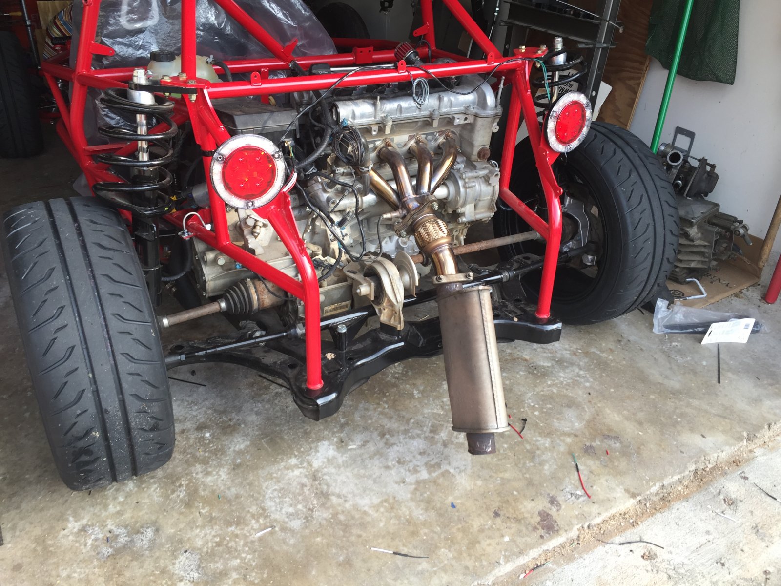

Well I'm one step away from cutting out the turn signal stalk and hard wiring everything. My stupid BCM is not allowing the turn signals to work. I have tried adding resistors (since the lights are now all LED) and I've replaced the turn signal stalk. I know the wiring works because I can apply voltage directly to the wires and turn signals light up on front and back.
The one thing that might be the missing link is I have no idea where my hazard light switch is or what it plugged into. The blinkers should work regardless of the hazard switch but Im just wondering if maybe its an open circuit with no switch or something.

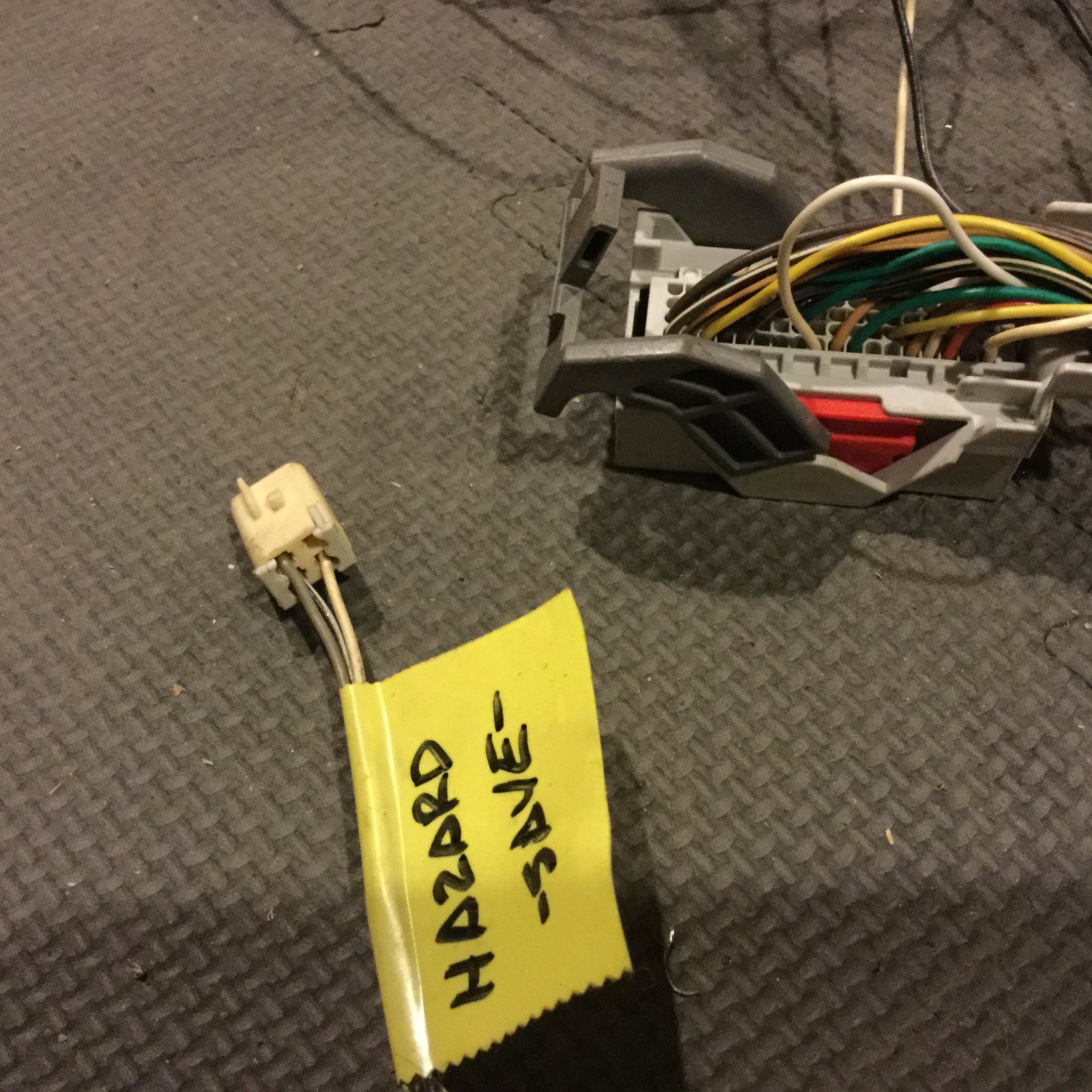

BAR-AIR
Here is a photo of the Hazard connector three wires black/white stripe -ground, grey wire runs to the instrument cluster connector -should be the back lighting and the white wire runs to the blue connector on the BCM as shown.
JSATX
Ugh. I dont have that. Those are the same color wires running into the plug on the turn signal stalk though.

The arrows don't flash. But I have found a way to mess with the turn signal stalk and have the signals flash. When the signals flash the arrows on the dash flash as well. So I know it's talking. It's very difficult to explain I sent a quick video to Adam because I just didn't know how to put it in words. I thought for sure it was a resistance issue but I went out and bought LED resistors and that didn't help. Next I hooked up incandescent bulbs thinking it still might be a resistance issue but that didn't help either.
I really need to get the service manual. But Its just so hard to spend $300 On it.

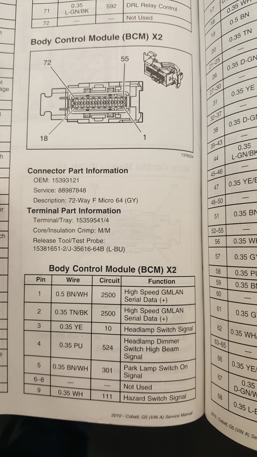

From what I read your BCM may be bad. Do you know if it worked in your donor?
Hazards ON is pin 9 of the X2 BCM plug to ground. It is a white wire. It is in the plug that is perpendicular to the red plug.

Thank you. I'll have to look into it when I get home.

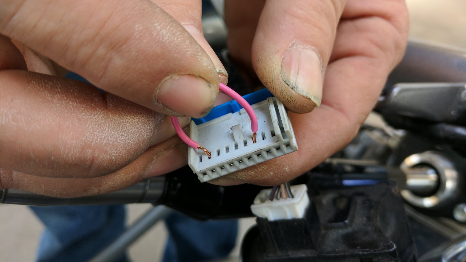

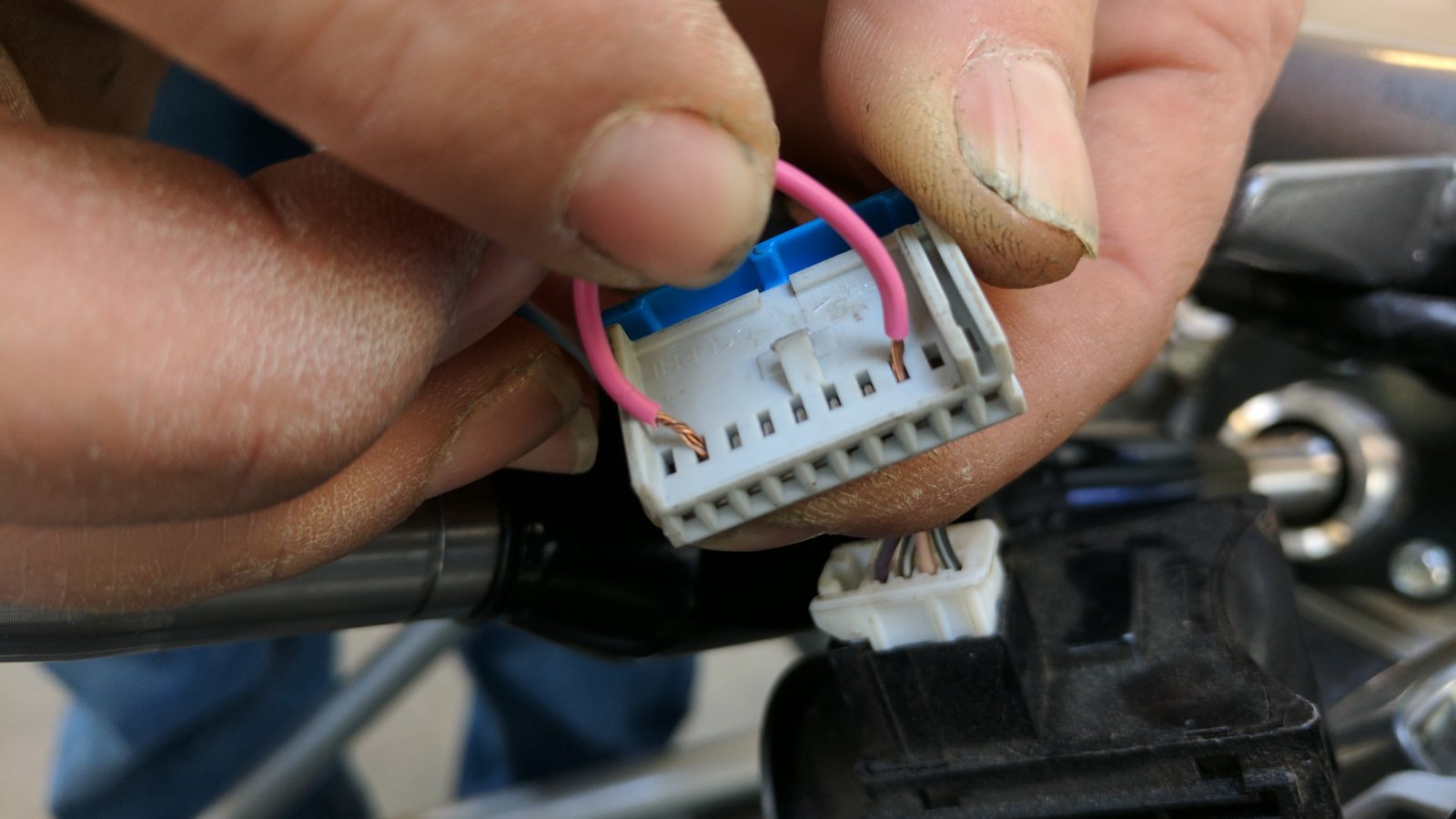

Do you know how the turn signal switch actually functions? I'd like to play around with bypassing it at the flat connector mentioned in your first picture this morning. It appears to be a pull down to ground signal switch. Am I reading that correctly?
We jumped the wide connector and got the turn signal to blink on the gauge panel:
Jumping left turn signal

Jumping right turn signal

So it turns out I had my hazard wires bundled up and taped off. I ended up finding the hazard switch and plugging it in. The hazards work! And both arrows illuminate on the dash as expected. I thought for sure this would some how fix the blinkers but nope.

Also I do not have parking lights or Hi beams wired up. Is there any chance it thinks the bulbs are all burned out so won't turn the blinkers on? I read about something like that on one of the cobalt forums.
I did have them all hooked together into my headlight earlier and it didn't change anything. But that's before I found my hazard circuit

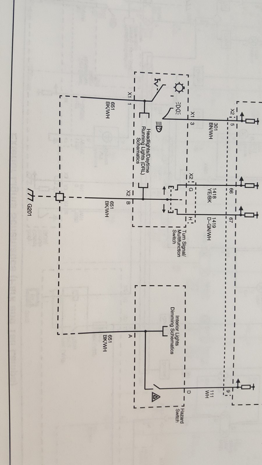

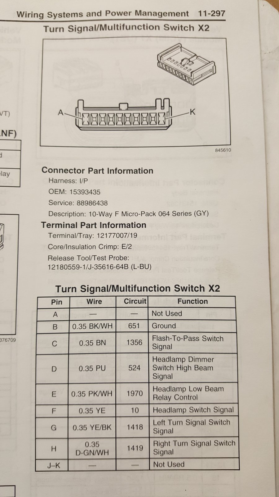

In that second picture from the manual where you note pin 9 is hazards, do you know which pin is turn signals?
The goblin we are testing on is only up to first stage. We have not hooked up any lights of any type yet.
The turn signal only works when the key is on.
The only way we know the turn signal is working is by the arrows on the cluster.
You should try jumping from pin g or h on the turn signal plug to the negative post of your battery. This will eliminate a possible ground issues.
