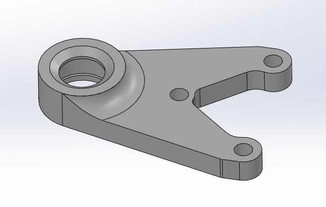

is it possible to have them as identical parts vs mirror image parts?
My suspension geometry is quite a bit different than the stock DF setup, and there is a left and a right.
The stock DF parts are identical. I can put some "stock" geometry models together that use the same FK bearing if you want.
Here's an image of a symmetrical mount that would have the equivalent geometry to the stock DF setup (same parts left and right), but uses a COM10 spherical bearing and cup. Custom spacers are required as well. The stock adapter piece that goes between the spring hat and the stock mount can be turned down and reused.

If these go into production, might consider trying to make the mountin holes slightly slotted or some way to add inserts to decrease rear camber. Or maybe just make the piece a little bit longer to since most of us have struggled to decrease camber enough and I don’t think anyone has had a problem getting enough camber.
On first thoughts I REALLY like the idea for adjustability. i am a huge fan of being able to tweak things for drivers' preference. however, on second thought is see some possible concerns for how quickly things can go awry. so, bear with me. . . we have 3 holes to slot in order to allow in and out adjustability. at the same time those holes are going to allow for quite a bit of rotational misalignment around any one of the bolt holes having more compressive torque than the others . . . just in assembly letting the tops of the struts be out of alignment forward or backward. under use because of the length of the "arm" (or plate/bracket) any forces sent up the strut are going to be magnified raising the potential for instant pothole induced misalignment. i think the ideas could sure work but we will have to account for how the heck we align things and the HUGE amount of clamping torque/ bare metal or surface finish between parts or i think we will be introducing a weaker link than say the existing top mount of the strut?

is the bottom of this plate square to bore of the bearing housing AND the bolt holes?
I am asking because the MR-1 is only a 3-axis mill and am thinking about the various operations. and re-fixturing that would be necessary if not. for the most part I think my machine is big enough to cut 4 of these at a time out of a single piece of billet (if we find said billet available) but to do the bearing cup counter bore we would have to flip the parts over and re-index on the machine. if the hole bores are not parallel that would be a third re-index and each case could be a source of rendering the parts unusable.
What kind of camber are most of you shooting for in the rear? What kind of ranges do you get out of the BC racing coilovers? I know they already have a slot for adjustment, but not sure what you can get out of them with all else being stock. Do you guys not like running the cam bolts for increasing camber adjustment range in the rear for some reason?
Yes, all of the hole axes are perpendicular to the top and bottom of the mount plate, so you would only have to do 2 machine setups.
Desired rear camber range is -0.5 degrees to -3 degrees.
The camber adjustment in the rear is the slots on the 2 bolts at the bottom of the shocks. Seems to work well without the need to slot the top of shock mount. Just my opinion and guess, as I have never played with slotted top mounts. Easy enough to enlongate the bottom slots, if wanted.

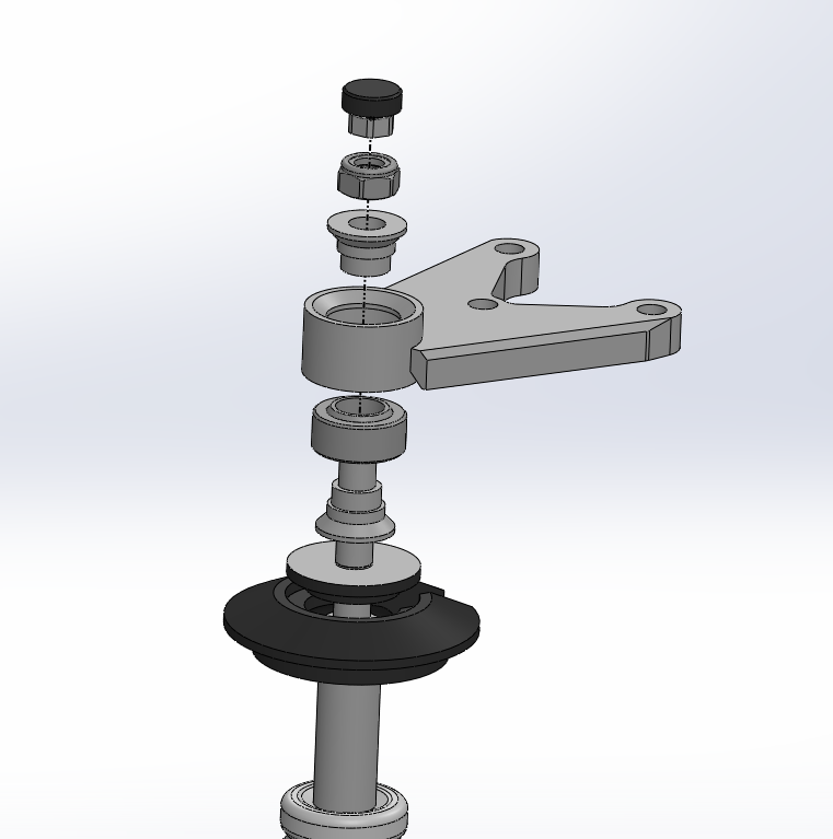

Are the clearance pieces to the ball joint (the ones above and below the bearing) standard parts or something you designed?
Also, do you think you could shoot LP the files so he can 3d print a sample for me to hold in my hand?
i am not sure my wording captured what i see in my head at the moment, please forgive me if this is the case.
I've been meaning to follow up on this one. I think you might be overestimating the precision that the mounts are located at as delivered. Just judging by how other portions of the frame have moved during welding, and the lack of precision of the lower subframe and tolerance stack up of everything involved, I would expect there could be over 0.25" of variance already. And I could see it possibly being twice that.
-OLDB1
I designed and manufactured those spacers for myself. I couldn't find anything off the shelf that would work in that location.
I can send him the files later this evening.

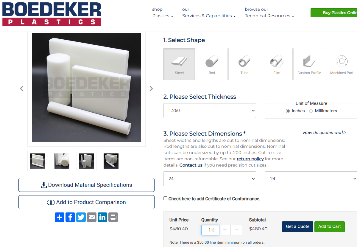

Based on the Pro-thane bushings as a representative example of what needs to be produced in Derlin. . . . I am currently shopping for (affordable) Derlin sheets/slabs in 1" inch to 1.25" thickness to bulk machine bushings out once the MR-1 is online. I figure cutting a dozen or so bushings (3 cars worth) at a time on the mill top down in a sheet would be a lot more effective use of my time than turning one at a time by hand on one of my manual lathes. . .
