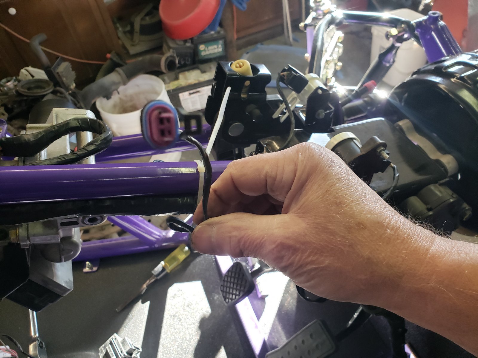

ok our 3rd issue today: anyone know what this little purple plug is on the wire harness? it comes out of the main part of the dash harness next to the group of grounding wires and has just about enough length to reach the clutch switch but you can see that is already plugged in.
speaking of the grounding wires. . . .our chassis did not have a grounding lug on the pedal support like it shows in the videos. is this normal? we adapted and overcame the issue by grinding some of the powder coating off around the power steering mount and bolting it down there. you can kind of see the loop of wire on the upper LEFT side of the picture.

Can you take a better photo of #2? Like a few photos and some backed up to see the whole area?
#3 Maybe the brake fluid level sensor? I’m not sure there since I have a LSJ with the old style brake and clutch stuff.
speaking of the grounding wires. . . .our chassis did not have a grounding lug on the pedal support like it shows in the videos. is this normal? we adapted and overcame the issue by grinding some of the powder coating off around the power steering mount and bolting it down there. you can kind of see the loop of wire on the upper right side of the picture.
Brake reservoir connector. It gets wrapped together with the accelerator pedal while thinning the harness.
Part 10 time stamp 6mins of the wiring harness videos on YouTube if you need anymore info

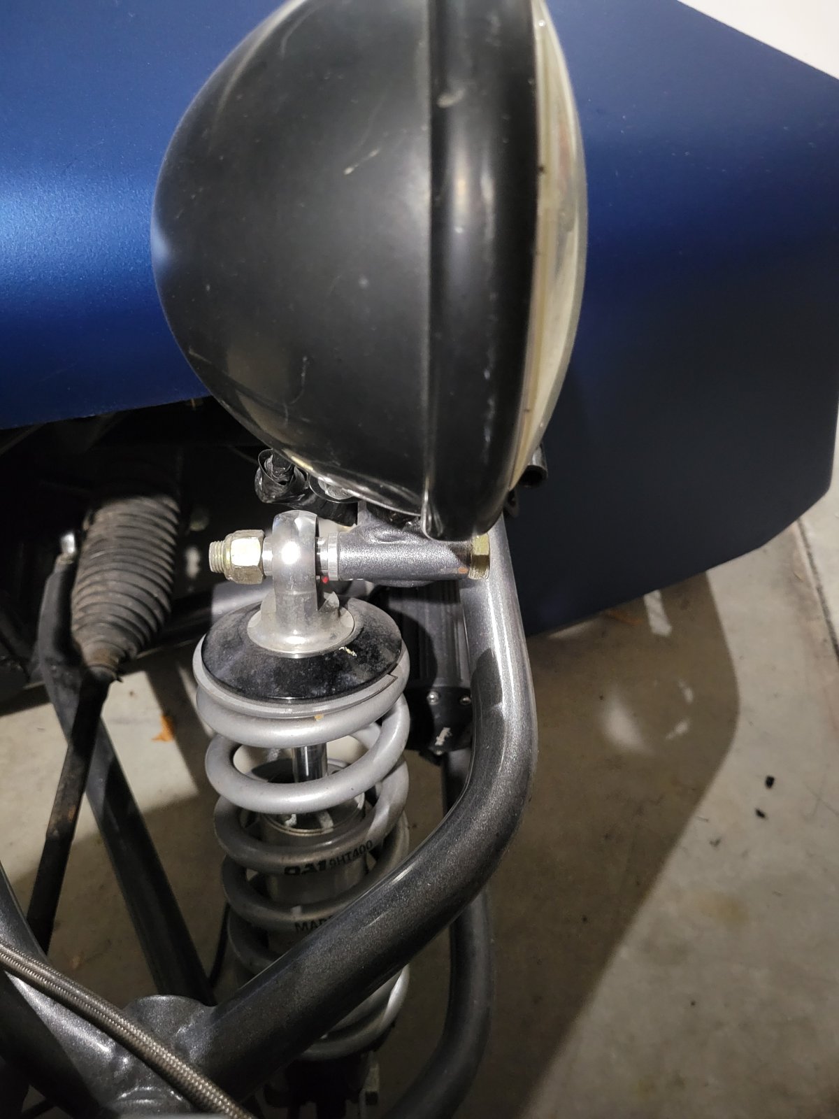

As to more photos- YES- i will but it may be a bit because I only work in the goblin shop on Wednesdays since it is about an hour away. the picture of the suspension is taken from out board on the passenger side looking down on the shock mount and the front bolt to the upper control arm.
The silver spacer should be on the other side between the shock eye and the mount bushing. A thin washer should go where the silver washer is to move the bolt head inward toward the rear. If there is still interference with the a-arm, a silver washer can be installed at the suspension mount bewteen the mount bushing and the heim joint to move the a-arm forward a bit to help make clearance (moving the a-arm mount forward a bit will not affect the suspension geometry).

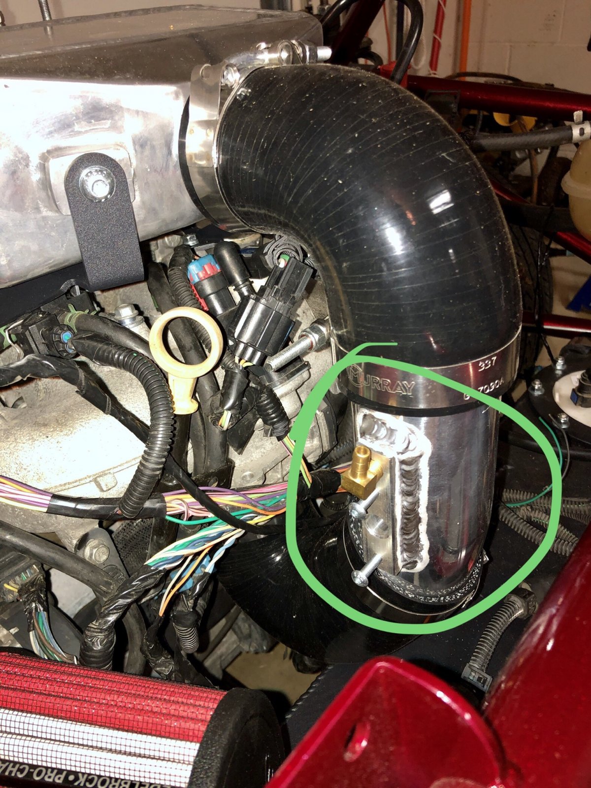

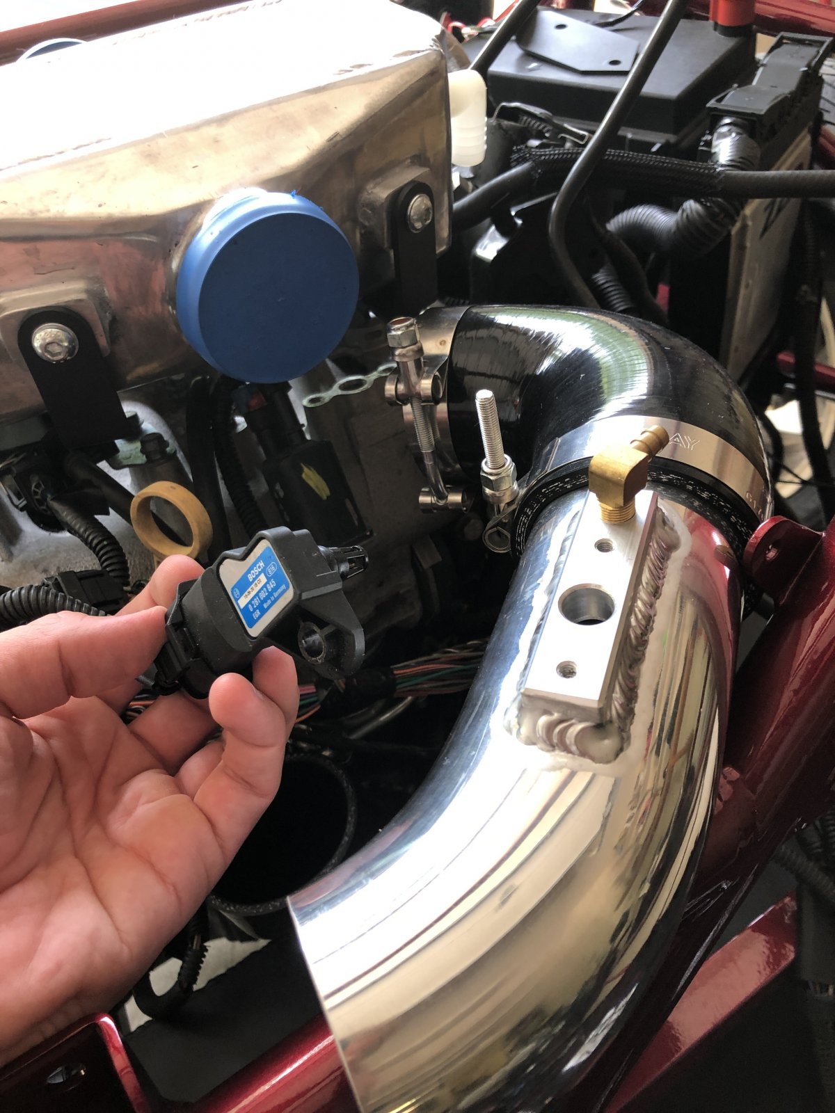

4. the entire charge pipe/turbo piping package. most importantly the MAP/MAF pipes- pics borrowed from Aaron Buley's build

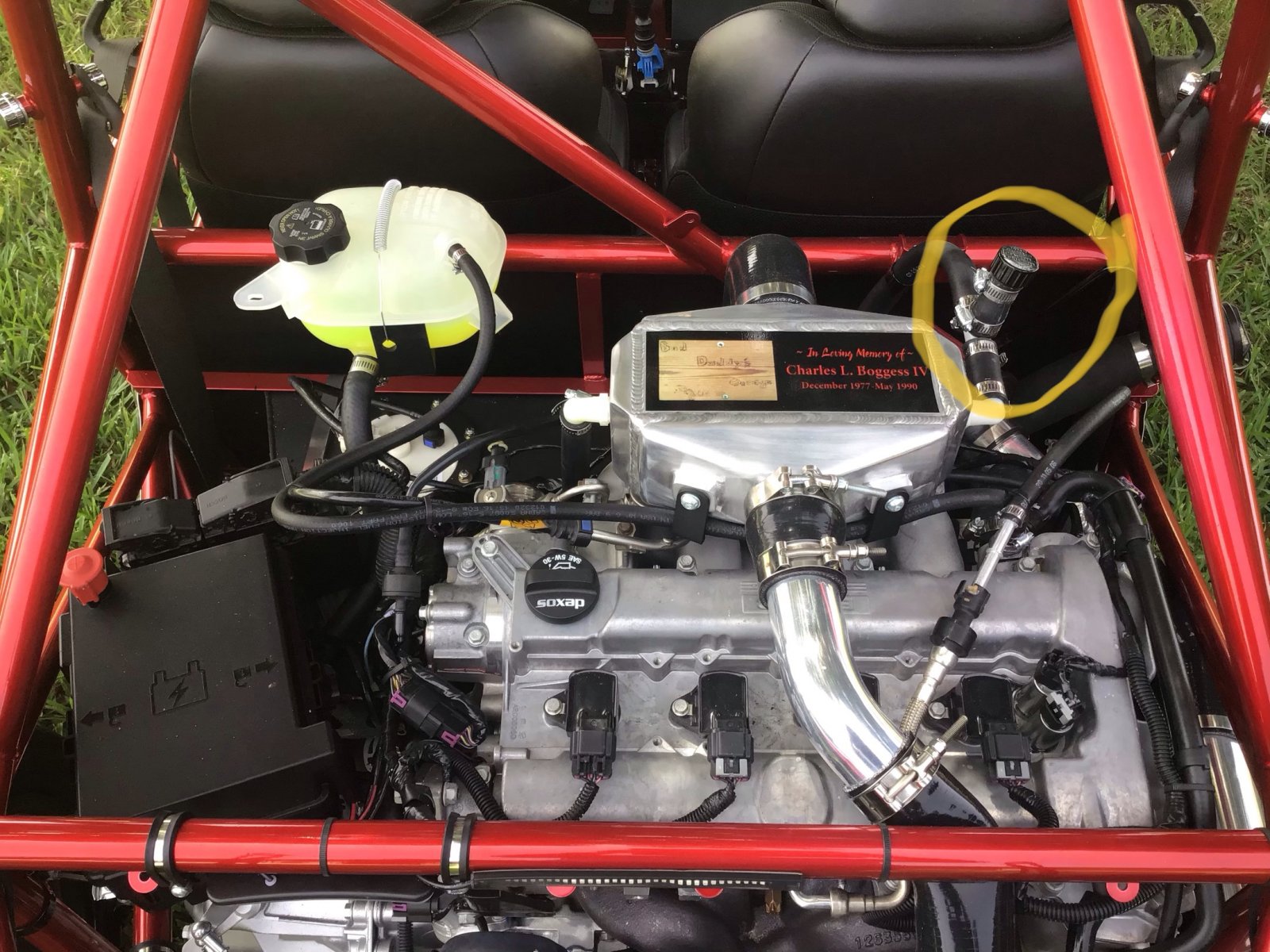

a question regarding the intercooler liquid plumping. . . somewhere i found a schematic but not on this computer presently. i believe this system is closed loop- is that correct? does it in any way tie into the radiator coolant overflow bottle? i found this picture of a T- with a flush fill cap -is that enough of a "reservoir"
46831
Sluggonaut
It is a separate circuit and would need its own reservoir if you want to use one - it's not required.
The only real benefit to the reservoir is in removing air from the circuit.
