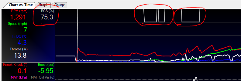

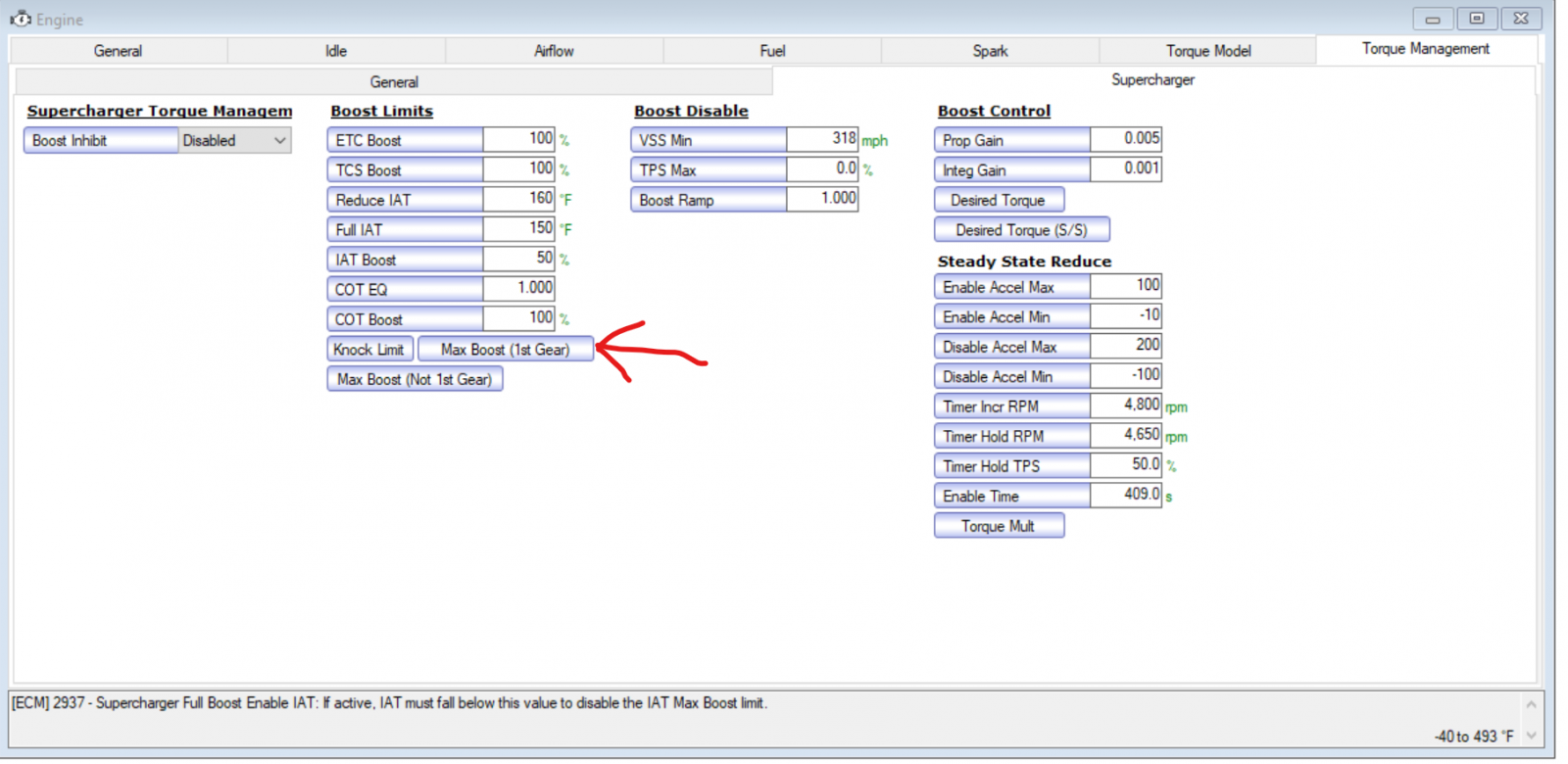

When it comes to low boost:
  • Your 1st gear boost limit is 75% and it's being handled by the engine correctly
Wait. What! I would love to know how to get 1st gear boost limit set to 75%
Please tell! I tried to do this for my tune.

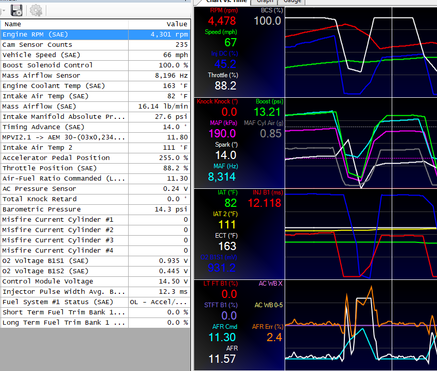

This is a screenshot of your data log:
35079

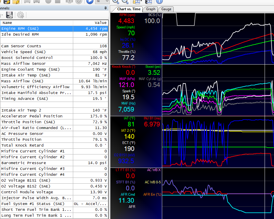

Here's a similar screenshot from a recent data log I did:
35080
I don't know what your foot was doing but it looks like there is a lot of bouncing in the throttle trace which comes from the accelerator position being all over the place. Your injector DC % and INJ B1 (ms) values are far lower than mine at that similar time and this is during open loop with AFR target of 11.3, yet your open loop fuel tables were essentially identical to mine. That must mean your air tables are off if it thought it only needed a small amount of fuel to hit 11.3.
