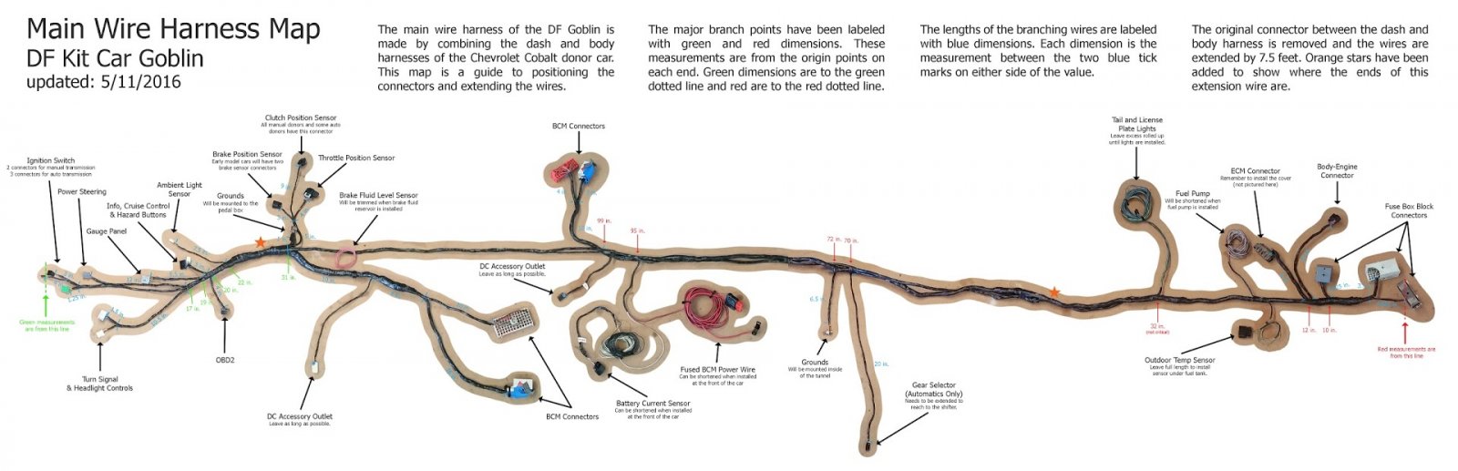

I found that picture today while searching for information. main-harness-with-labels-medium-big-labels.jpg
I think I will mount connectors in the car and run the wires that way. That should make it easier for me to understand the concepts rather than just cut here extend there instructions. I am used to reading wiring diagrams that way.
This map has some extra tiny measurements from the left side (BCM side), some from the ECM/PCM side, but the measurements don't meet in the middle, so I don't know the overall length. I just followed the video and mounted my fusebox a foot off the 4x8' plywood tabletop.

Awesome! Thank you!
I found that picture today while searching for information.View attachment 9478
I would plug the main connector between the dash harness and main harness in, mark and cut the remaining wires like the video shows. If you dont your just going to end up with everything plugged in but not even close to reaching the other end of the plug.
Also, use the measurements in the photo to make sure the red and white/blue BCM connectors are going to reach, I ended up having to cut a wire or two and extending them going to the BCM so the harness would reach the fuse block next to the engine and route through the tunnel correctly.

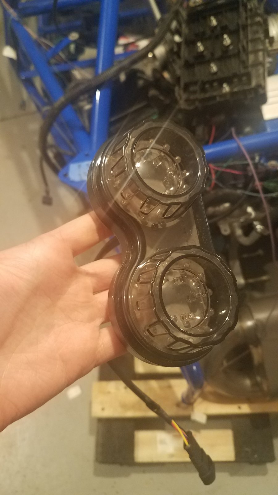

I am working on installing taillights and am having troubles.
What wires did you use for the brake lamps? I tried using the yellow (driver side) and dark green (passenger side) wires but these also flash with the turn signal and cause some odd problems with the headlights. Things like the front parking lamps flash with the blinker if the brake isn't pressed and strange things like that.
I am not using DF taillights and have read that I may have to add in a diode somewhere to prevent feedback on these cheaper type lights.
Any advise will be appreciated.

These are the lights I'm using.
I have the fuse box ripped apart looking for alternative brake light wires that only go on with the brakes.
I'll reassemble it all and document the exact symptoms.
It very well could be a ground issue. I only wired up one light for testing and didn't secure the ground permanently.
The headlights, blinkers, mirrors and parking lights work perfect without the brake wire plugged into the taillight.

There are no other alternative wires that im aware of that can be used for the brake lights. The brake lights use the same wire as the turn signals.
Now there is a dedicated wire that I forgot to mention for the third brake light, but that's not what you would want to use for the tail lights.
Make sure you're matching the correct wire colors from the Goblin harness to the tail light wires.
