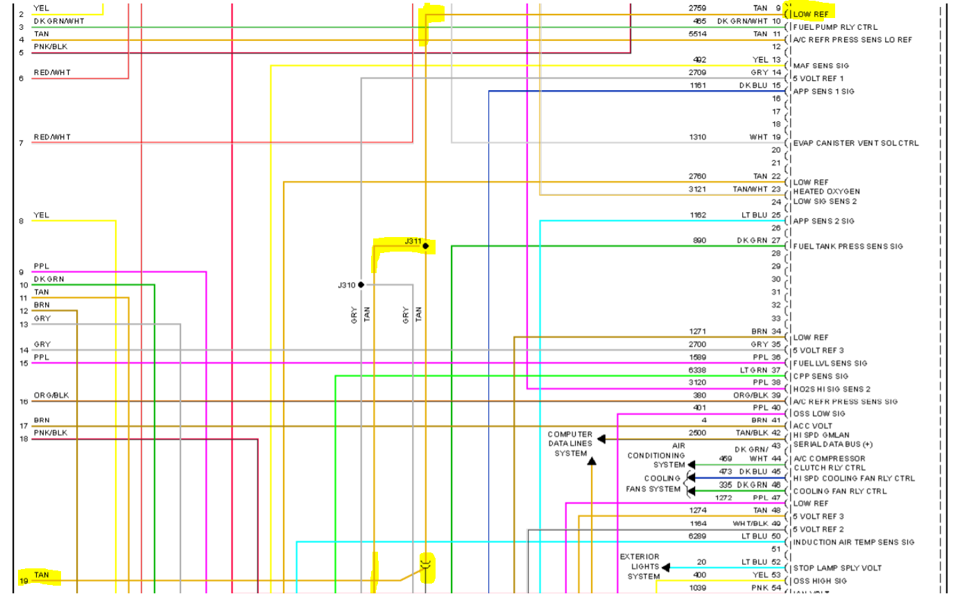

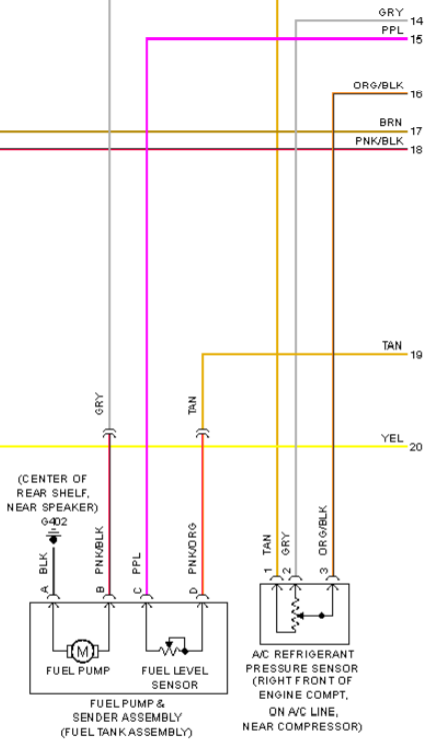

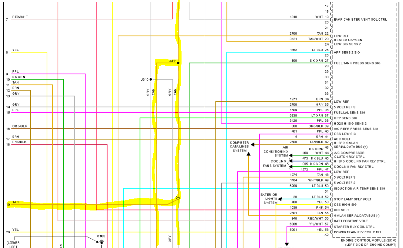

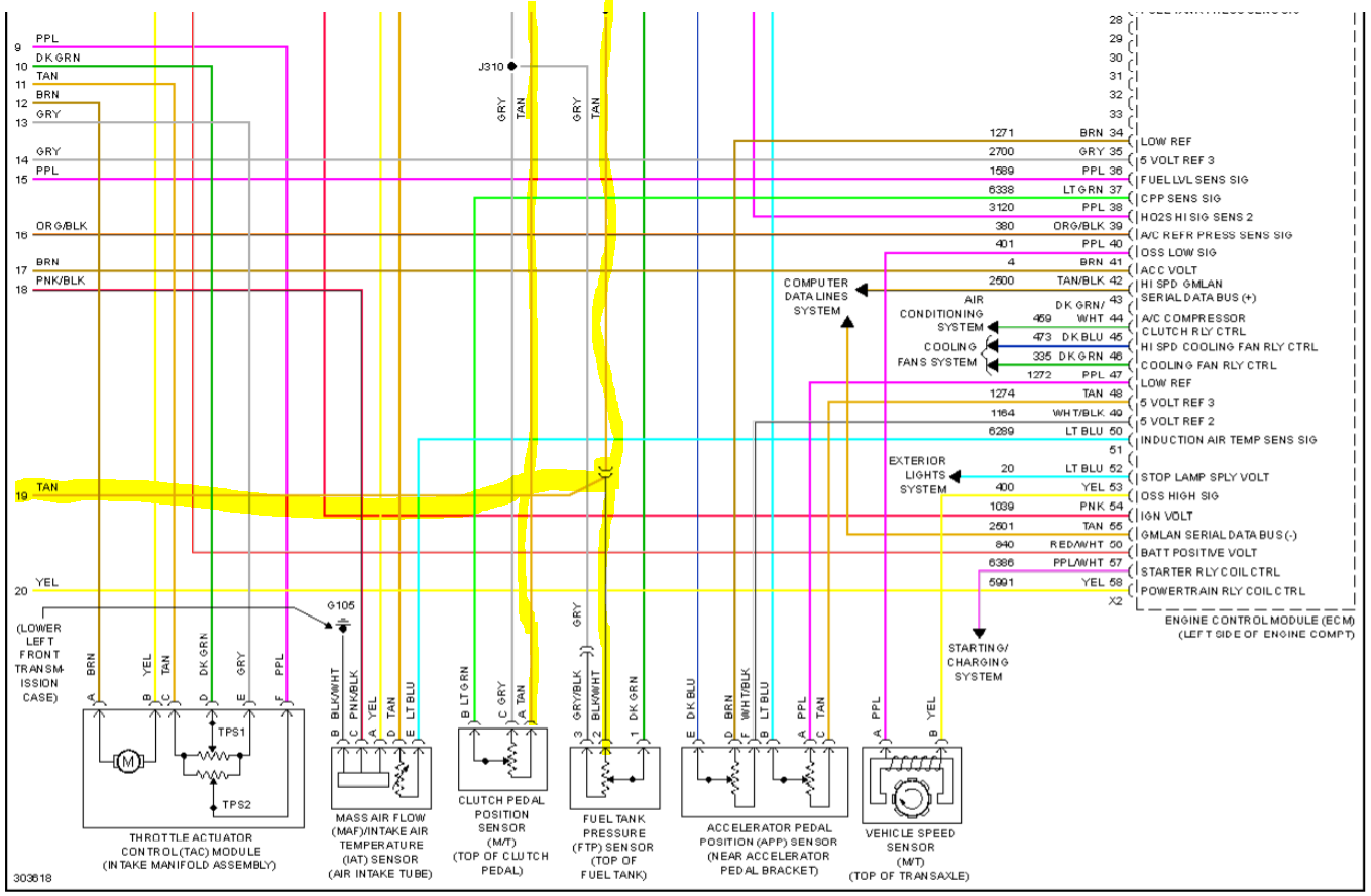

Background Info: When I got my donor, the clutch position sensor was throwing P0808 (voltage too high) as well as my fuel level sender giving P0463 (voltage too high). Both codes were there when I got the car, and both codes will not go away with my Tech2 DTC removal.
Both of these sensors share the same TAN wire... leads me to believe there's mischief afoot between their shared high voltage codes.
I've replaced my clutch position sensor with a brand new one, tried to clear the DTC so that I could do a clutch relearn, but it continues to show up immediately. Apparently, when you have a clutch DTC, Tech2 won't do the relearn until it's cleared.
There's something going on with that tan wire. I wonder if this is something up with the ECM since it was going on before I rewired the harness.
One of the screenshots has the tan wire going to a spot called "Low Ref".

The Low Ref is basically signal ground. This may not be the exact same as frame ground but a ground or "low" for the signal. As I was reading though this, I was thinking that you may not have the ground side of the pot for the clutch if you are measuring the source voltage (4.9v) all the time. It needs the "low" side to be able to go low, if that makes sense.
Mayor West
Good point! If Low Ref is a problem it would indeed cause issues for both sensors since both have the exact same high voltage DTC thrown and the tan wire is shared between Low Ref, Clutch, and Fuel Level.

First, I really don’t think that you have a bad ECM or anything. It’s most likely a wiring issue. Let’s keep it simple. I can’t see the diagrams hardly at all on my phone while at work so I can’t reference them, but ohm out between the clutch sensor LOW REF side and to the source of the LOW REF at the ECM/BCM it where ever it goes. You should read ideally 0 ohms but could measure 1-3 ohms. If you don’t get that, you need to figure that out before going any farther.
There are no fuses on the “grounds” or low sides.
