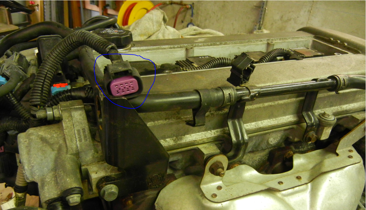

The reason our car didn't start the first time was it was not getting spark. It didn't take long to figure it out because I remember seeing the headlight harness uses the same plug as the coil pack harness. I was trying to light off my headlights instead of the fuel. Make sure you have the correct plug plugged into the coil pack. Use the wire colors as your guide.
Did I miss something here?
