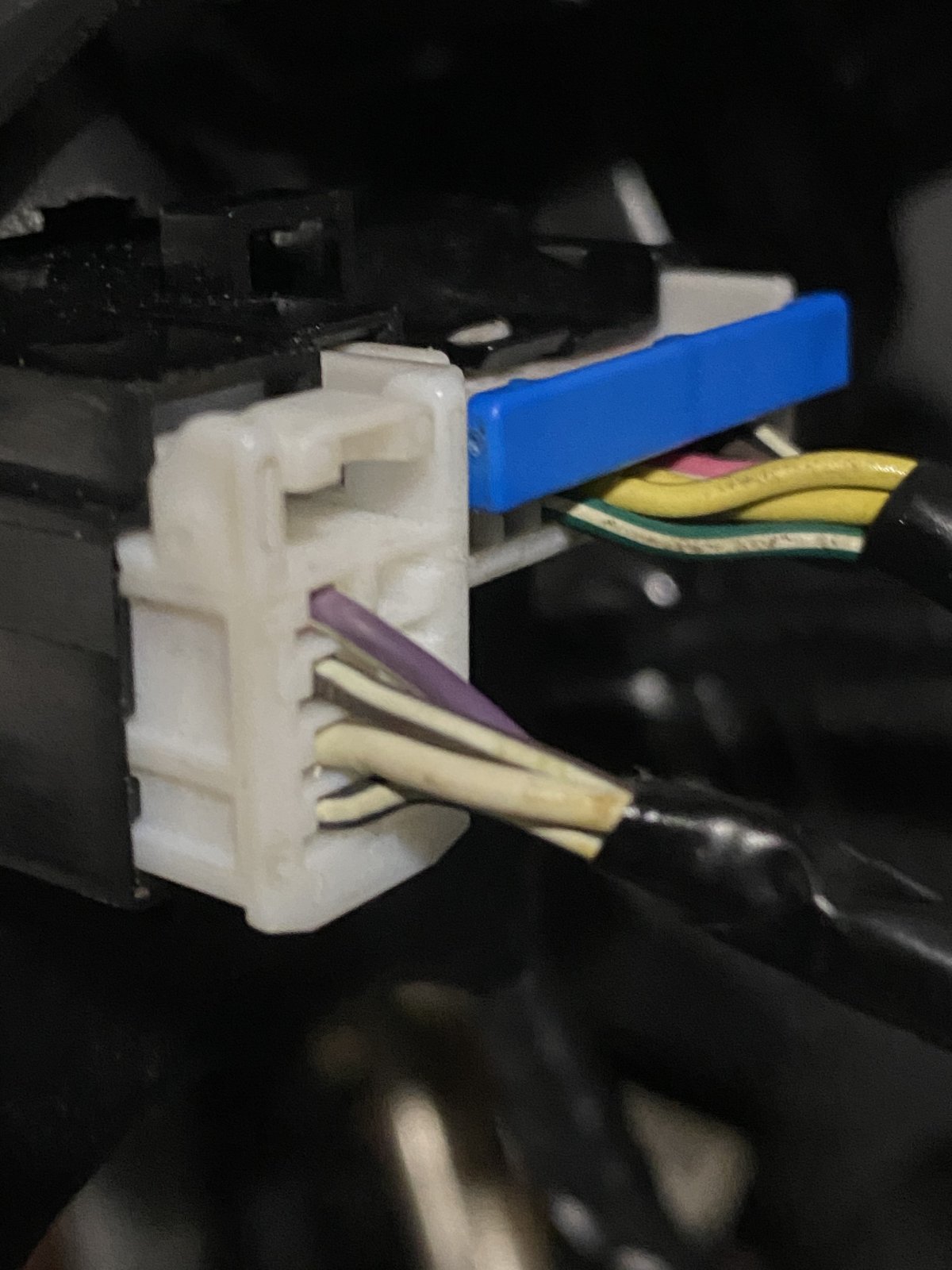

My focus now is on how my turn-signal light stalk only lets me turn the car on if it's not set to AUTO. Like, if it's set to AUTO, the whole BCM shuts down. I don't think data wires daisychain through the turn signal stalk, right?
Anyone else who did their own wiring run in to that issue? AUTO on my light stalk completely jacks up everything. I wonder if I messed up a wire and that's causing more issues down the line.
I've just test that if I plug in the white stalk harness but not the wide slim one, and keep it on non-auto, it lets me crank... so it's something with those 4 wires. Purple/White - Brown/White - White - Black/White. I'm looking through the wiring docs I have for their paths.

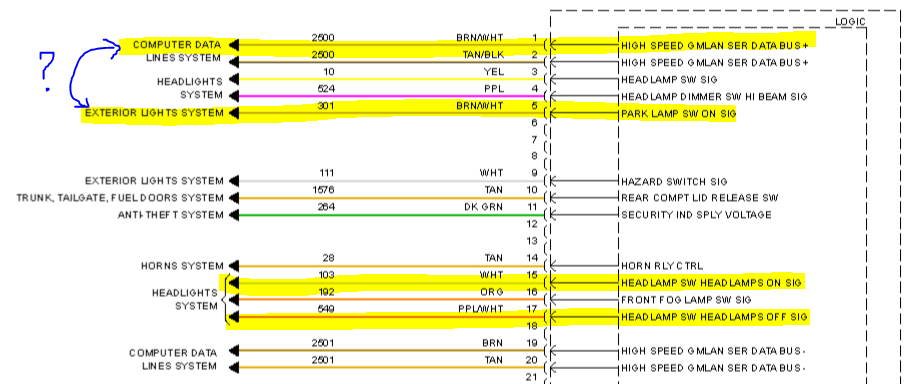

EDIT: Looking at this wiring diagram, there are two BCM wires that are brown/white... one goes to the light stalk and one is a GM data wire. I could have messed this up while doing my wiring... I need to pull this plug from the BCM and test continuiity between the turn signal stalk and both end points for the brown/white wires at the BCM.
Auto lights should not impact the car starting. There are no data wires that are going through the turn signal. I've been trying to track down a data issue on the instrument panel, so I know there's no data in the signal stalk. Test that continuity that you're highlighting in the diagram.

Okay, so I tracked all the wires from the turn signal stalk to their correct locations on the BCM X2 plug and the Fuse Box C2 multiplug. Every wire checks out and has continuity. This puts a damper on my initial assumption of the wiring job I did being incorrect (because my turn signal set to AUTO disables the car) which is sorta good because my wiring harness doesn't appear to be incorrect.
Right now I'm sort of at a loss for where to go in regard to the Turn Signal -> Auto Disabling issue. I'm going to focus on other things such as checking spark, fuel, etc...
