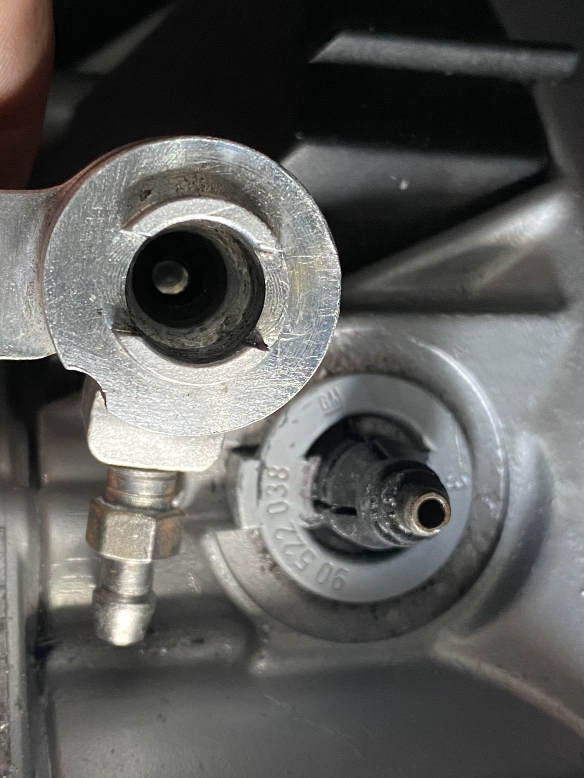

Check the top real well. Mine looked like it was leaking from internal, but it was at that elbow from the line to the slave. That goofy oring can be a pain. The oring needs to be on the slave side, line. Then the elbow goes on (if it’s the same as my supercharged model).
Mayor West
Yeah that's first on my list before removal because I'm fairly certain I tightened that slave side very well.
Okay so I can juggle the top fitting and see brake fluid around it so I'm thinking that's it. Sucks though because now I likely have a boat load of brake fluid all in my clutch.
Can anyone tell me if I'm missing anything here?

I grabbed the rubber fitting and it's still leaking out the bottom. I disconnected all the lines and am letting it all drip until it stops and I'll clean it then reattach and see if it begins leaking again or not.
Odd question: you do have the U looking clip for the elbow correct? And it’s in good shape? I had to “rework” mine to keep it all tight.
Mayor West
Yeah I made sure I had that. It's hooked up and appears to be tight but it was leaking a lot prior to fixing it (I pressed the clutch a lot out of excitement too) so I'm sure it was full of fluid so I'm hoping the dripping is from residual fluid in there and not new fluid.

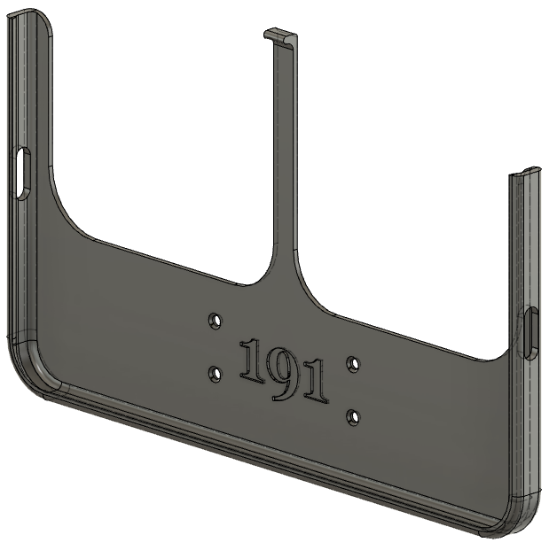

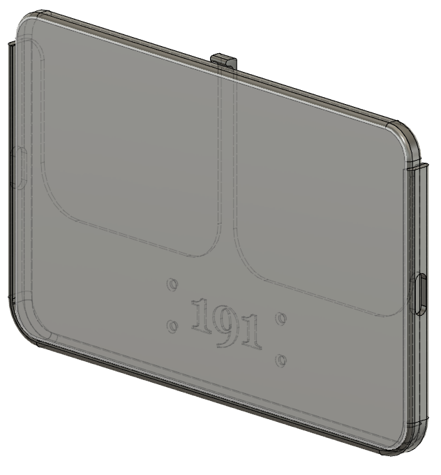

In other news, I've modeled up a tablet holder for my Samsung Galaxy Tab A to eventually use as a torquepro device. I'm printing my 4th test fit now and I expect this one to be the bee's knees. I'm glad plastic is cheap because I'm blowing through it printing full size tests, even at low quality. I'm not 100% sure where I'll mount it yet, but I've made a universal bracket attachment point to make it simple.

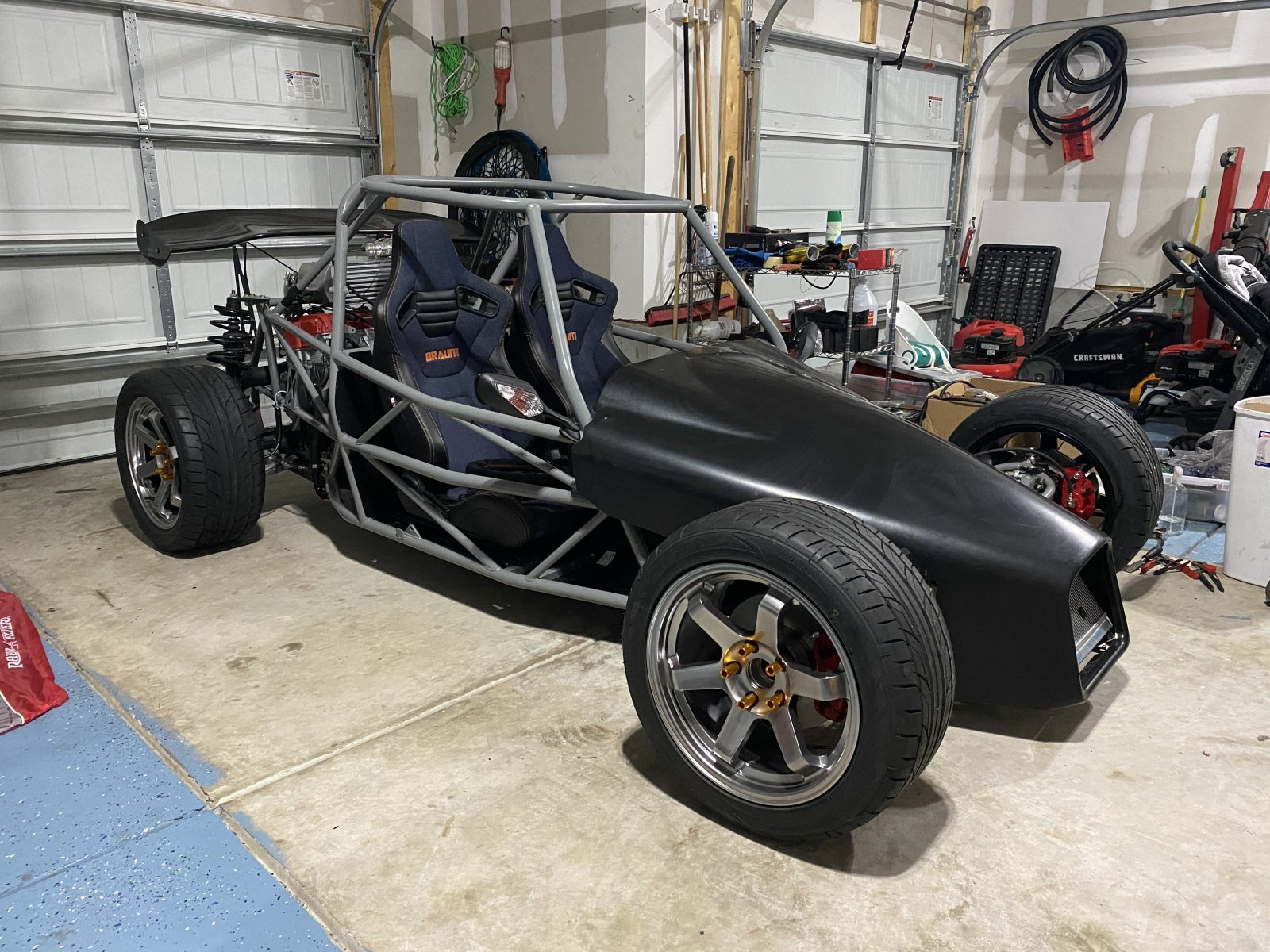

Maiden Voyage! Very happy to be at this point. I got into 2nd gear around the neighborhood. It's very loud in my garage but out in the open it's tame enough to not cause too much of a ruckus.
Very happy with it.
It's so small and intimate that close to the road. Can't wait to get it tuned, aligned, and running smooth.
Very happy with it.
Twice now I have sunglasses flew off my head and I had to turn around and go back to get them. Just drove up to them and reached over onto the ground to pick them up. Came in quite handy. It can be a bit intimidating at first.
When Kaleb took my dad (78 years old) out for the first ride, Kaleb came back complaining to me that "Grandpa kept tell me and motioning with his hand to slow down!" "I was doing 10MPH UNDER the speed limit!" :D
