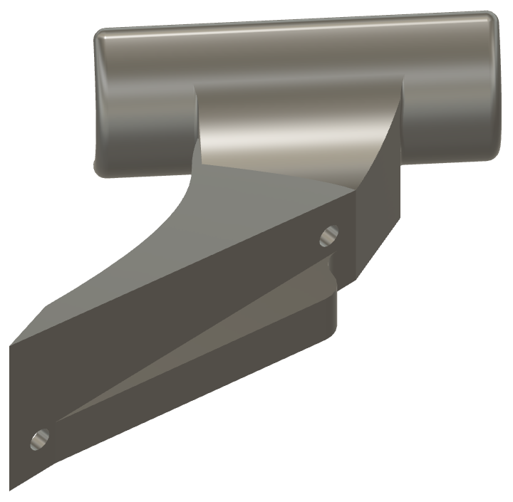

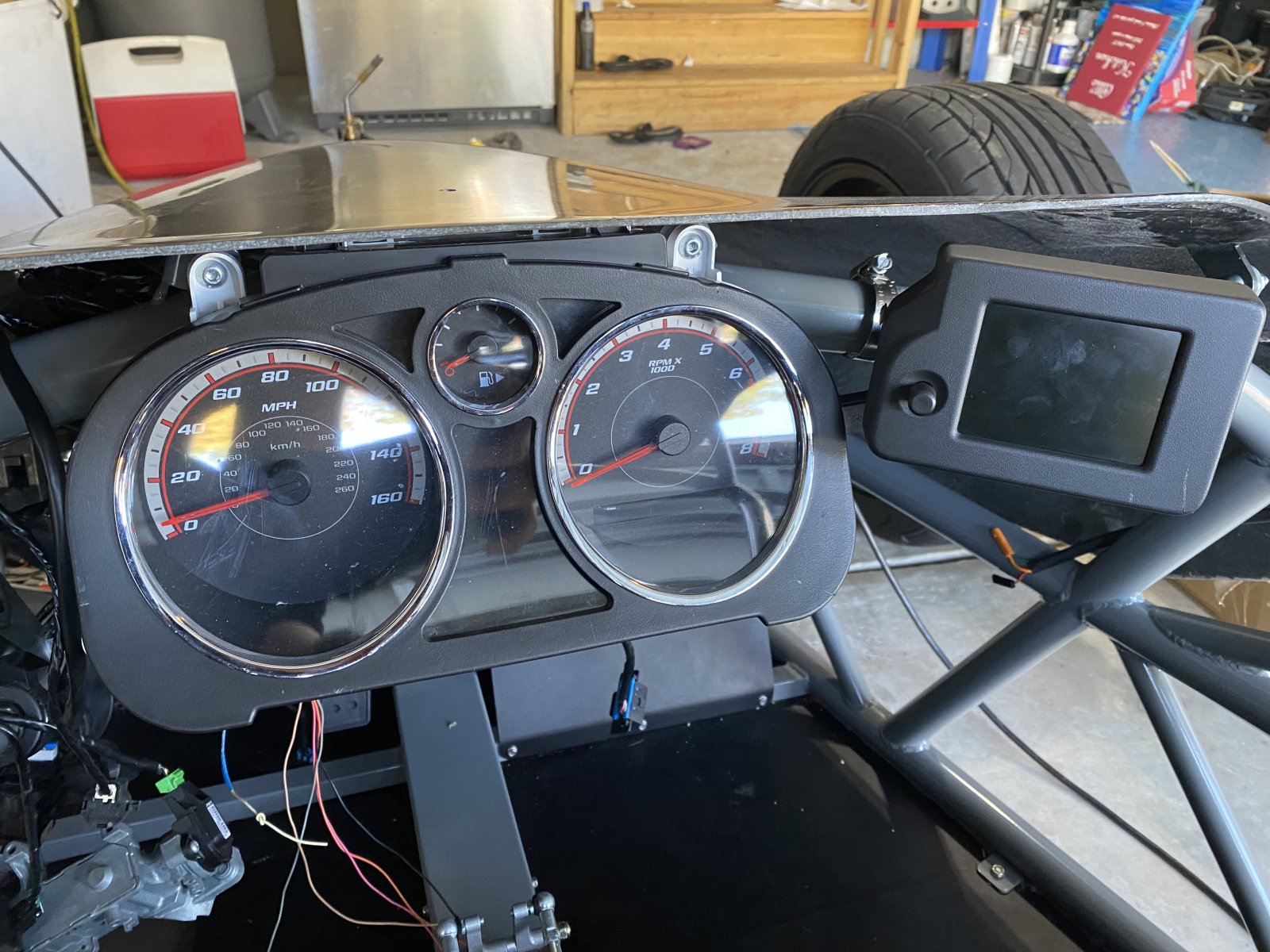

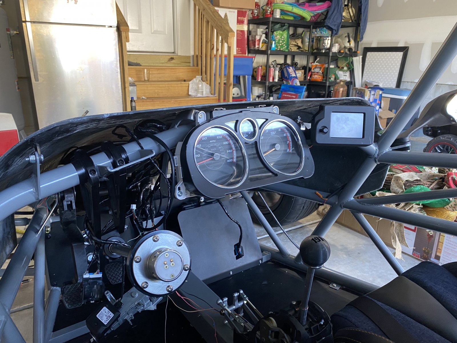

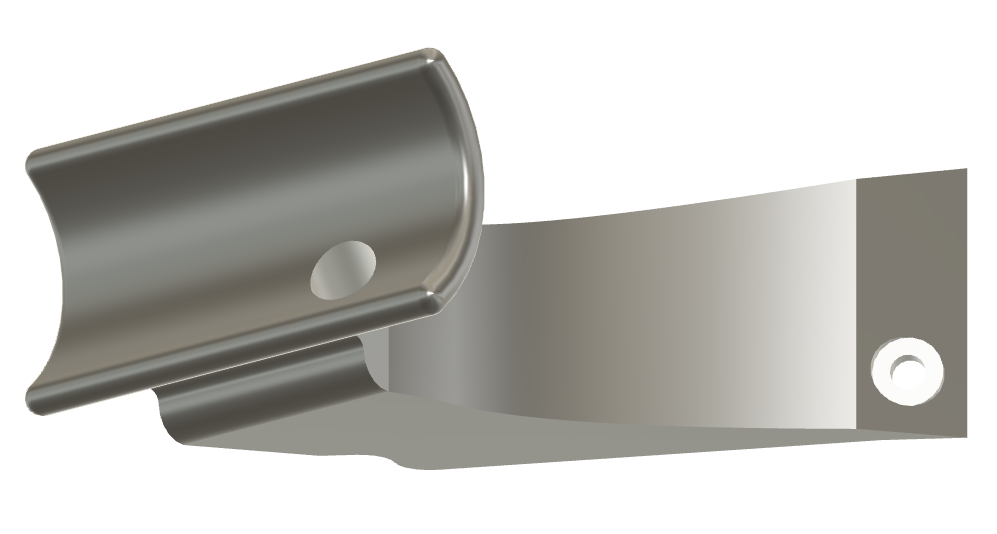

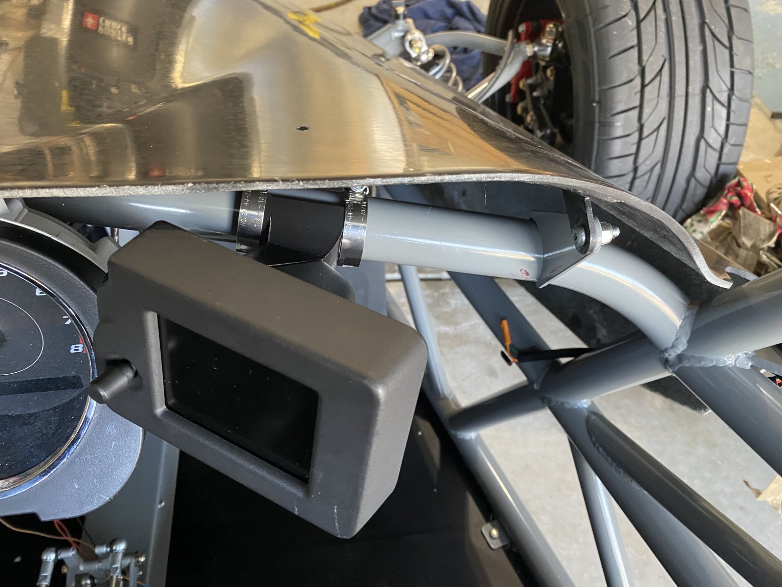

I made a new RPD mount! This time it actually fits and doesn't suck. It reuses the OEM RPD case and turns it toward the driver.
Working on putting my wideband gauge in there somewhere, whether alongside the RPD or next to the steering wheel.

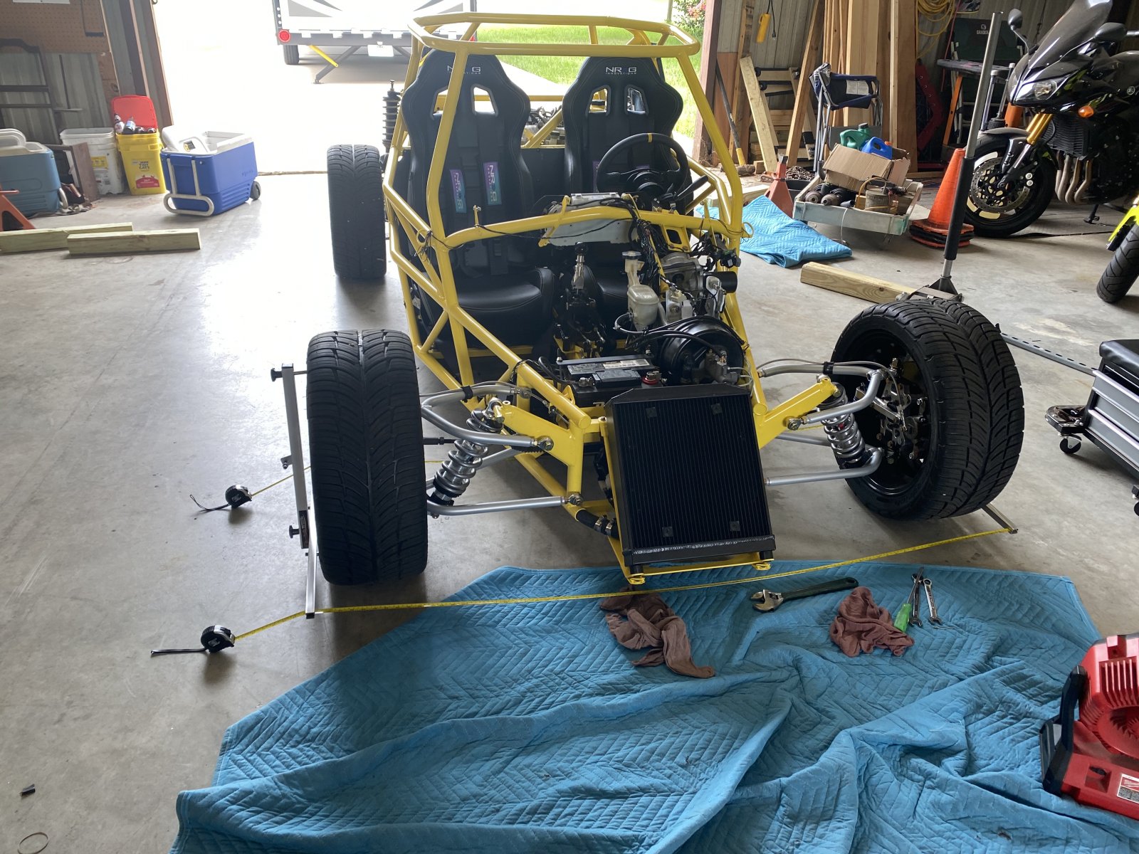

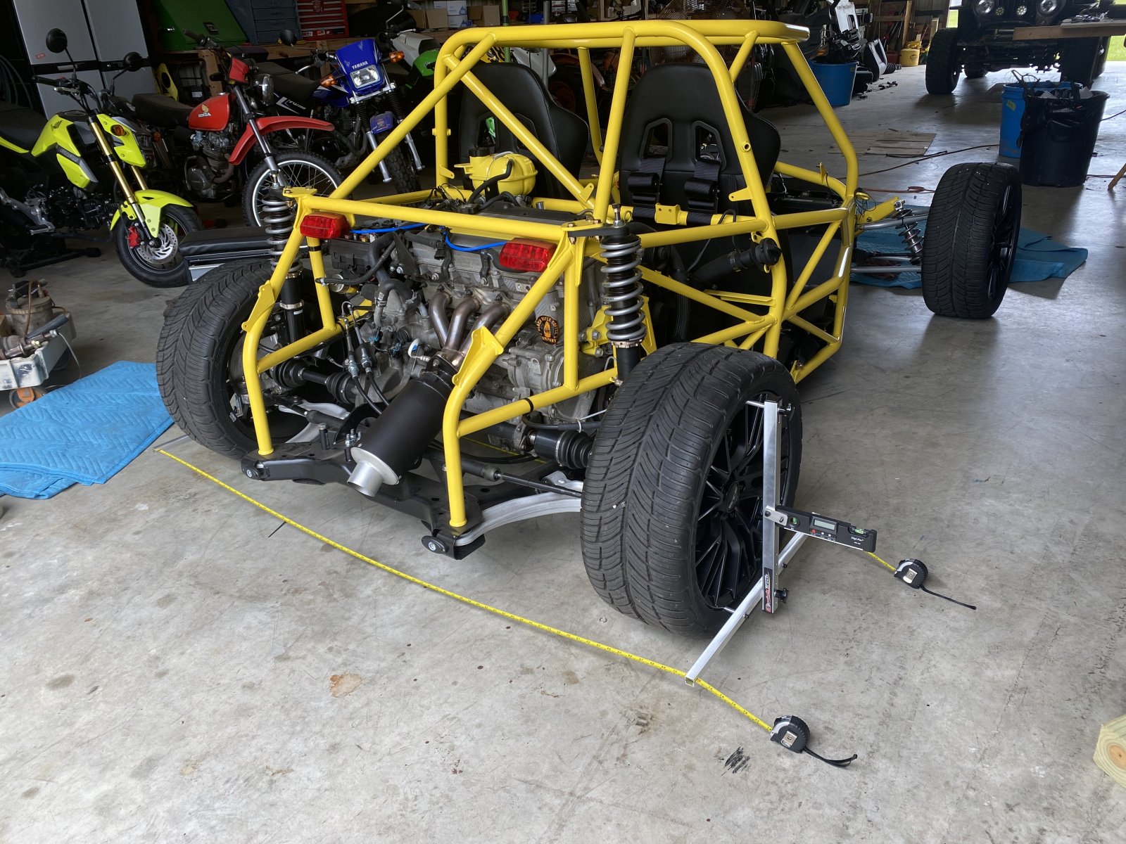

Today @OptimizePrime & @KSLunsfo came over to help with my alignment and general love & support. Many thanks to Optimize's alignment kit because it was super helpful. We didn't quiet get it 100% but we did get it close. Learned a few things along the way.

You got any pics of this "alignment kit"? I built some jigs that mount to both wheels on one axle that uses two tape measures and a digital angle finder that I used on my Colorado back in the day but I'd like to see other solutions.

It's the longacre kit. Turn plates (castor), toe plates & measuring tape, and a digital gauge.

I used QuickTrick alignment kit on mine. I did not use turn plates due to how light the front of the goblin is. If it binds or turns hard, put a thin piece of flat plate under the tire so it slides.

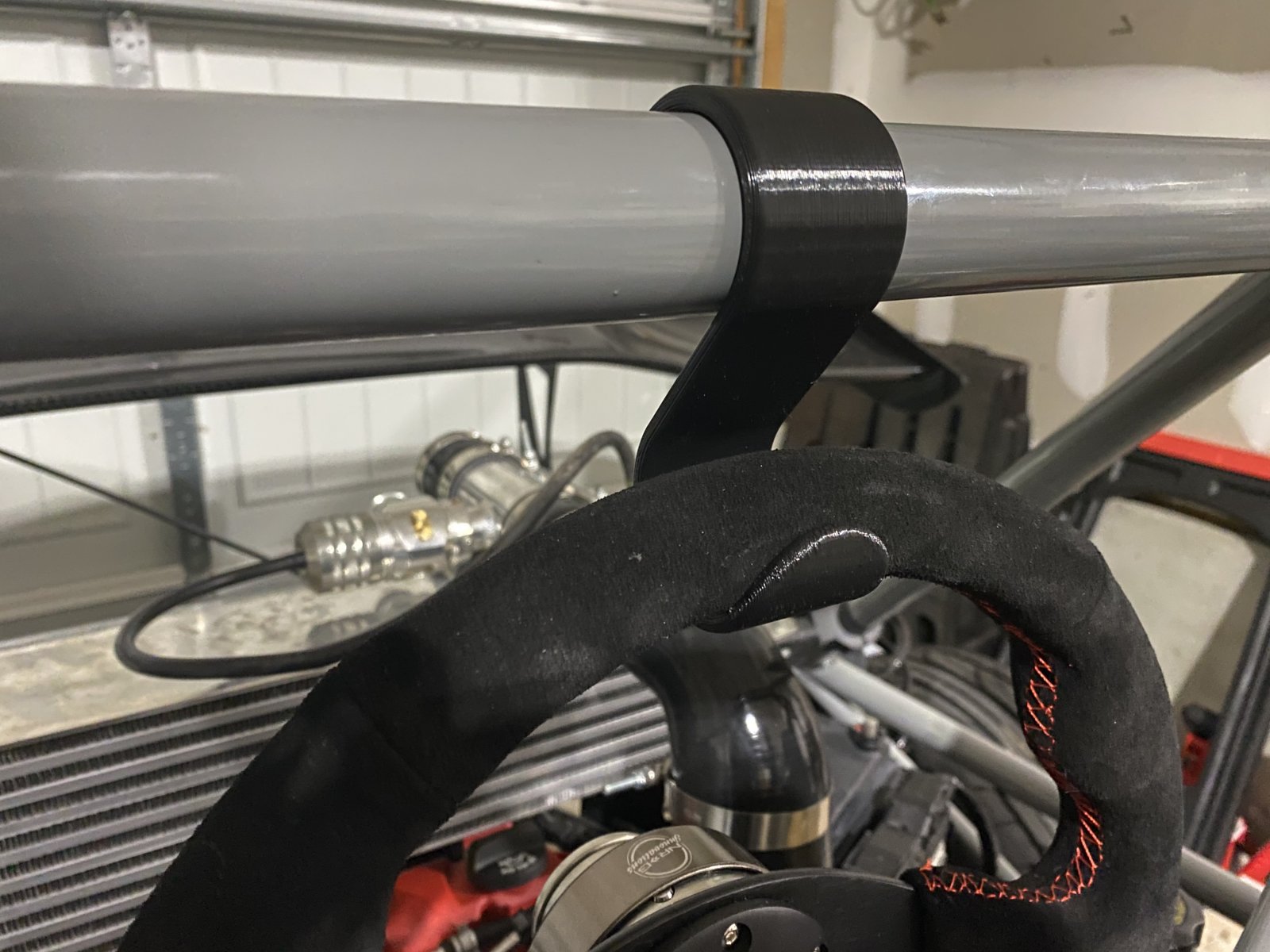

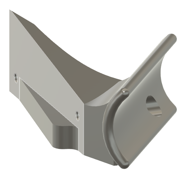

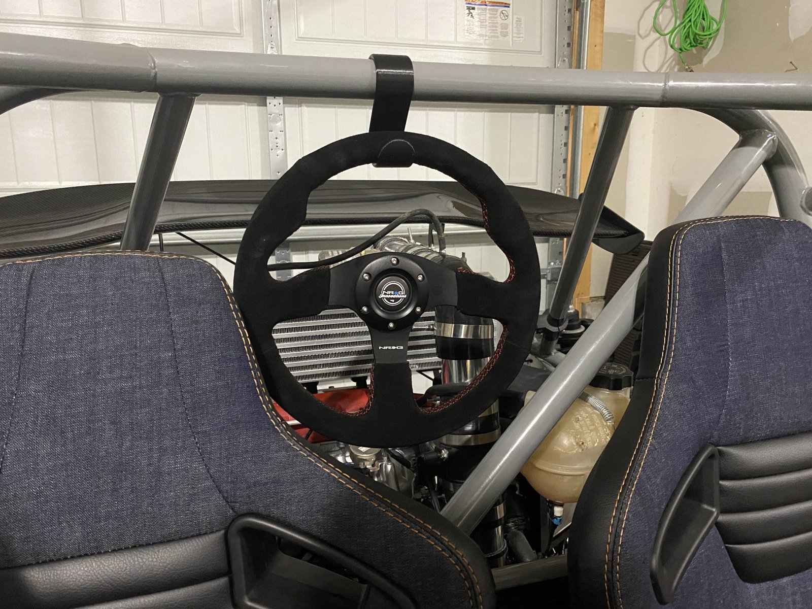

I printed a steering wheel holder for when I'm getting in/out of the car. Turned out pretty nicely. The STL is in my signature.

My solution for turn plates has been a steel protractor, sidewalk chalk, four pieces of one sqft vinyl tile (two per side), and table salt between the two tiles. Worked great for my TIB Ranger (wasn't necessary on the Goblin).

Looks sick. I need to get a 3d printer man. I wanted to make this exact hook setup for my wheel but I was gonna use steel. That looks so good.

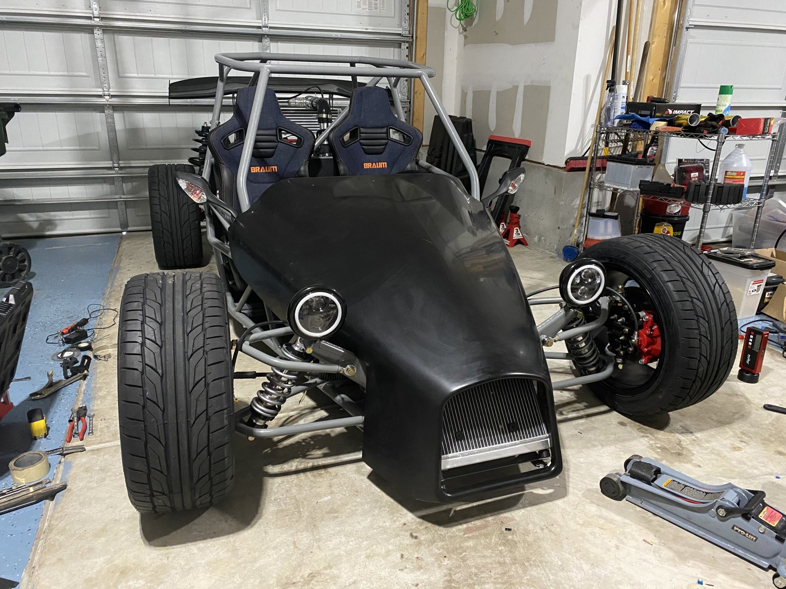

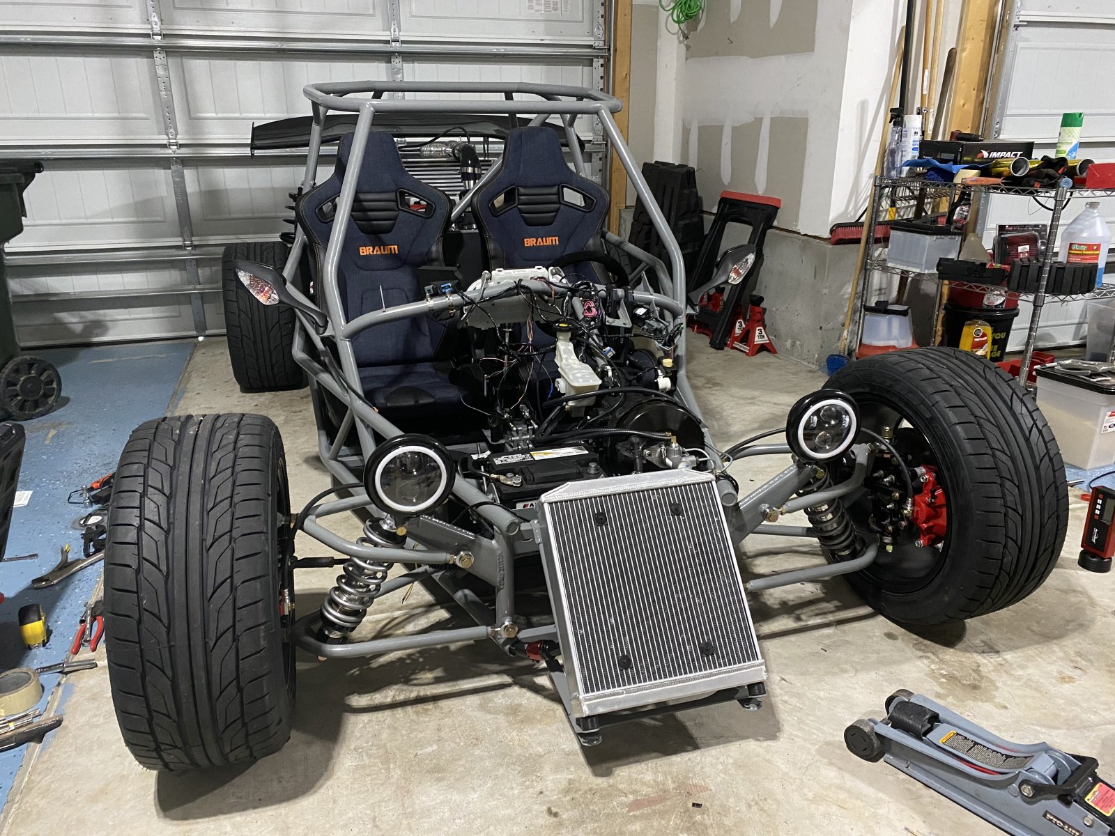

Tonight I hooked up my headlights, turn signals, and temporarily wired my brake lights to fully test them. I also added my 3D printed turn signal stalk switch holder and more permanently secured my manual steering bar. It's coming together!
  1. My brake lights never go off, they're 100% brightness all the time.
    1. Is the potentiometer adjustable with a Tech2?
  2. My DRL's just don't seem to be working.
    1. I need to check the fuse
  3. One of my headlights low beams doesn't work, but the other does.
    2. I checked the light itself and it does work.
    3. I need to review the wiring videos and schematics to see where these wire end up and confirm continuity and all that stuff...
