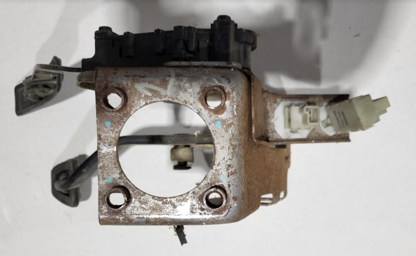

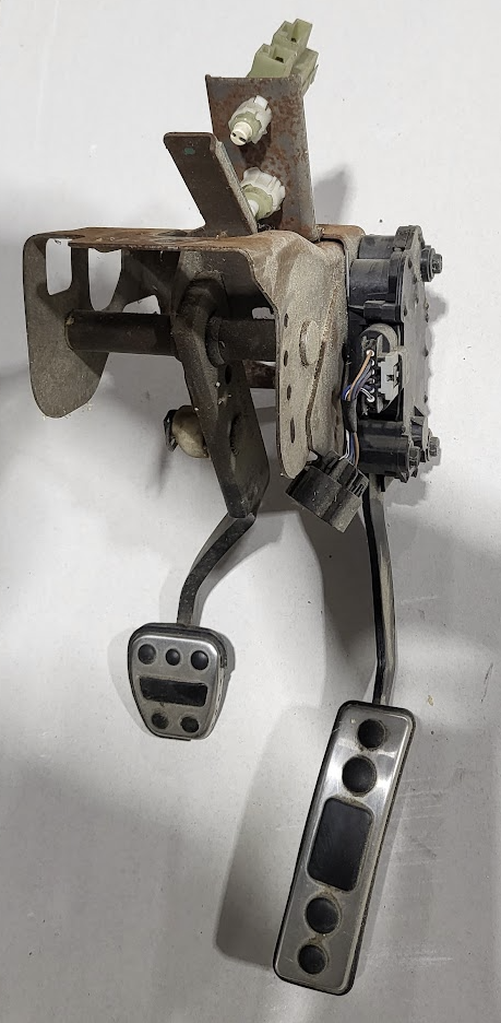

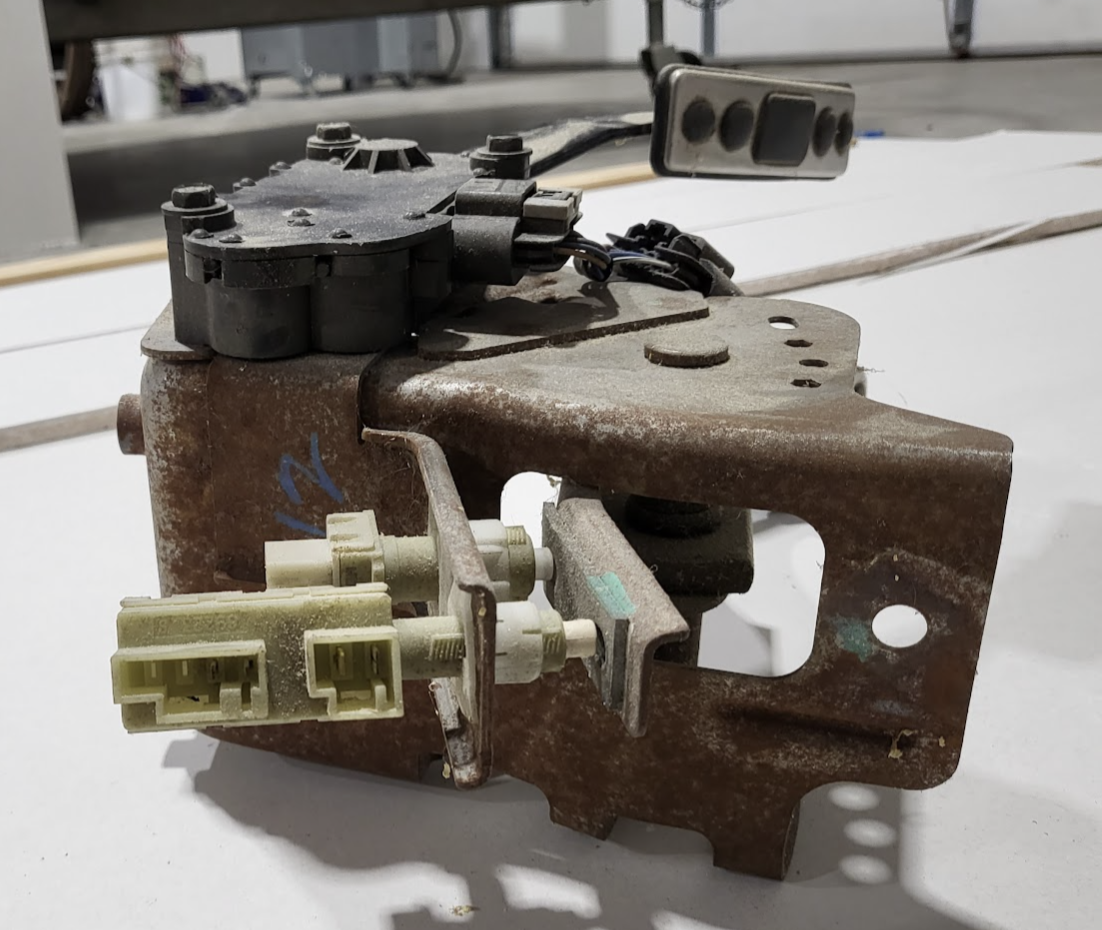

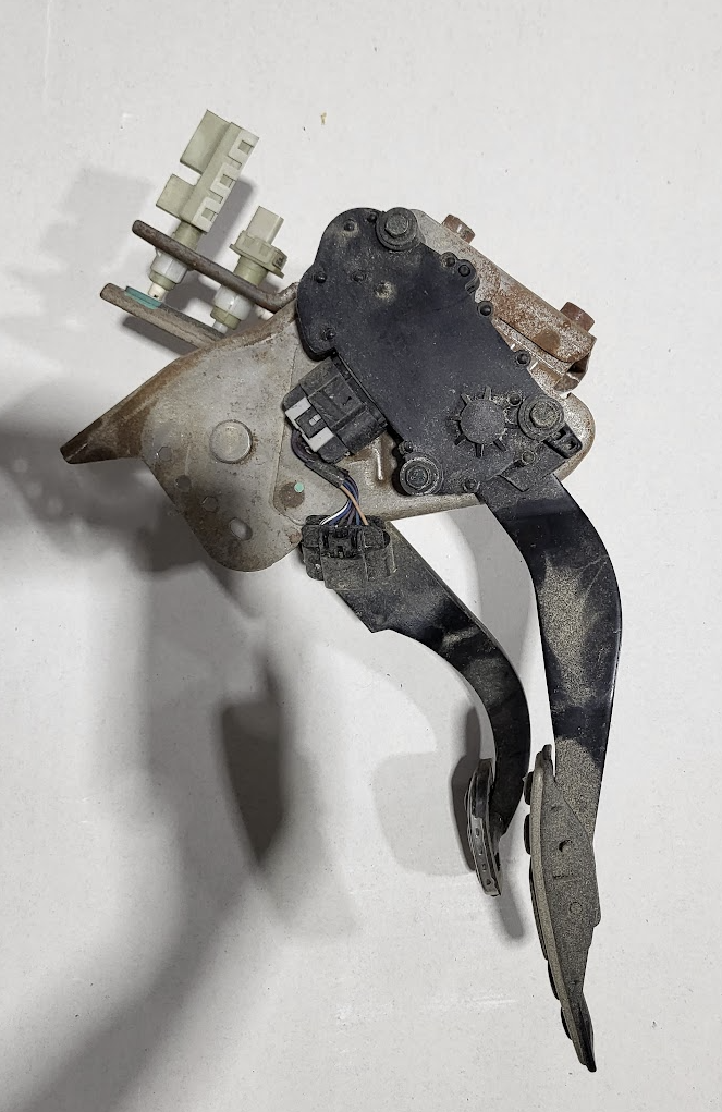

I have an extra set of pedals from a 2006 LSJ SS with the fancy pedals on the G85 optioned Cobalt.
There are 2 switches on the brake pedal, the top one has provisions for 2 electrical connectors. The 2 wire connector was on my wiring harness, but the other 4 wire connector was not used. For my goblin, the top wire switch was removed, to allow the hood to fit, but I don't have cruise control set up, so I don't miss it. If I want to add cruise control, I will have to engineer a new switch and mount.
