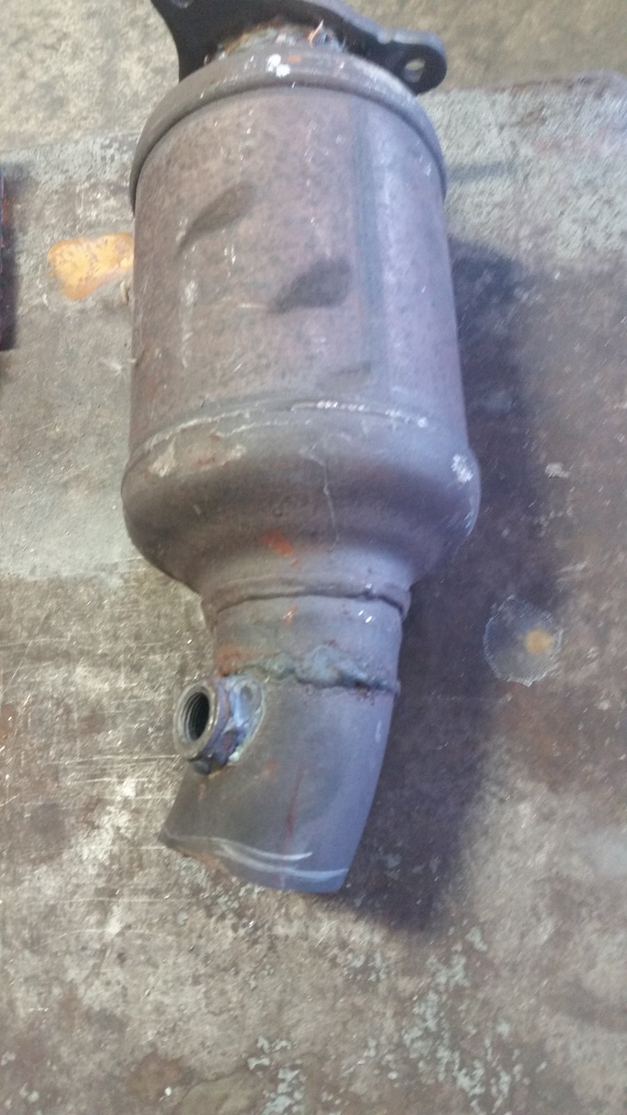

When I went for the inspection I has modified the cat and just bolted it to the manifold. The did not say any thing about bumpers, can you post a copy of your form your application may be you checked the wrong box. My inspection station did not question my seat belt chose.

You can use this to get passed inspection, give me a call
