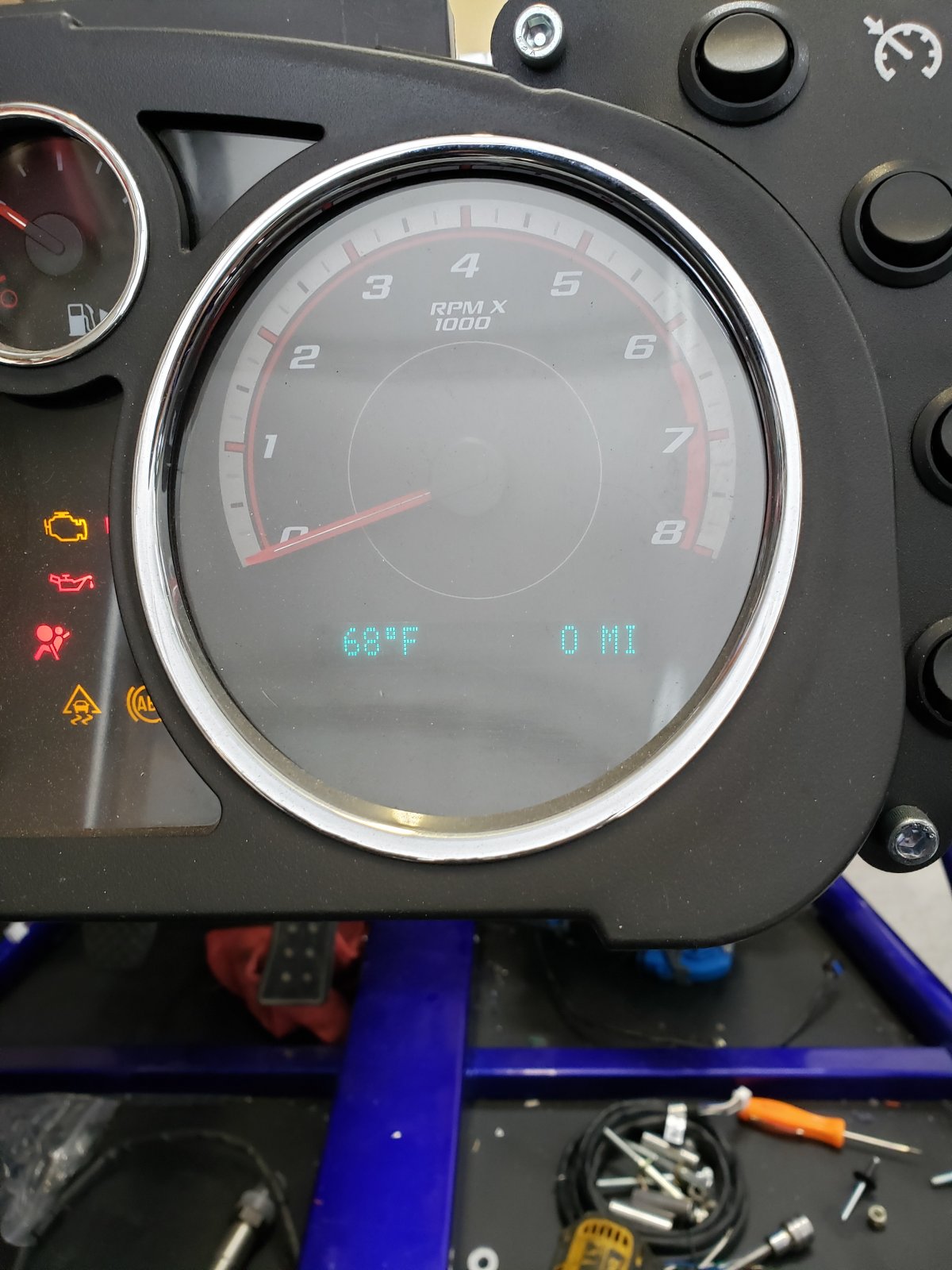

Just got my bcm back today, 1 week from when I mailed it off. They actually set odometer to 0 too. 20200701_162839.jpg

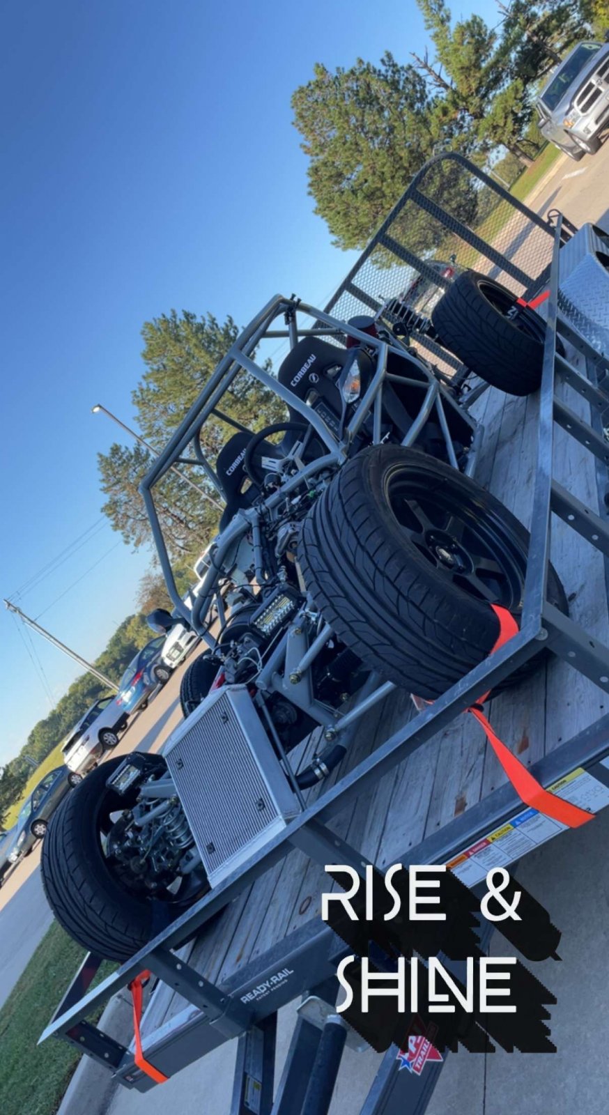

Just finished with it at troop c in STL at 8:40 today. Passed with no problem. Car had no DOT Stamped headlights, no body, 5 point harness, and a transmission that didn’t match the donor vehicle. How ever I did trailer it up there since I was told before that driving it was not a option. On now to submit my vin application. One step closer! Thanks again for everyone on this thread. Was a big help!
