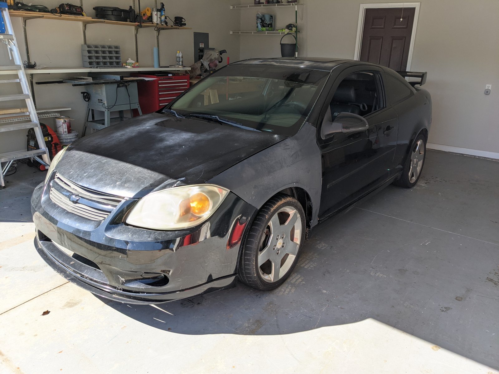

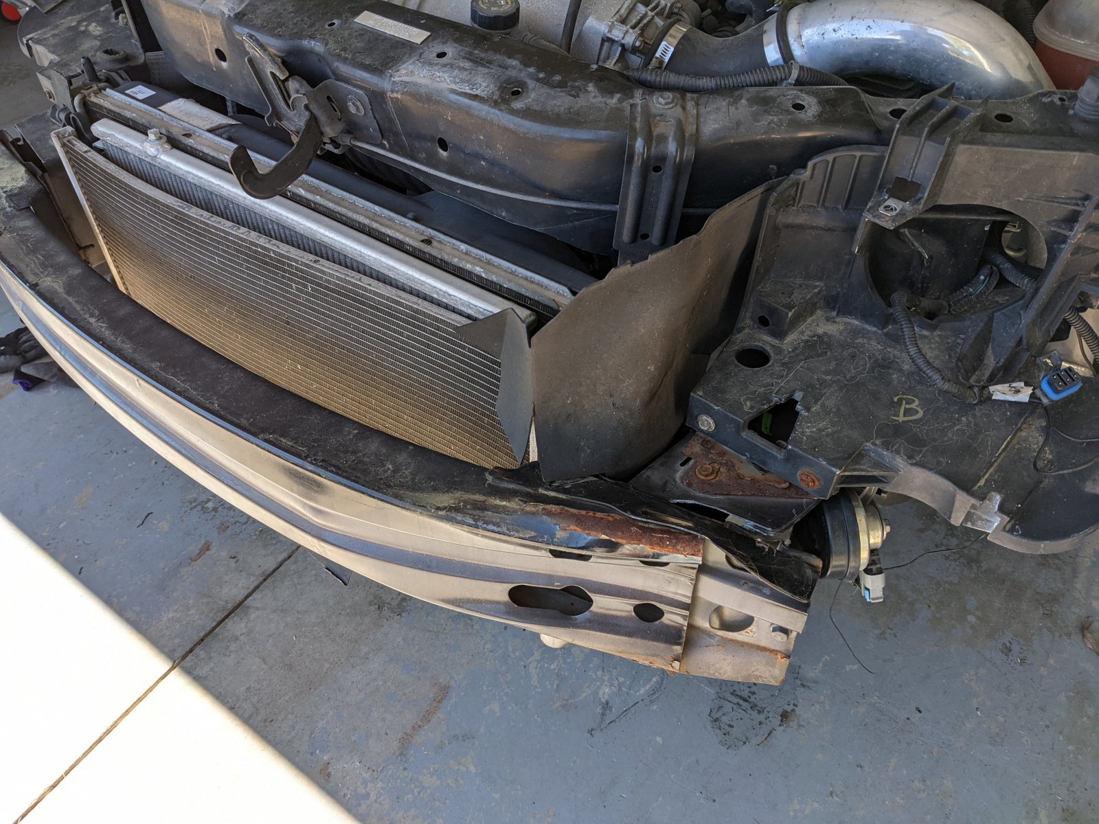

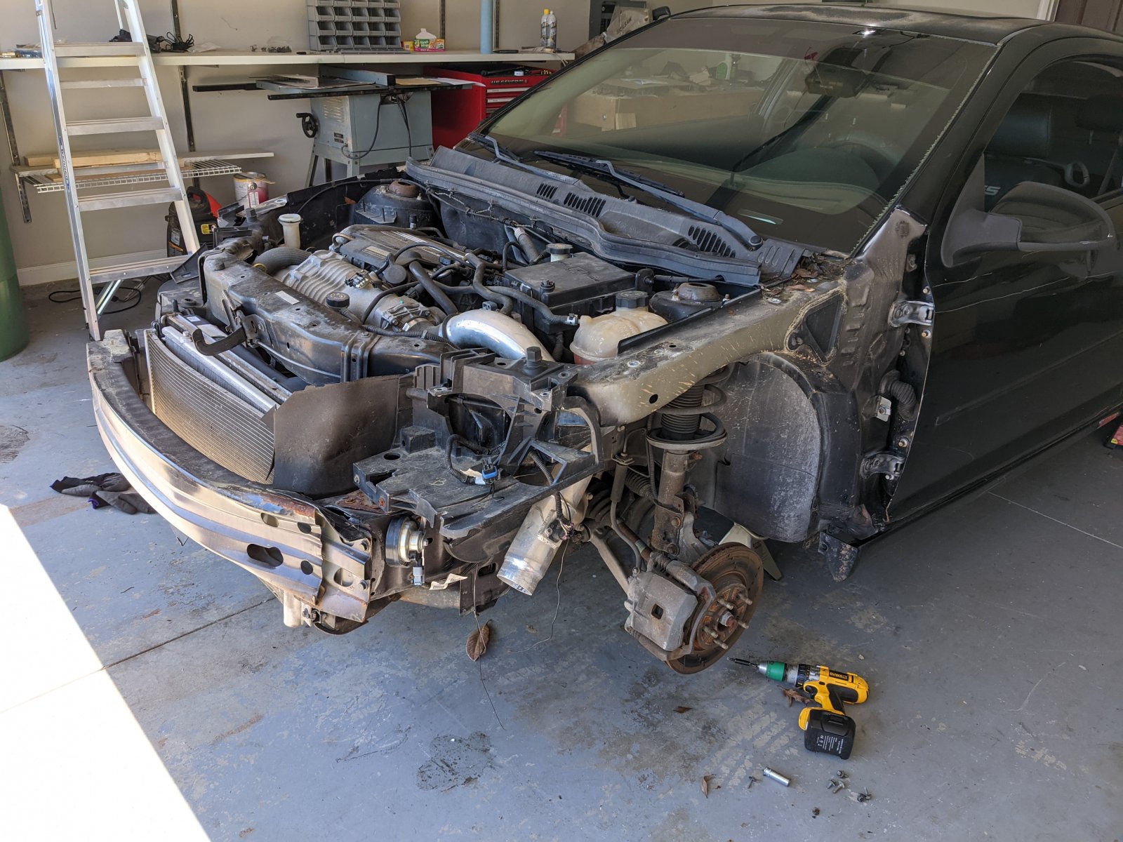

My build donor is a 2007 SS Supercharged with a salvage title. I bought it off Facebook marketplace for $1200, and from what I can tell, I should be fairly proud of that. The guy I bought it from got it at an auction, and didn't realize he couldn't title it in NC as it was. It got salvaged due to a pretty hard cronch on the LF corner, and it bent the inner bumper/unibody frame a little bit. The AC condenser is a little banana shaped, and quite a few parts got cracked because of it. Whoever did the body work to put the new fender and other bits back on could have done a better job if they used a sledgehammer instead of a wrench. Suffice to say, they did not do well. The good part is that it runs just fine - shifts wonderful and the engine is plenty strong.
This morning I got started into it. I took off the front body parts, and some other odds and ends. My plan is to take it really slow and be as methodical as possible labeling wiring connectors, and sorting the bolts by location. My first question to that point: should I bother sorting by where bolts came from for items that won't be saved (i.e. baggie for bumper bolts, one for hood bolts, one for fender bolts, etc.)? Or is it better to just sort by thread size?
I haven't put in the order for the Goblin yet. Still sorting out what configuration/options I want, and making peace with my girlfriend who is graciously giving up the entire garage for this.
Edit to broadly outline what I want: I intend to keep the motor and kit as stock as possible performance-wise. It was already plenty quick in the Cobalt, so it should be all I need in the Goblin. I want something to take to the nearby mountains, as well as the odd track day here and there. But I don't want to bolt on power and require brown pants of passengers, just a sense of thrill.

Looks like a great donor. How many miles on it?

Cool. That’s what I paid or mine, in basically the same condition.

Roughly 187k on the odometer. A little higher than what most look for, but it really didn't give me much to worry about as far as how it runs, sounds, etc. My parents live near where I picked it up, and we gave it a full once-over/shakedown drive around country roads, and were very pleased.

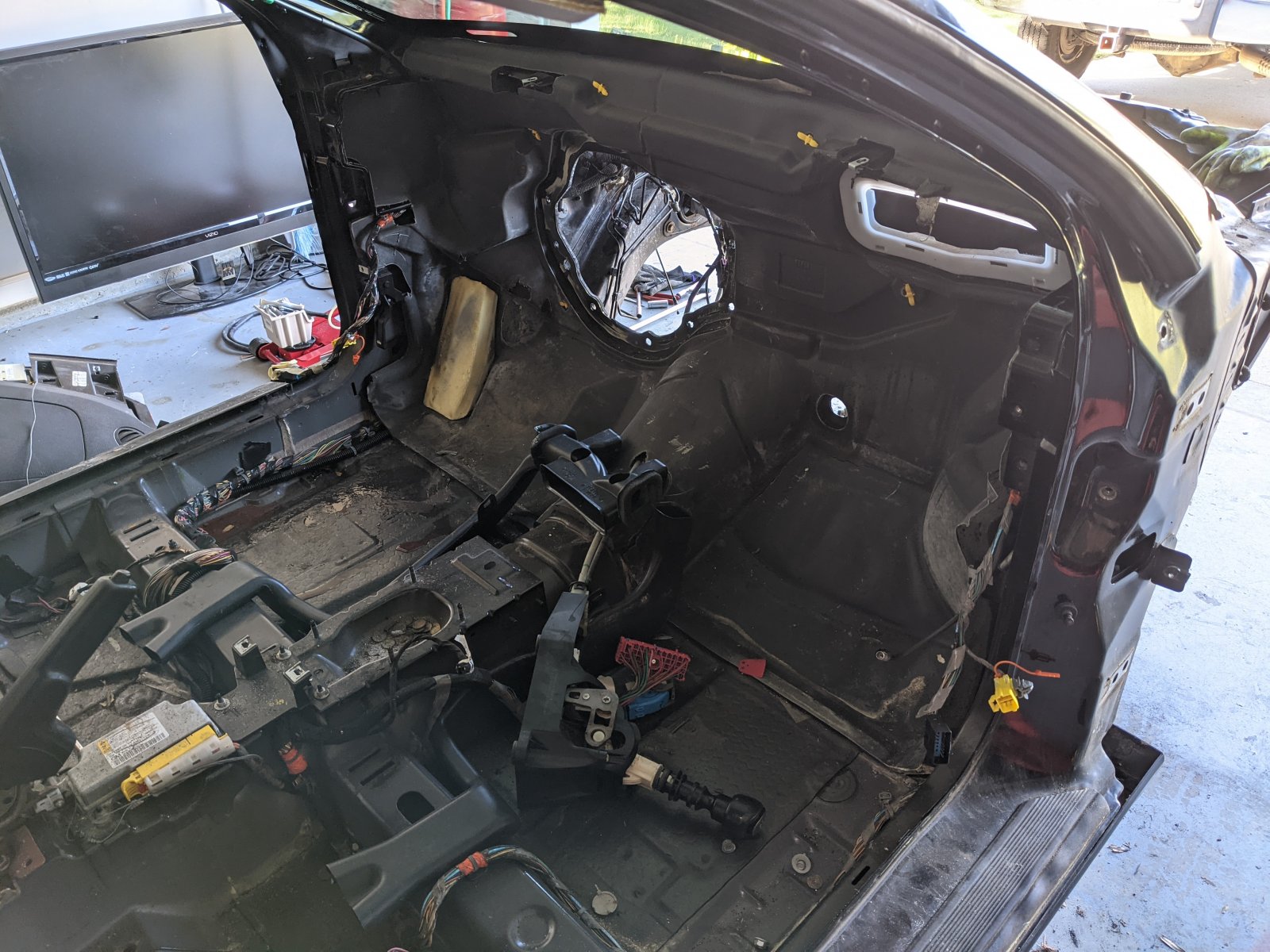

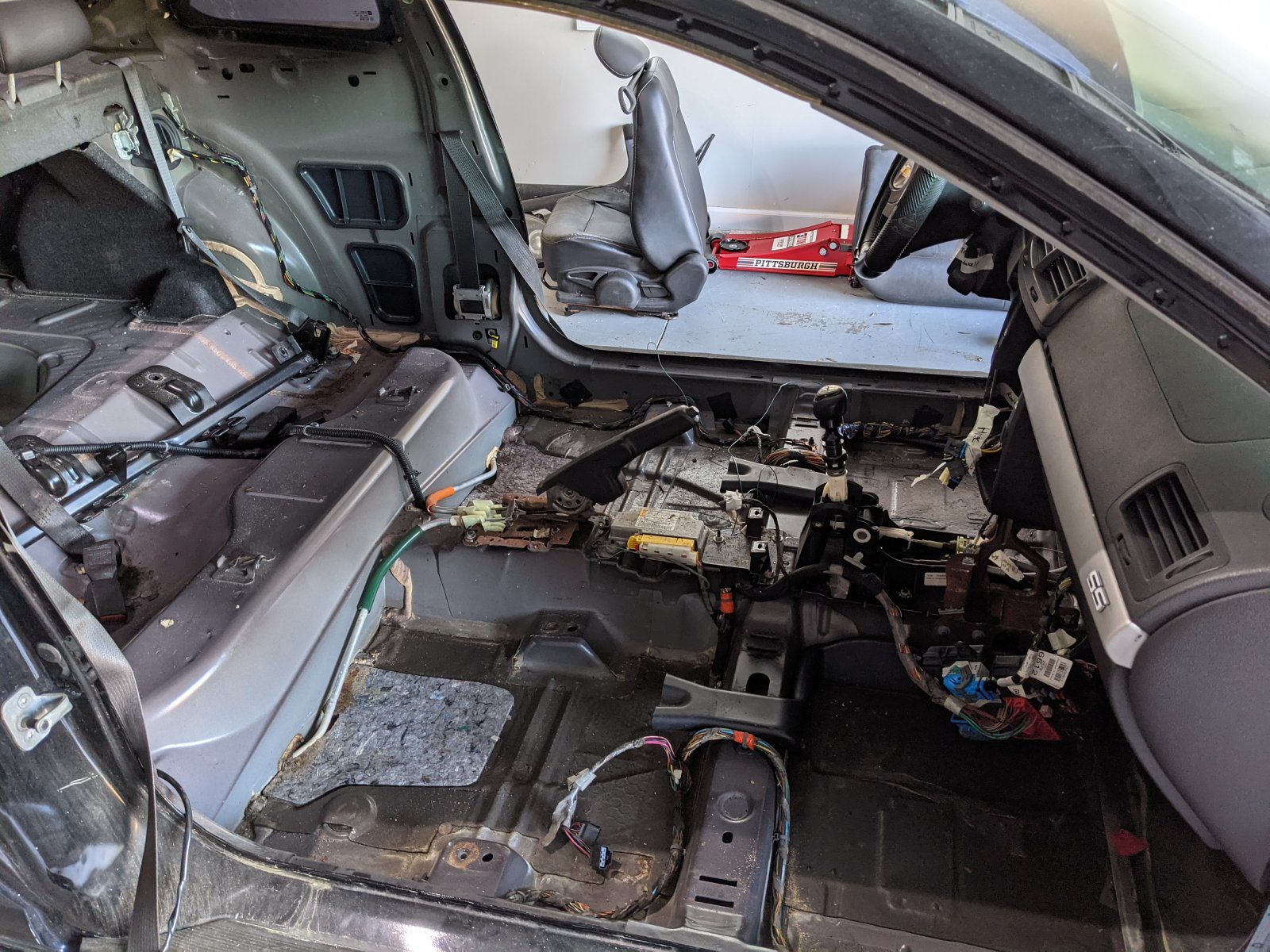

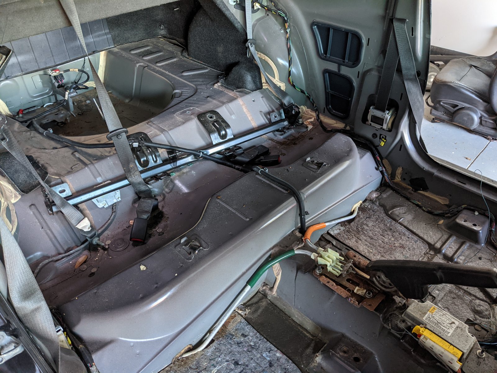

Nothing too eventful yet. Over the past few evenings, I've gotten the unused parts of the interior pretty much out save for the dash and some odds and ends. Everything is coming apart cleanly and isn't giving much fuss. Connectors are all being labeled, bolts are all being sorted and saved. I took the pictures below, then busted out the seatbelts completely. Not sure if I was supposed to take the bolts out of that black bar where the back seat bottom hooks on at the back, but it had some nice chunky factory bolts that might come in handy. Also found out GM decided not to drain that back seat bottom area, so I had who knows how many years of water with coins and dirt steeping. Definitely took a step back and let it dry out for a couple days.
My dad is coming over this weekend, and our goal is to get the powertrain and the dash out.
And the way things are going, I plan on putting in an order this coming Monday!

I took all the nuts/bolts out that I could. When you live out in the middle of no where, it’s hard to come by metric bolts and I like “factory” ones better than store bought ones. :cool:
jennam
Seems like I pulled that black seat mounting bar too. I think that was the only way I could get part of the seat out.
Definitely save all the hardware. I’ve broken more bolts than I care to admit working on other cars and stuff. It’s super nice to have that tub of hardware for a replacement.

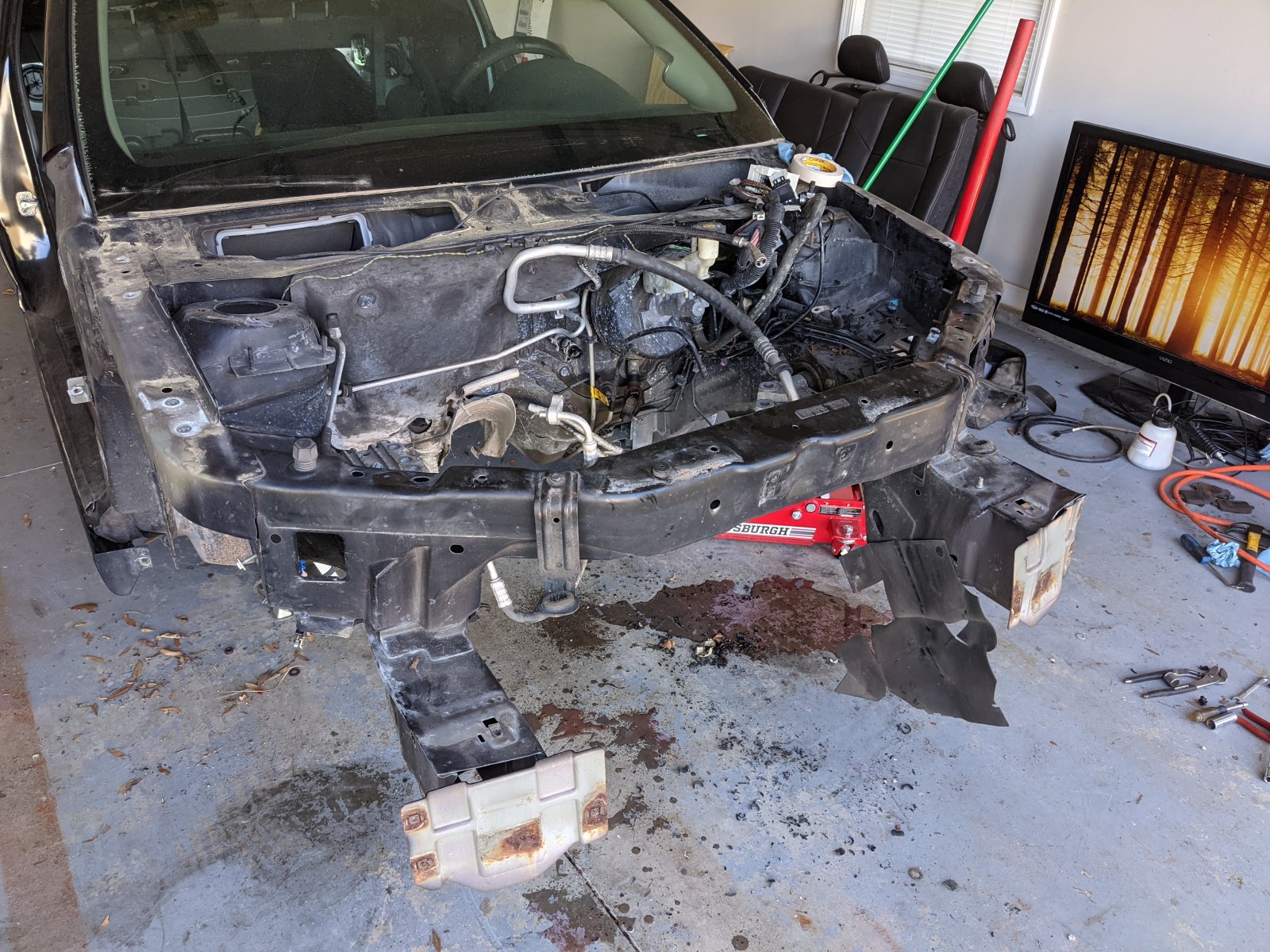

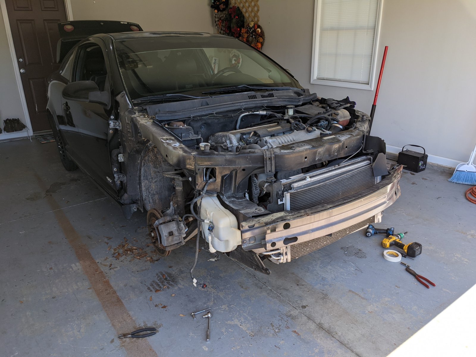

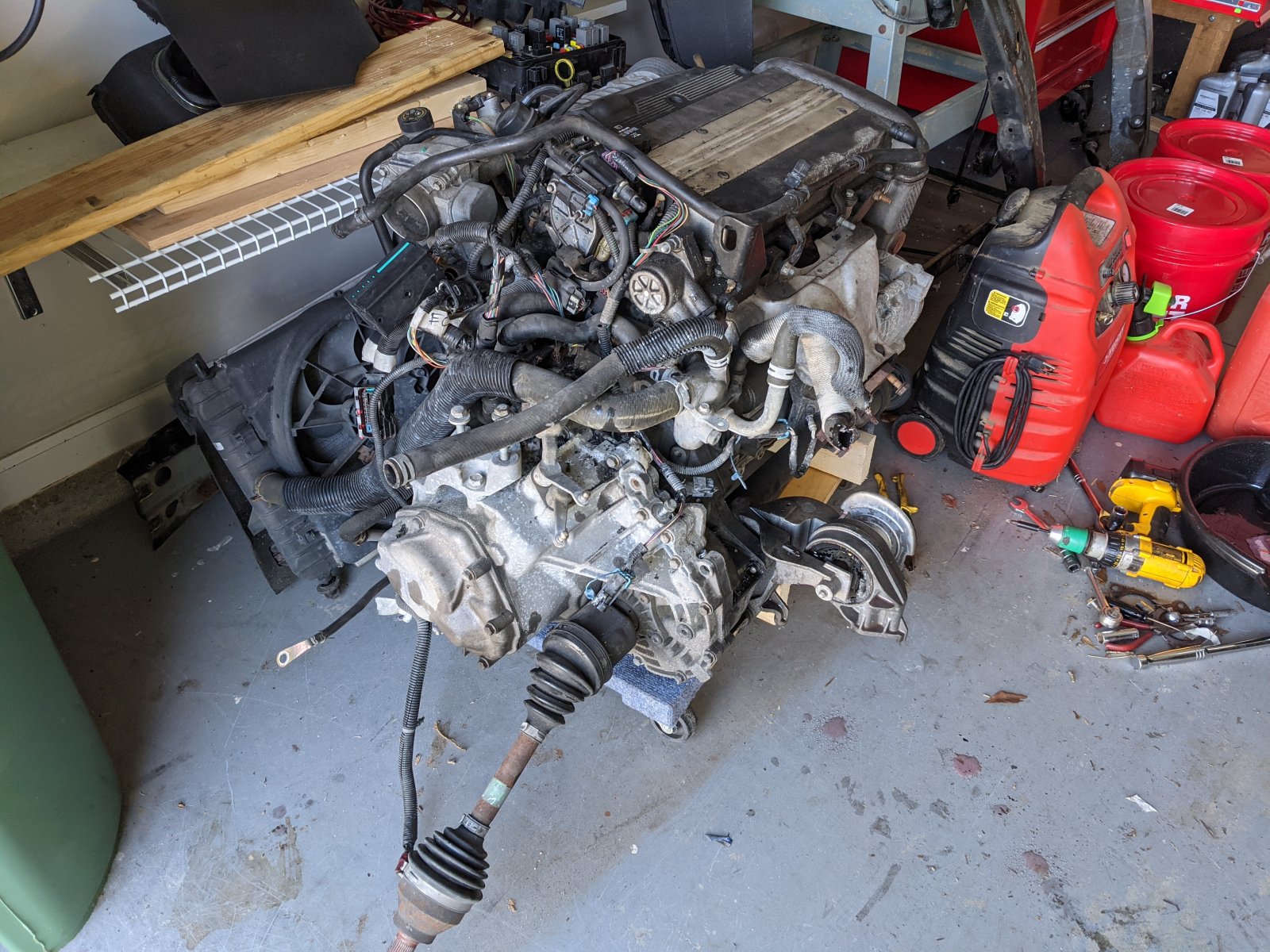

So a fairly big update on the teardown: engine and dash are out! My dad lent two more hands yesterday, and we were able to get the engine and dash both out of the car. I was extremely lucky that this was a Florida car most of its life, because all the big bolts that were potential trouble came out with no fuss whatsoever. Only one of the two exhaust studs froze and snapped. The subframe dropped easily, and the engine dropped out without any real concerns. Suspension blew apart just fine as well. All in all, a very low stress day taking the engine apart. If you can find a donor from a state that never sees salted roads, get it. Life is so much easier.
My dad and I only had access to a couple floor jacks and Harbor Freight dollies for the engine removal in lieu of a hoist, and I will describe our method here: first, undo the subframe like the video shows. Then, we put one floor jack on each unibody rail where the videos also explain early on, at the doubler. We dropped the car at the same time until the engine was just barely touching the 2x4s on the cart. We carefully undid all 6 engine bolts until the last couple slowly lowered the engine weight onto the blocks. Once the weight was entirely on the cart, we jacked the car up and slid it out. I'm sure that's extremely similar or identical to what others have done, but I figured it bears repeating since it's a slick way of getting the engine out. Pro tip: use a stronger cart than we did...the middle is bowing a little.
Now I just need to follow the disassembly videos to finish up stripping the car!
