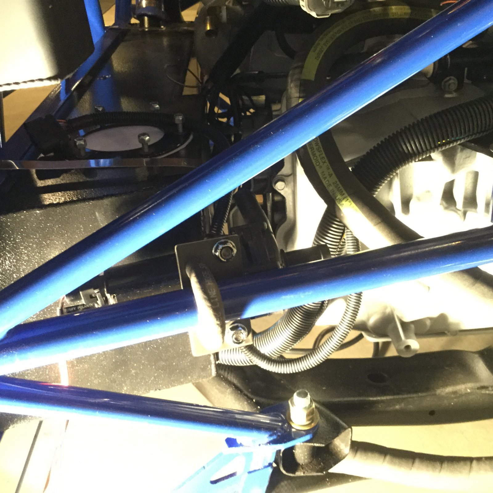

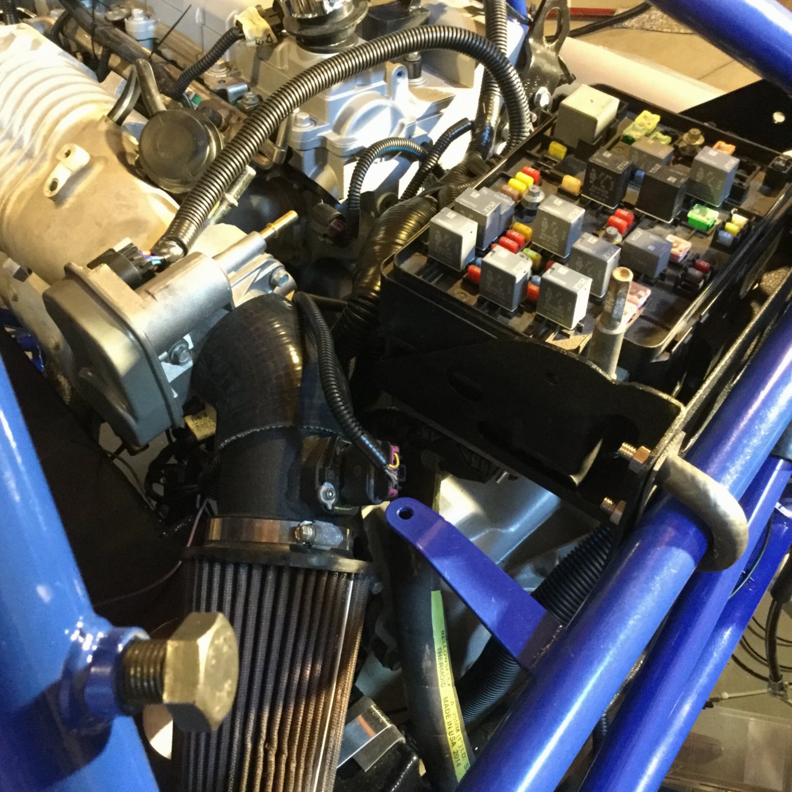

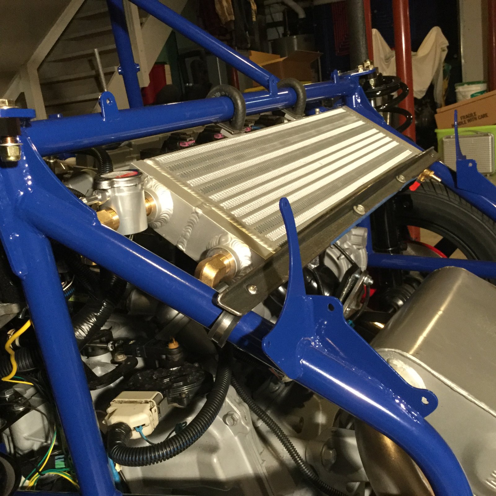

Good Evening,
Just something to think about if you are going to do any modifications (changing the mounts for reservoirs, coolers, brackets for radiator lines). If you have the frame powder coated all those changes are going to have to be clamped to the frame. If you have a raw frame you can weld in threaded lugs or tabs for mounting those accessories. (would make a lighter cleaner look). Couple of examples in the pictures. If I would not have had the frame powder coated first. I could have welded in tabs or threaded lugs right onto the frame.
