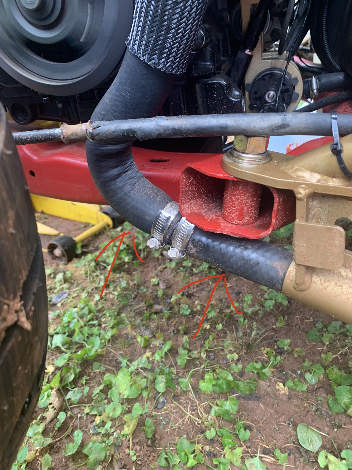

At what point do the lines get cool?
You also might try applying the vacuum again and see if you get a bunch of bubbles. I think I applied vacuum on the steam port on the head when I did mine. You can also take the top radiator hose loose and confirm that the radiator is mostly full of water. I think I originally filled my system with the top hose disconnected until it filled to that point. I then reconnected and filled through the steam port until it wouldn't take anymore. I then applied vacuum to confirm it was full.
