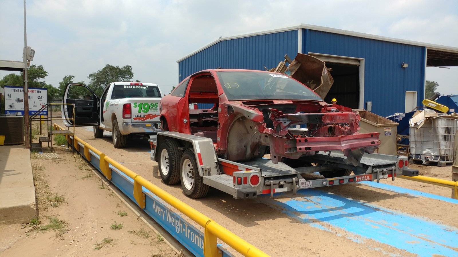

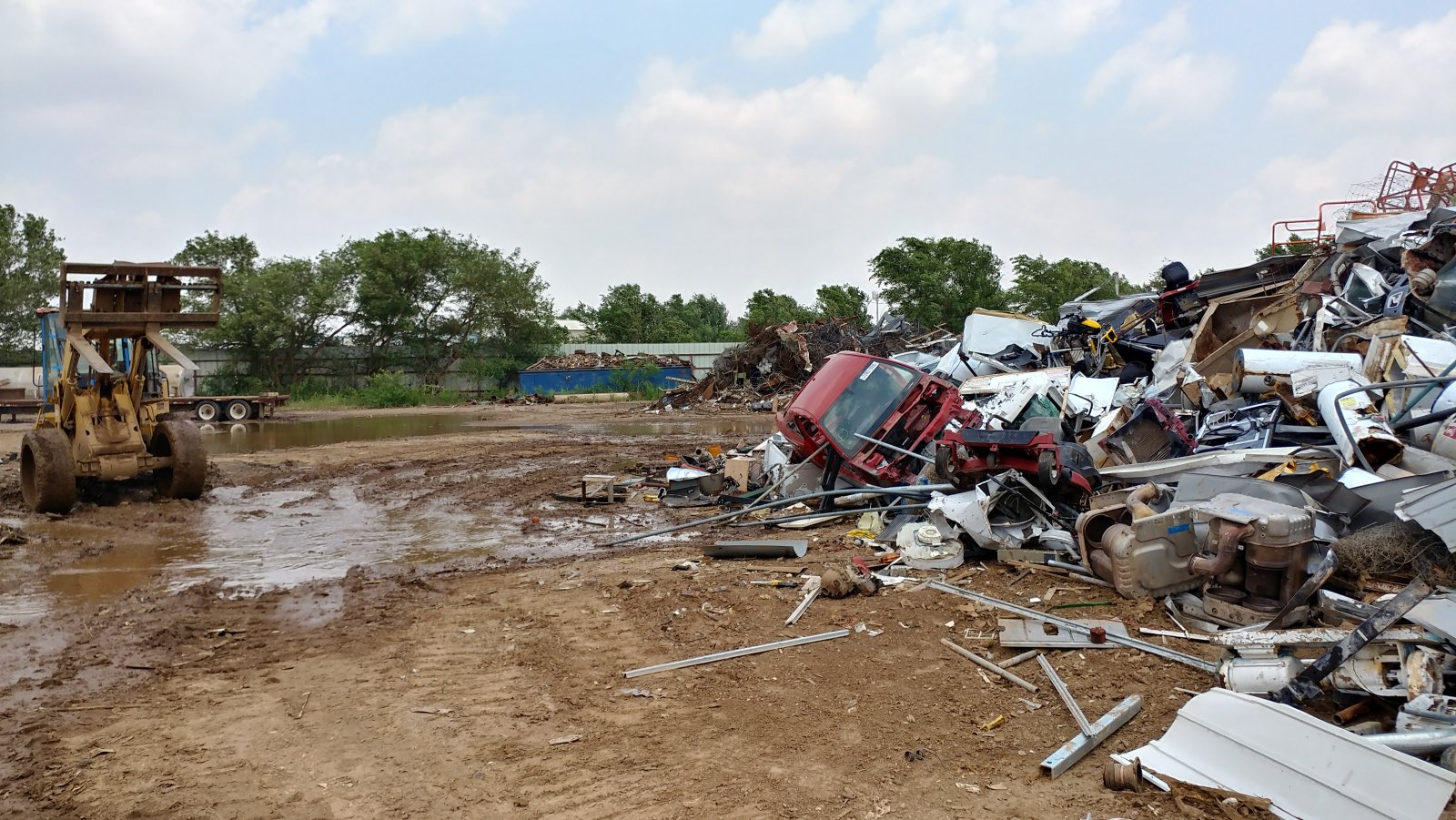

Finally back home and able to work on the car again. Got rid of the carcass, it brought a whopping $11.37 from the local scrap yard.

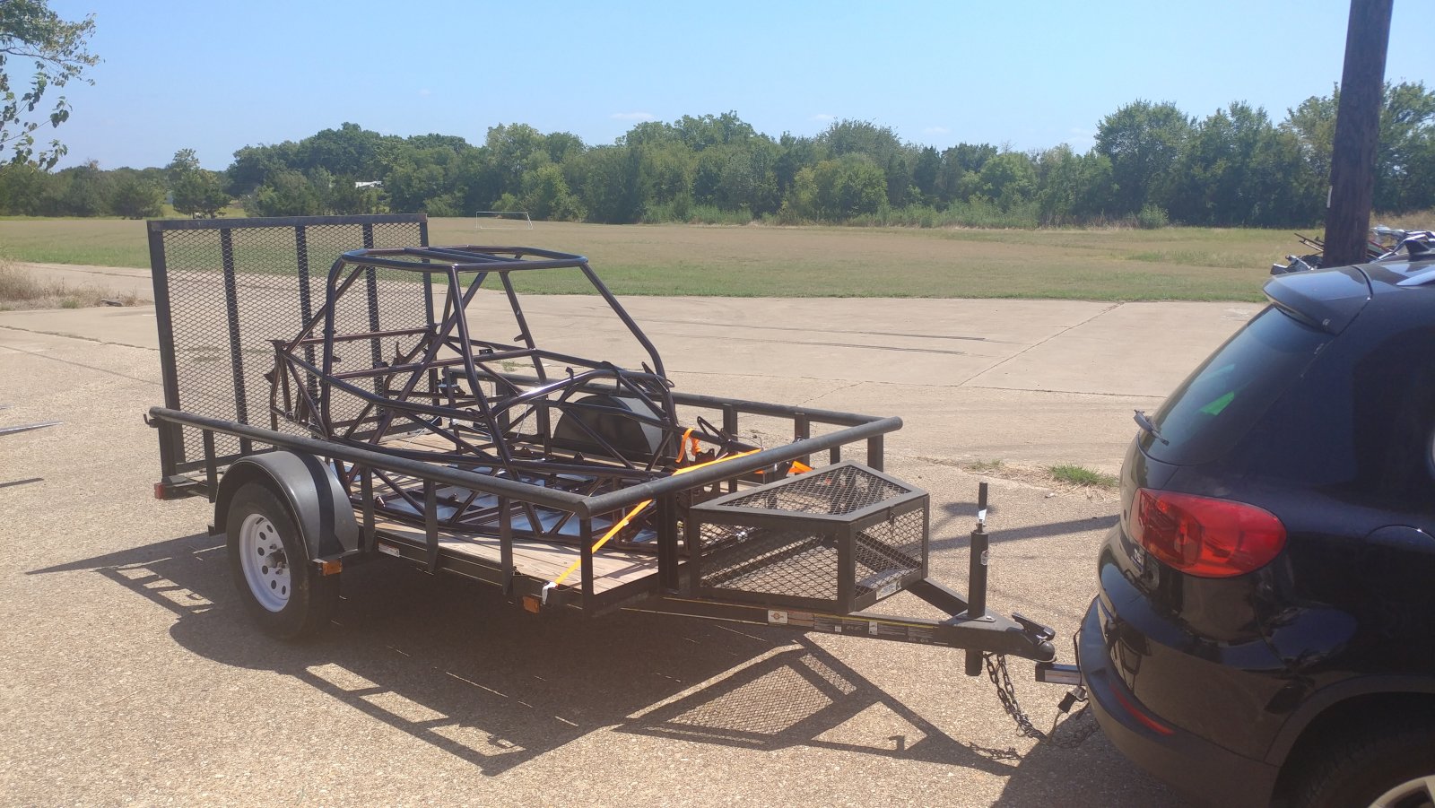

As for a Goblin and trailer -vs- a big-ole Class A RV... a diesel Class A might get better mileage. Coming back from Dallas in my wife's stock 2.0 TSI Tiguan with three people, a 10' utility trailer, and the Goblin frame, the mpg dropped from a normal highway 22 all the way down to 9.8. I think that alone justifies getting one of these to haul the Goblin around with:
