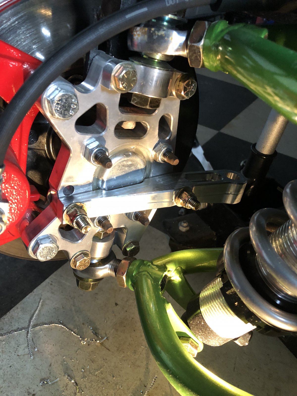

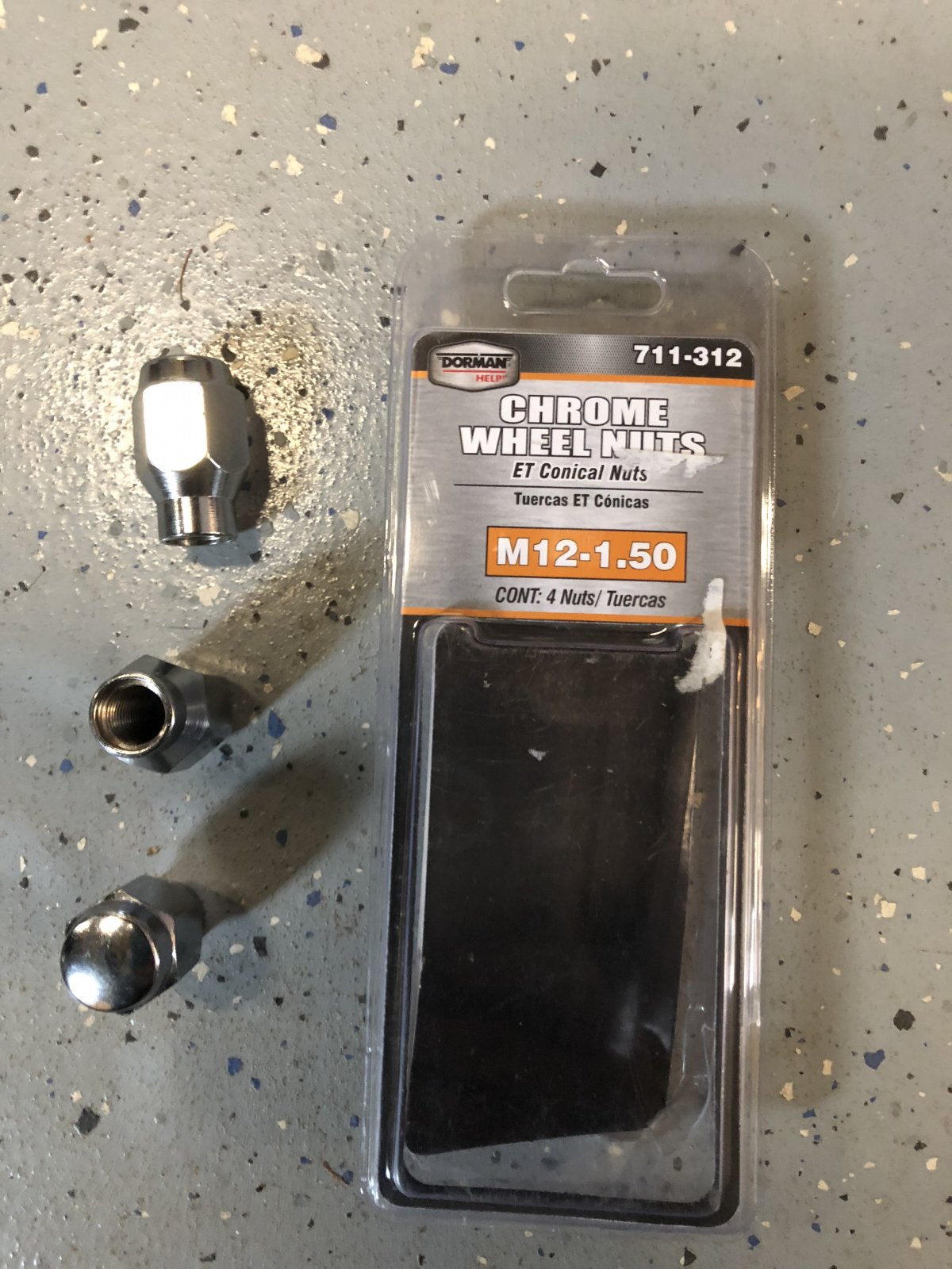

Been busy this weekend. Redrilled the front of the steering knuckles and installed the new arms and shorter tie rods. Nose painted and installed. Rear tires with spacers installed, it was easier to buy different lug nuts than install longer studs. Rear fenders installed. Almost finished painting the engine cover. I’ll redo the alignment this week, plan on doing what I did before with string and jackstands. Plan to install the signal cancel cam later today.
Edit, picture was taken before putting on the tie rod. Tapered end should be down.

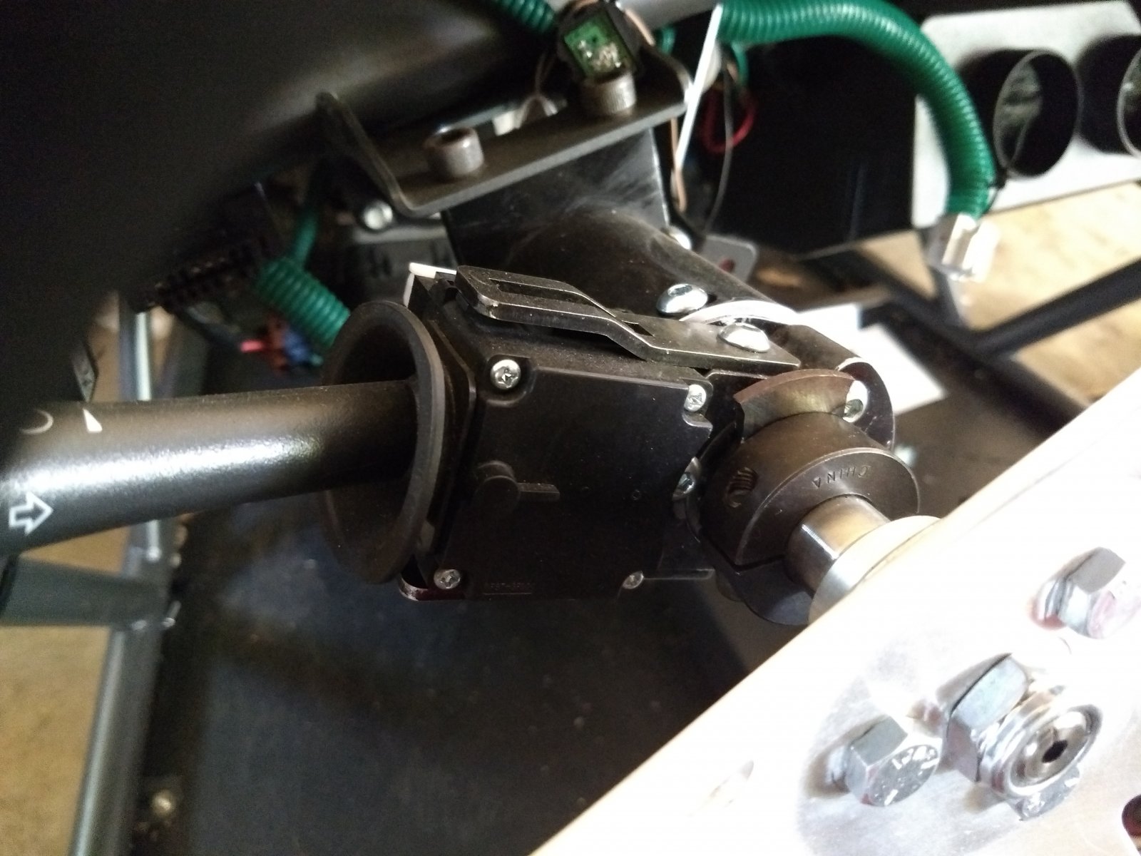

Turn cancel cam works; I used to forget sometimes to turn it off before.
The new front knuckle design is great; so smooth up to 55mph, didn't feel floating or loose at all.
I also turned the shocks up 5 clicks so not sure what helped the most.

k.rollin
There is a little ring that goes on the steering shaft that the blinker clicky hits and turns off after you turn.
I'll try to take a pic of it tonight.

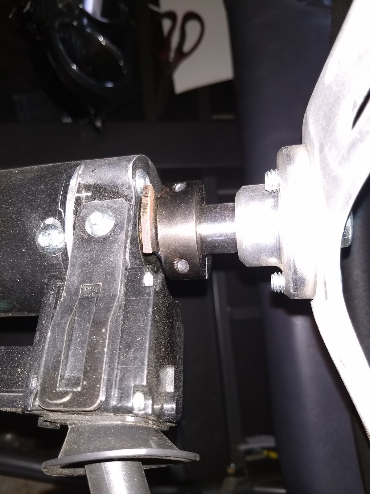

It's not the clockspring from the donor, is it? Mine got trashed when I removed the steering wheel if I remember correctly.
Okay, this is the perfect time to bring up another question. What is keeping your steering shaft from compressing more and the cancel bracket from rubbing and hitting the three screws? On ours, we can pull the shaft out some and push it in to the screws. Kaleb was worried about it catching on the screws and stopping the steering (which could be a real safety concern), however I don't think it can go in between the screws to hit squarely on one.
I just put the snap ring on. I knew it was on the original shaft but I didn't see the groove for it. I had to tap the shaft back to finally expose it completely. I knew I wasn't going to get by without having to pull the steering wheel hub at least once. Luckily I had a harmonic balancer puller that worked great!
With the snap ring on there is no movement in my steering shaft. You can yank on it back and forth and there’s not even a thousandths play.

Mount it with the tab 180 degrees from the turn signal. If you consider the turn signal to be at 10:00 position, mount the tab (with the steering wheel centered) at 4:00. That way it cancels at the same for both left and right turns. The little piece works really well.
