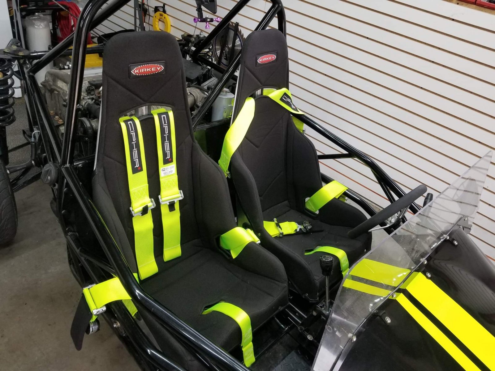

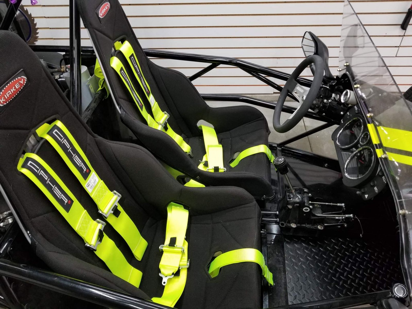

I am 6'4 300 lbs and fit fine with an extended frame. With a quick detach wheel I'd imagine you'd be fine, but definitely try sitting in one to be 100%
I have kirky drag seats too, which I imagine helps alot, mounted just 1" off the floor.
I don't have a quick detach wheel now and am fine. Once I get that quick detach wheel it'll streamline my getting in and out, but even as is I don't have any issues. I think the kirky seats is a huge factor.
For the record the kirky seat I have is I think $140+128$ for the washable cover. It's worth every penny. I'll see if I can grab some pics for you.

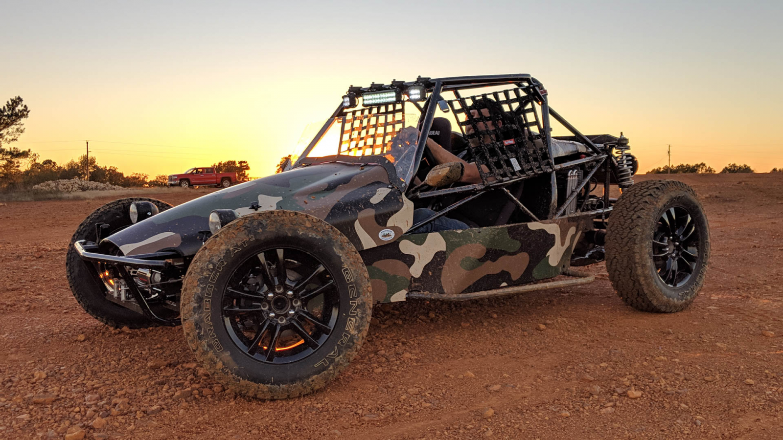

When you talk about a lift kit or riser kit, does the Goblin AT fit the bill? Image below is from the DFKC gallery. They only build them in auto, largely due to gearing issues that have been covered here among other places. I'm sure this is still more than quick enough and handles well enough to do twisties if that's your inclination.

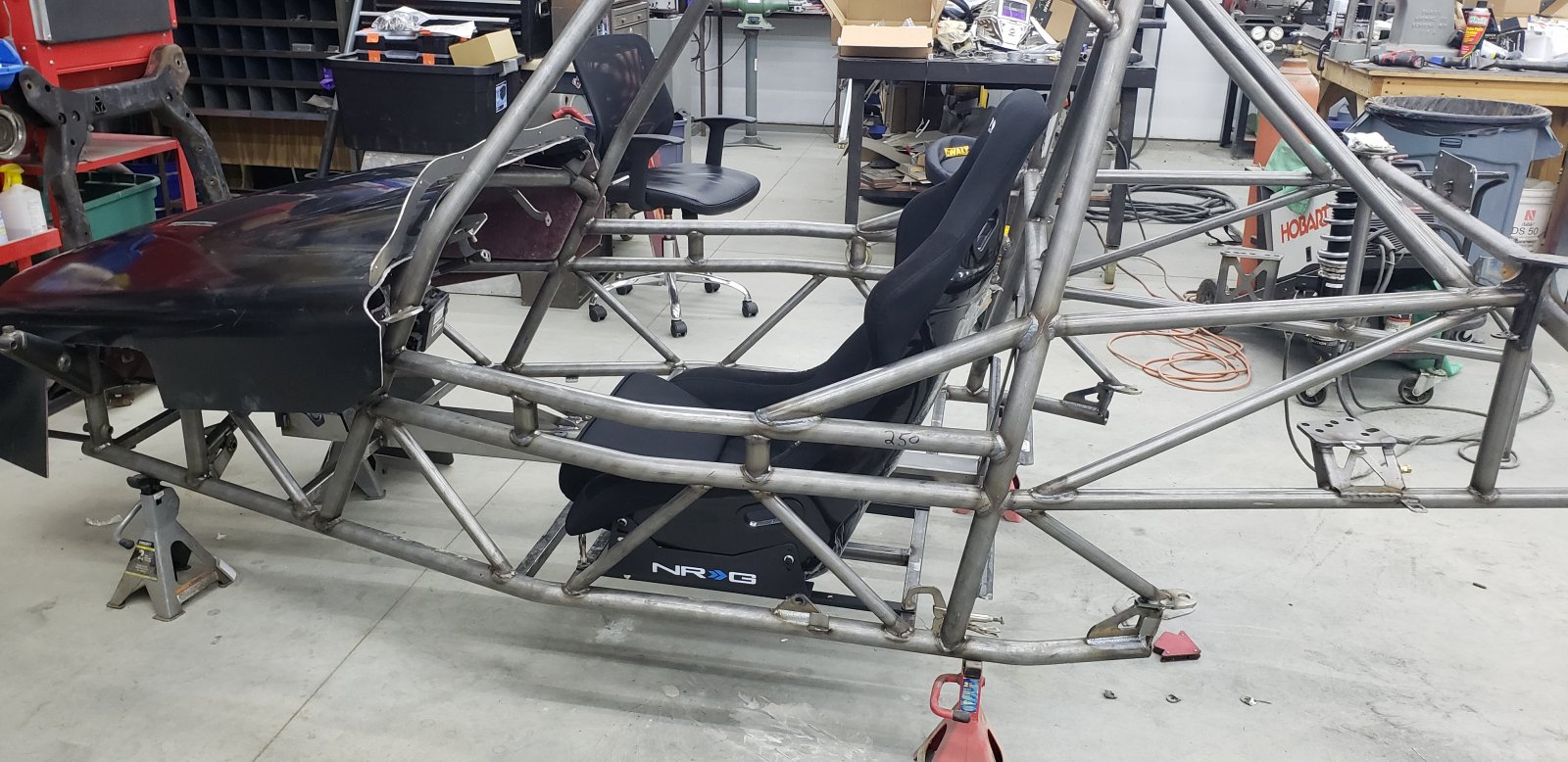

I am 6 3" and currently 280lbs with limited mobility. I have an extended track easy entry with extra frame bar (loose 4" over plain easy entry), Today I fitted the drivers seat (NRG Large Racing Seat) there is plenty of room behind the seat yet and I have no issues getting in and out. I did cut 2" out of the steering shaft as I do not like the wheel in my face. I am going to add the extra bar in the halo to give me something extra to grab onto.
comegetjoe
Can you post a picture of your "doors"?
