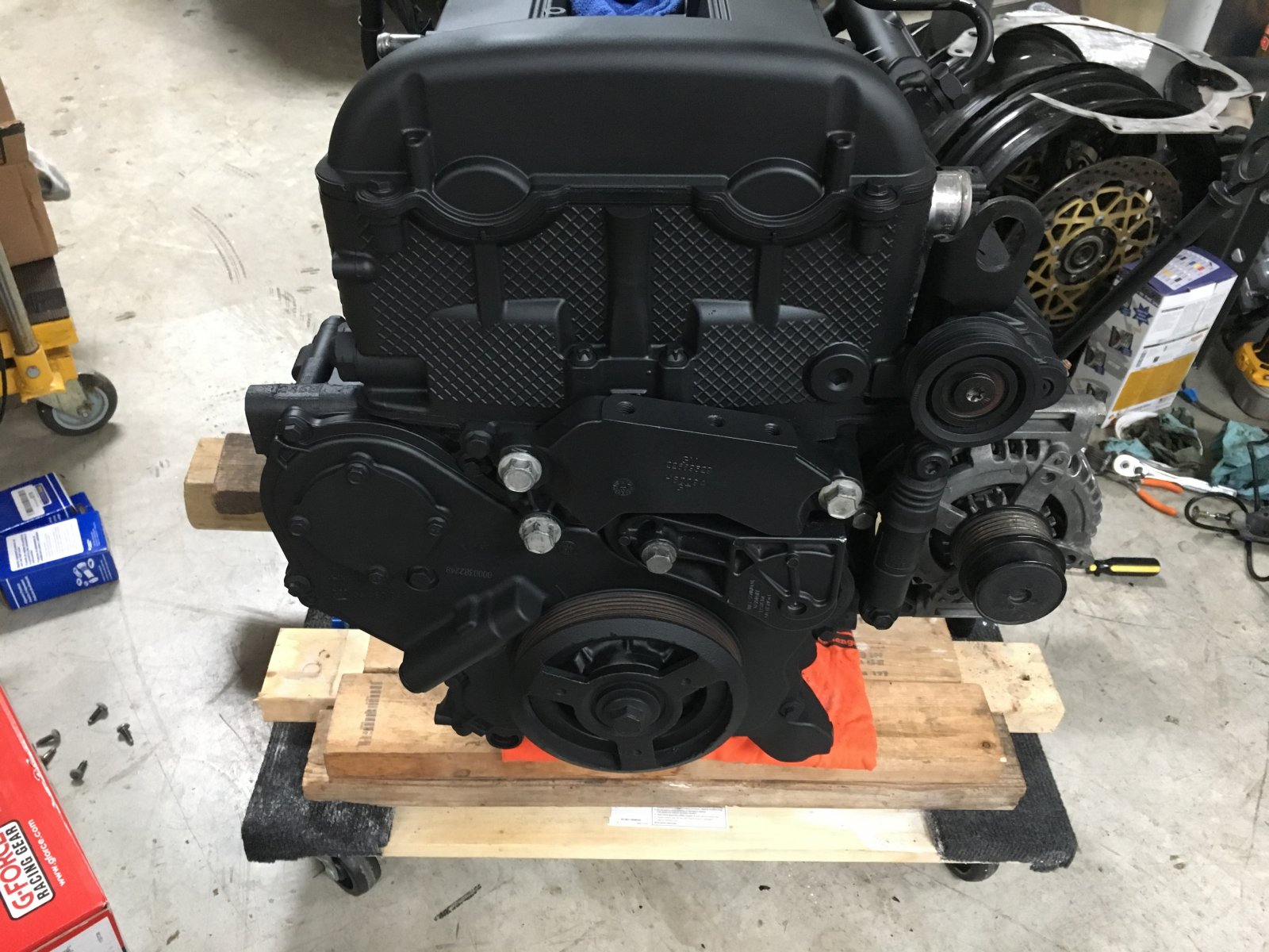

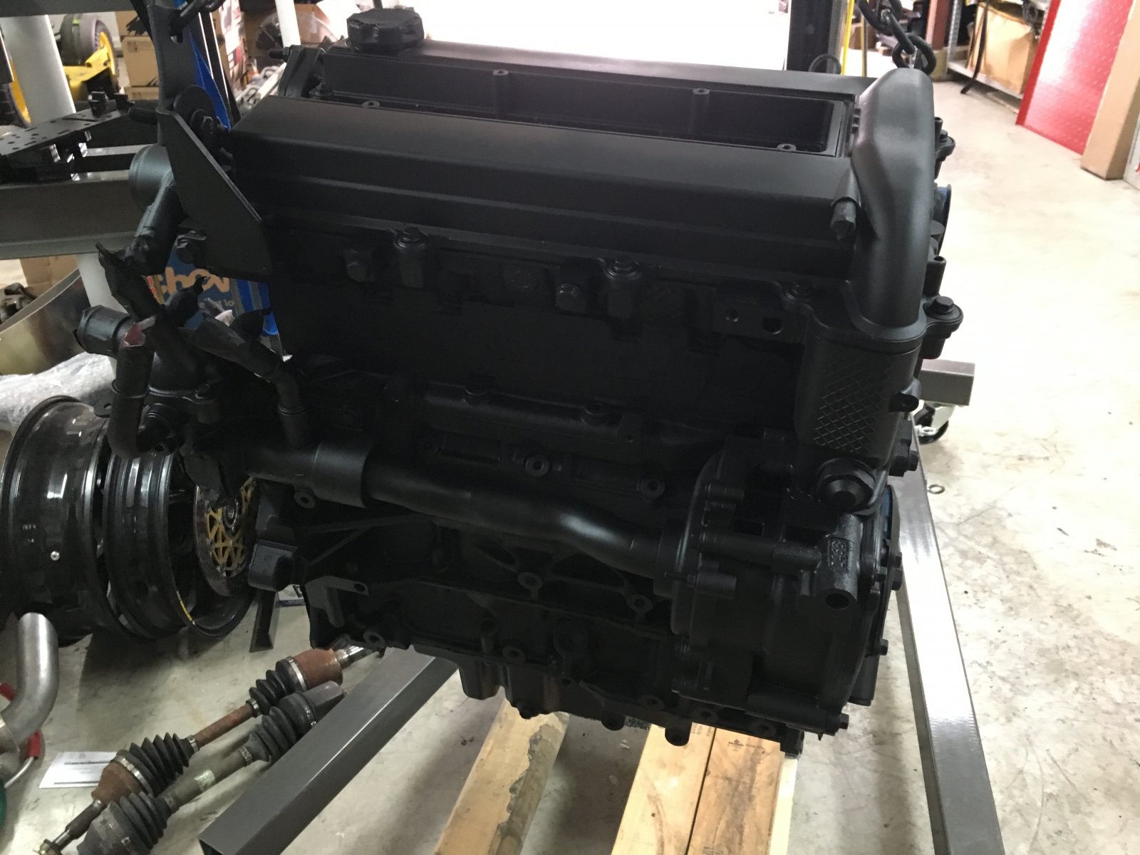

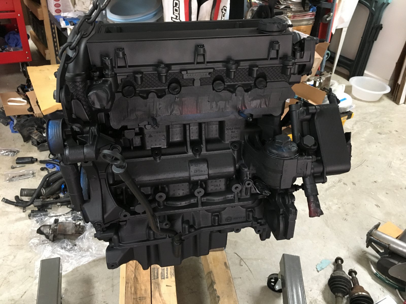

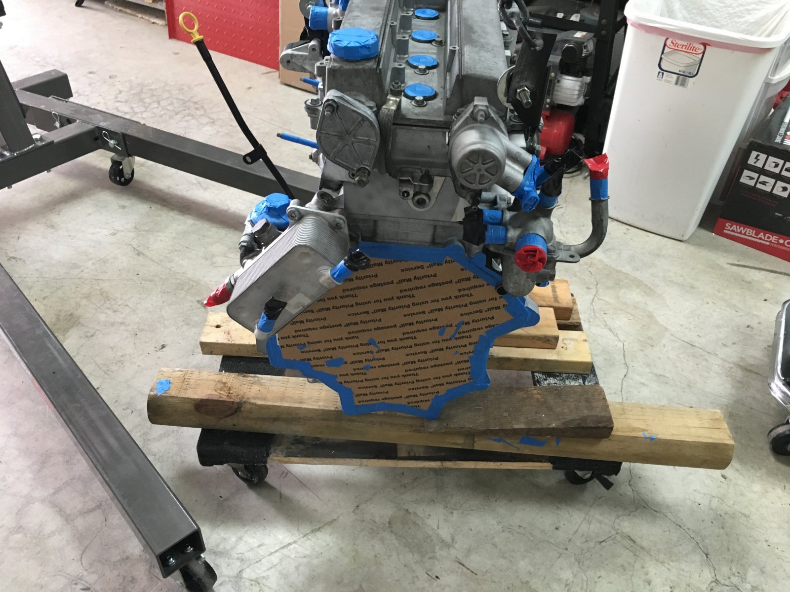

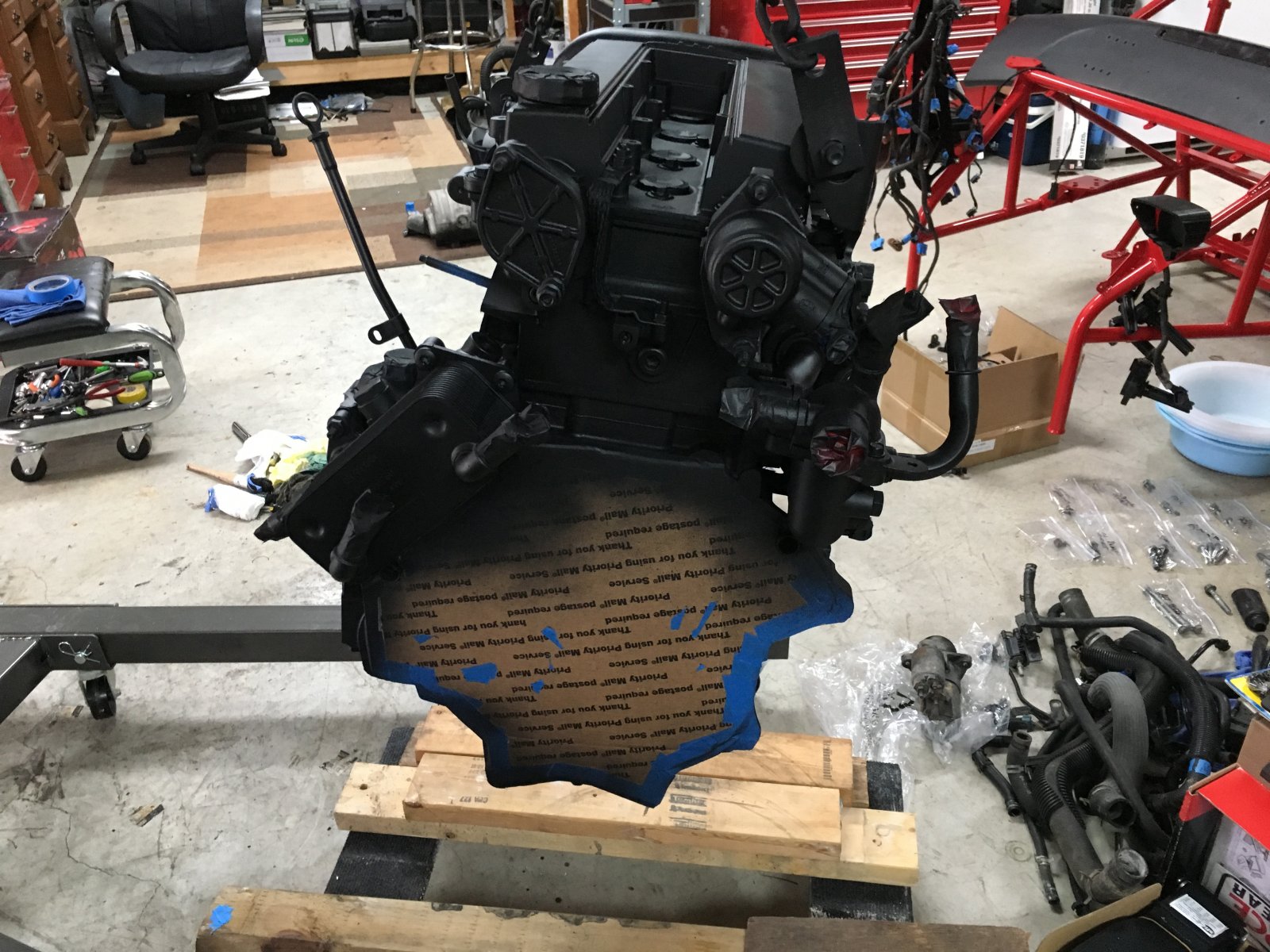

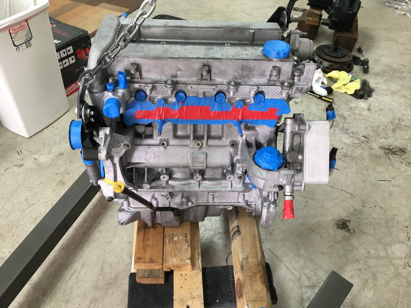

Some slow progress over the last couple of weeks. I'm nearly finished with cleaning and painting:

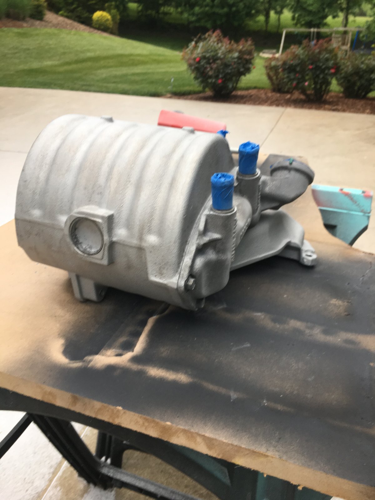

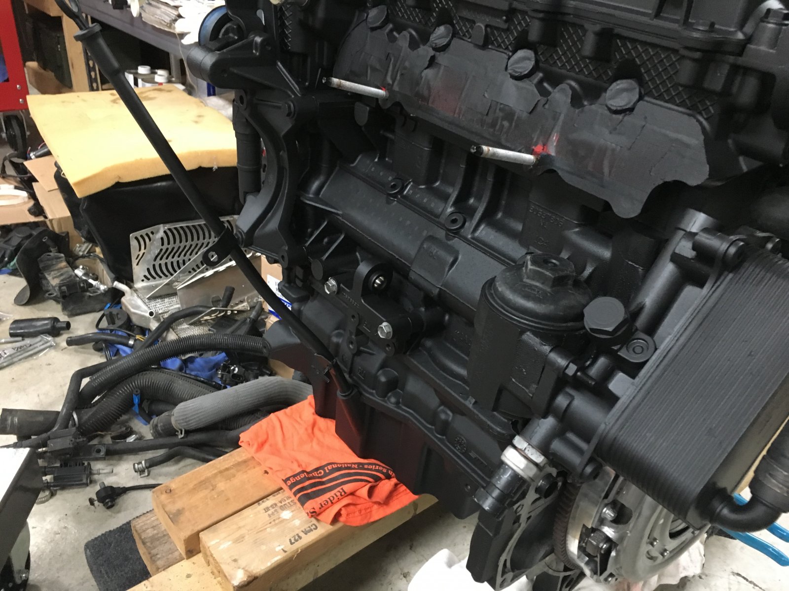

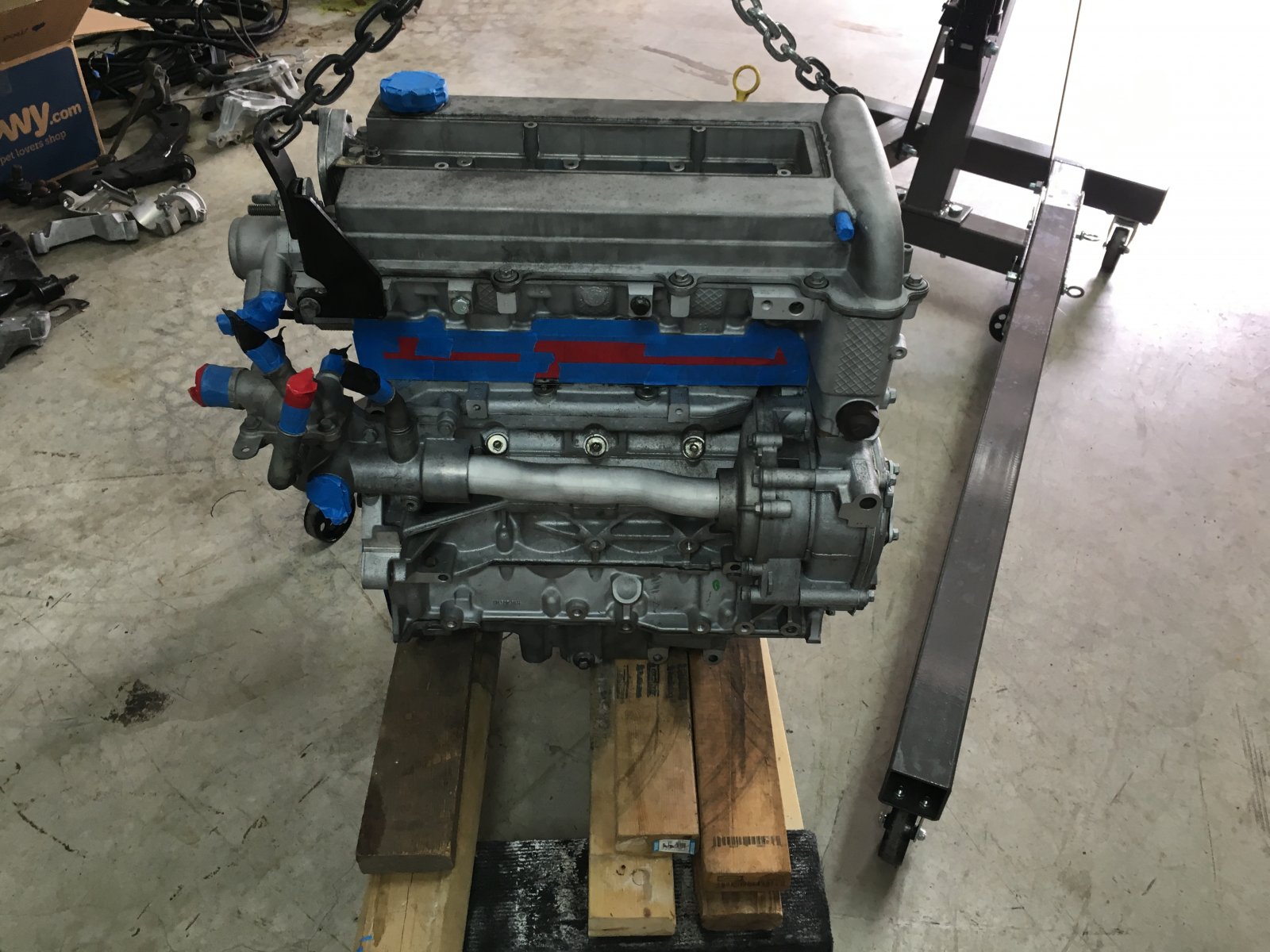

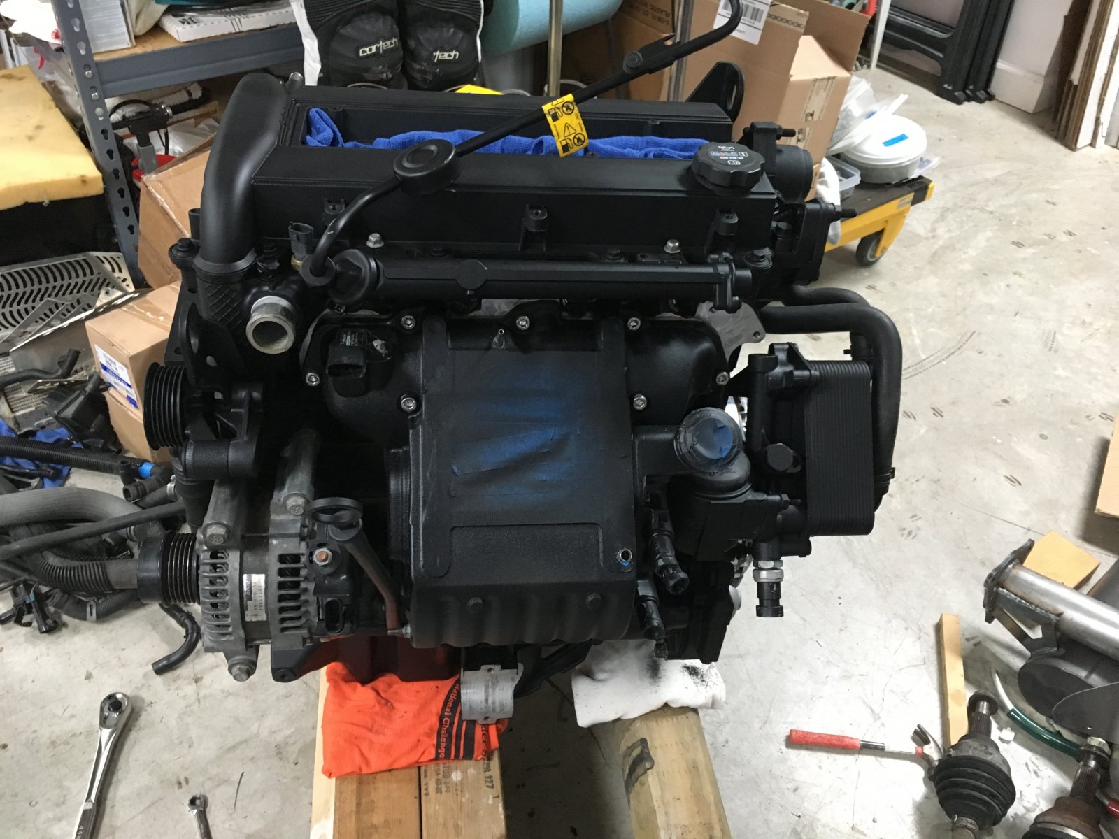

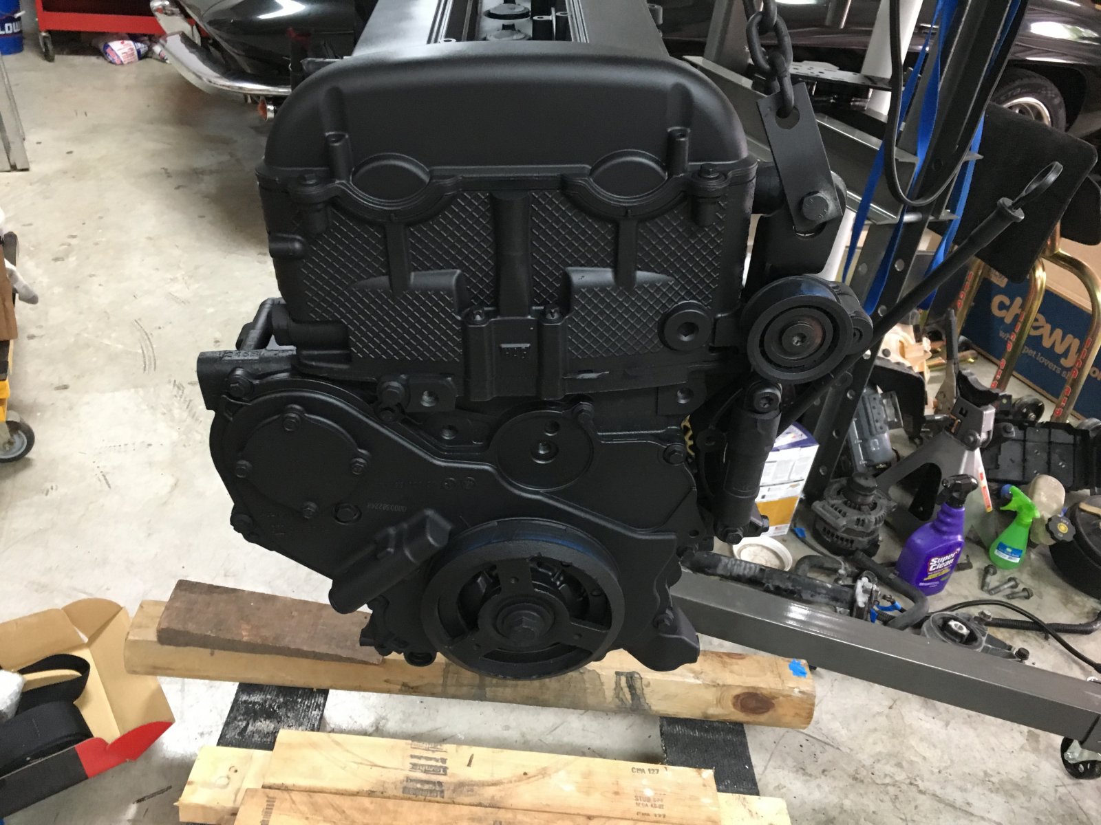

Here are some more:

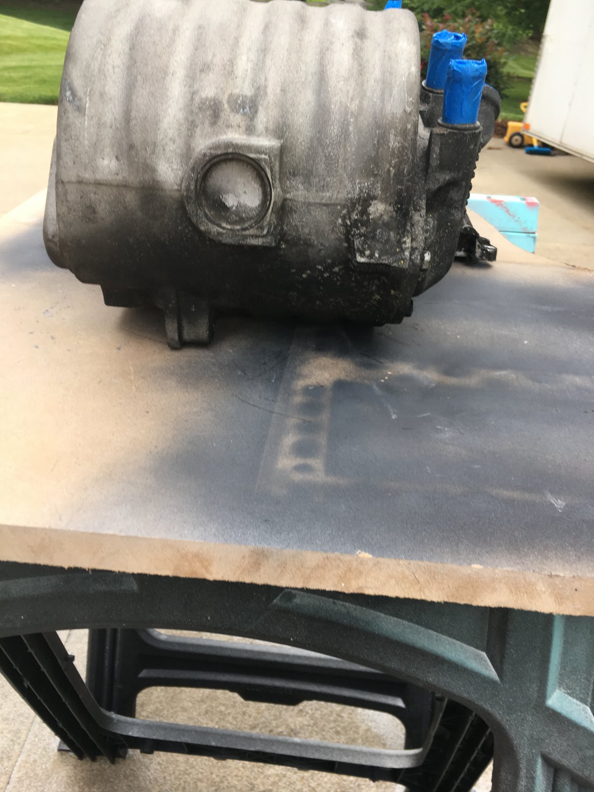

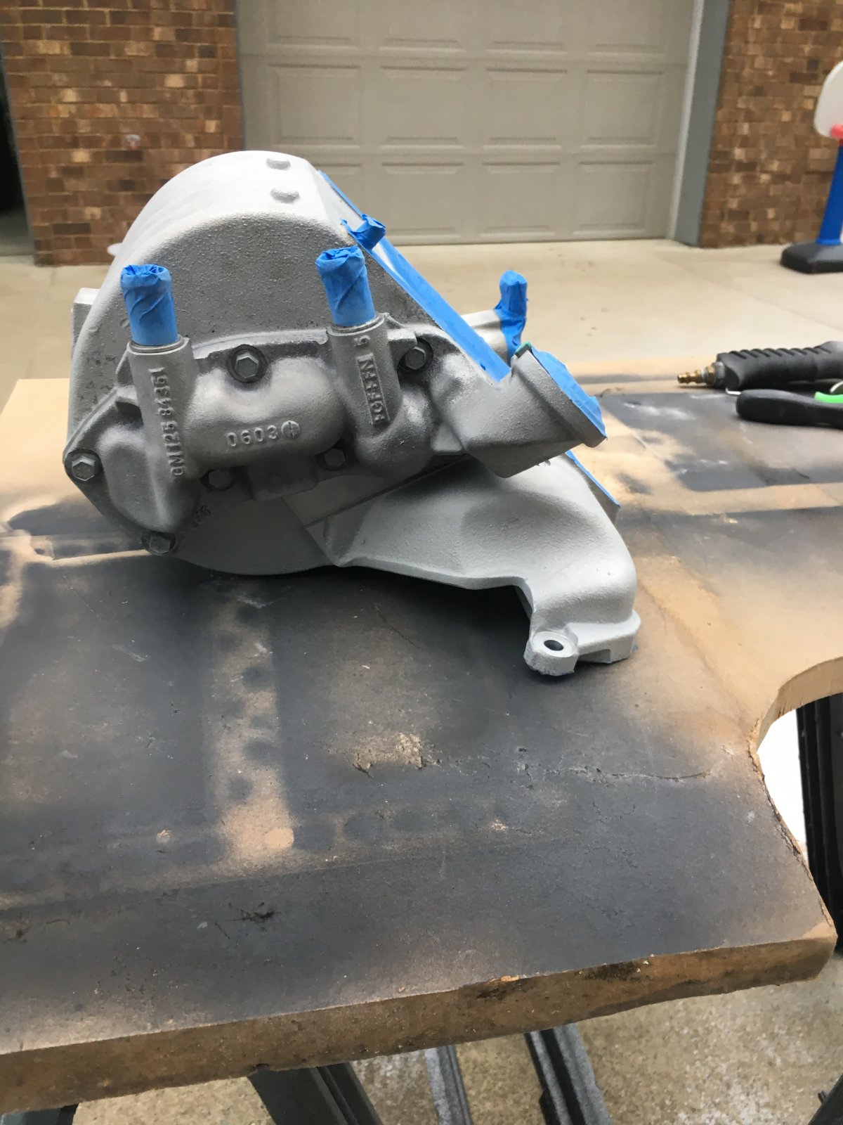

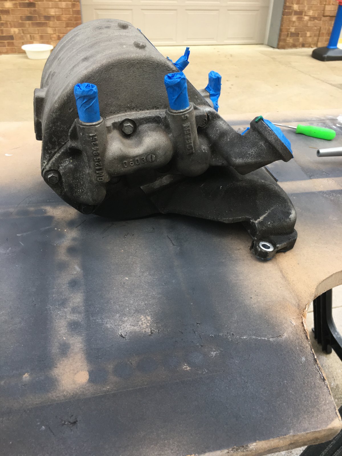

The soda blasting really cleaned up the intercooler/intake manifold well!

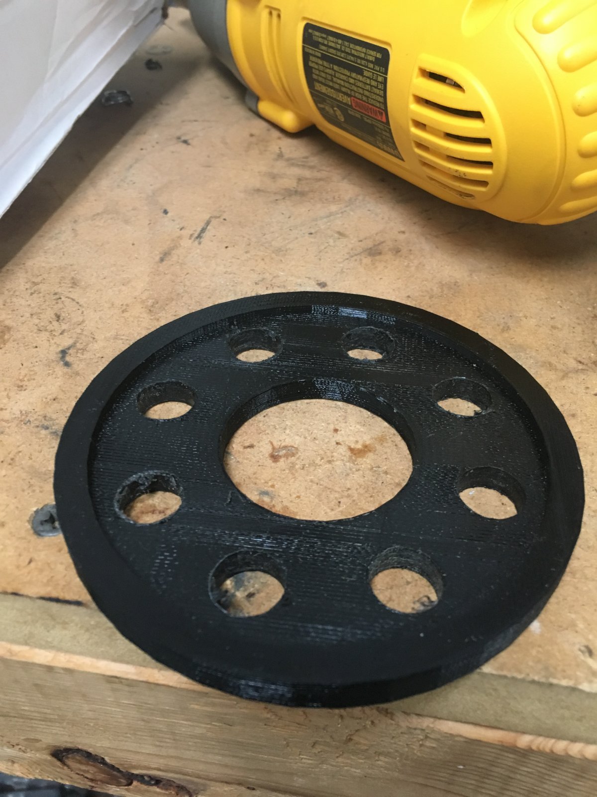

I noticed the rear main seal was ever so slightly leaking, so I replaced it with a new Fel Pro seal and made this little tool to seat it in without having to beat on it.

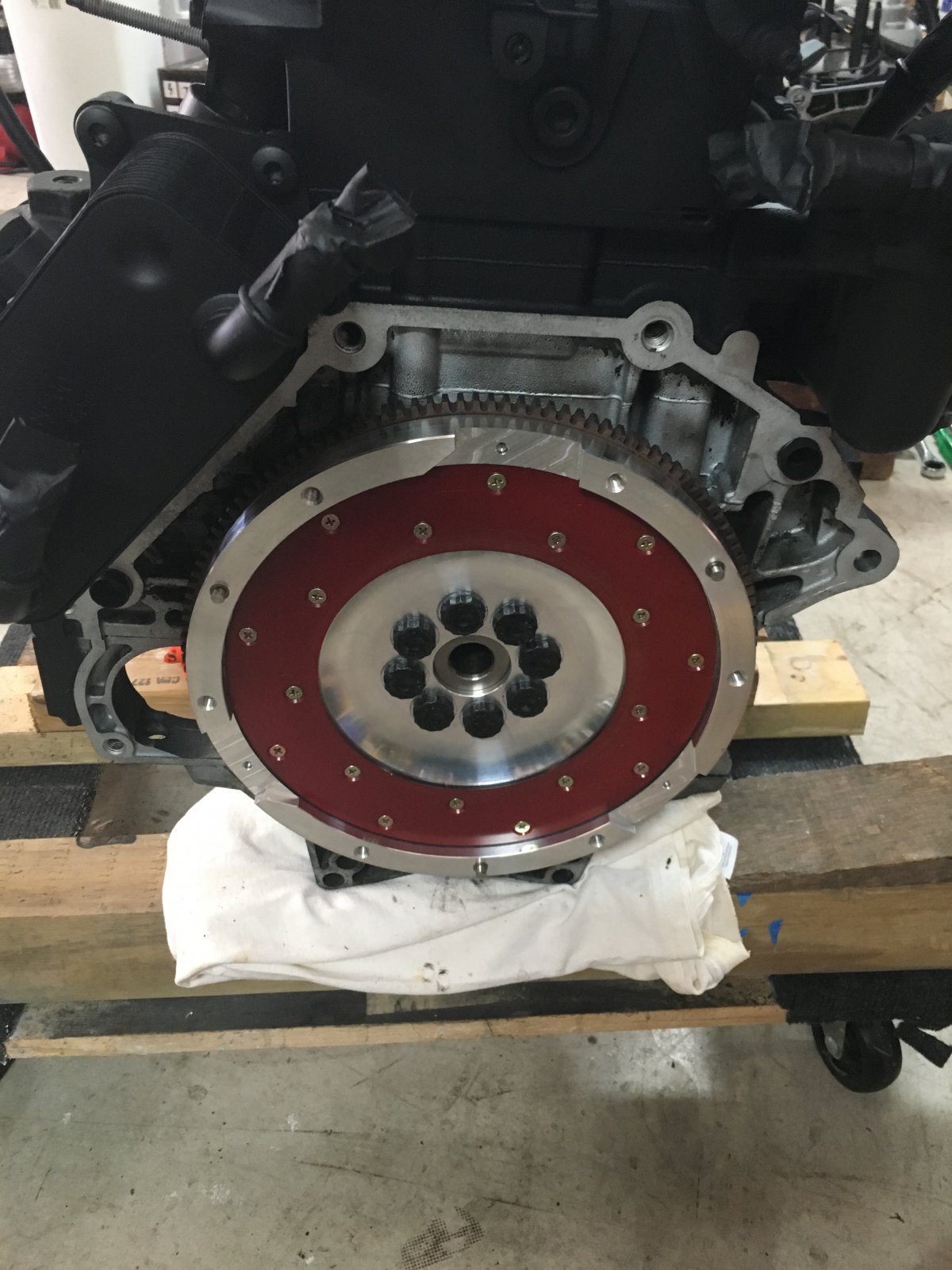

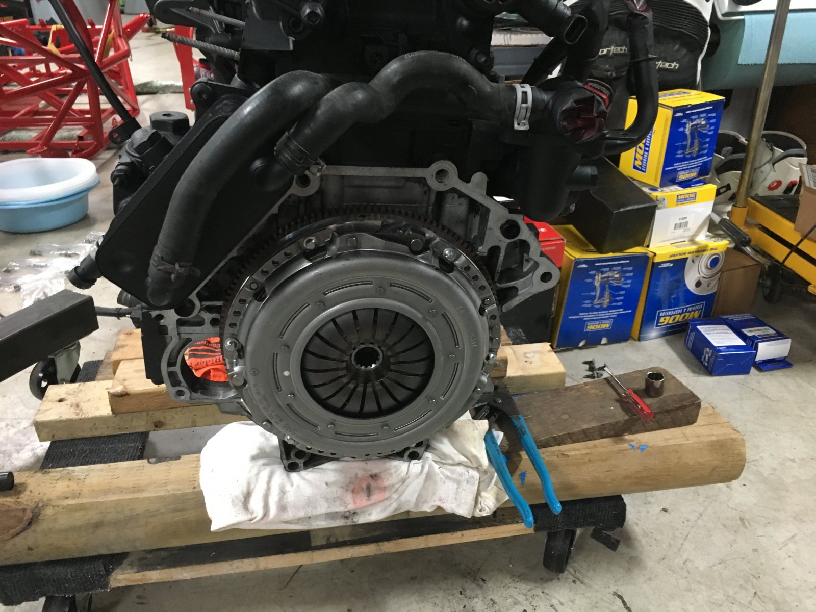

Here is the ZZP aluminum flywheel. I'm having issues with getting the stock type Exedy clutch to mount to it - none of the bolt holes on the pressure plate line up with the flywheel in any of the possible three positions - gonna talk with ZZP about that today. The flywheel bolts are from ARP and were an Opel/Vauxhaul part. There is a lot of discussion on the CSS board about the other ARP bolts made for the Cobalt that don't work because the bolt head is too thick, these fit great and don't rub the clutch disc.

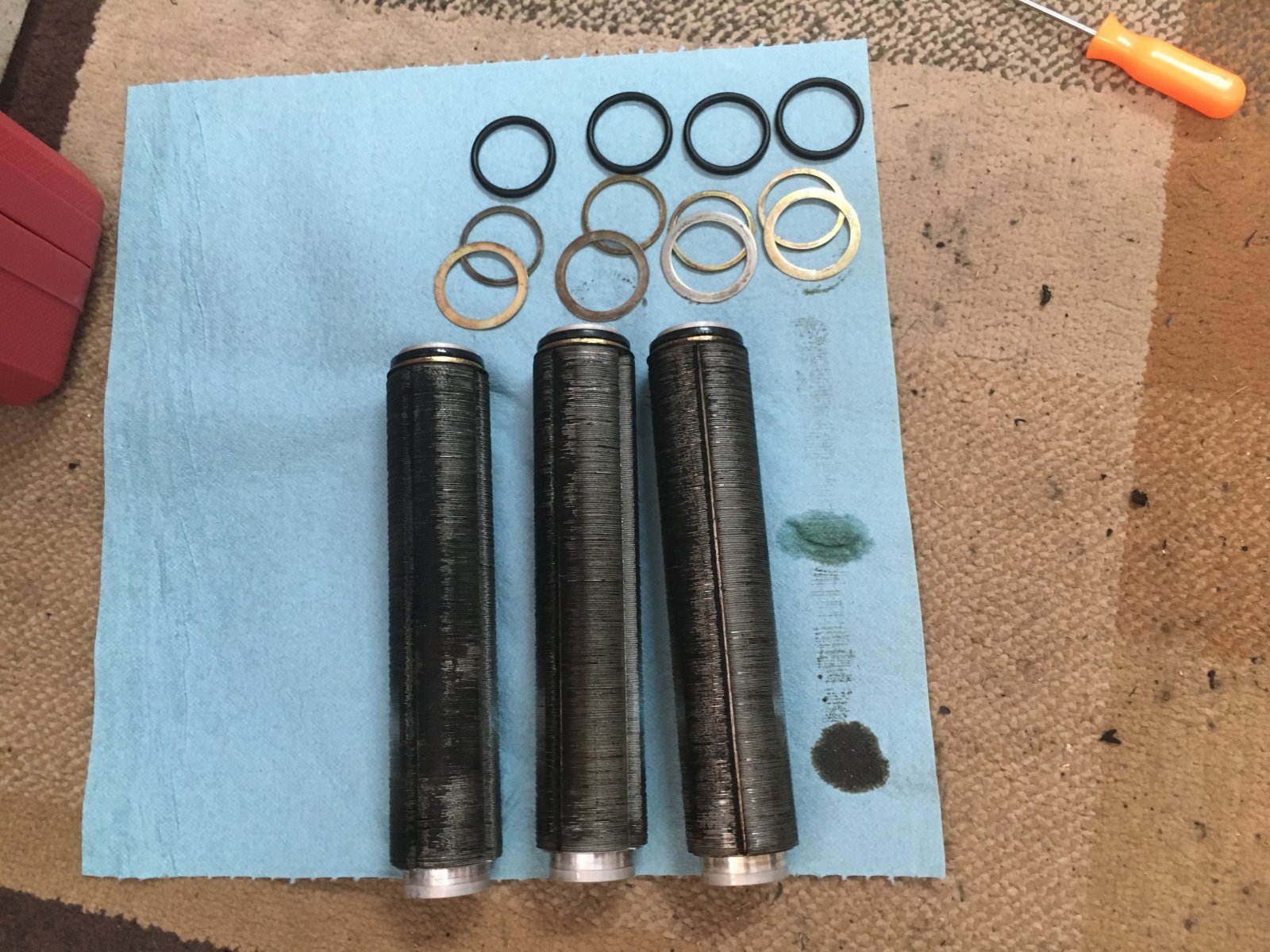

Laminova cores were nasty...

I installed the flydenza aluminum flywheel with the green friction surface. I did not have any issues. I'm sure it was gone the first time I drove it lol.
Nuker-
SliderR1
That coating was a PITA to get off the flywheel. I ended up using a scotchbrite pad and brake clean.
So the pressure plate and clutch disc that was on this car did NOT fit the aluminum flywheel from ZZP. Both pieces were Exedy parts, and I'm assuming were matched to the flywheel that was on the engine. I ended up just buying a new upgraded LSJ clutch kit and it fit the flywheel perfectly. I now have an extra throwout bearing that I'll sell if anyone needs one.

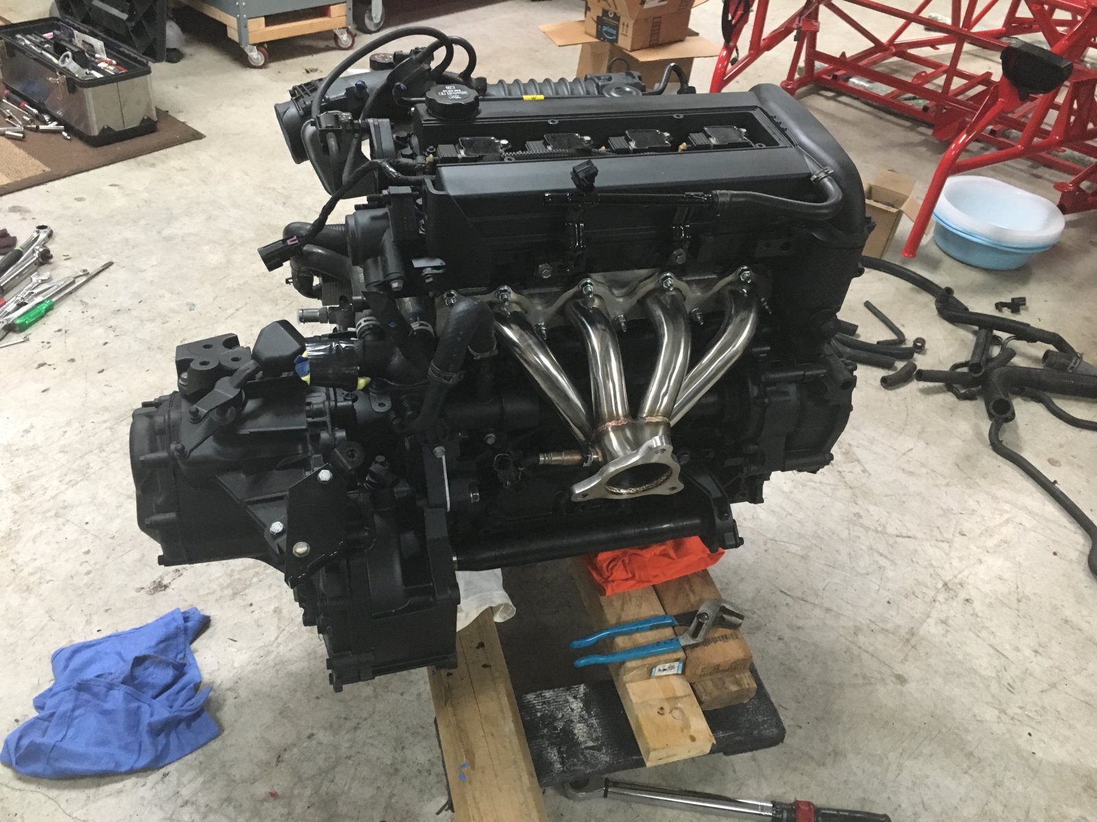

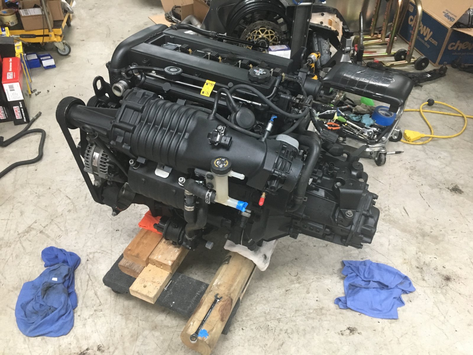

Got a little more engine assembly completed over the long weekend. I'm glad that someone mentioned clocking the laminova tubes in another thread becuase I forgot. Once I got that taken care of, I installed the intake with the new phenolic intake spacer. I also made a little fuel injector cleaner with a syringe and a 9 Volt battery - worked like a charm. Progress is slow but steady...
SliderR1

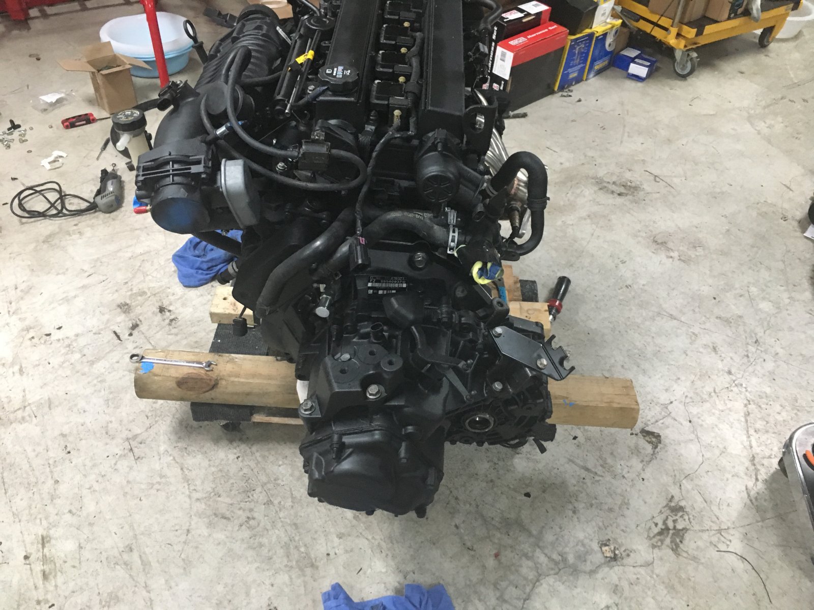

Been at it hard for the last three days and have some progress to add to this thread.
Engine is basically finished now - just need to add some sheathing to the harness when my order is delivered.

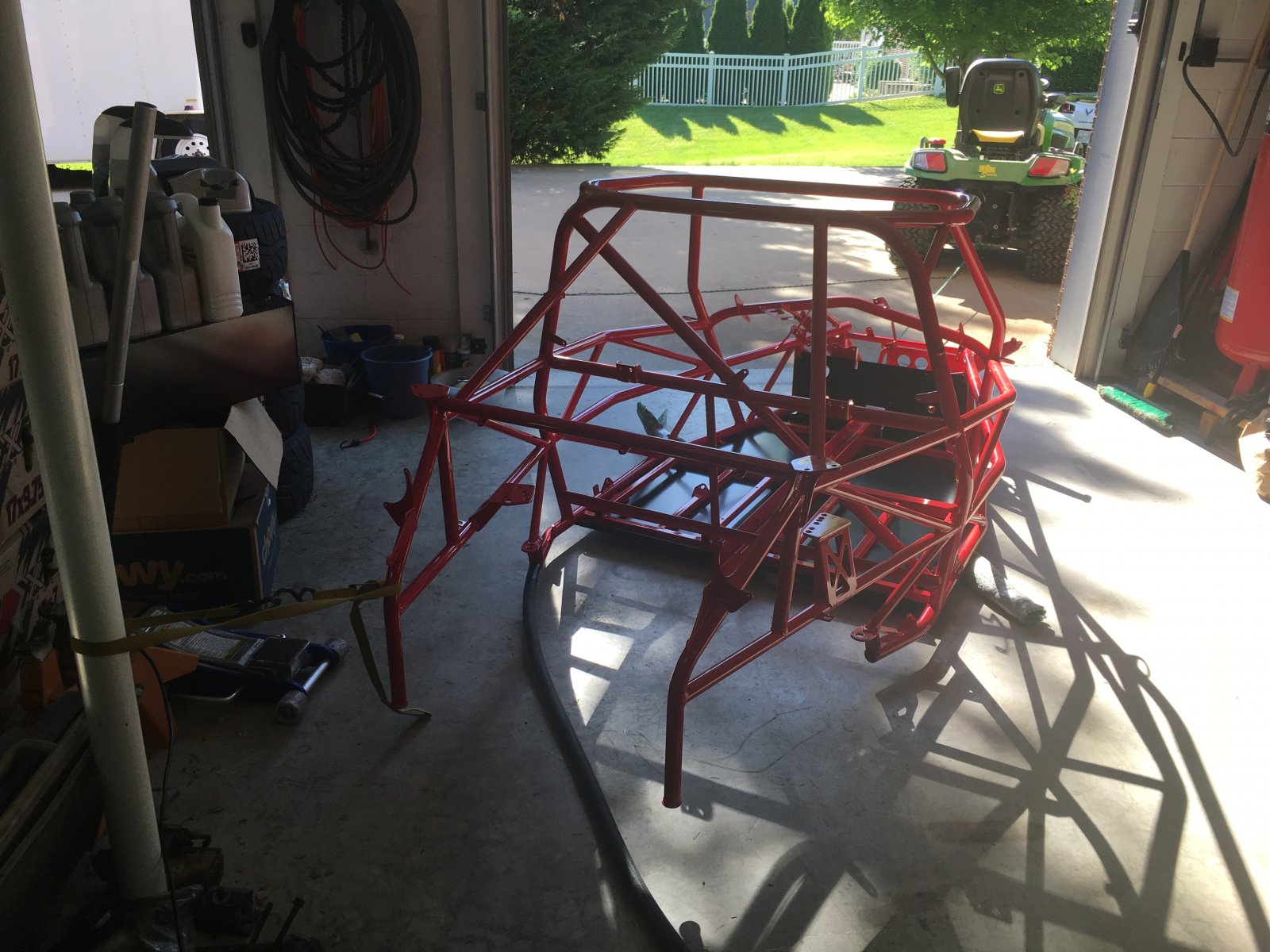

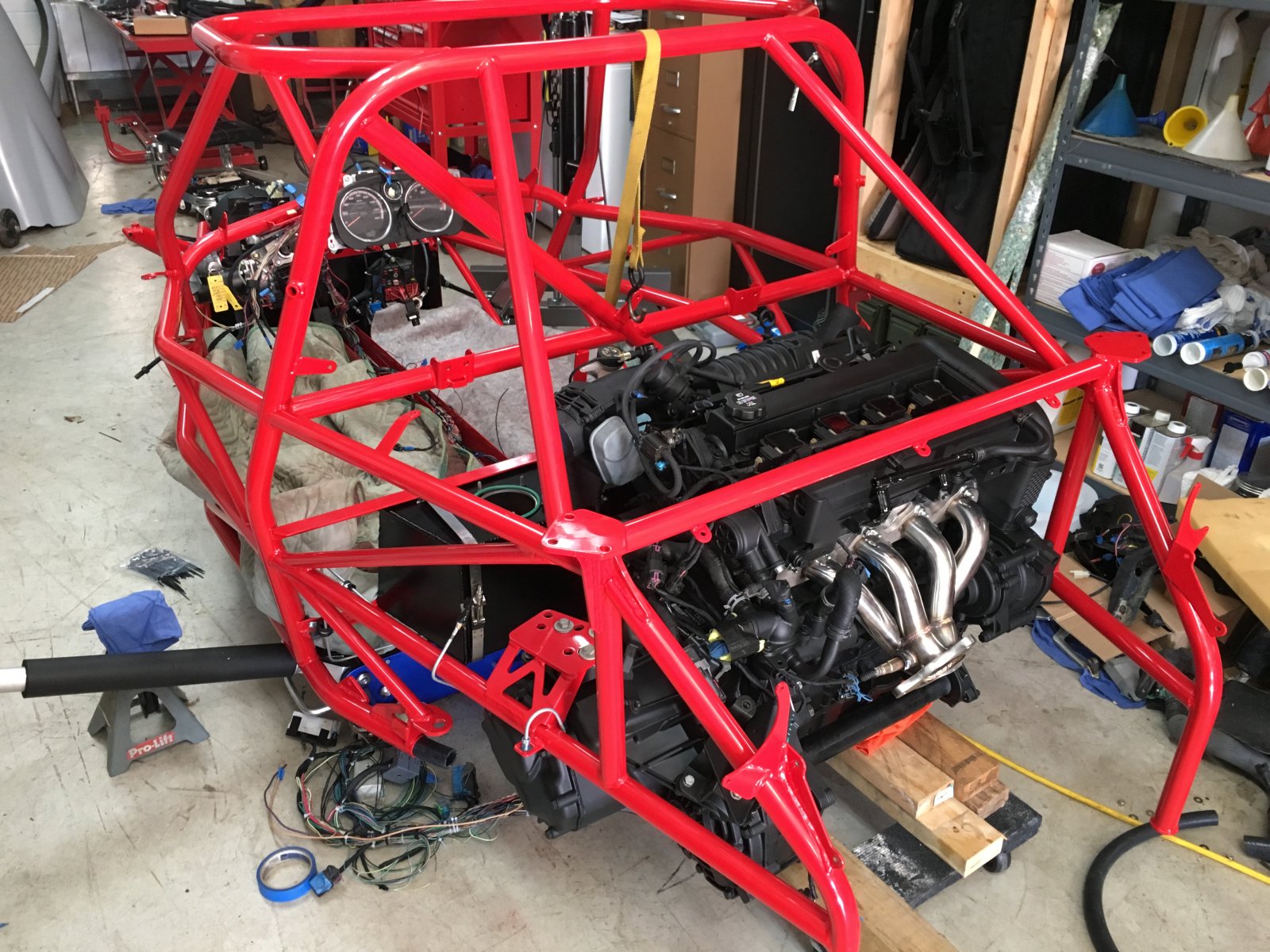

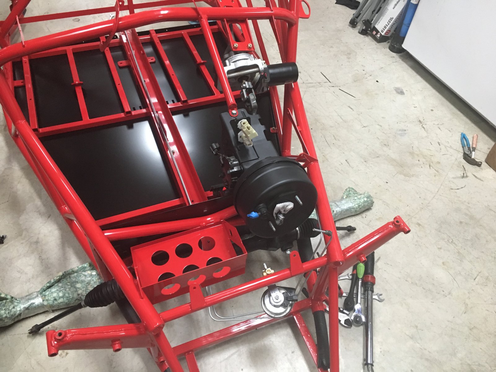

So I accomplished a pretty big milestone yesterday and got both the radiator hoses installed in the lower frame tubes, by myself. I did have a little help with a John Deere tractor. Didn't even take 1 minute to pull them through with it.
Once that was finished I started assembly on the actual car. I think things are going to go a lot faster now!

Sure are gutsy tying up to the support pole. o_O
Funny because I used our JD to pull them through also but tied the frame the hitch on the truck.

Got a lot done this weekend.

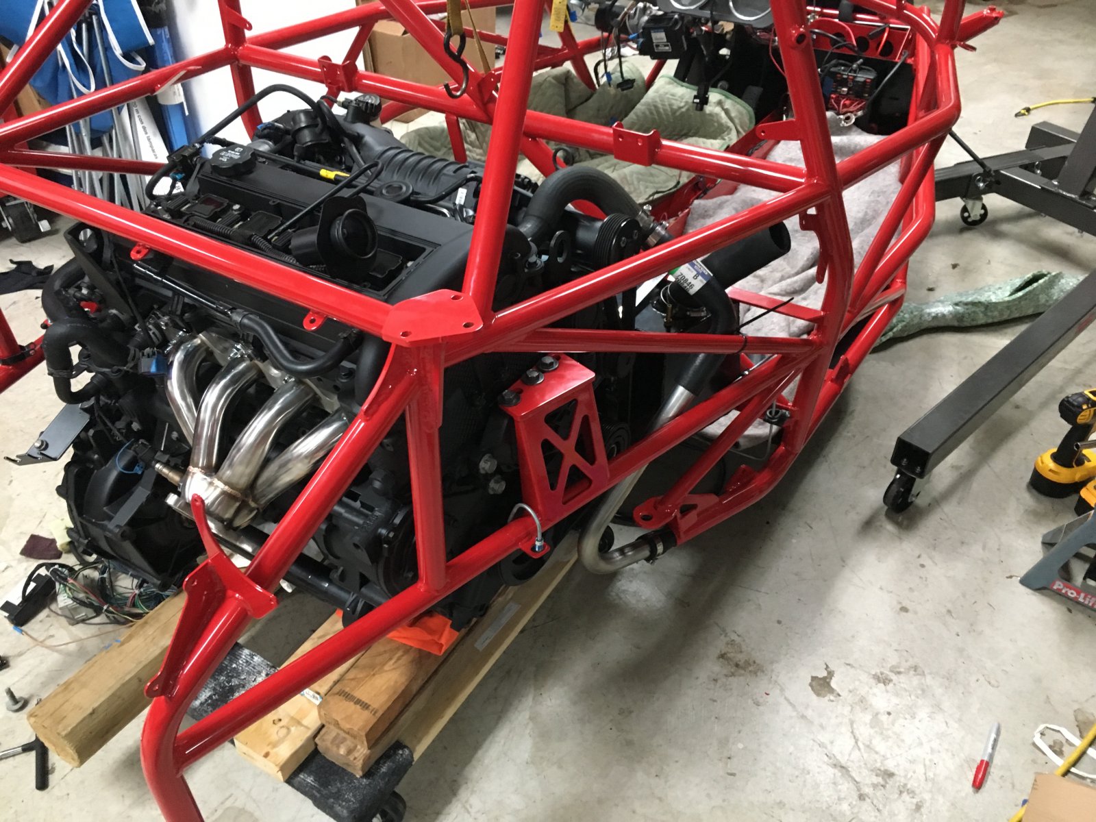

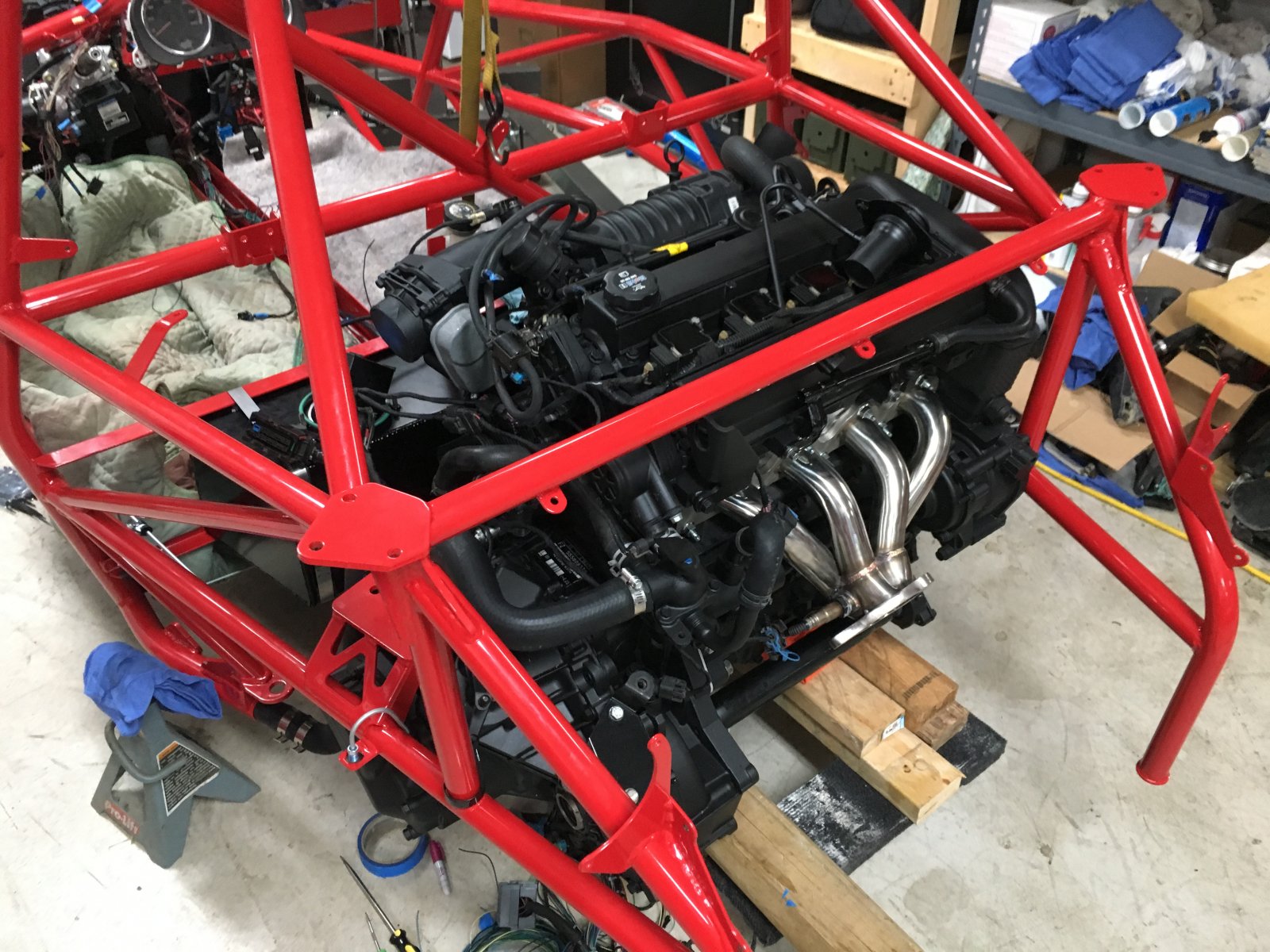

Engine is in now. Engine cooling system is hooked up. Now working on a custom mount for the fuse box - I has similar issues that others have mentioned about getting it to fit in the as designed location. A simple tab should fix that.
My radiator mounts were quite a ways off. Spent some time getting that fixed. Engine mounts lined up great!

Thanks! Engine is PJ1 Fast Black from rattle cans. Its pricey but lays down really nice for a rattle can...
