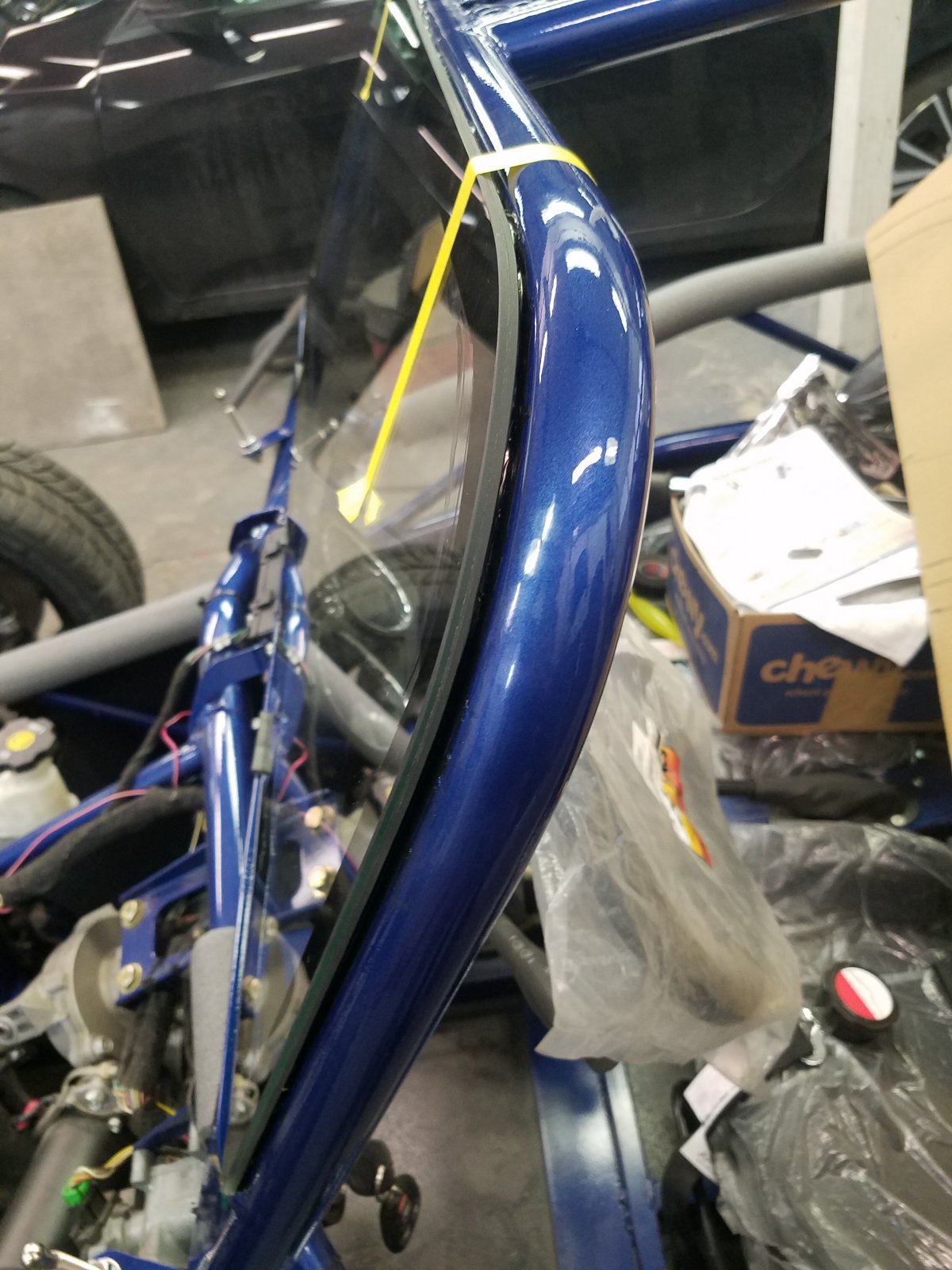

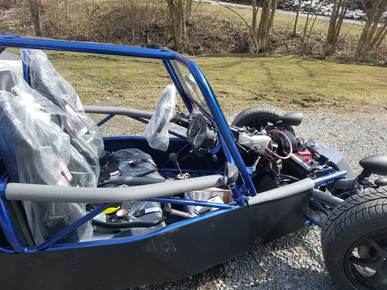

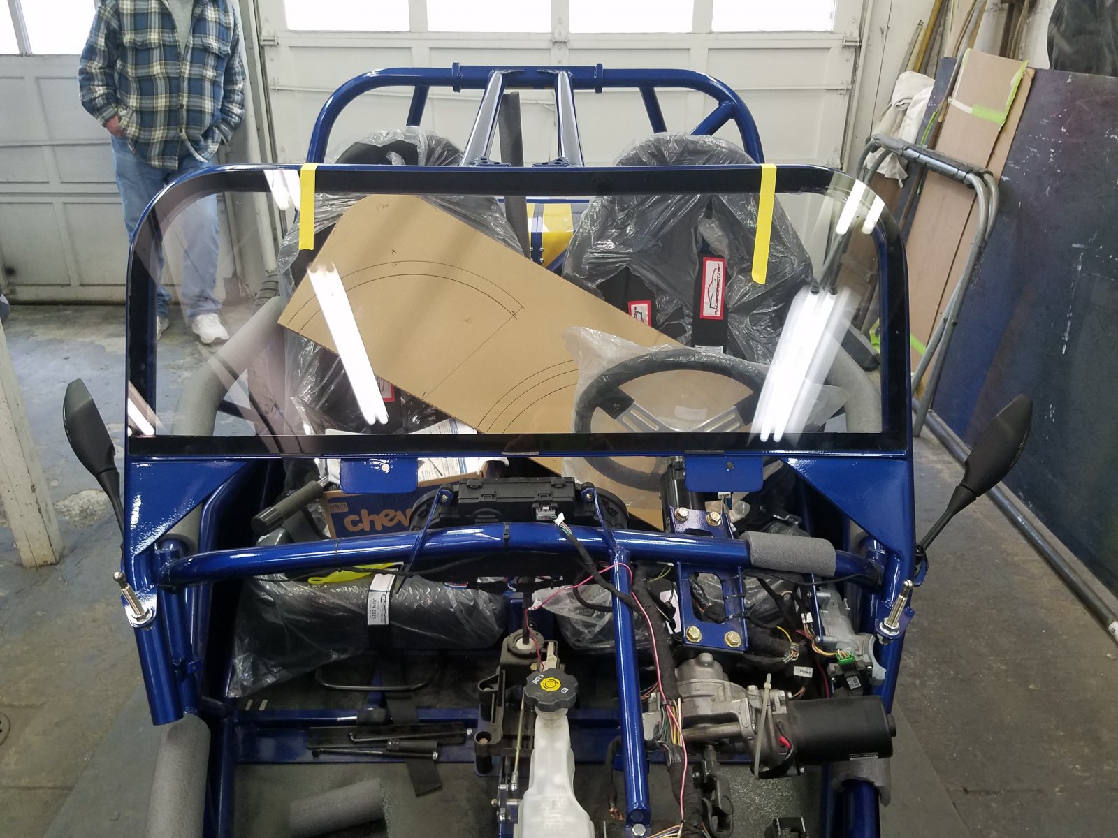

Speaking of the center bars and windshield frame. My brother had some time to get the windshield frame painted for me. He gave me a hand installing it and the windshield glass. I am getting closer to meeting my end of march goal. But there is still a lot of boxes to check off .

How will the front cowl fit against the base of the windshield frame? Do you have enough 'knuckle room' between the windshield and steering wheel?
How will the front cowl fit against the base of the windshield frame? I am working on that this week, as of now the hood will sit right against the lower edge of the glass.
Do you have enough 'knuckle room' between the windshield and steering wheel? As it sits now I would guess about 4 to5" of clearance. plenty comfortable right now. I am planning on a removable wheel so I may shorten the column or lower it some time will tell.

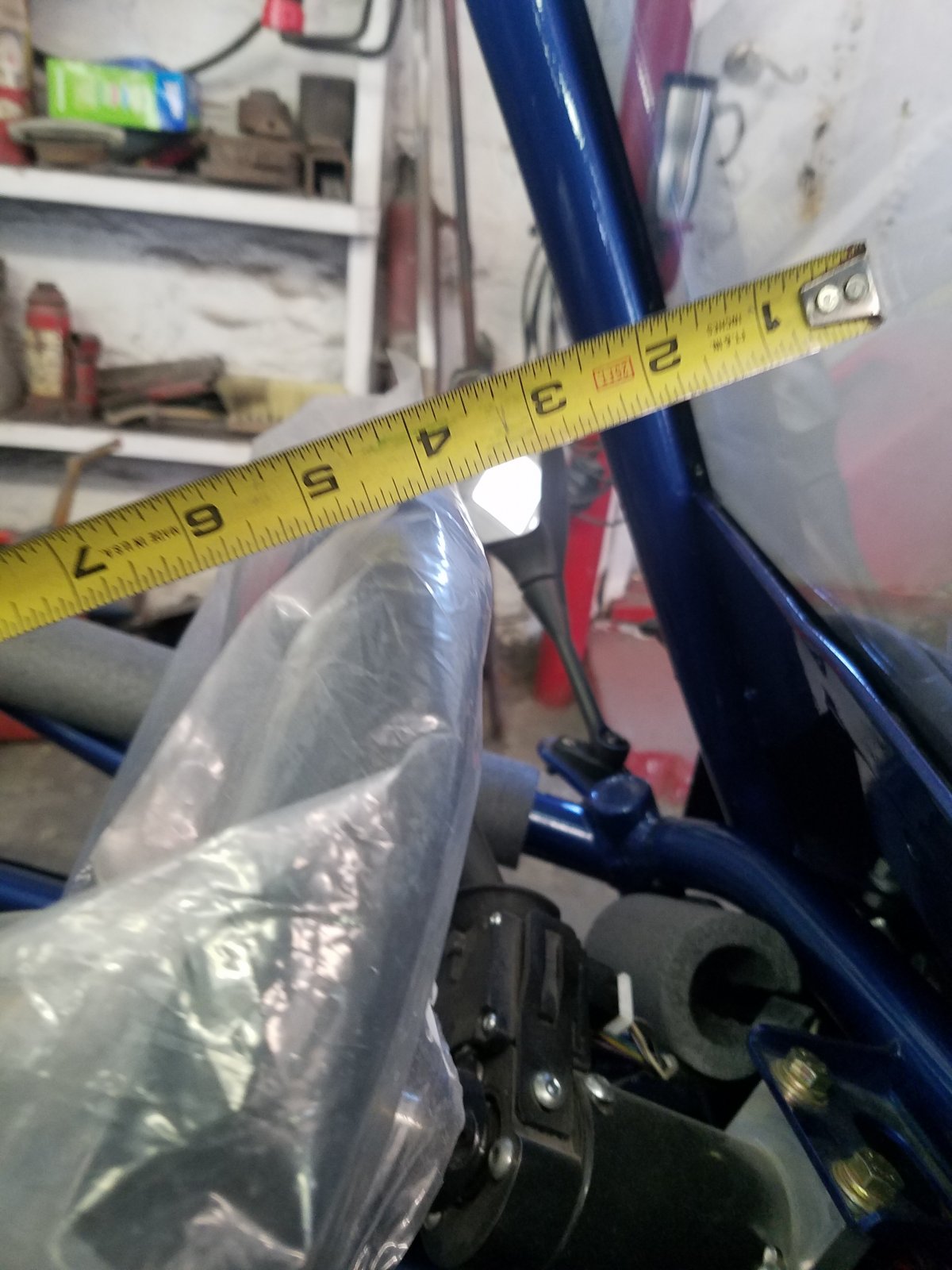

Here are some pictures of the clearance from the windshield. I have just about 4" of clearance to the glass from the wheel.

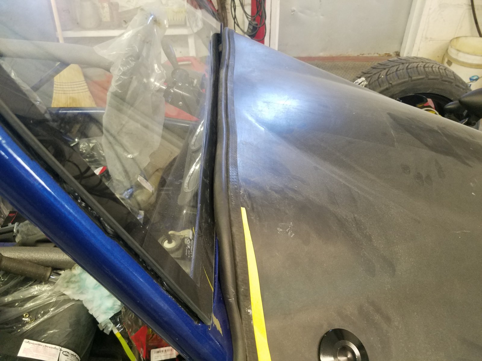

Well back when I stripped the donor I kept the cowl to hood gasket in hopes to use it where the hood meets the glass. I have a little trimming to do on the hood but it looks like it will work. A few pockets for the wiper arms and it should be good.
