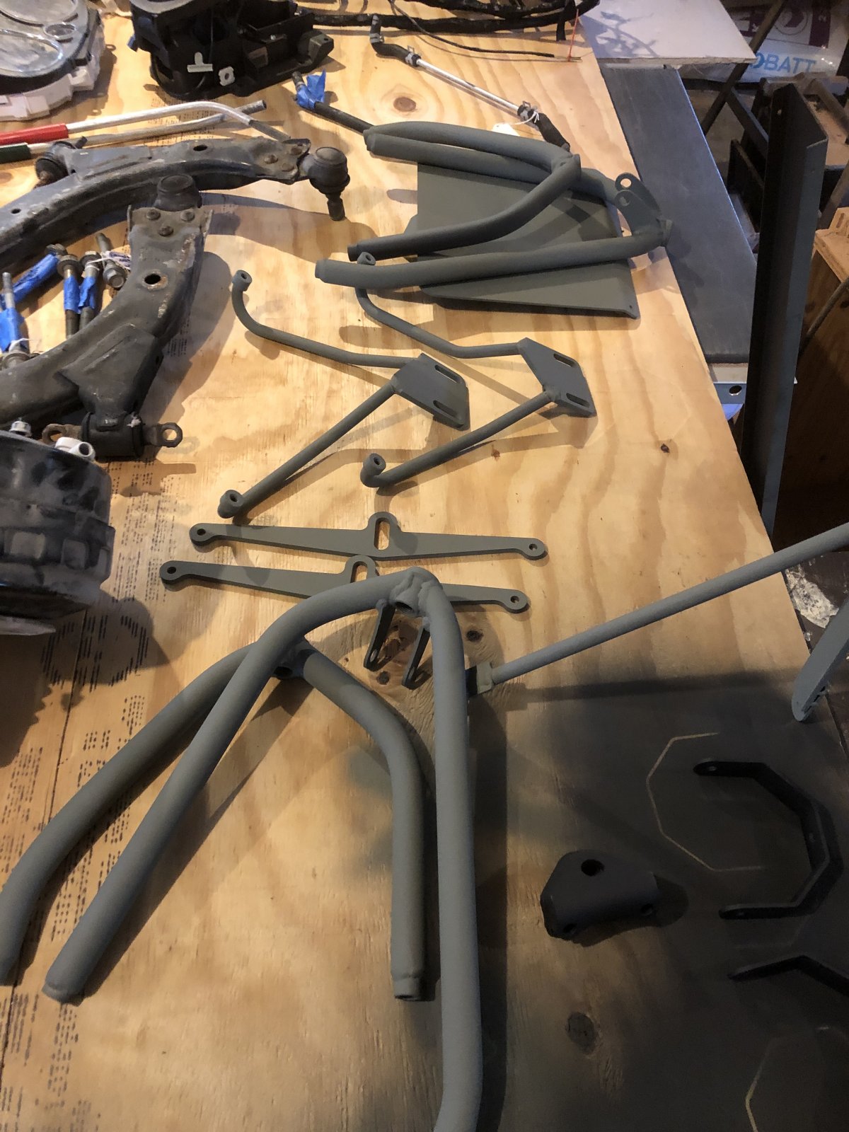

Yeah, these are the questions I have been wrestling with. I’m seriously thinking about going with Raptor tintable coating. They have a nice silver grey color. Planning to paint the body panels lime green. With an off center racing stripe in white.Powder coating is easier - unless you're doing it- but the bedliner is likely tougher against damage, plus it is far easier to rework if needed. Depends upon the finish you want, shiny and bright or matte and rugged.
Just checked out your build, excellent job. I do believe that I am going with the Raptor liner on my frame parts and pieces. Only I’m going to spray my chassis a silver grey.I sprayed raptor liner and loved it. Respirator required as the stuff is quite harsh but it's easy to spray and have great results. Pics in my build

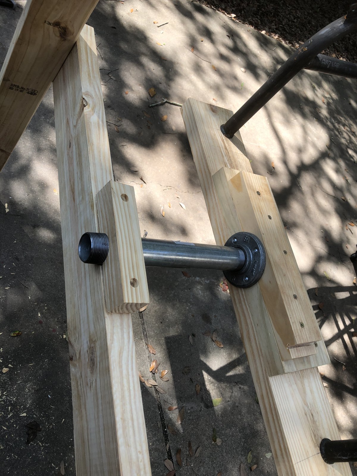

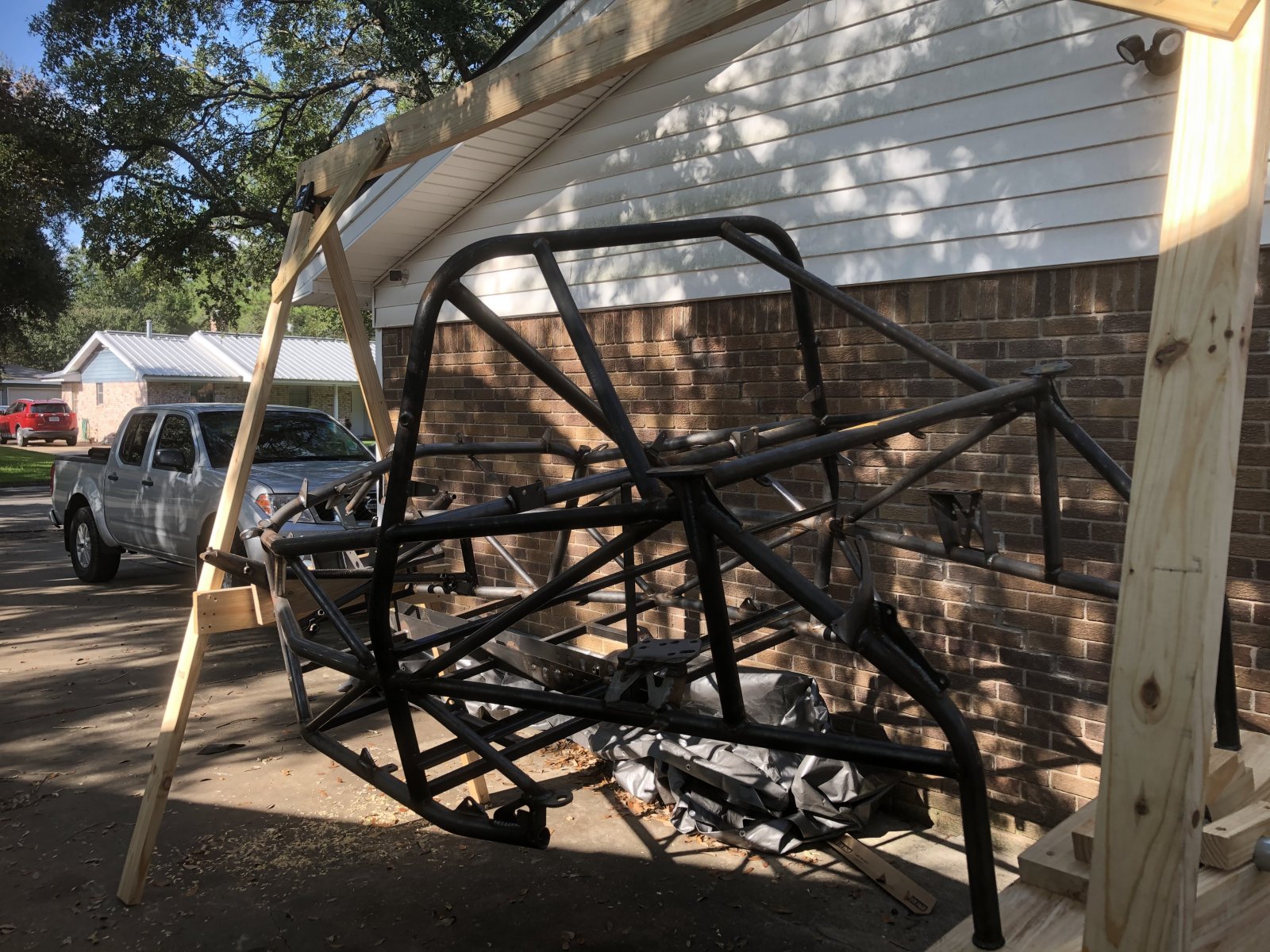

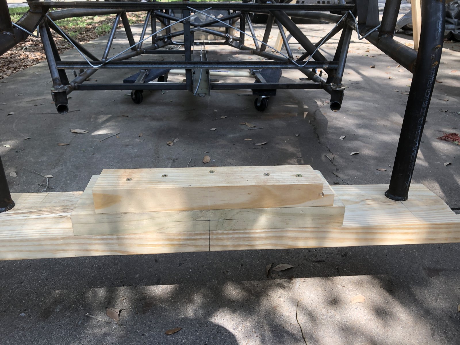

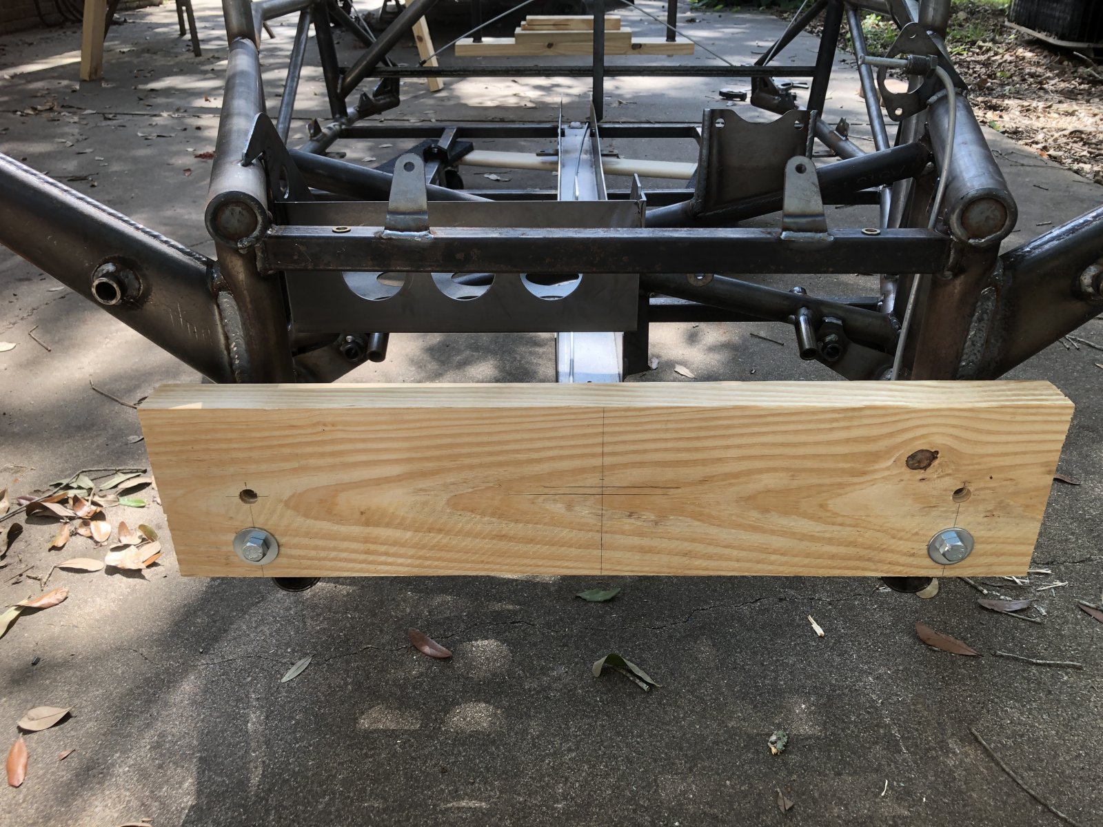

Pretty simple build. Used four 2x4x8 for legs, one sawhorse kit, and a 2x6x12. Some scrap wood to shore everything up steady. Used a pipe flange with a 1 1/4” x 12” nipple.Nice rotisserie. I was thinking of making one out of steel tubing, but if it gets only one use it seemed like a lot of money. The wood frame is a great idea and could be 'recycled' into any number of things later. Could you post some additional photos and overall dimensions? Thanks!![]()
