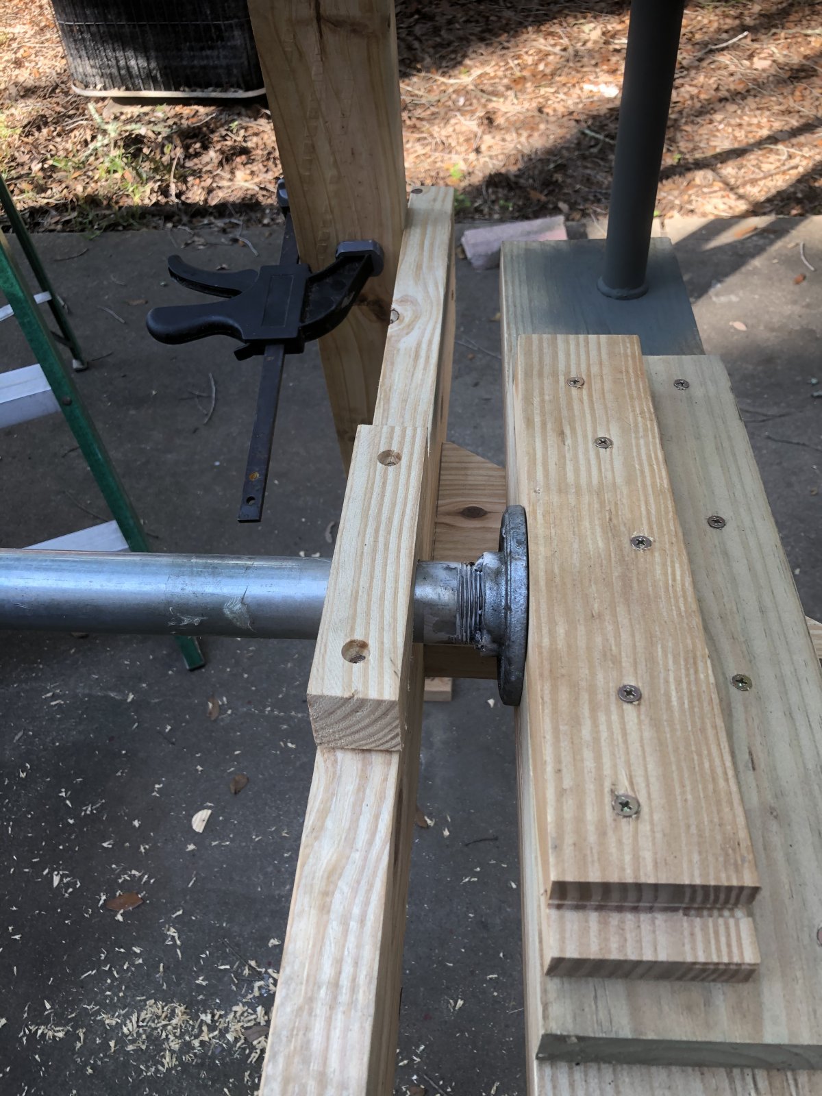

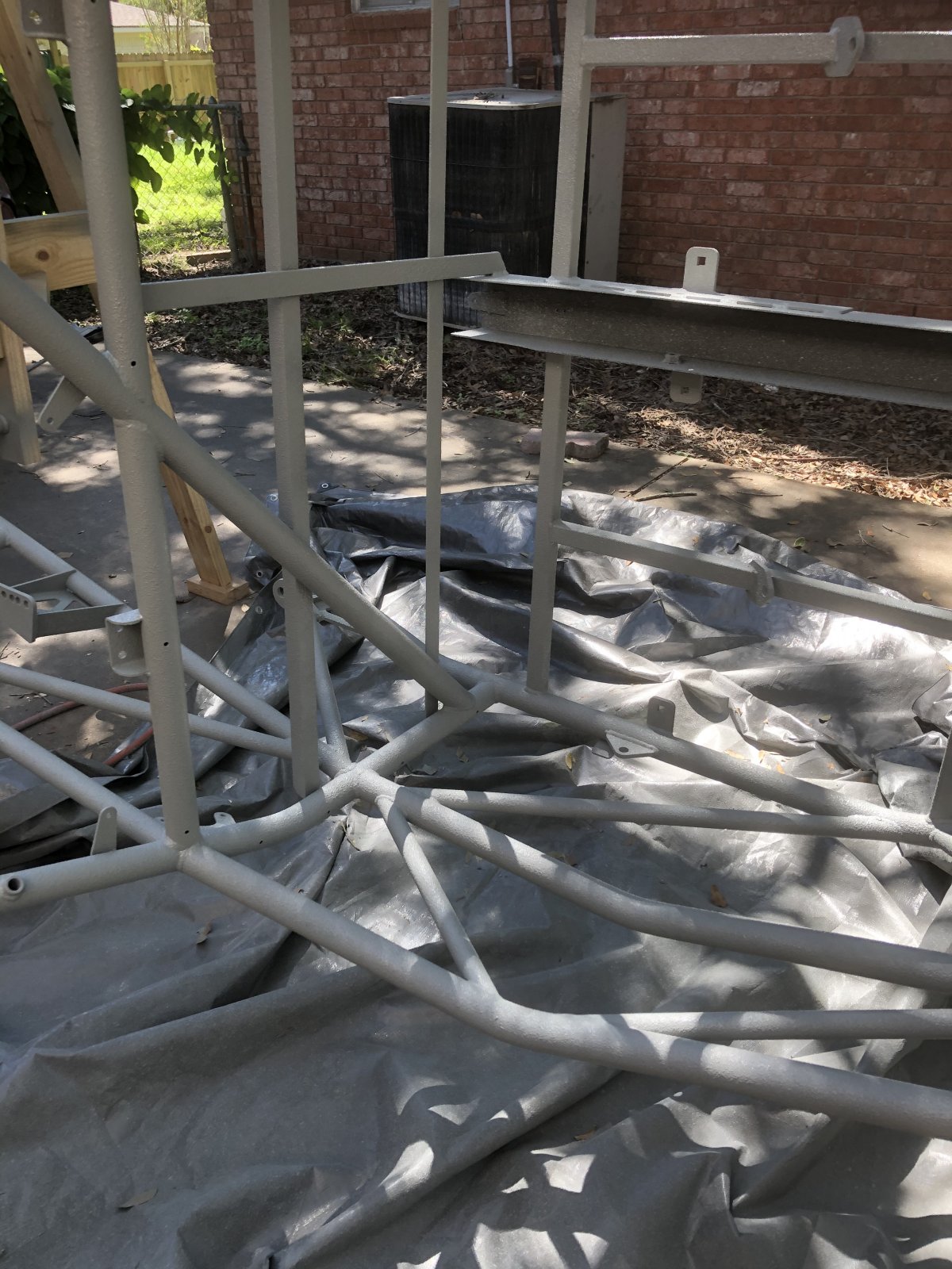

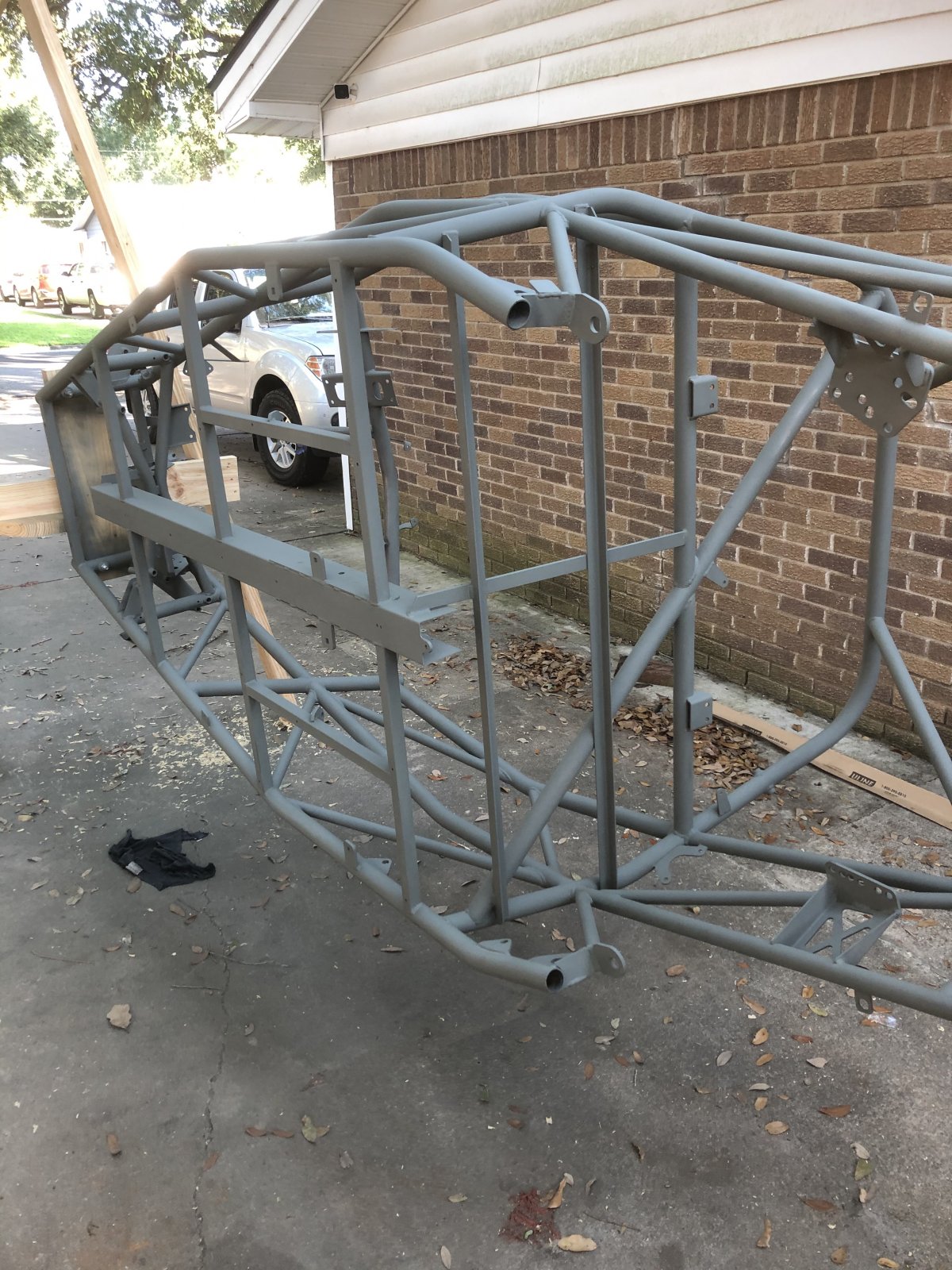

Chassis is etch primed. Went on nice and easy.
Added a block on each end to only allow 90 degree travel.

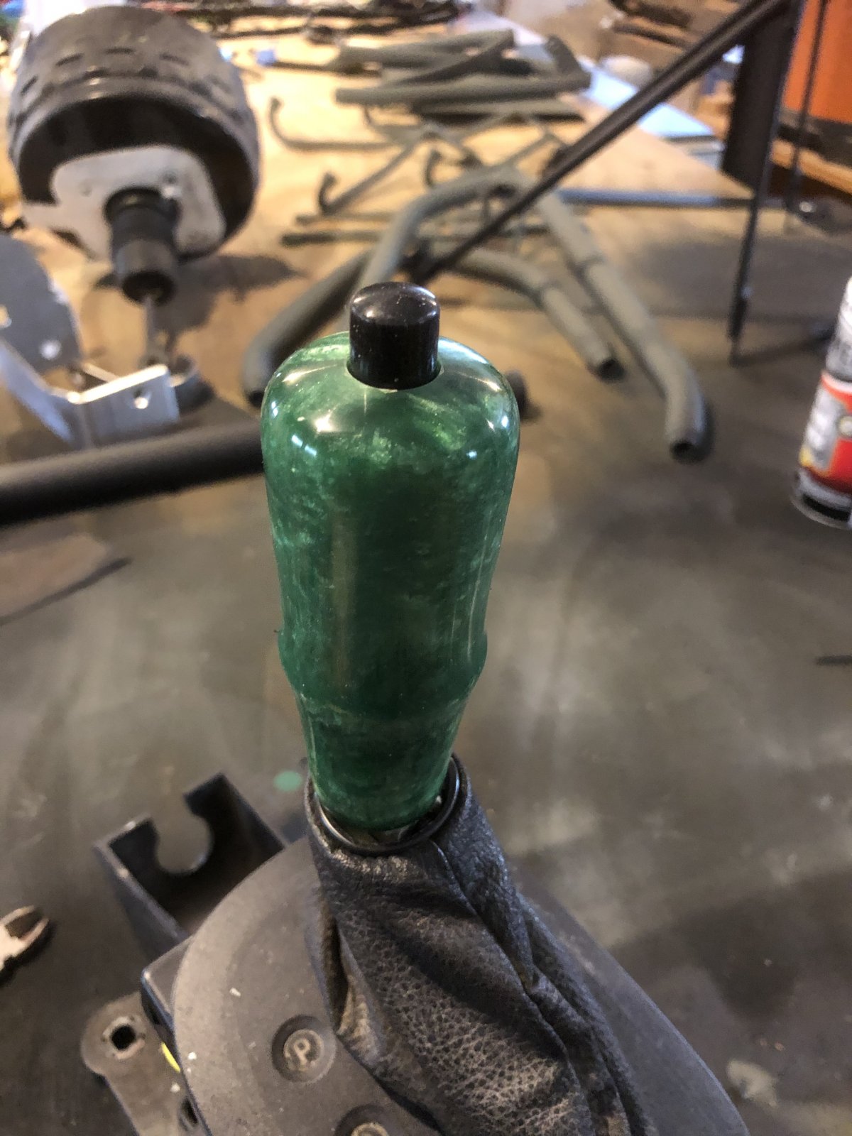

Well I had planned on spraying the Raptor liner yesterday, but had a cool front move through with some questionable rain or shine. Decided to take a break and do a custom handmade accessory.

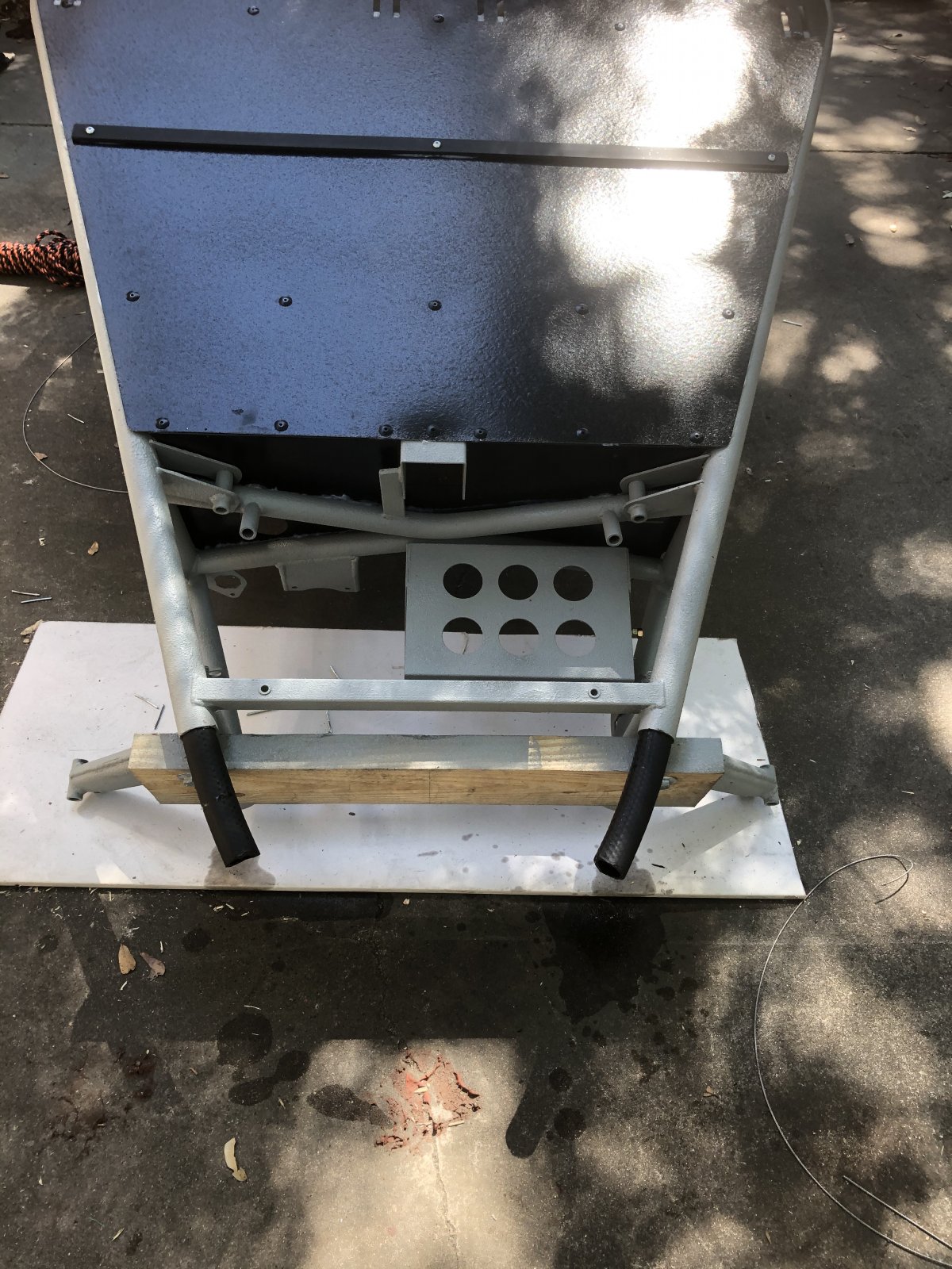

dvldawg

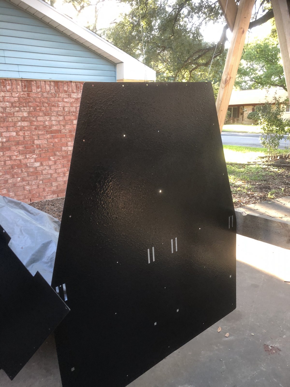

Had just enough time to get the chassis down after 4 hours of dry time. Got the sheet goods prepared and hung and shot with black liner. I need a beer!

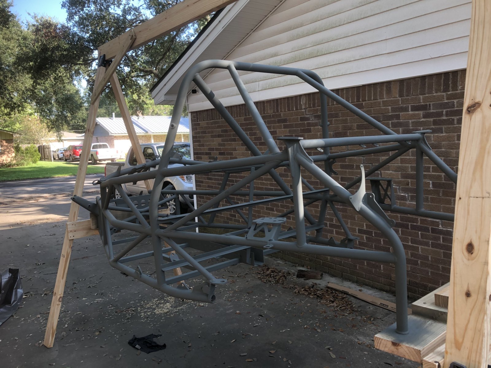

PaulPerger
My granddaughter is going to love you! I was discussing the "rotisserie" with my wife and she said, "You should build it in the backyard and when you're done hang swings on it for Zelda". WIN!! Granddaughter gets a swing set and I get a rotisserie to paint my frame!
Great Idea you give me!!
dvldawg

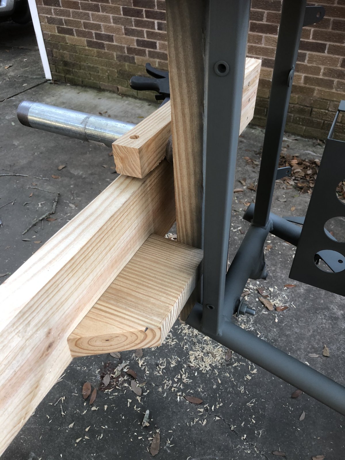

Some info on the rotisserie. Make sure that the top of your cross brace is at least 43” up from the floor. This will ensure your frame will clear if you decide to rotate a full 180’. Although 90’ rotation was perfect for painting. Just a few lessons learned.
