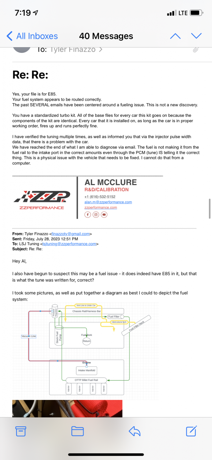

@Gtstorey yes it has been tuned by ZZP. I’ve been going back and fourth with them for weeks on what the issue could be. Here is the most recent (and it appears final) email I have received from them:
41857
So it appears fuel is not making from the rail to the intake port. I’m going to pull the fuel rail today and see what I can find.

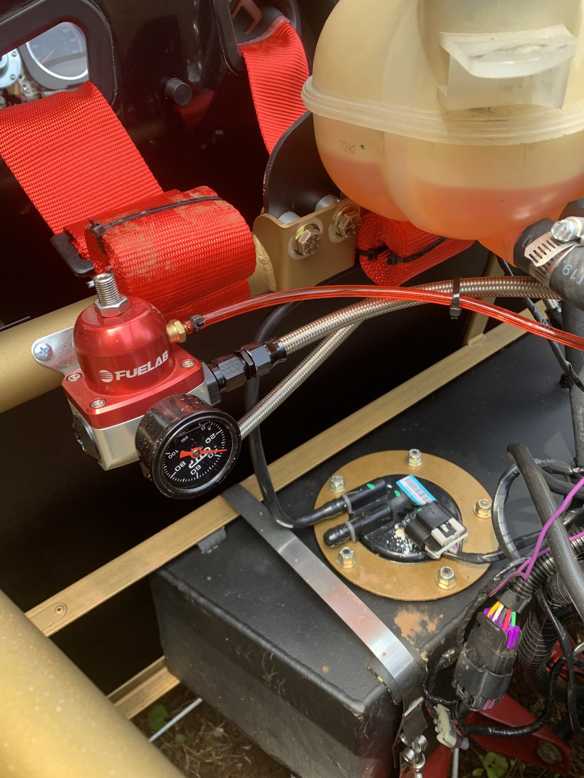

I will say this though - I’ve noticed that right when I turn the key on (not start, just key on), the fuel pressure gauge will jump to 45 which is where it is supposed to be and then will fall immediately (to about 20 or so I believe - will double check when I get home). If I remember correctly, when I did first start back a few months ago, this did not occur - it held at 45psi. Is it possible that this could be caused by a bad fuel pump relay or inserting the fuel pump relay incorrectly?
On key on engine off my fuel pressure regulator jumps to 42psi, and then if I key back off (turning the fuel pump off), it falls to about 30. If your fuel pressure never comes back up, it sounds like the pump is only running for a second and then not running ever again after that. That, to me, would point to an issue with the pump or relay.
If I were to pressurize my fuel system, then unplug the fuel pump, then start it, it might fire for a second, but wouldn't run for more than a few seconds like that. If you can still manage to idle for a minute, then that, to me, would point to an issue with the relay.
Are you using all new parts? If it will idle, can you pull the vacuum line to the regulator and see if that changes anything? I've read about some crazy regulator failures before.
One additional note, on my car, on key on engine off the fuel pump will run for about 5 seconds, and then turn off, and doesn't turn back on until you key off key out for about a minute, or send a crank signal (key to start). The fuel pump will not run continuously upon key on engine off. I idle at about 36-38psi of fuel pressure.
F

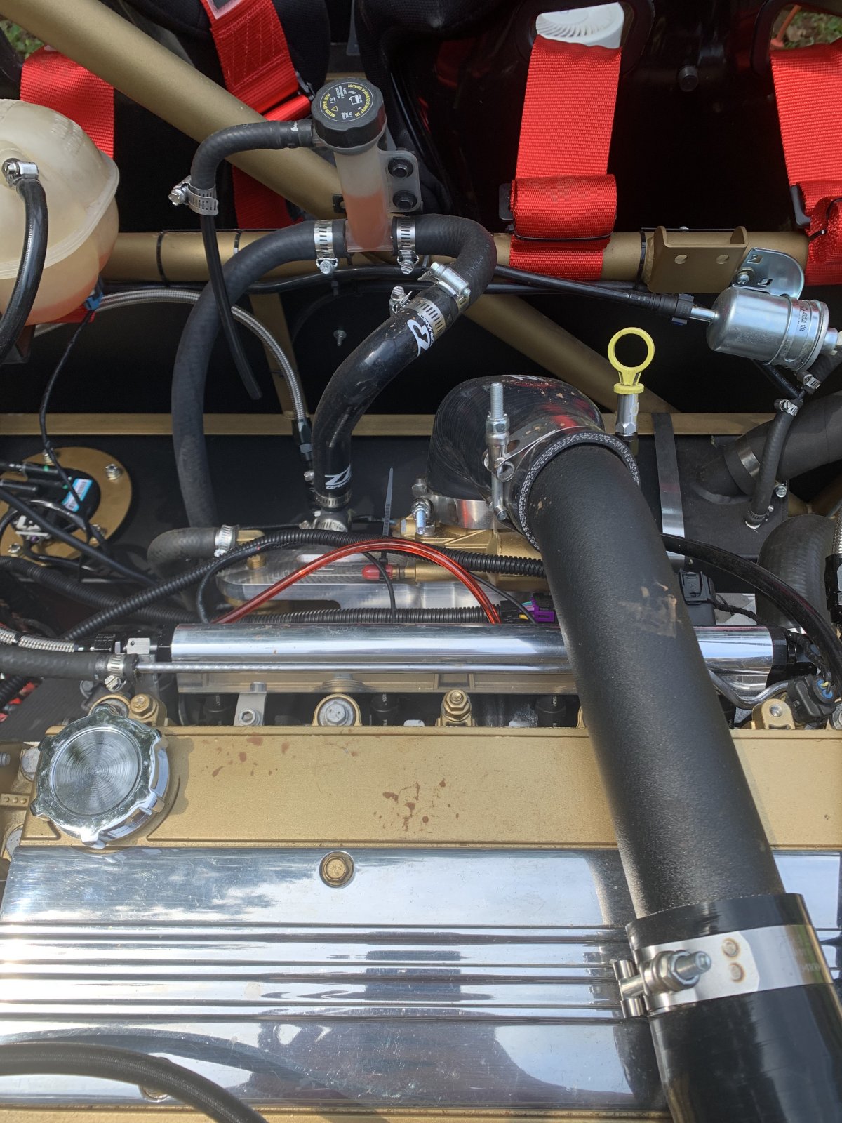

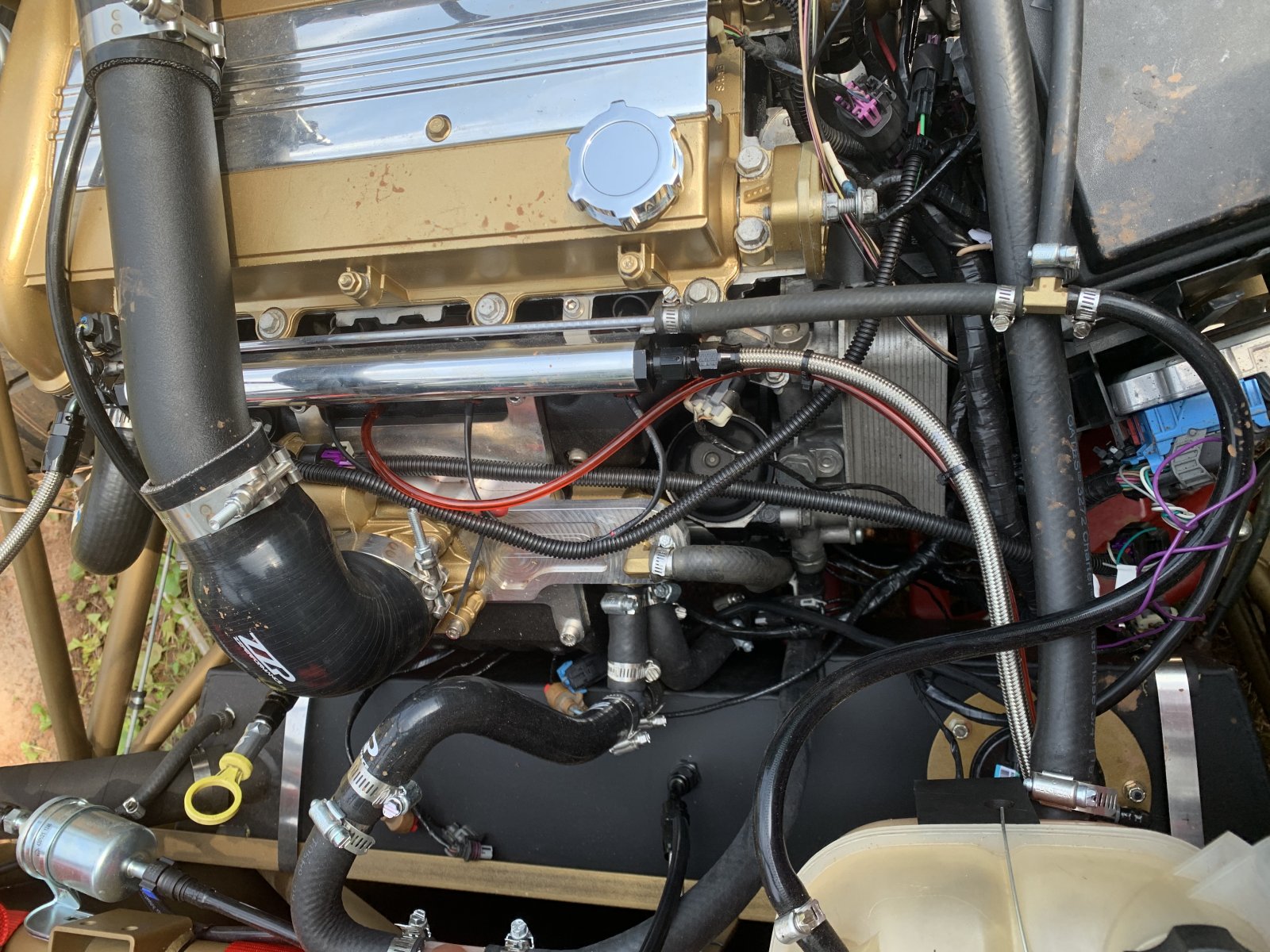

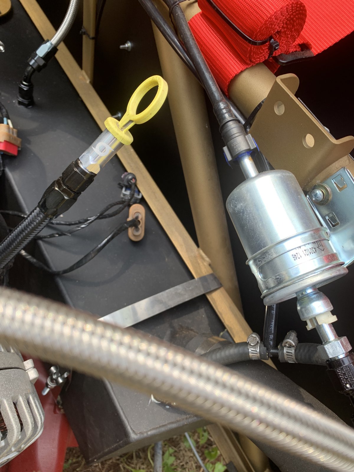

@Rauq yep all new parts. New stock fuel pump, brand new fuel rail and injectors, new regulator. If I pull the vacuum line, the car will start and then pretty much immediately die.

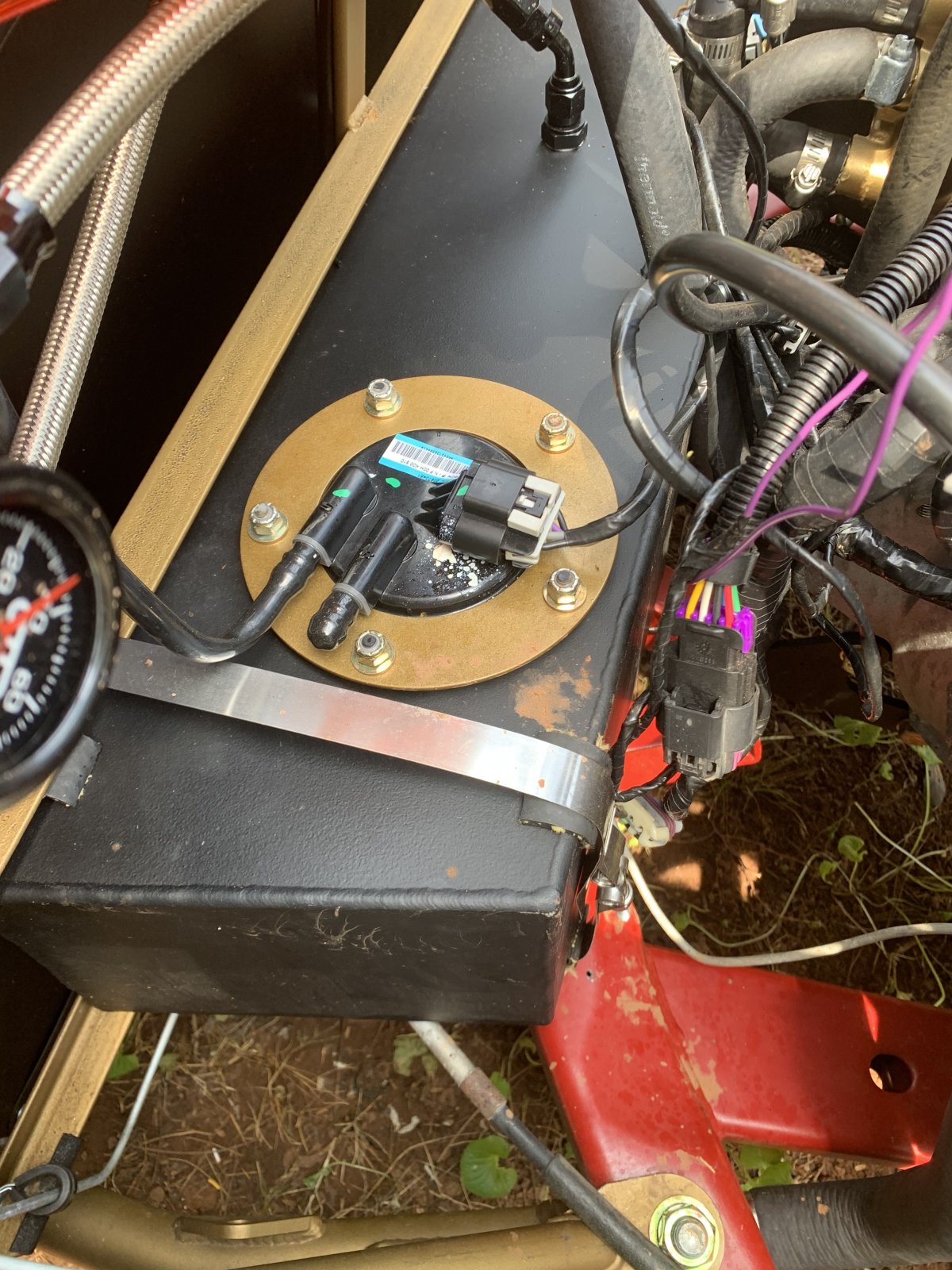

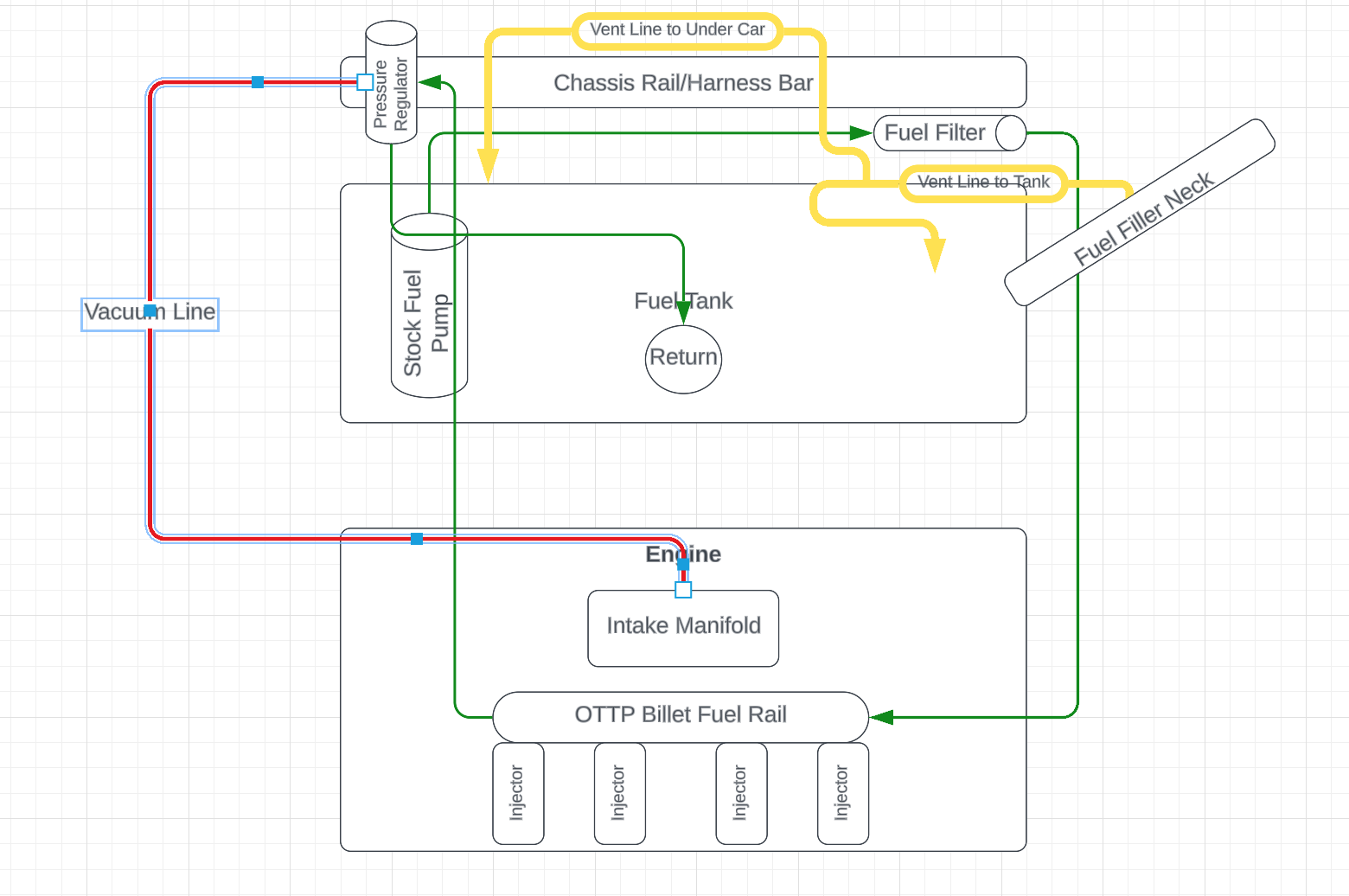

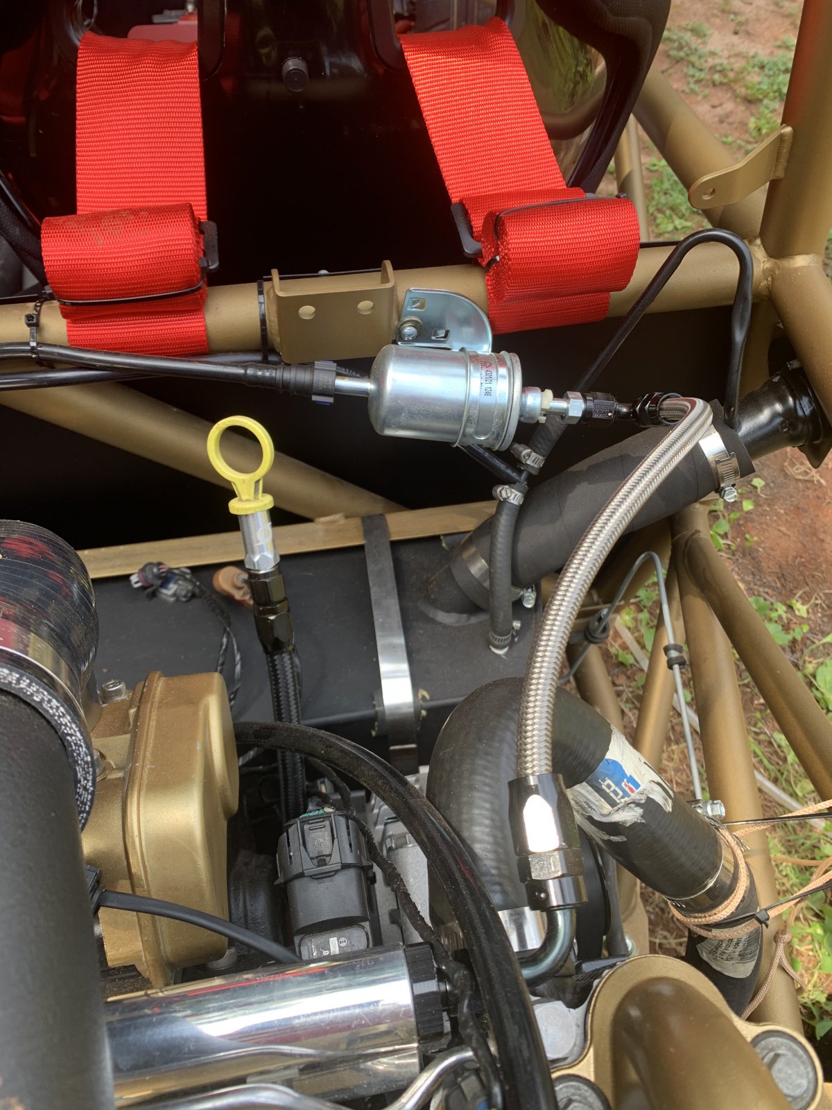

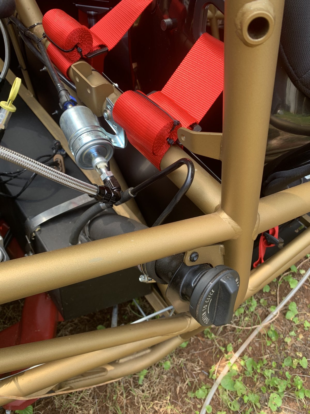

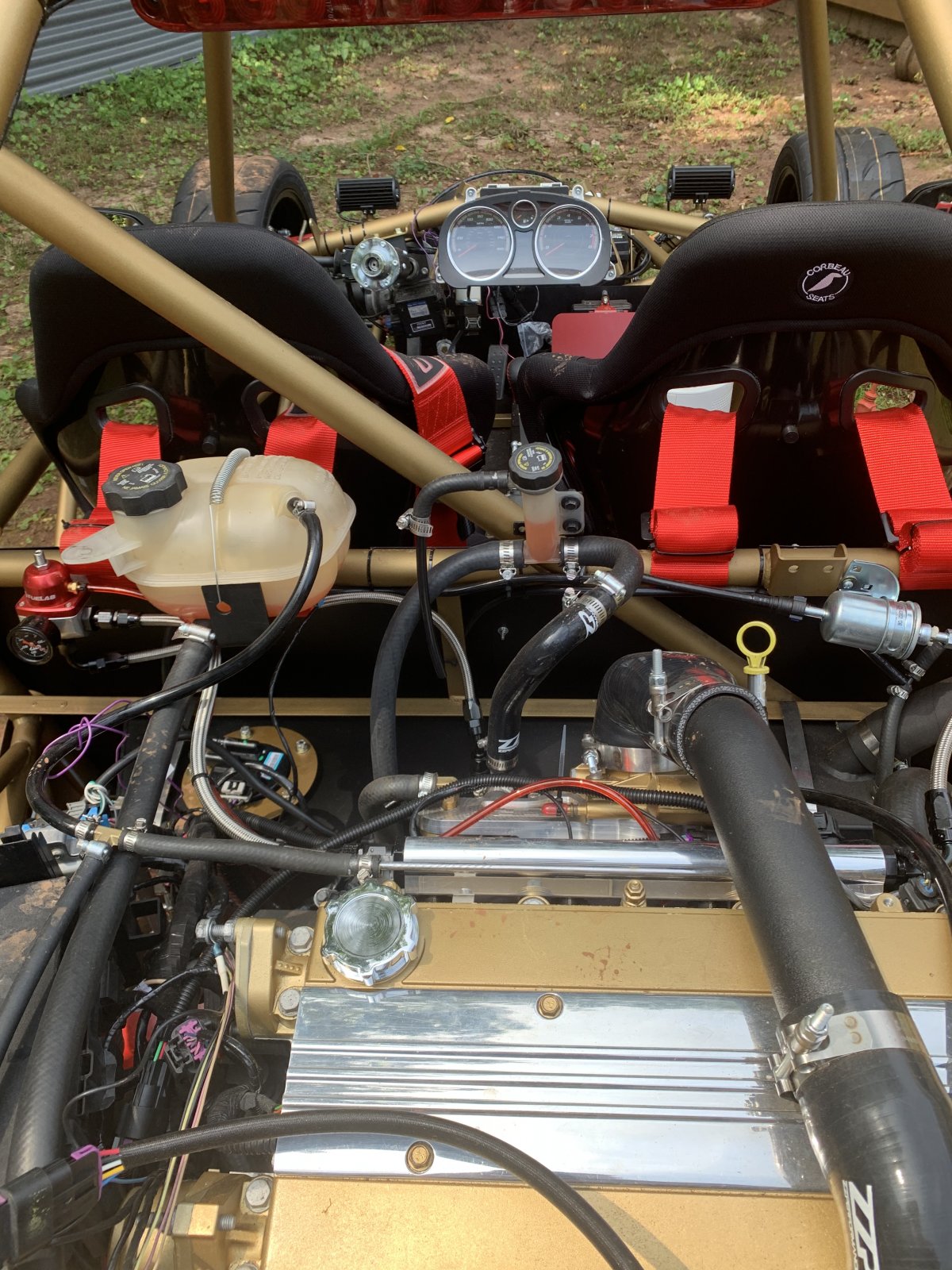

@Fozda files attached
escapepilot
I doubt its a relay issue but that is easily tested by swapping it with another. Can you log fuel pressure while running to see if it is steady or surging? If you add a little throttle, does the surging quit? If you release that little bit of throttle back to idle, does the surging return? Can you remove the air filter and observe the throttle blade while it's surging? - Grasping for anything here really.
Might be interesting to see the log that ZZP used to say that it was a fueling issue. Did ZZP provide the Injectors? Have you confirmed pressure with a manual gauge?
F
So when I give it throttle, the surging goes away completely. When I release it, the surging returns. Because it’s on a turbo tune, I don’t think it will run at all if I remove the charge pipe to see the throttle body. Watching the fuel pressure gauge, it does fluctuate when the surging happens. When the RPMs increase, the fuel pressure drops.
Here is a video of that happening:
I have a lot of speculations, but before I offer them, what's your wideband O2 reading during all of this? Because some of my guesses are that you're running pig rich, but Al makes it sound like you're not getting enough fuel into the engine, e.g. running lean.
Your video of fuel pressure doesn't suggest to me that there's anything wrong with the fuel pump, relay, or regulator. Something's causing the surging, though, and I believe we can figure this out.
F
