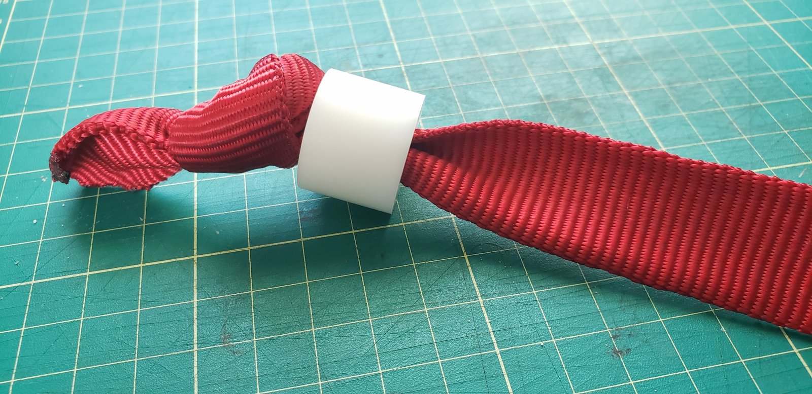

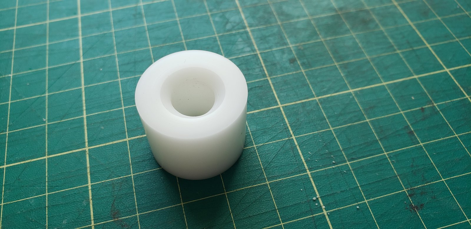

So as figured my frame did not get done this week so beyond cleaning my shop (always needs done) I machined me a slug to pull the hoses through the frame. Some 1" 23kN webbing strap should get the job done.
Towerdog
Their new method is way easier. I pulled mine with a rope pulling and my buddy feeding it. It took about 15 minutes to do both tubes.
I already cut up all the rope I have under 11mm for classes... I have spools up on spools of 1" nylon webbing, figured it would be easy to pull by hand or I will pull it w my sxs winch

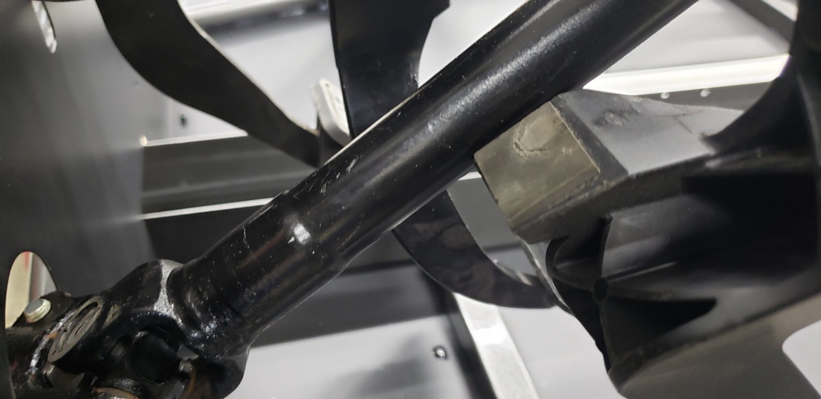

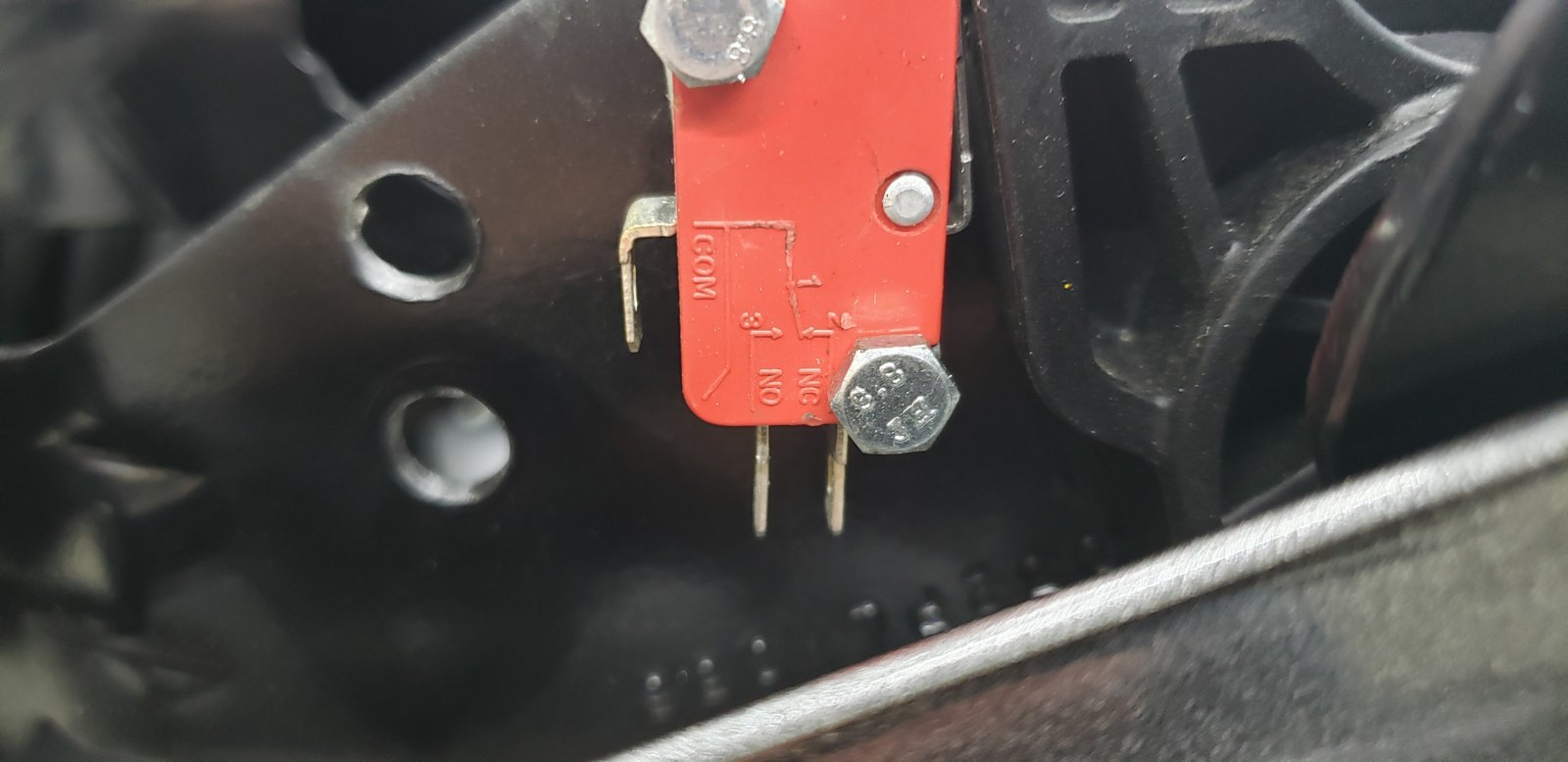

So has anyone had this happen? The boss for the bottom clutch switch is hitting the steering shaft before it is even in place. And of course the switch hits on the outside of the boss so it cannot be trimmed. 07 SC donor
My top switch fix has both N/O & N/C is it possible to wire both to the one micro switch? I know that the purpose of the bottom is to ensure that the clutch is ALL the way in before the starting circuit will be energized.
Angle the steering box and steering wheel to the left (outside), which will move the steering shaft toward the brake pedal. Bonus - it aims the steering wheel more toward the center of your driver's seat.
