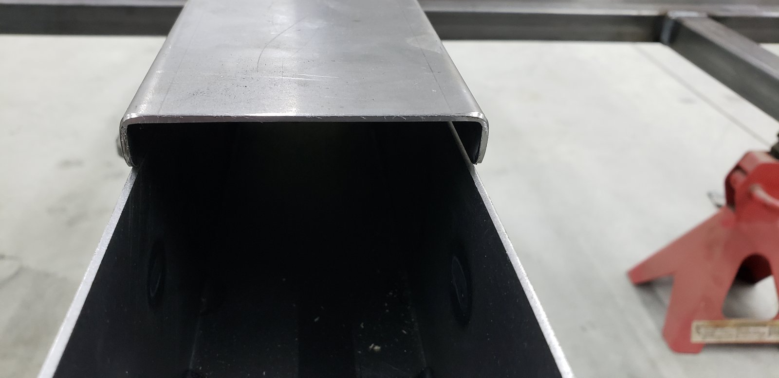

Spoke too soon on the hardest thing..... The tunnel cover is much worse! It must have pulled when it was welded in because it is the same size as the cover. I tried C clamps and steel angle to bend it in with no luck... Not going to break out the torch relax it so I cut the cover into three pieces, have to use a clamp to get one end of the cover started and work the rest of it down. Will not be putting rivet nuts on this due to clearance issues. I will just rivet it on with aluminum rivets so it is easy to drill them out if I need in there again.
k.rollin
I used a large pair of water pump pliers to squeeze the tunnel enough for the tunnel cap to fit. A rubber mallet also helped a little.
