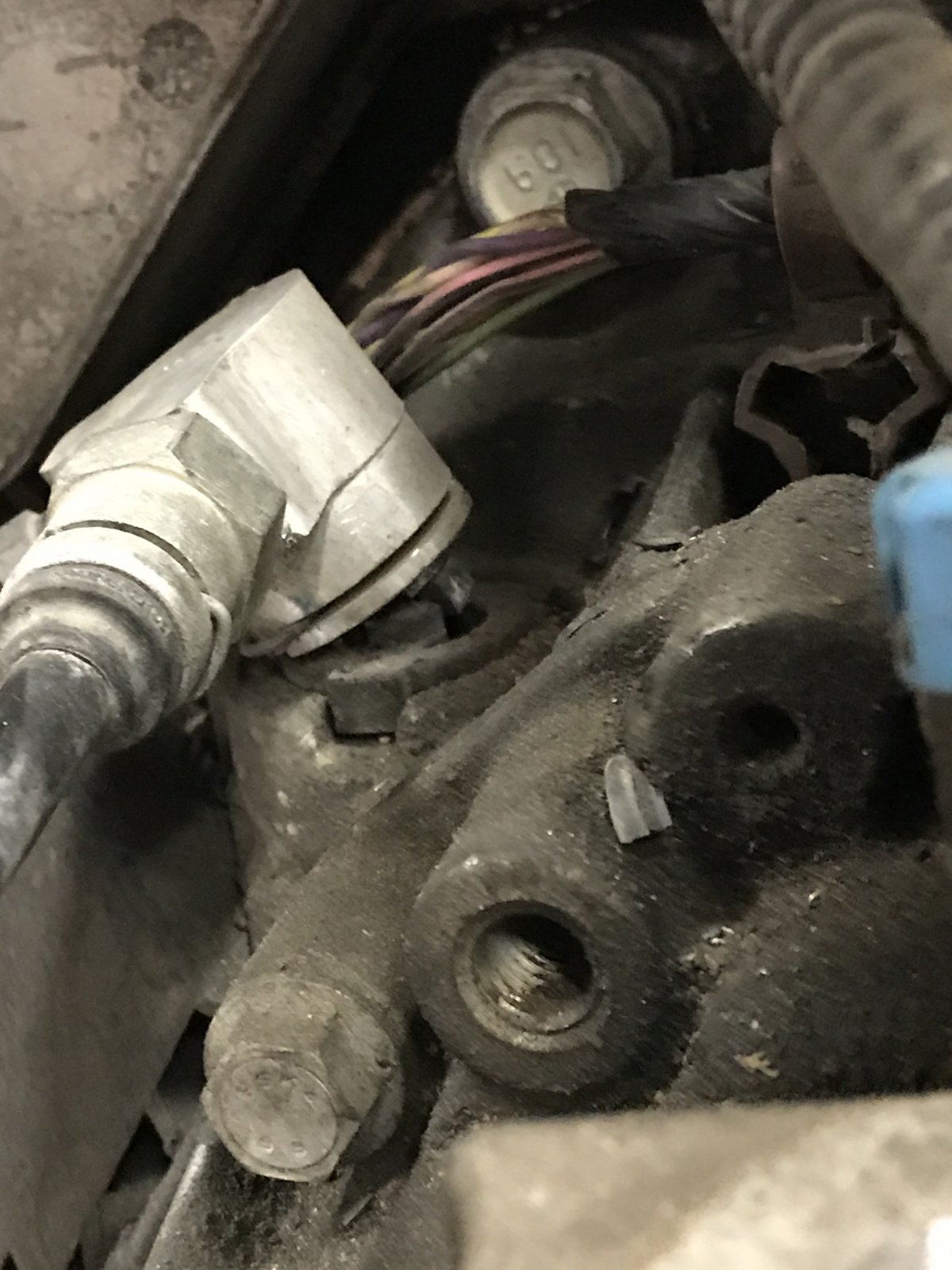

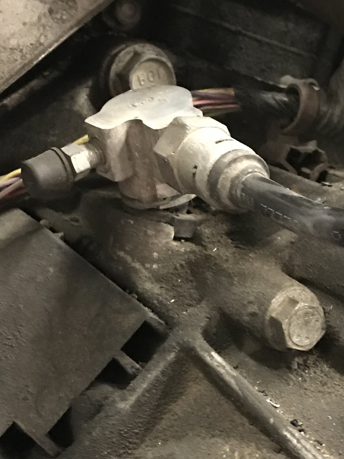

I don't know if it's ok. I think when I took out the engine it twisted a bit. Does the tubing come with the kit?You may not need a replacement. As long as the elbow on top of the trans is okay (and has the clip/insert intact) you should be fine.
The steel tubing comes into that fitting and you don't reuse the plastic one.
X2The kit will come with the steel tubing that goes from the slave cylinder to the back of the car to the hydraulic elbow on top of the F35 transmission. I went ahead and replaced my elbow and inside clutch pipe when I replaced the clutch/flywheel and Throw out bearing. Just to eliminate any problems in the future. The elbow at ZZP is around 20$ if I recall.

Here is the elbow. I think I broke whatever clip or thing it mounts to, but I'm not sure. I still don't know how to take it off without breaking it any more...
