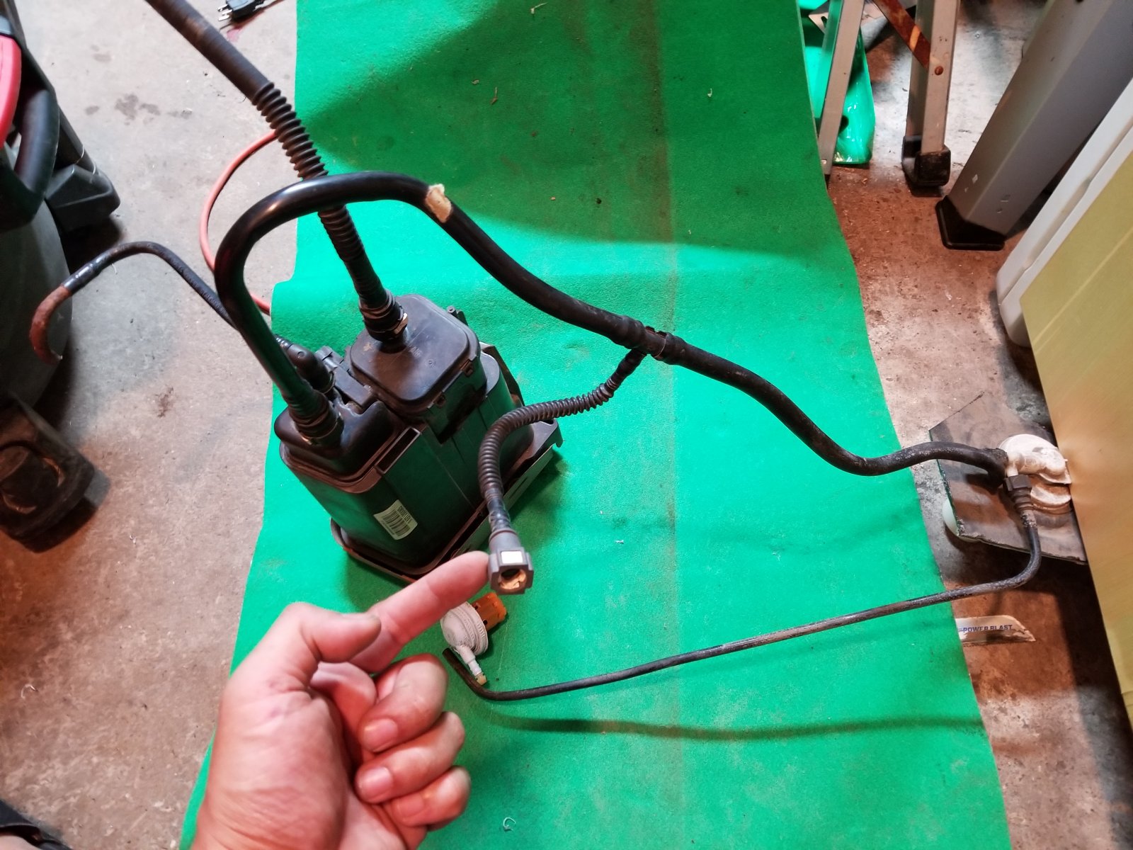

I think you will be able to hook up the EVAP with out those 2 valves. They are for the over fill and to prevent leaks if you end up on your lid.I'm in the process if trying to figure out that evap system also I'm just going to keep it on so i dont have headache when trying to register here in jersey if you look at my build log towards the end you will see some pictures of the Fill Limit Vent Valve,Grade Vent Valve that I removed from my gas tank to some how install them on the new tank
So I'm going to have to explain this the best I can.So I'm think to be able to eliminate to 2 valve I would have to just take a out the tee that goes to the filler neck and just run that Straight to the canister so wherre my finger is pointing that is where it was connected to the filler neck I'm i in the right track do you think that would workI think you will be able to hook up the EVAP with out those 2 valves. They are for the over fill and to prevent leaks if you end up on your lid.
I would also be willing to bet that you will need the evap in CA
Yes I think that will work.So I'm going to have to explain this the best I can.So I'm think to be able to eliminate to 2 valve I would have to just take a out the tee that goes to the filler neck and just run that Straight to the canister so wherre my finger is pointing that is where it was connected to the filler neck I'm i in the right track do you think that would work View attachment 1982 View attachment 1983
