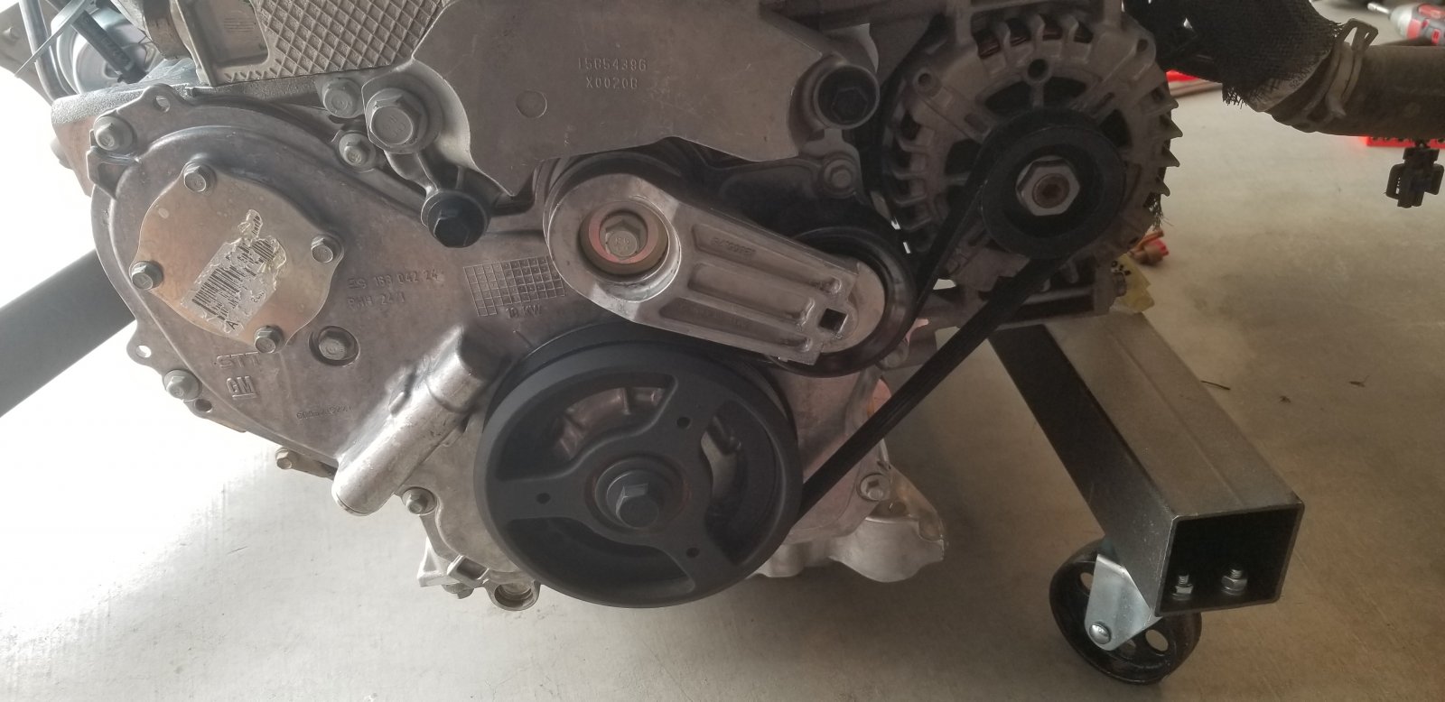

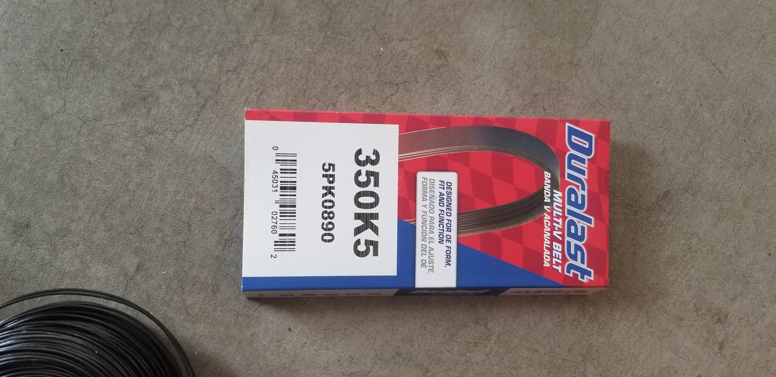

Its probably old news, but it's new news to me. The is the belt that fits the LNF motor after the ac compressor is removed. 350K5. 350 means the belt is 35 inches. The K5 means 5 ribs on the belt.

I bought this and it worked great (although it goes against what JBuild said). $8.95 with Prime
https://www.amazon.com/gp/product/B06Y4M8SJX/ref=ppx_yo_dt_b_asin_title_o04_s01?ie=UTF8&psc=1
In case the link changes:
K050345 DAYTONA Serpentine Belt OEM Manufacturer Quality 5PK875 5050345 4050345 345K5 5PK0875 K50345

Yep, same here. 34.5" belt. Mine has not been started with that belt on it yet, but I had no trouble getting it on.
