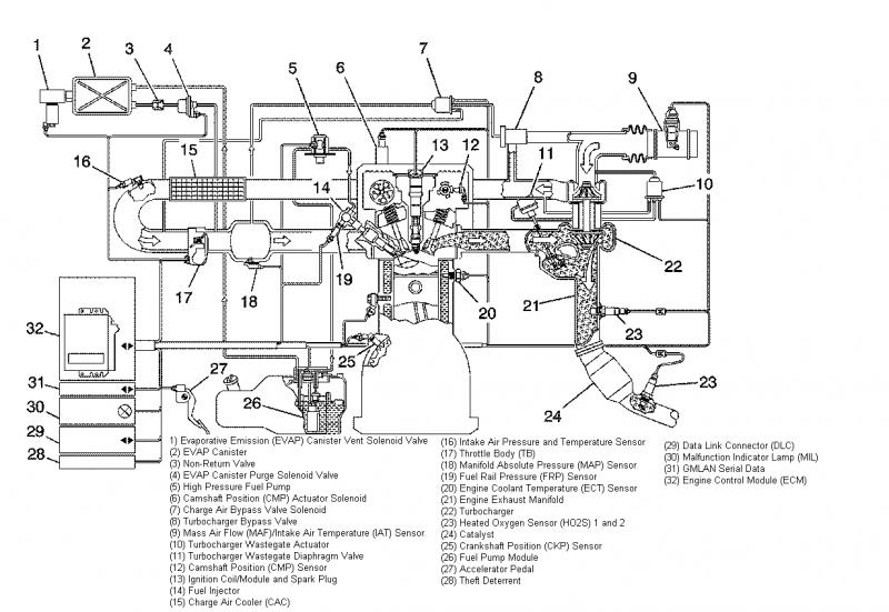

Desert Sasqwatch Bigfoot Goblin Desert Sasqwatch Bigfoot Goblin Jan 16, 2023 #1 Ran across this while trolling around for info about deleting the vacuum reservoir. Last edited: Jan 16, 2023
Vwsaabvt Goblin Guru Vwsaabvt Goblin Guru Jan 16, 2023 #2 do you have a larger version? it's super blurry when zoomed in on.
Goblinfanclub1234 Goblin Guru Goblinfanclub1234 Goblin Guru Jan 16, 2023 #3 when deleting the vacuum resevoir on LNF engines don't forget to add a check valve between the intake manifold and the boost control solenoid
