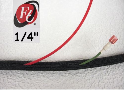

i used a split loom mesh to cover much of it after minimal taping. That makes it easier to open it back up to add or remove. I did tape the entire main harness in the tunnel and engine bay to protect it along with the mesh loom.
I like split loom a lot, but the problem I found with it is that it takes up precious room in the tunnel. Unless your wiring is super straight, you might have to go up a size or two to get it on.
Check out the mesh loom I used in my build. It's not the corrugated heavy plastic stuff. It's more of a mesh sleeve. It's split and has strong memory to the wrap.
https://www.ebay.com/itm/1-4-Flexo-F6-Braided-Cable-Sleeving-Wrap-Split-Loom-Techflex-F6N0-25BK/350999178330?ssPageName=STRK:MEBIDX:IT&var=620245293936&_trksid=p2060353.m2749.l2649
