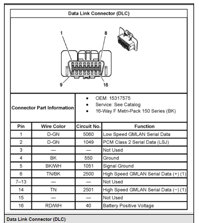

Do you have 12V from pin 4 to pin 16? If not check this fuse.
Do you have 12V from pin 5 to pin 16?
Do you have 60 ohms resistance from pin 6 to 14? (Checking if the two 120 ohm terminating resistors are in place.)
Do you have AC voltage from pin 1 to ground, when the key is turned on? (Is digital data flowing if you have an oscilliscope)
Do you have AC voltage from pin 2 to ground, when the key is turned on? (LSJ engine only)
Do you have AC voltage from pin 6 to pin 14, when the key is turned on?

Didn’t have voltage at any port in the OBD2. After watching some YouTube videos it seems in most GM products the OBD2 shares a fuse with the cigarette lighter. The fuse for the cigarette lighter in my fuse box was missing. Moved the fog lamp fuse to test it, I have power now. Phew.

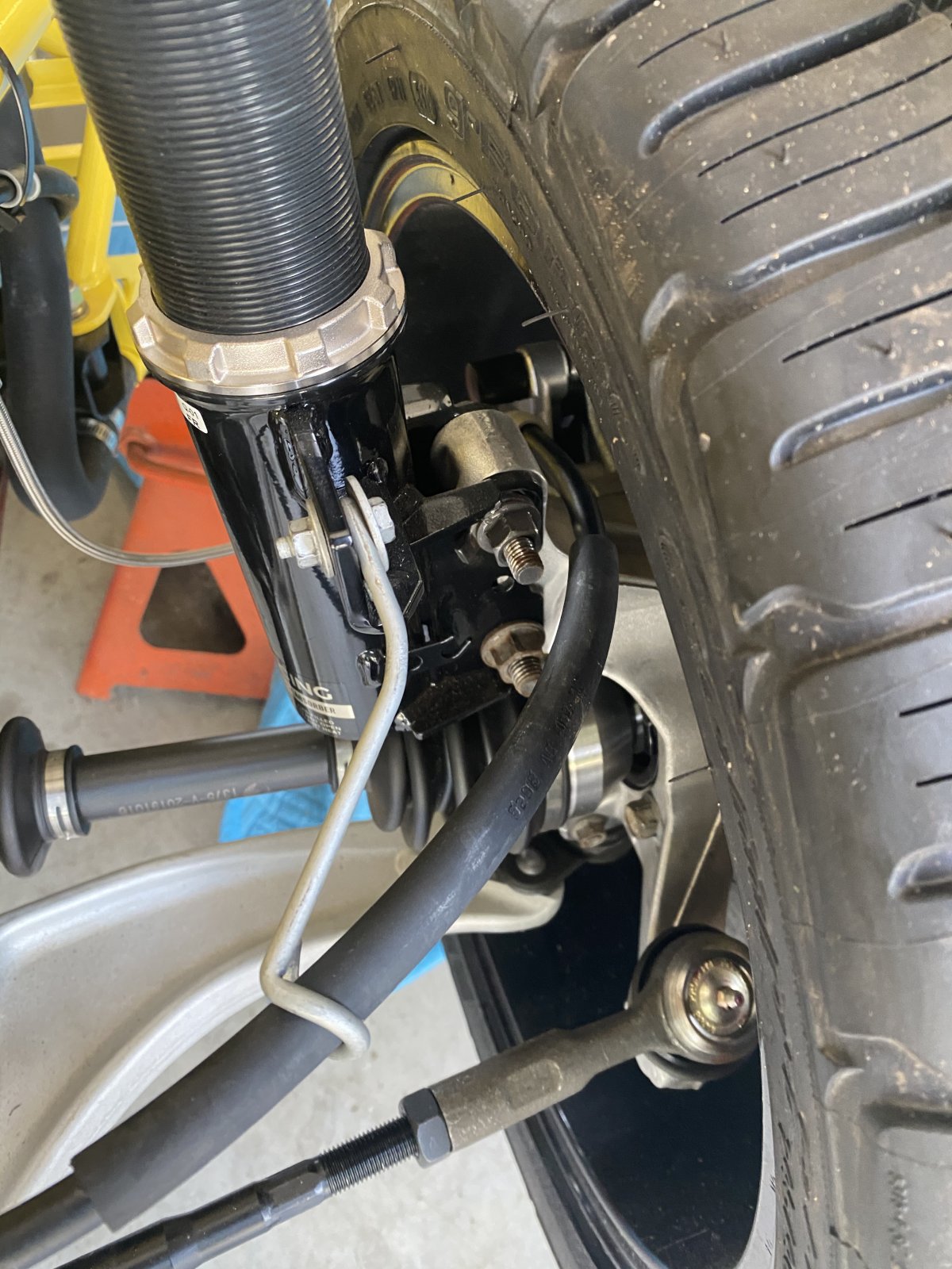

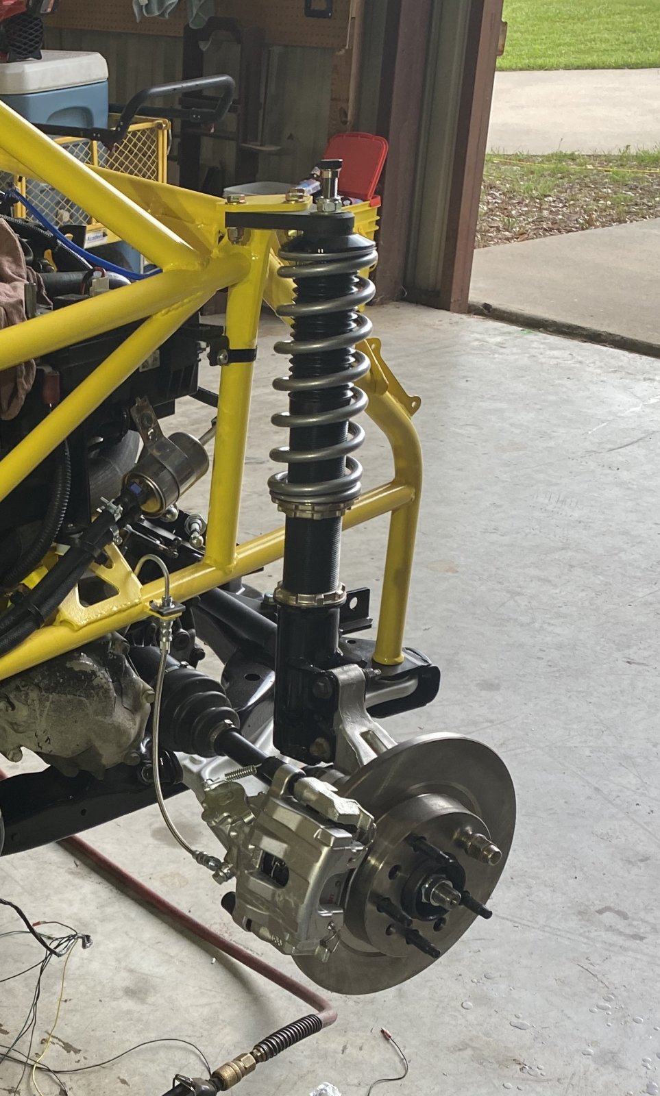

Has anyone used the new Solstice rear calipers? Do you have pictures of them mounted on your car? One says LH and one says RH. When I watch videos of installation on a Solstice it sure seems like LH is on the right side and RH is on the left side.
Sorry. These are the best I have on them.

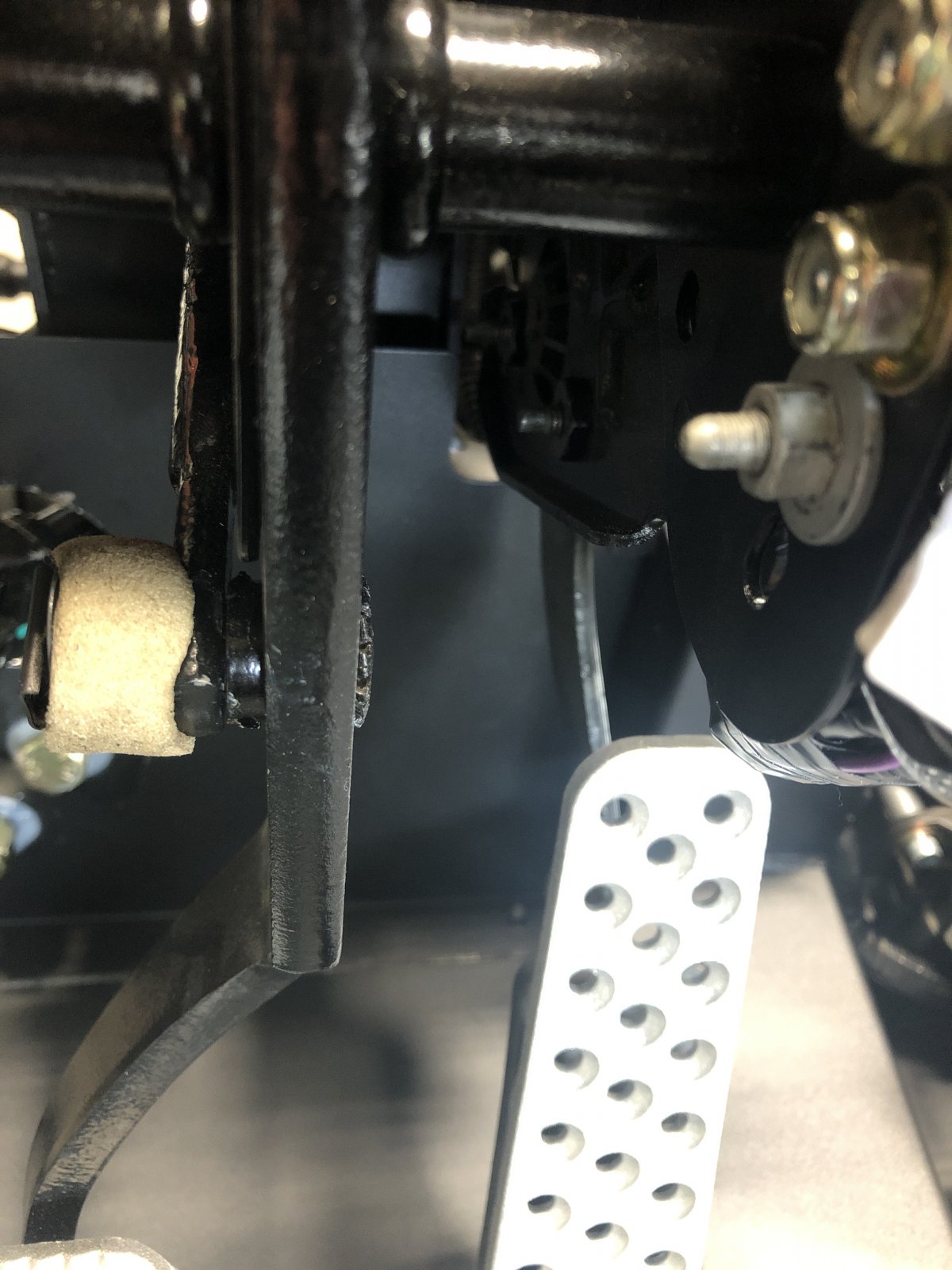

First drive went great. Obviously need a few little adjustments. My brake light is on. My fluid level seems fine. Could have something to do with the emergency brake? I haven’t hooked the emergency break up. To my knowledge there’s no plug or sensor for it. Anyone have any ideas?
There is a wire going to the parking brake handle in a Cobalt, but leaving it disconnected should be fine. I'm not sure if Lonny removes it if you are using his harness.
Grab a meter, and check the brake switch is releasing?
