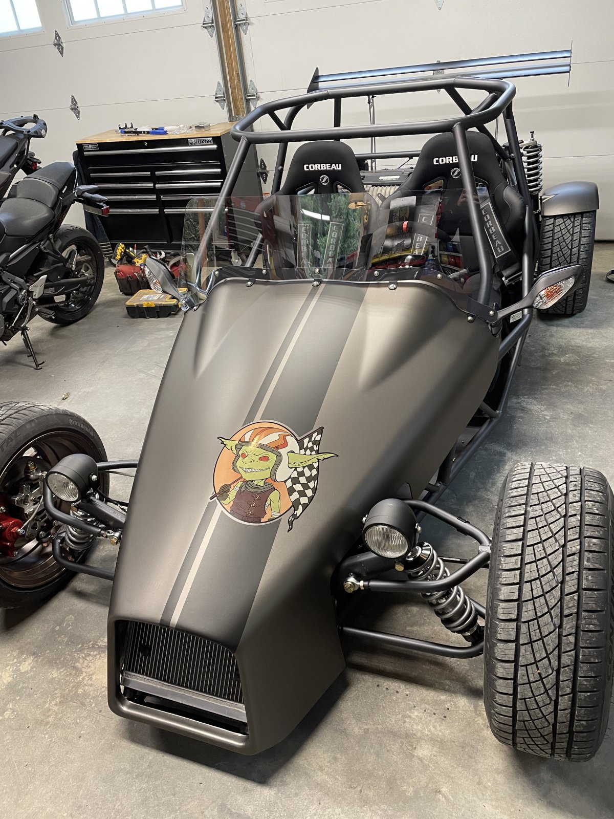

I have not been able to replicate the issue I had. Possibly just a fluke? I am really enjoying driving the car though! I’m waiting on a couple little things before I get some good photos but here is a sneak peek of my Goblins goblin.
2017 Kawasaki Z650 (my wife’s bike) and a 2020 Honda Africa Twin 1100 (my only bike at the moment).
Nice. Got to test ride an Africa twin at cota Motogp a few years ago. It was the “auto” one. That was interesting to ride without shifting and such. That z650 is probably way too much fun to ride :cool: Very forgiving and will do whatever you want it too. My friend has the ninja 650 and it’s a blast to throw around. I race a ninja 300. :D
