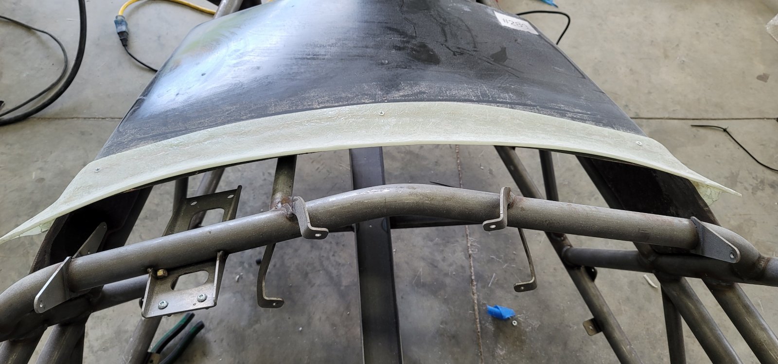

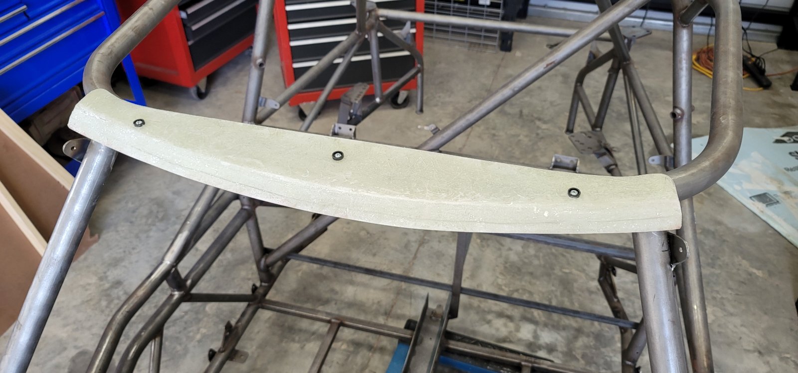

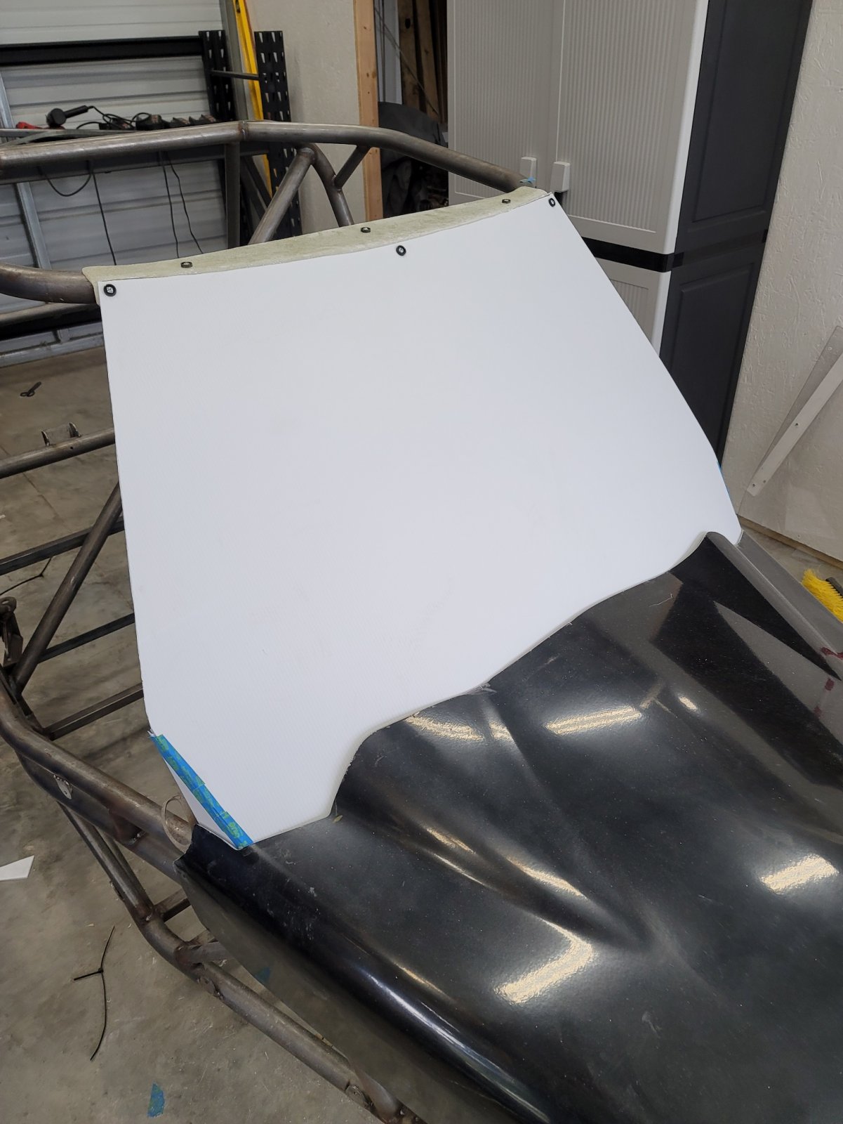

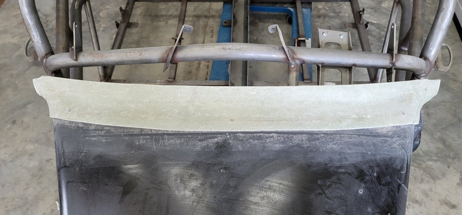

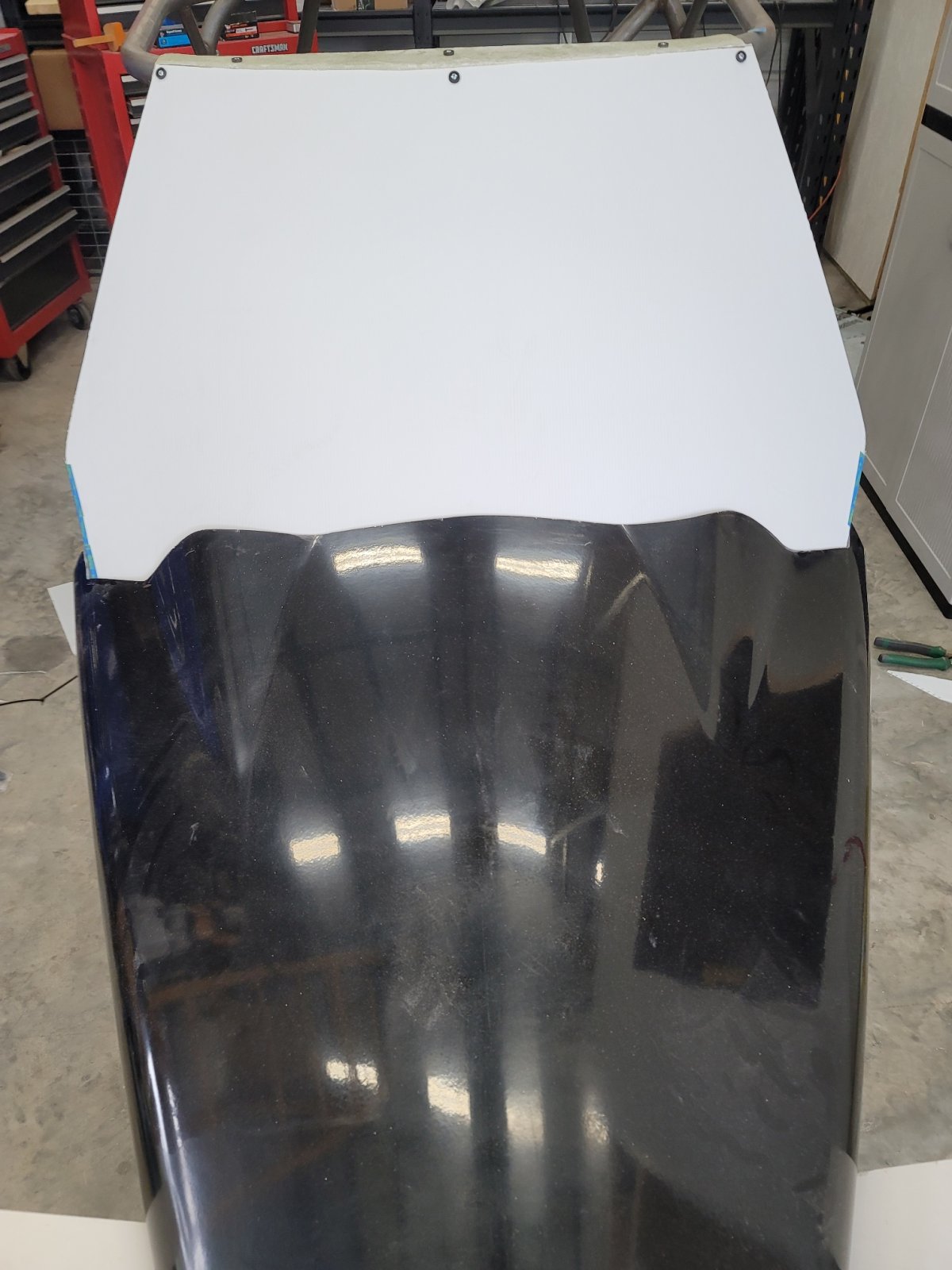

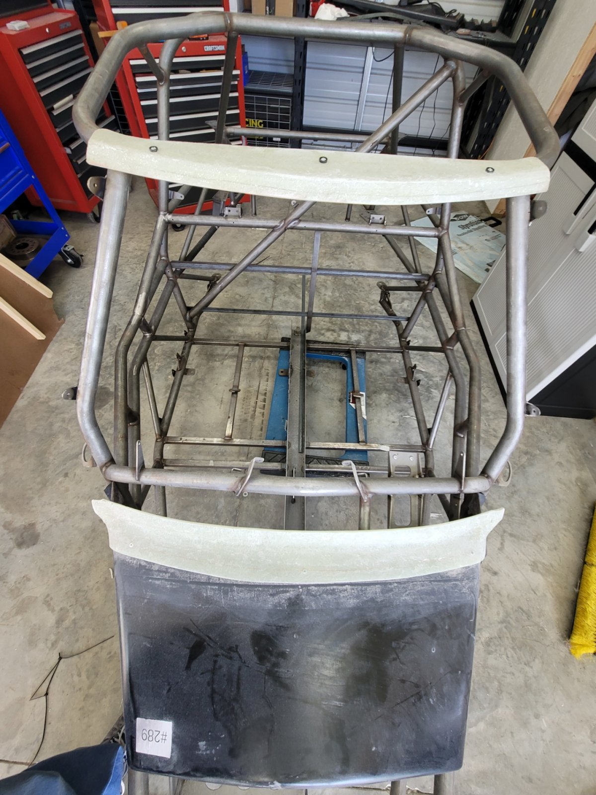

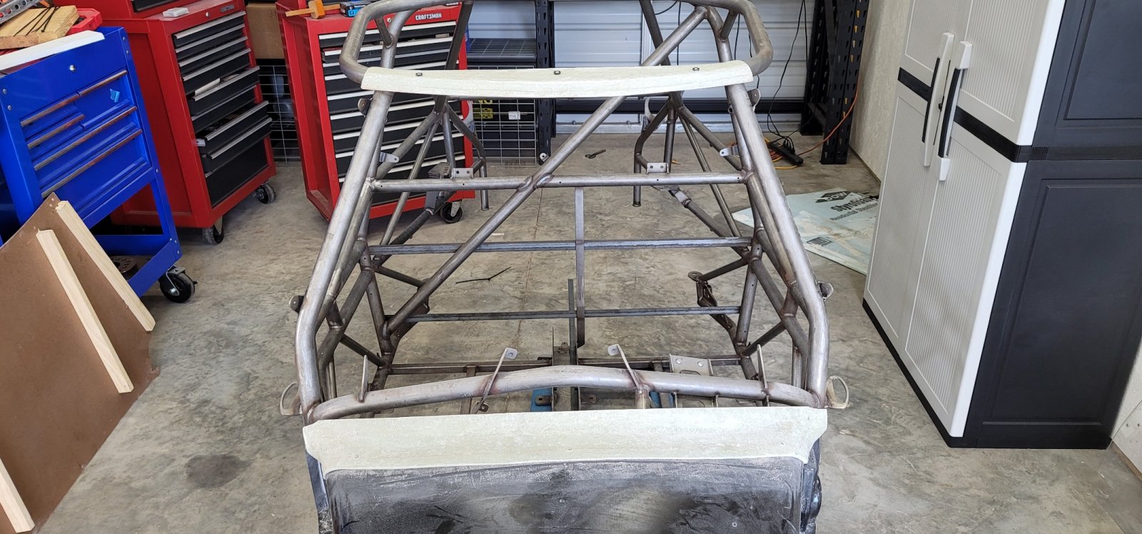

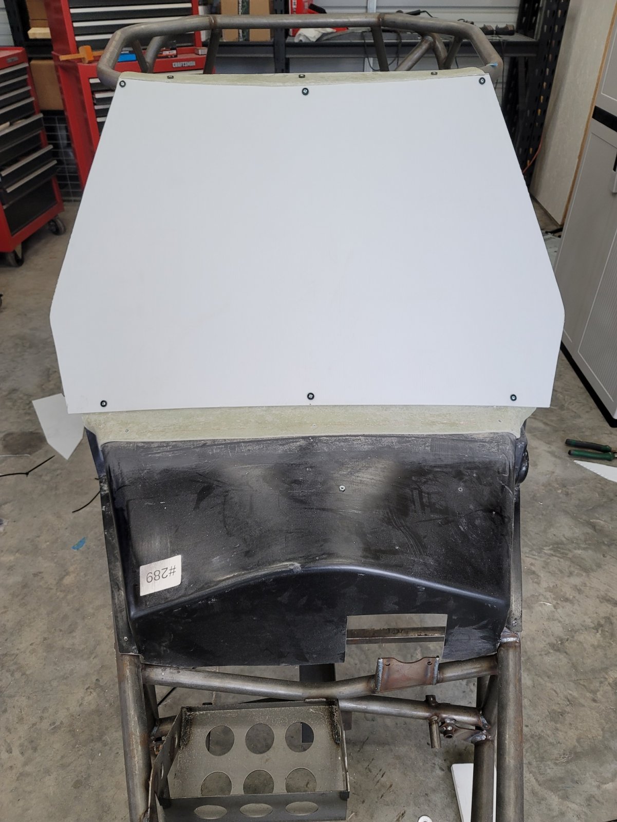

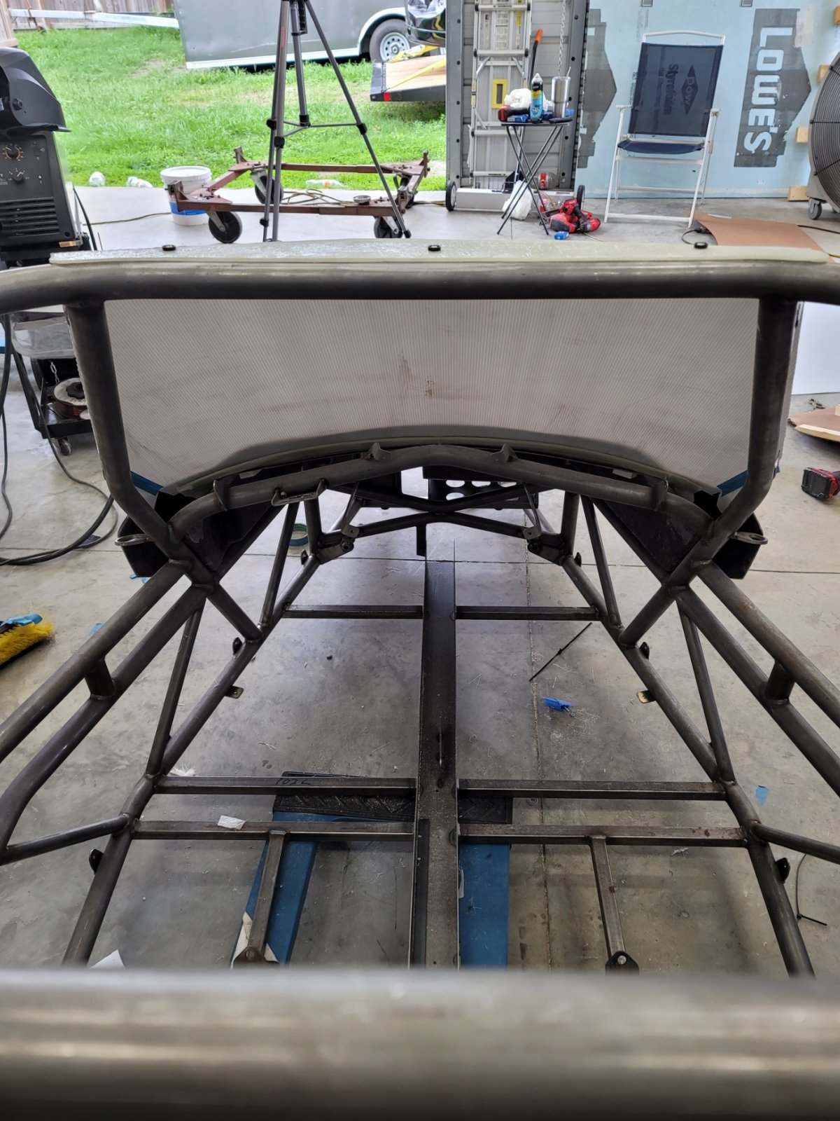

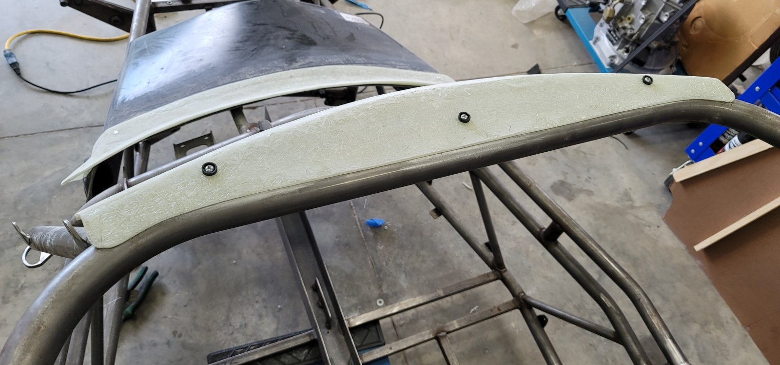

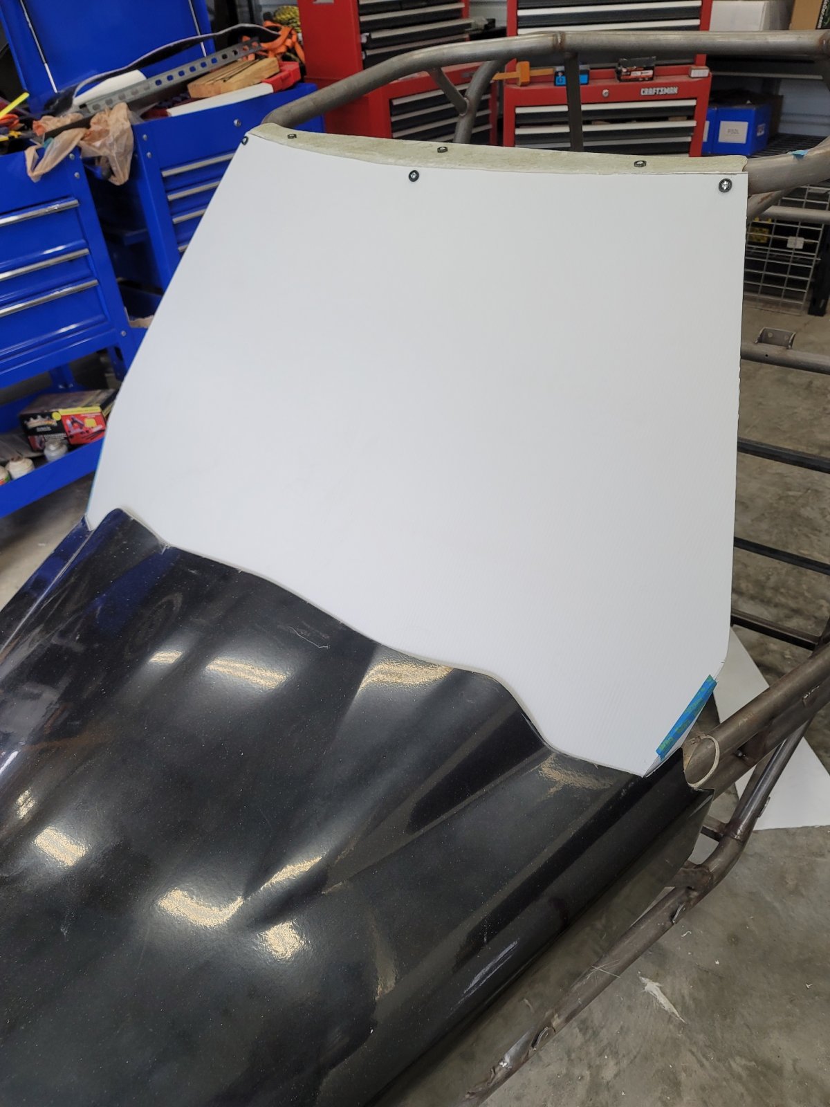

My take on a windshield, toughest part was getting the nerve to cut the hood. Will be using the cut off portion of the hood to make a dash.
Hood is going to be hinged at front, just getting started making the hinge. May or may not have to add a little structure to the hood to strengthen up the hinge point.
Going to make a full windshield and also a cut down windshield out of 3/16" Lexan.
