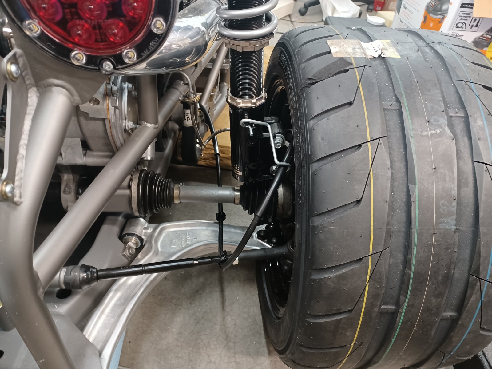

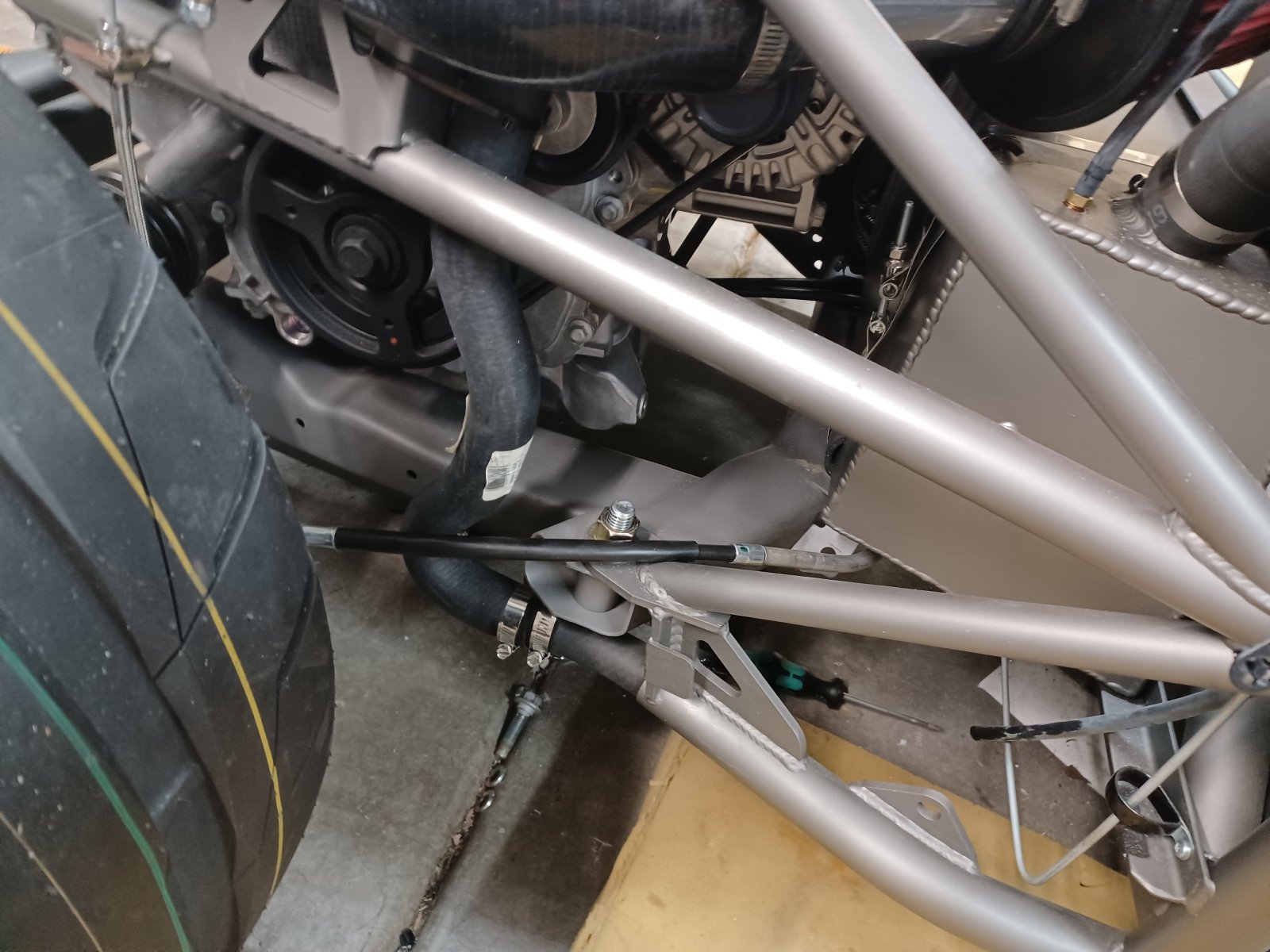

Put the parking brake in.
29619
29620
29621

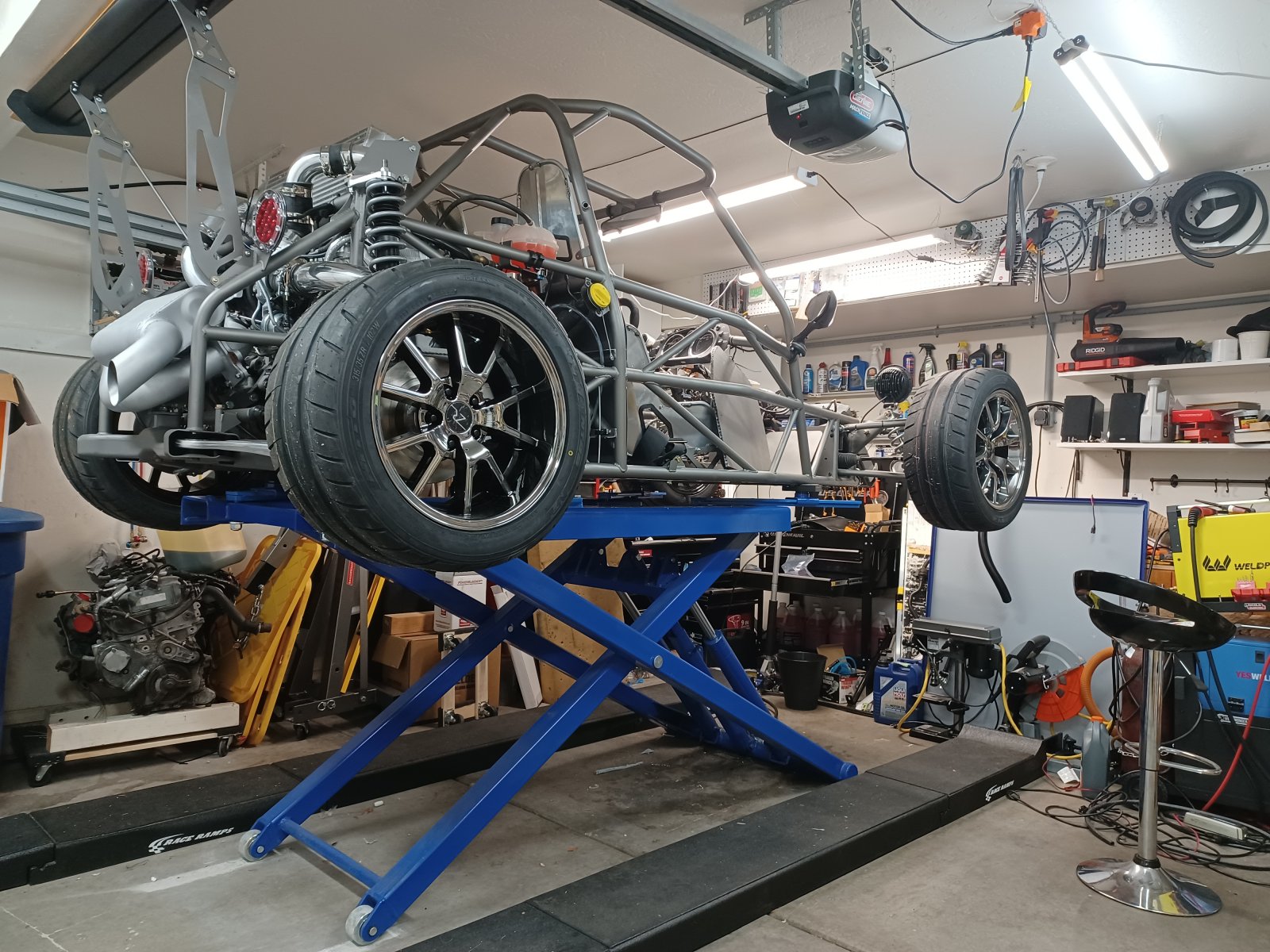

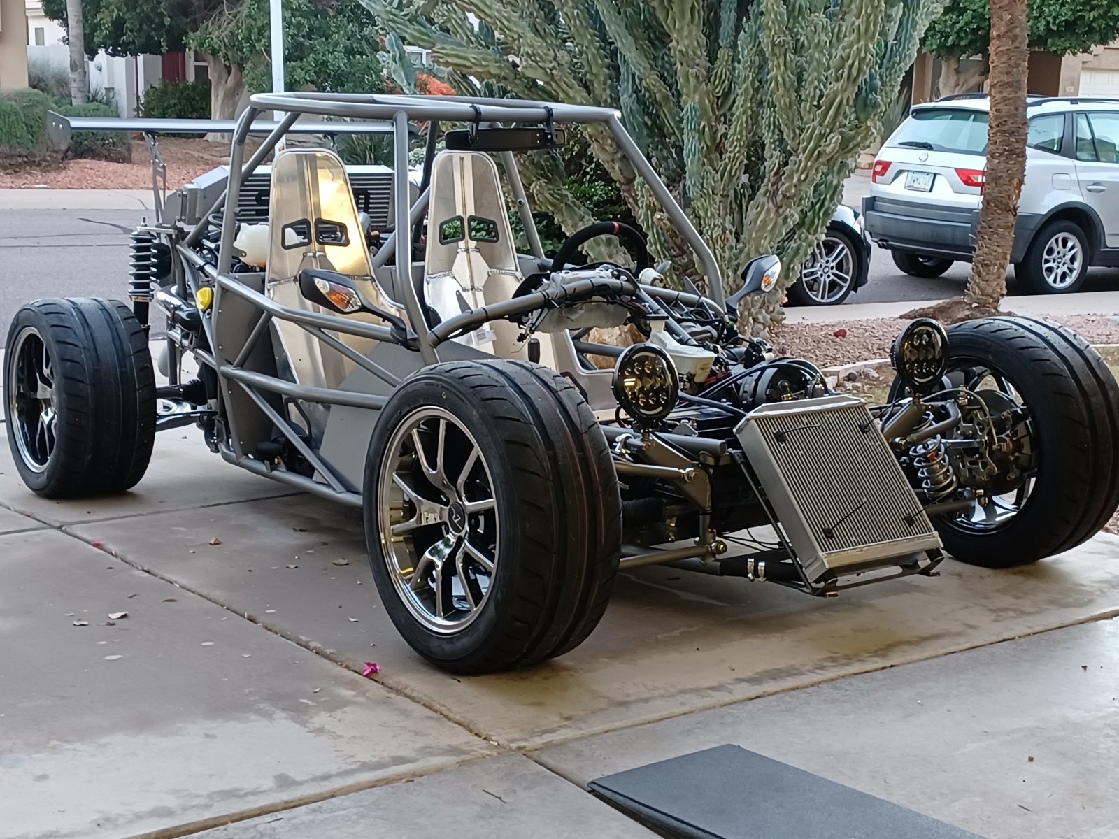

Well the first test drive is complete. It wasn't much of a test drive but it did make it onto the street and back. Verified that the shifter, new clutch, brakes and parking brake are all working. Next I have to fit all of the bodywork and get started on the title/registration process.
29824
