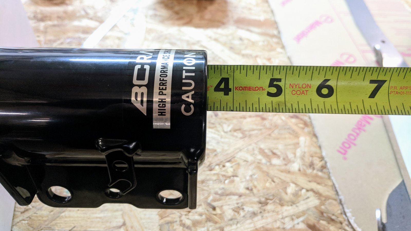

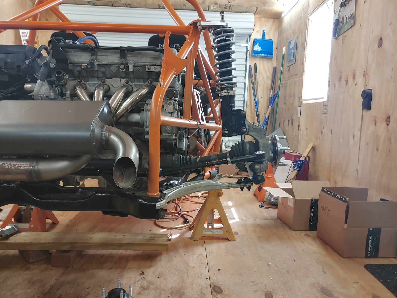

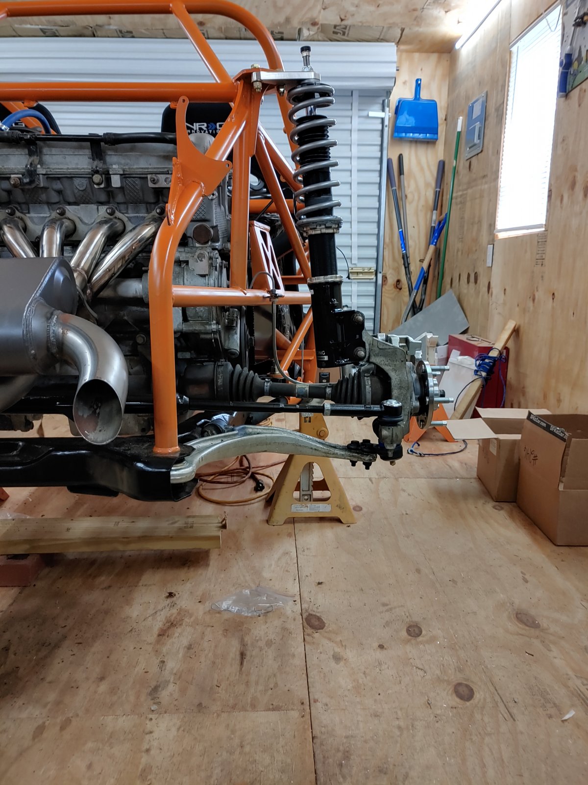

Do I have the wrong struts or did BC change the design some? I have about 4.5 inches of thread for the coilover and the other picture that somebody(sorry didnt look atbmane) uploaded has 8 inches of threaded area. And looking at the last pic I'm going to need some 33 BFG's so the frame doesn't drag the ground. Thoughts?

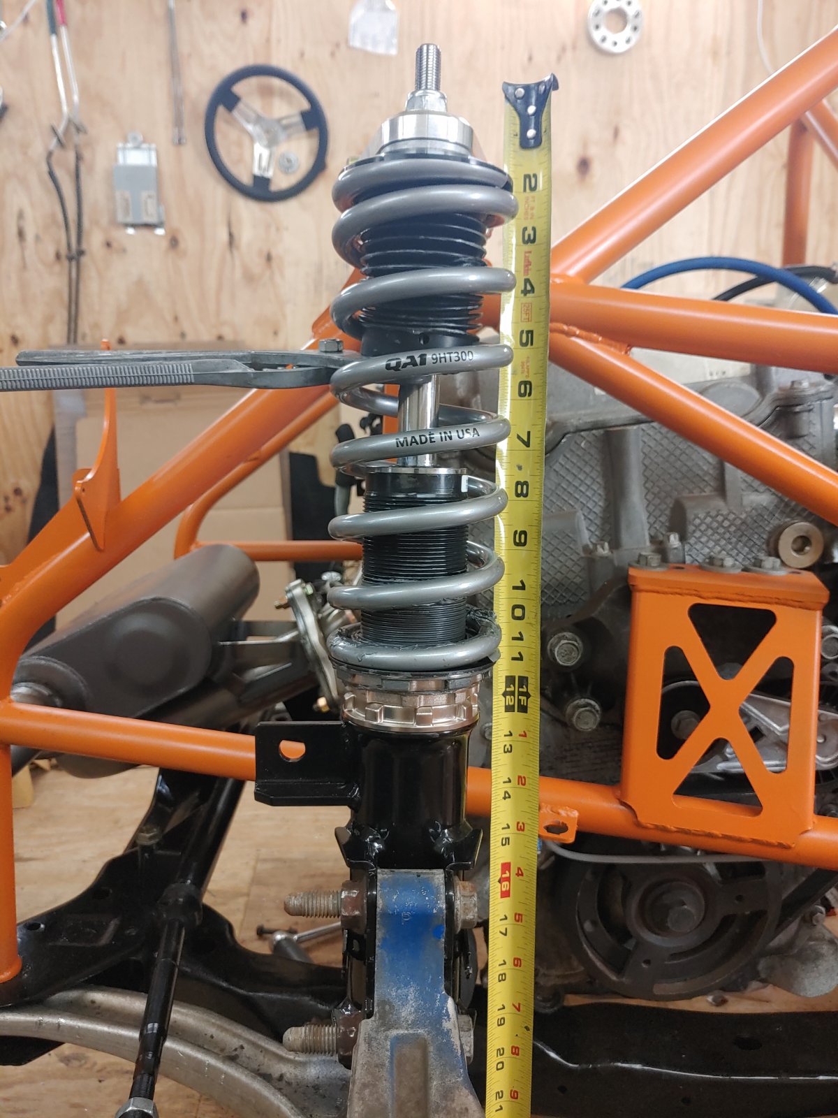

make sure you have 3 1-2 inch
It screws in or out
Measuring tape goes inside of mount

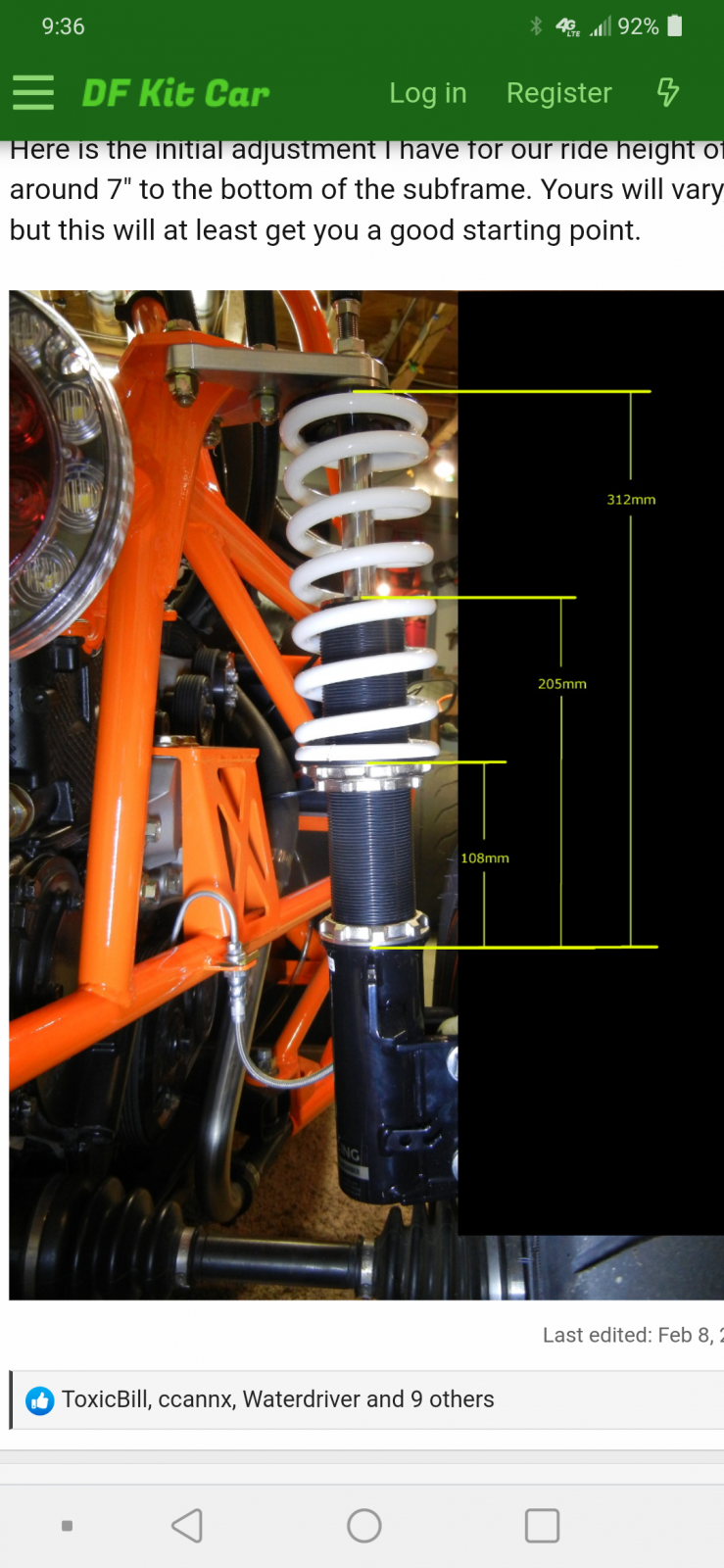

here's Chad's post on setting them up.
