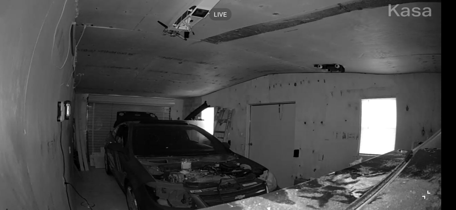

The car is going to be a what ever car. Autocross, drive it to work, just what ever.

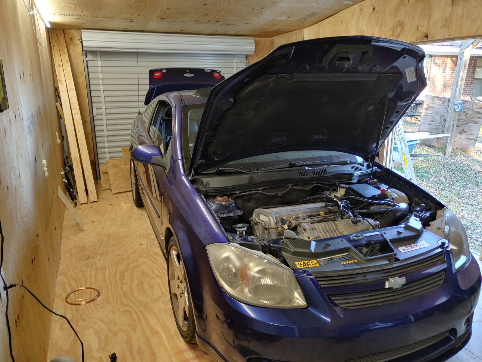

I have had the car for a few months now, but just go the "shop" finished so I could really work on the car. The shop is a 12x24 portable building so I have to think thin thoughts while working sometimes.

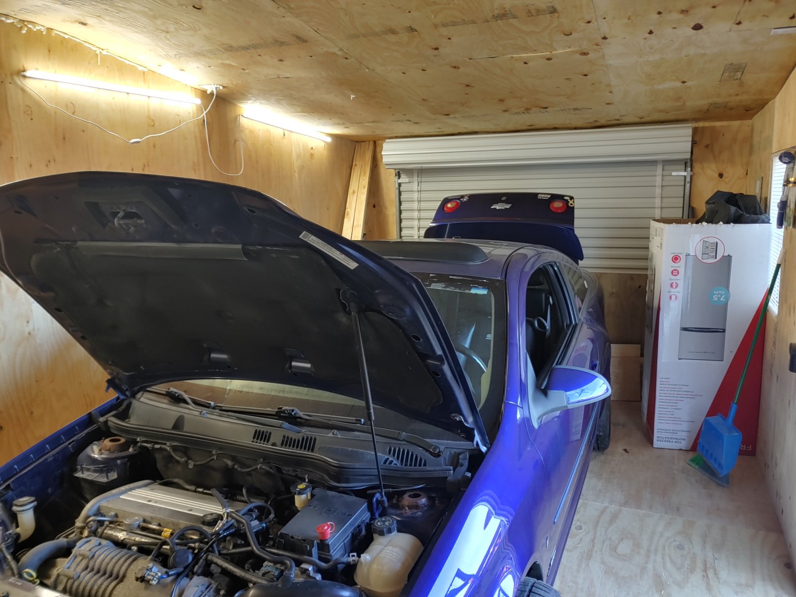

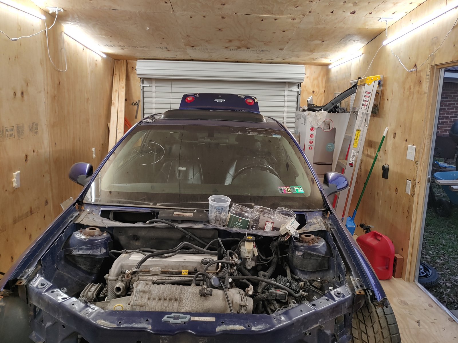

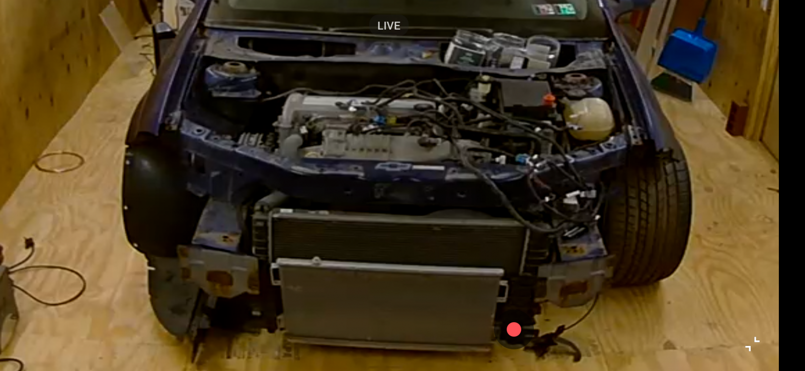

Day 1. Got the hood, wipers, cowl grill off, and the pass headlight/bucket.
19497
Day 2. Drivers headlight/bucket, bumper/and bumper cover, A/C condenser, washer fluid bottle, finder liner on driver side.

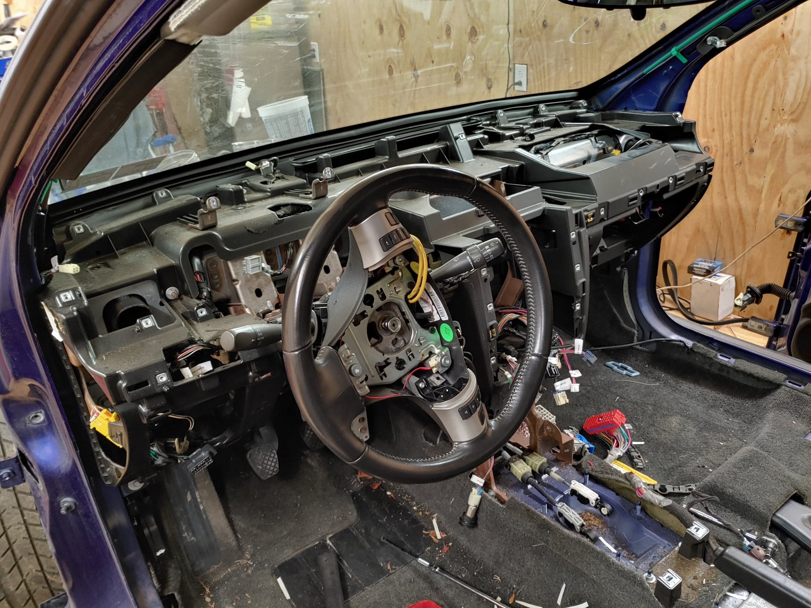

Yup doing this by myself. Good tip on the dash. I pulled a 94 mustang dash once and only once. That one was heavy also. We will see how it goes, when I get there.

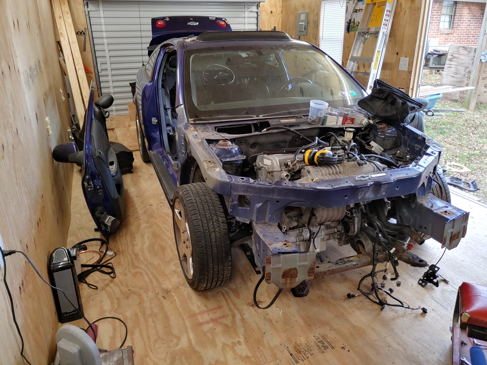

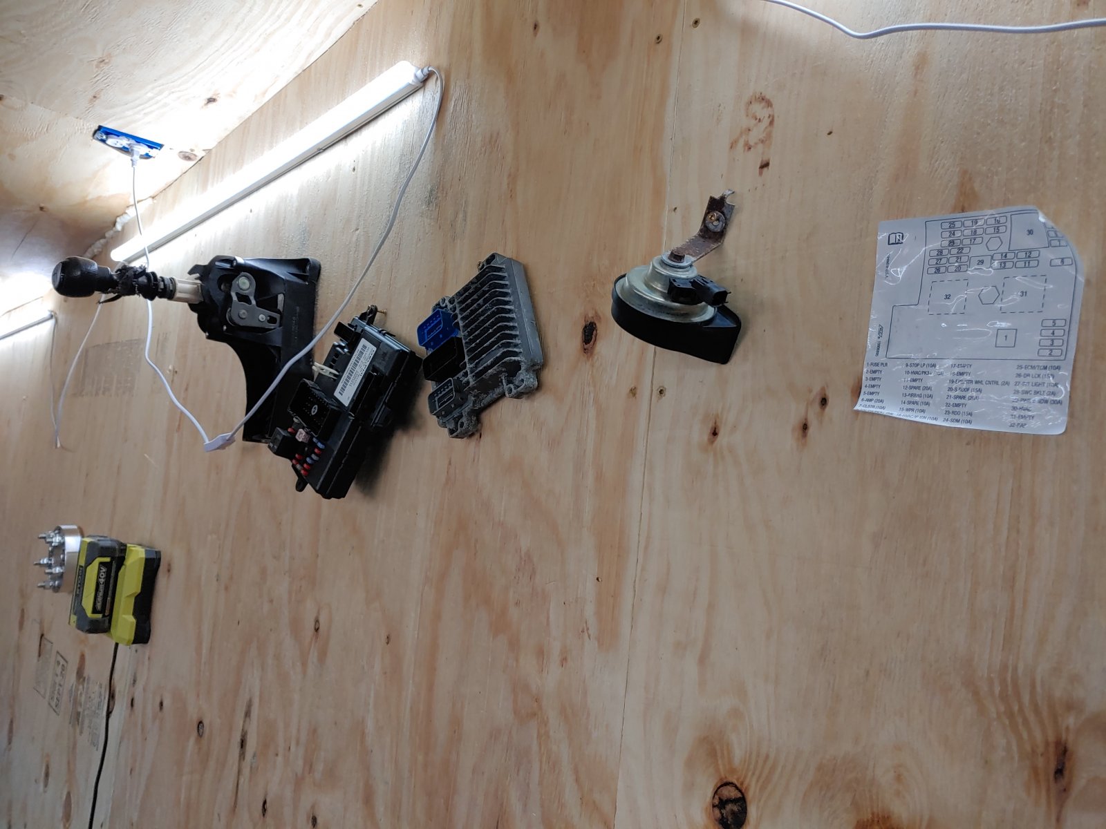

More work today.. The doors came off today big step :rolleyes: ... anyway here are the pics to prove work was done. Oh and my growing wall of parts.

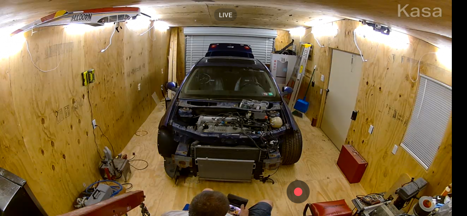

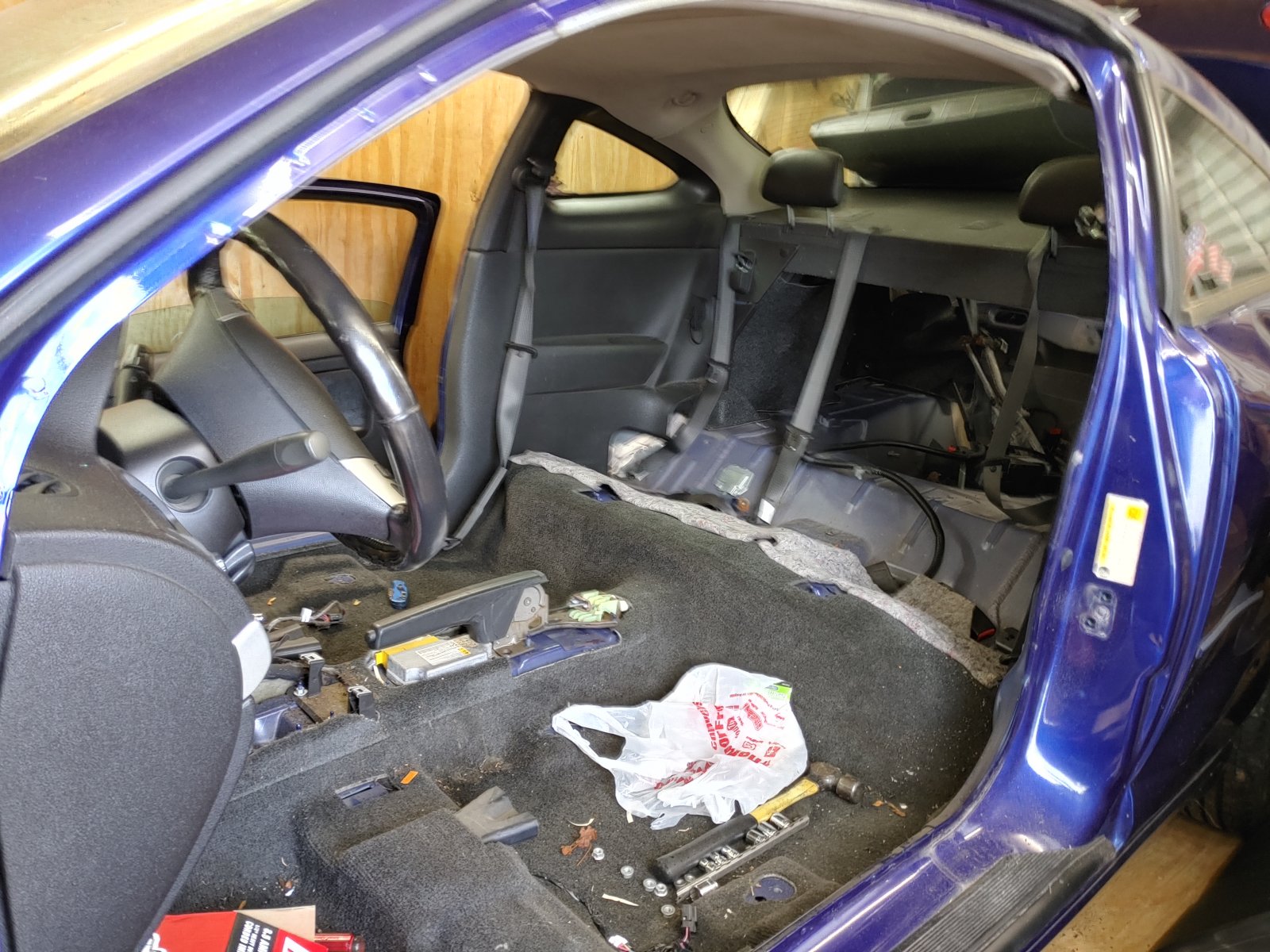

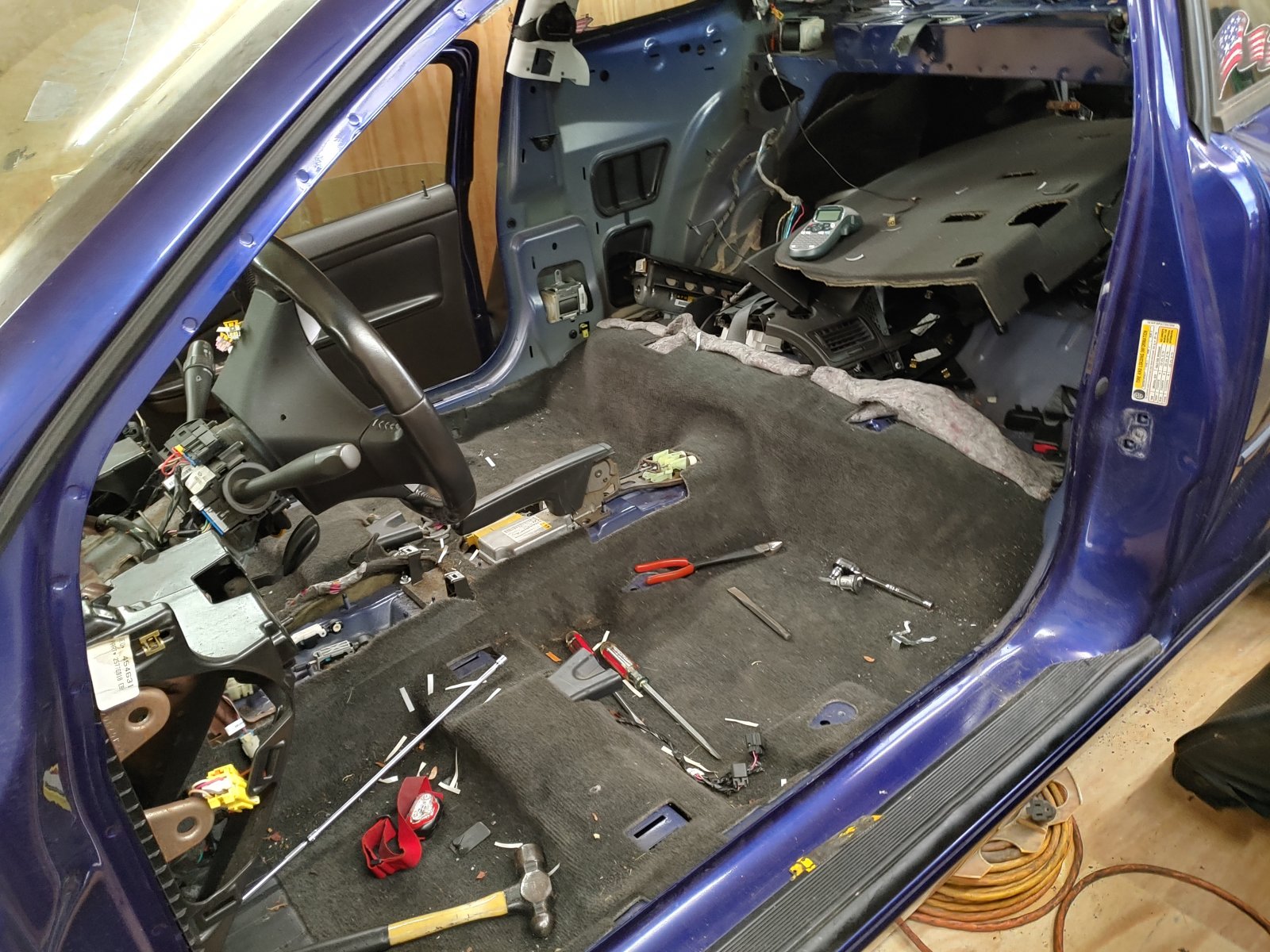

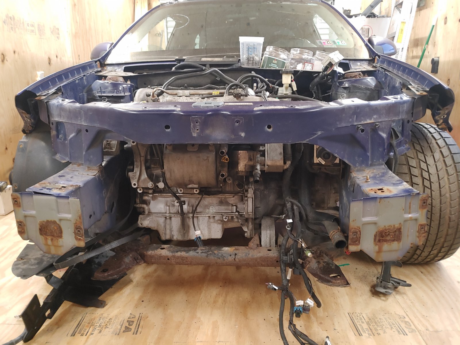

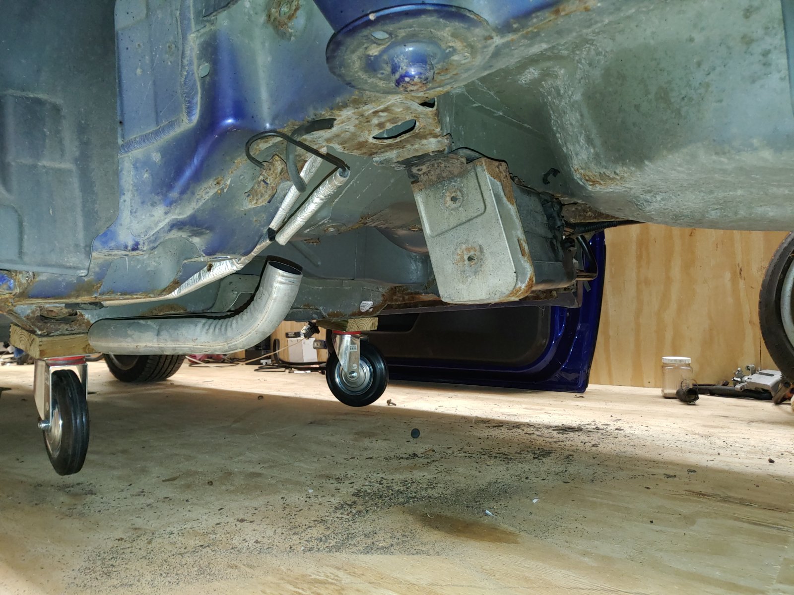

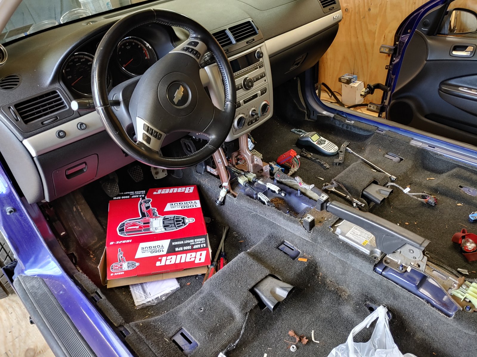

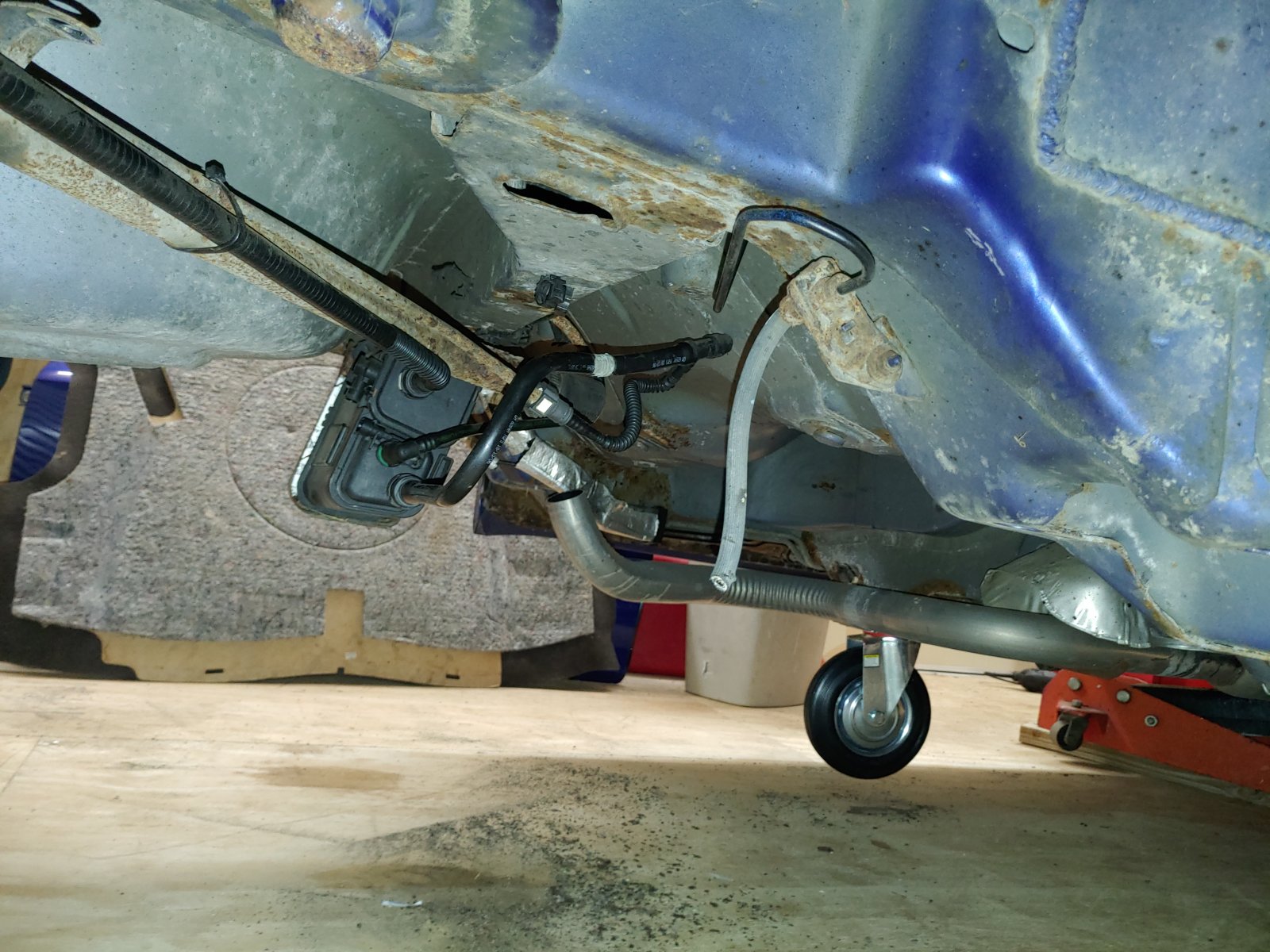

I got a little further than this pictures, carpet is out and a few other things. I'm at a point where I need to decide front suspension and engine or rear suspension a fuel tank. I'm going to weld swivel casters to the frame so I can move it afterwards.

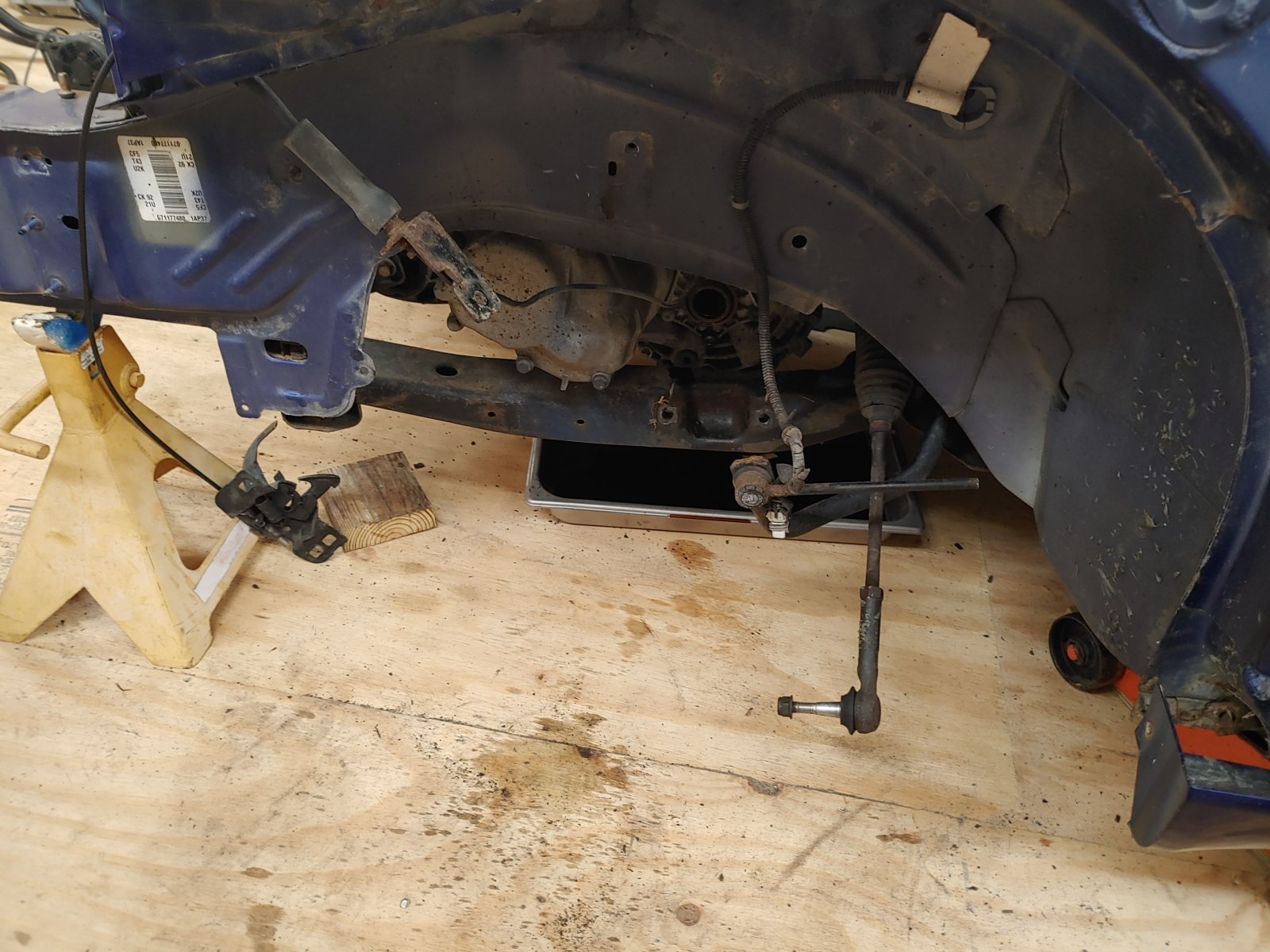

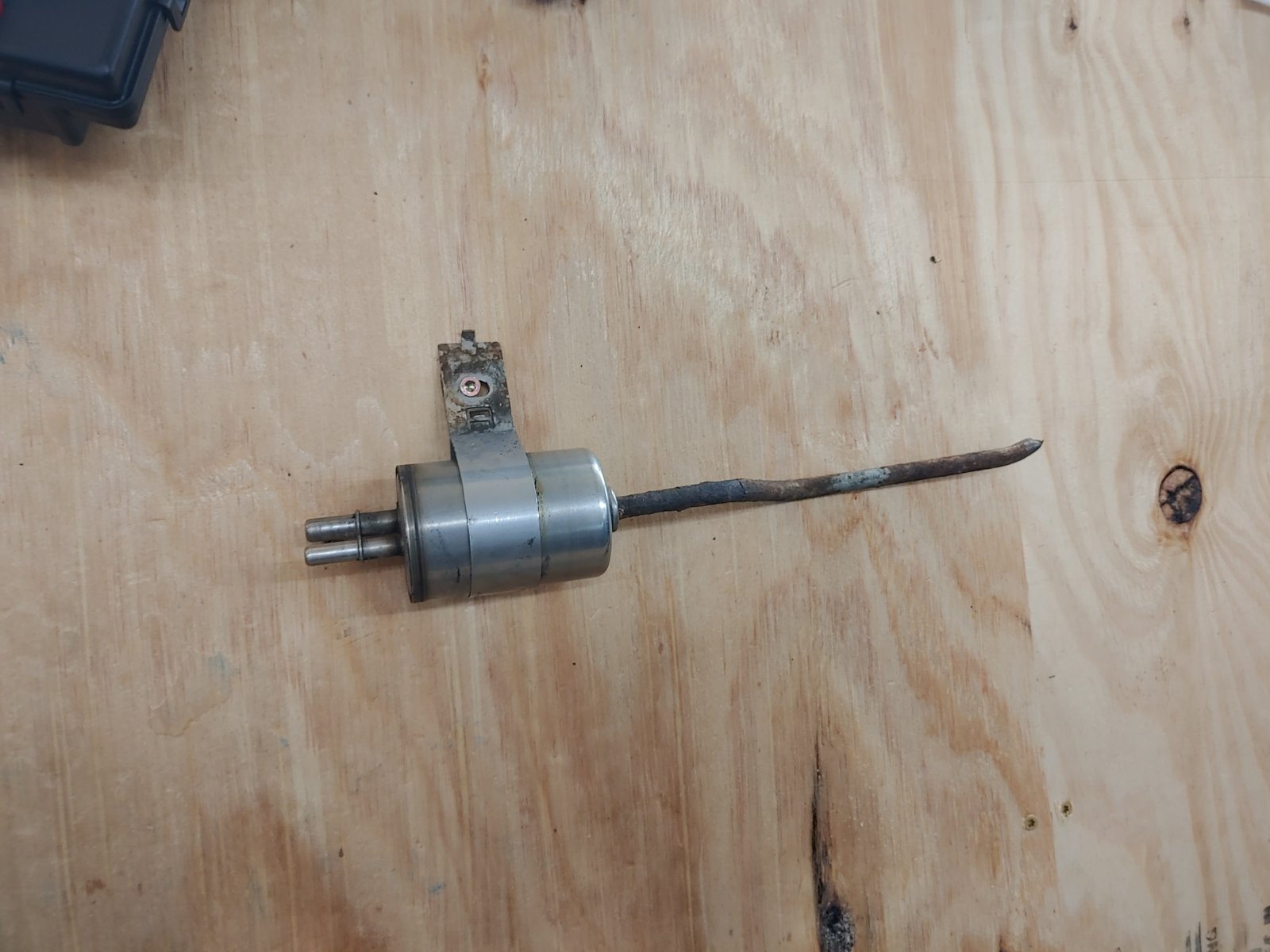

So a little work happened today. Removed the rear suspension, fuel tank, E-brake and tubes. I still need to pull the fuel filler neck after that the rear will be done. I started on the front suspension with the drivers side, it wasn't as bad as I was thinking it would be. The picture with the fuel filter, did i screw up by cutting the hard line? The car is ate up with rust and that hard line was bubbling with rust. The release tool wouldn't fit till I scrapped the rust off with a screwdriver, then it still took a hammer to seat the tool.
