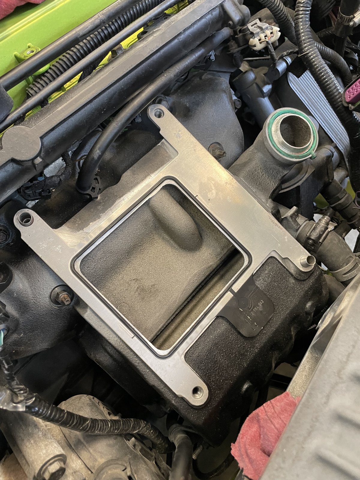

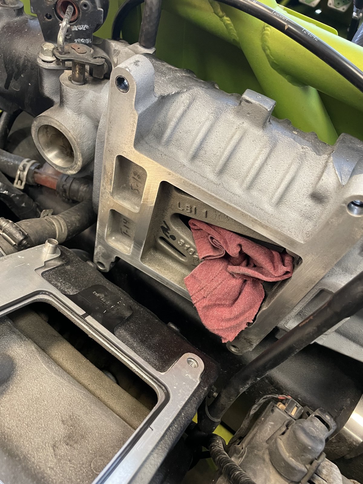

So I pulled the supercharger and it just appears to be a boost leaks between the intake and the supercharger. I had a clear oil residue where it had leaked. This also probably explains why I’m only seeing 4psi on my boost gauge. I tried to clean it and re-seat it. I was told the torque spec was only 18 ft/lb. I ran it after re-seating and still only got 4psi. Any suggestions on sealing it? I replaced the original seal during the build. I was considering removing the seal and using RTV.

With your Goblin parked, and engine off, replace the air filter with the exhaust hose from a clean shop vacuum.
Use the vacuum to pressurize the intake, and spray soapy water over the intake until you find all the leaks.
Or you could use a smoke machine, but you should remove the MAF sensor so it doesn't get smoke on it.

Gave this a try tonight. I could only get about 2psi of pressure with my shop vac setup. I’ve been seeing around 4psi when driving so I think I need to make more than that to find my leaks. Any other thoughts before I try the permatex?
Last ditch effort: Have a crazy friend kneel backwards in passenger seat, with a misting bottle of soapy water, spraying the intake, while you drive at full boost. A dyno would be safer to do this. Have a GoPro camera on the underside of the intake, and anywhere else it might help. See if you can make bubbles. PS, this is not my best idea, but up to you if you can do it safely. Russell's idea of checking for flatness sounds safer. Probably is. Probably.
I wanted to guess the boost bypass valve was opening when it shouldn't be before guessing the supercharger/manifold mating surfaces were warped, but that doesn't really explain the oil on the manifold. I'd think a smoke test would tell you if it's really warped mating surfaces.
