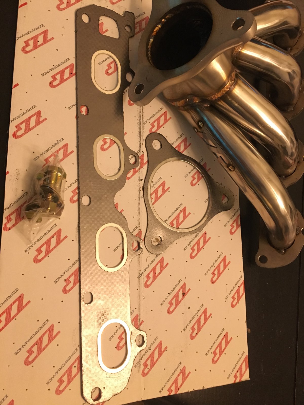

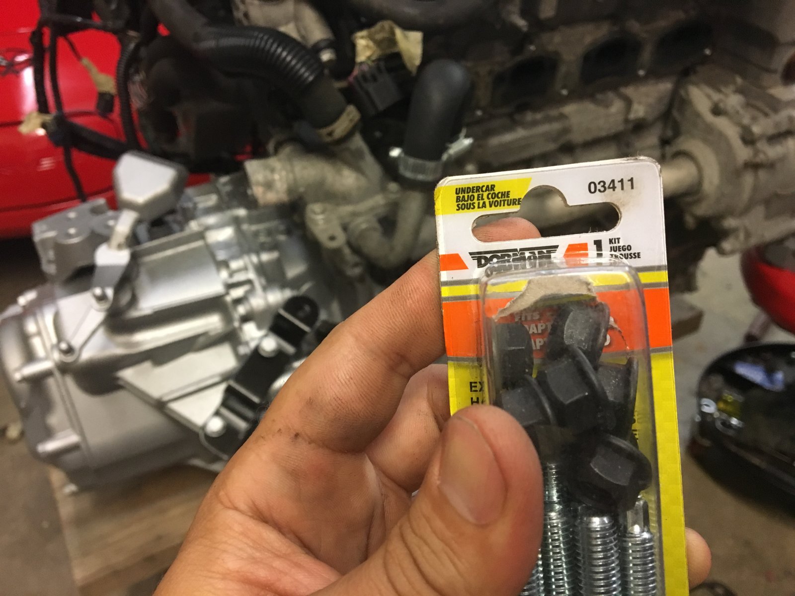

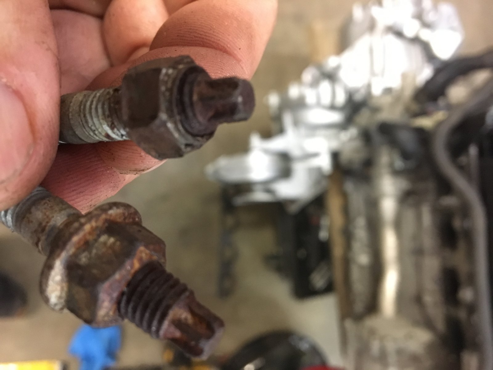

Just got the ZZP header ordered this evening. I also picked up some new studs because the old ones had the nuts rust welded on them the nuts were also different sizes for some reason.

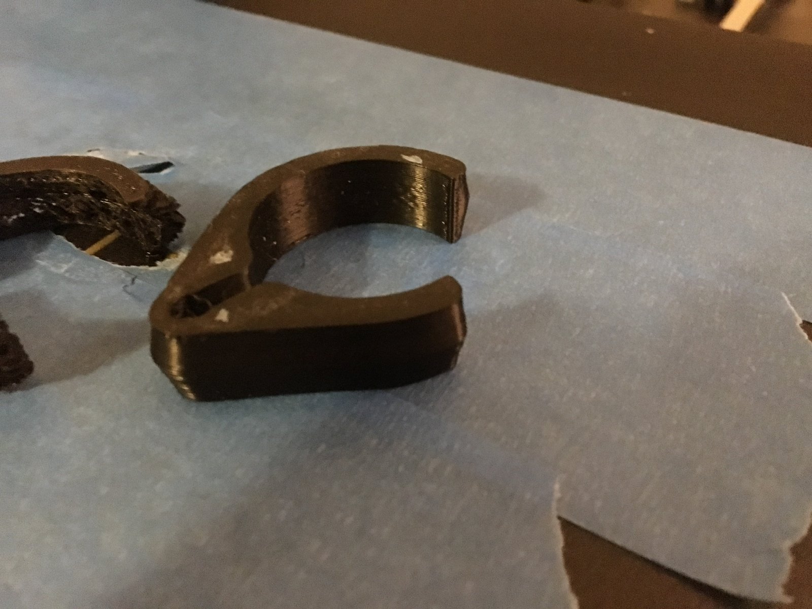

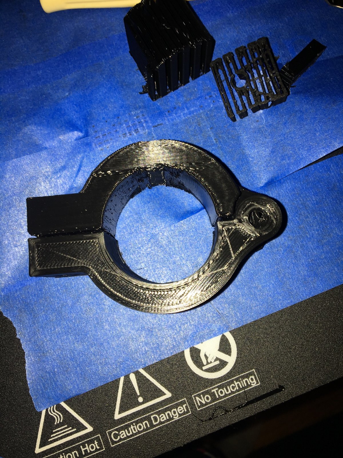

Playing around with the 3D printer and found some files on thingiverse that may be useful. 1.25 inch brake line clips and some 1.5 inch clamps that could be used for mounting different things to the frame. I also tried scaling the 1.5 by 83.333 and got 1.25 inch clamps.

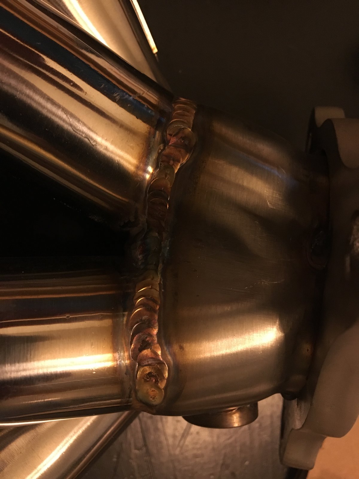

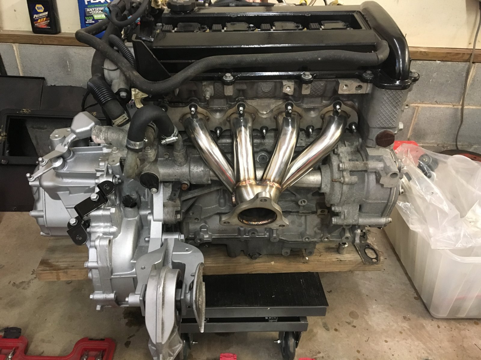

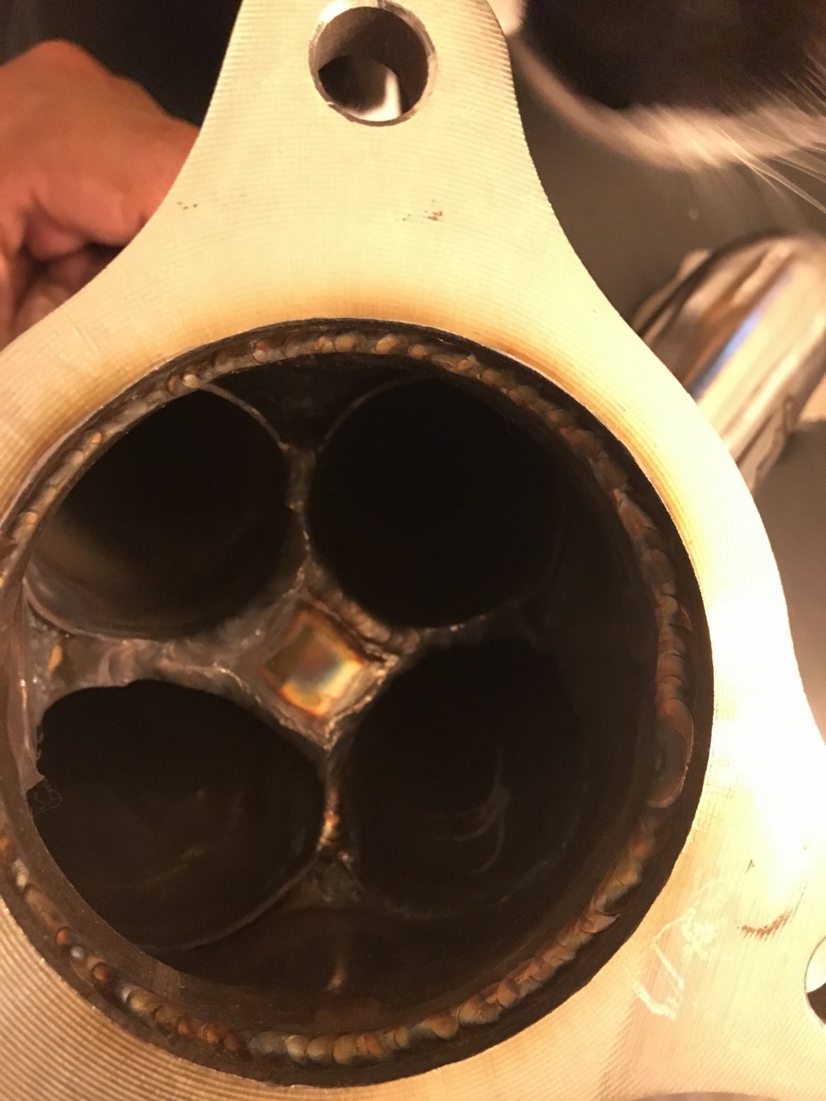

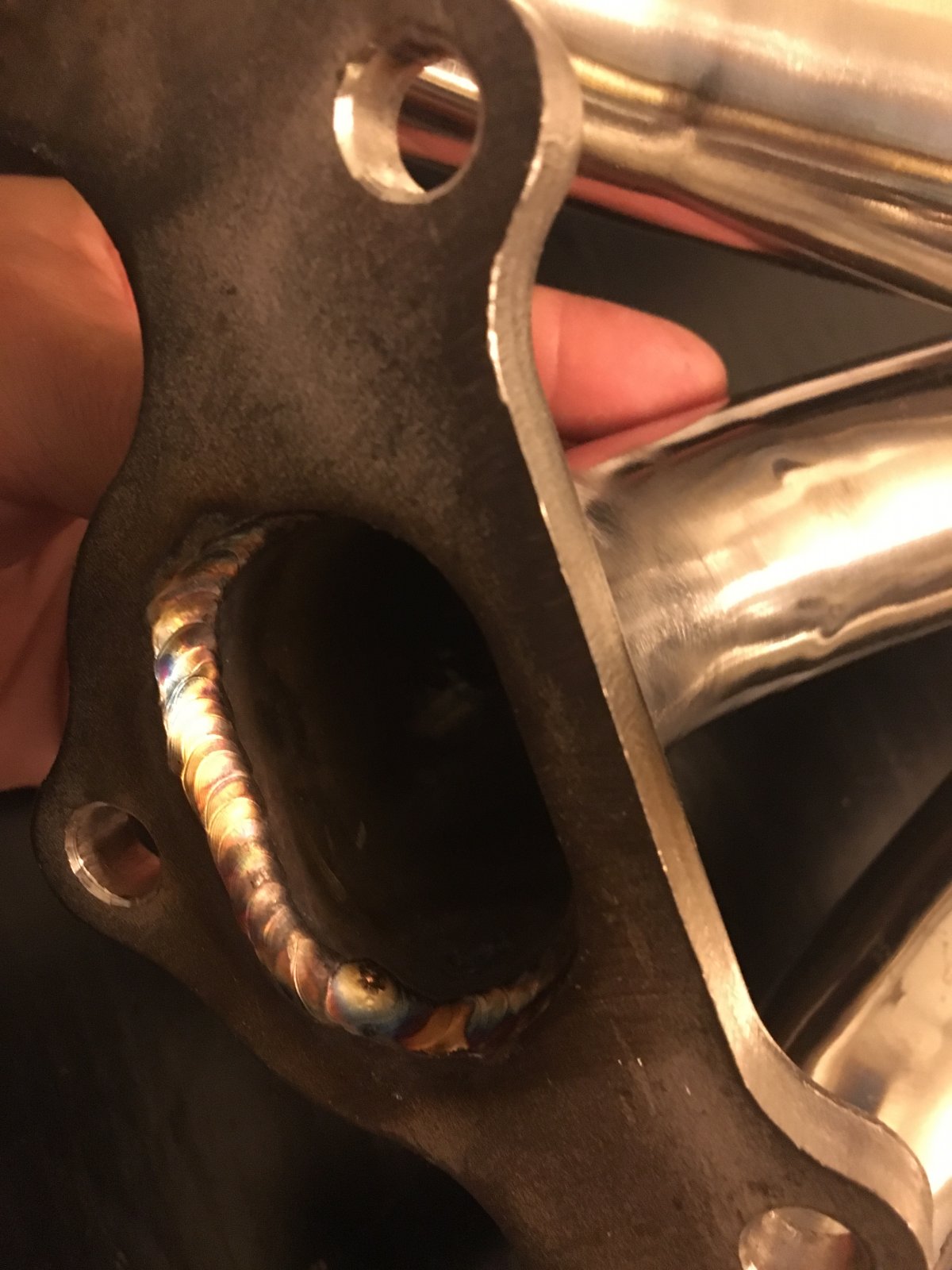

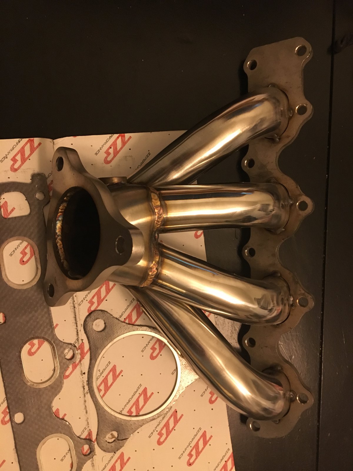

Got the ZZP Header in the mail today ! Looks great, I got excited and had to install it right away !

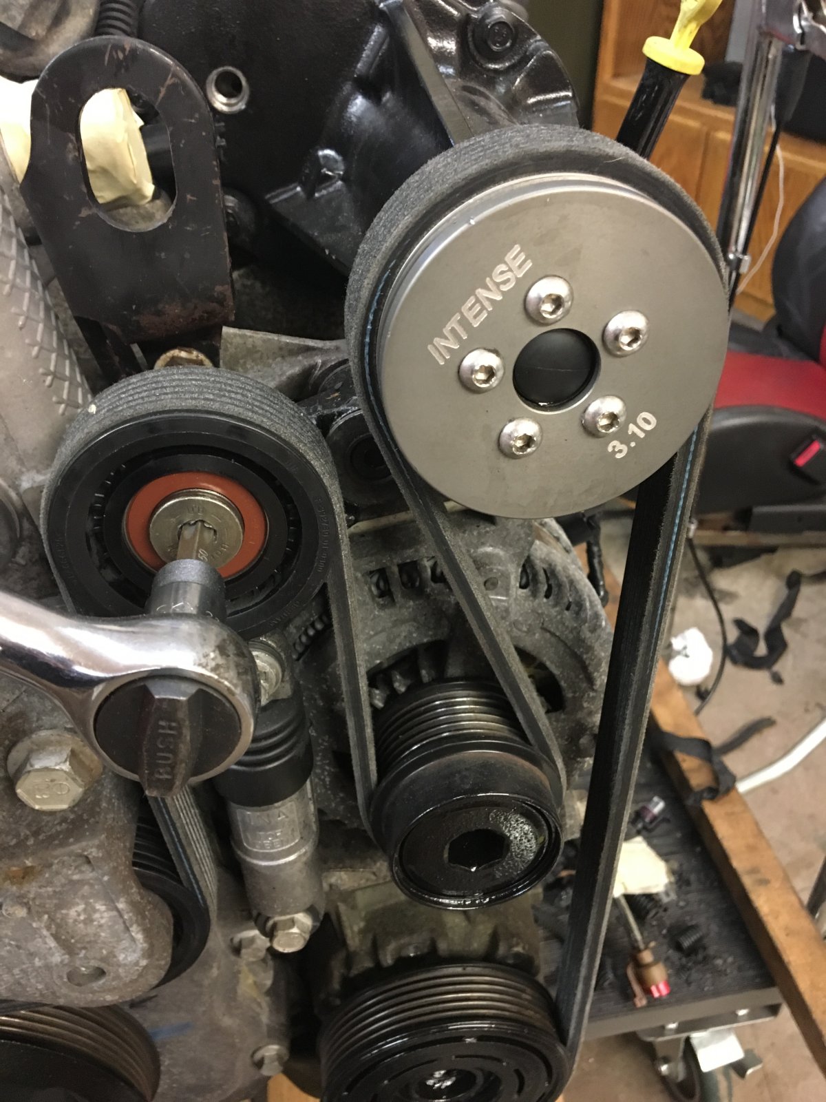

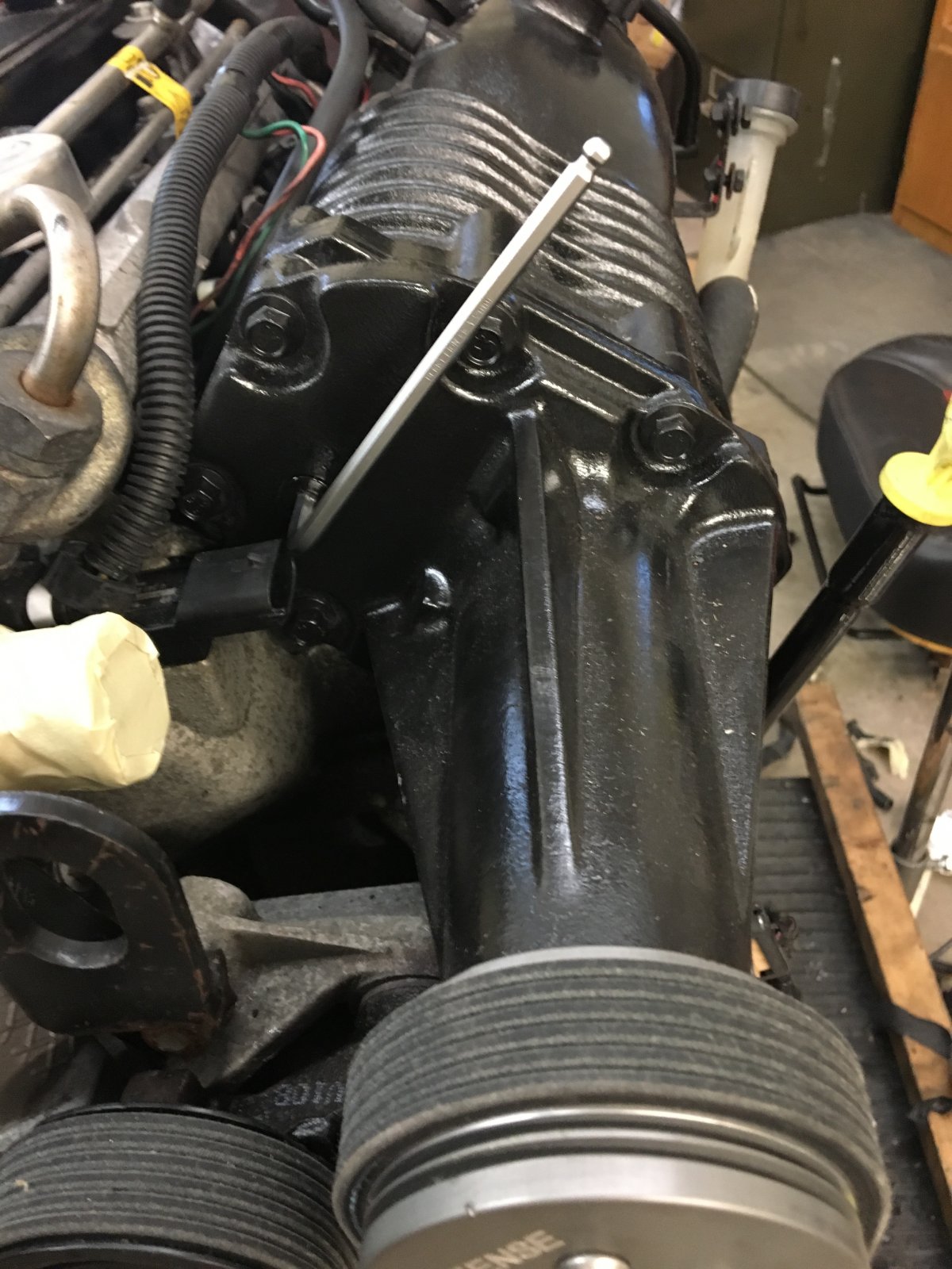

My 200k supercharger is making a little noise on startup hopefully a new coupler and some fresh oil will quiet it down. I would hate to have an excuse to buy a 1320tvs but if this doesn't work that may be the route I take.

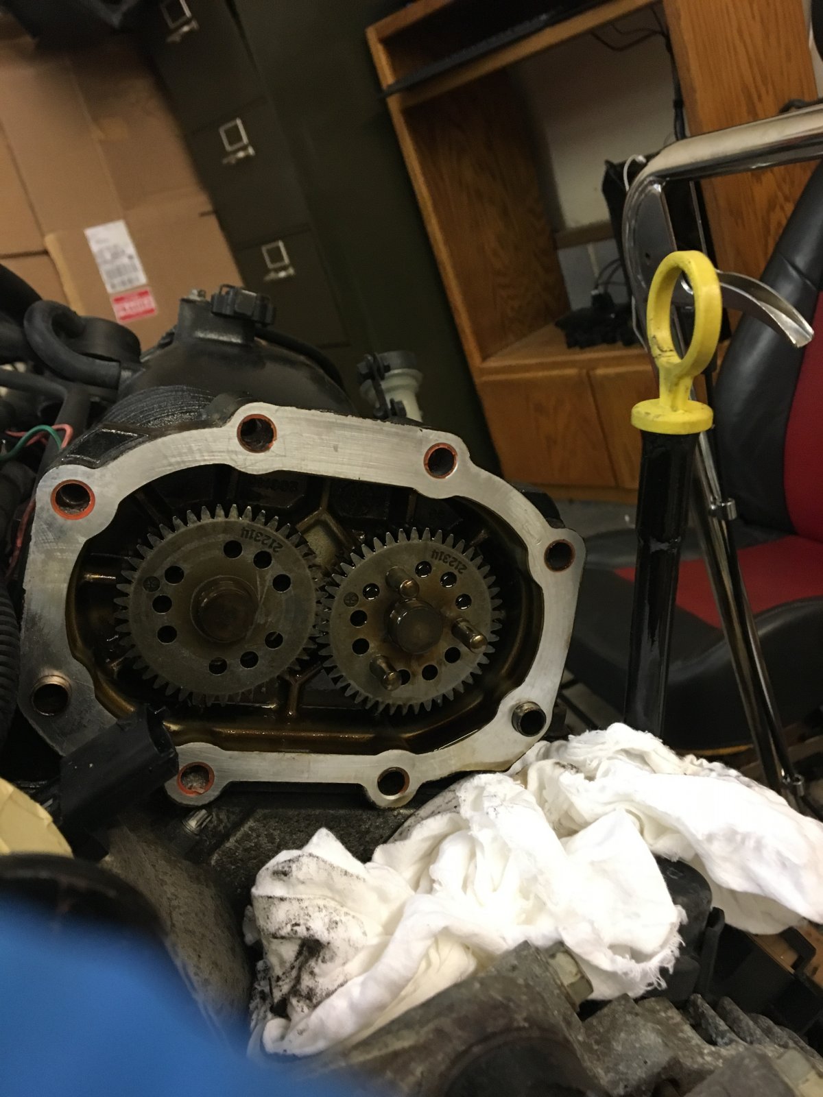

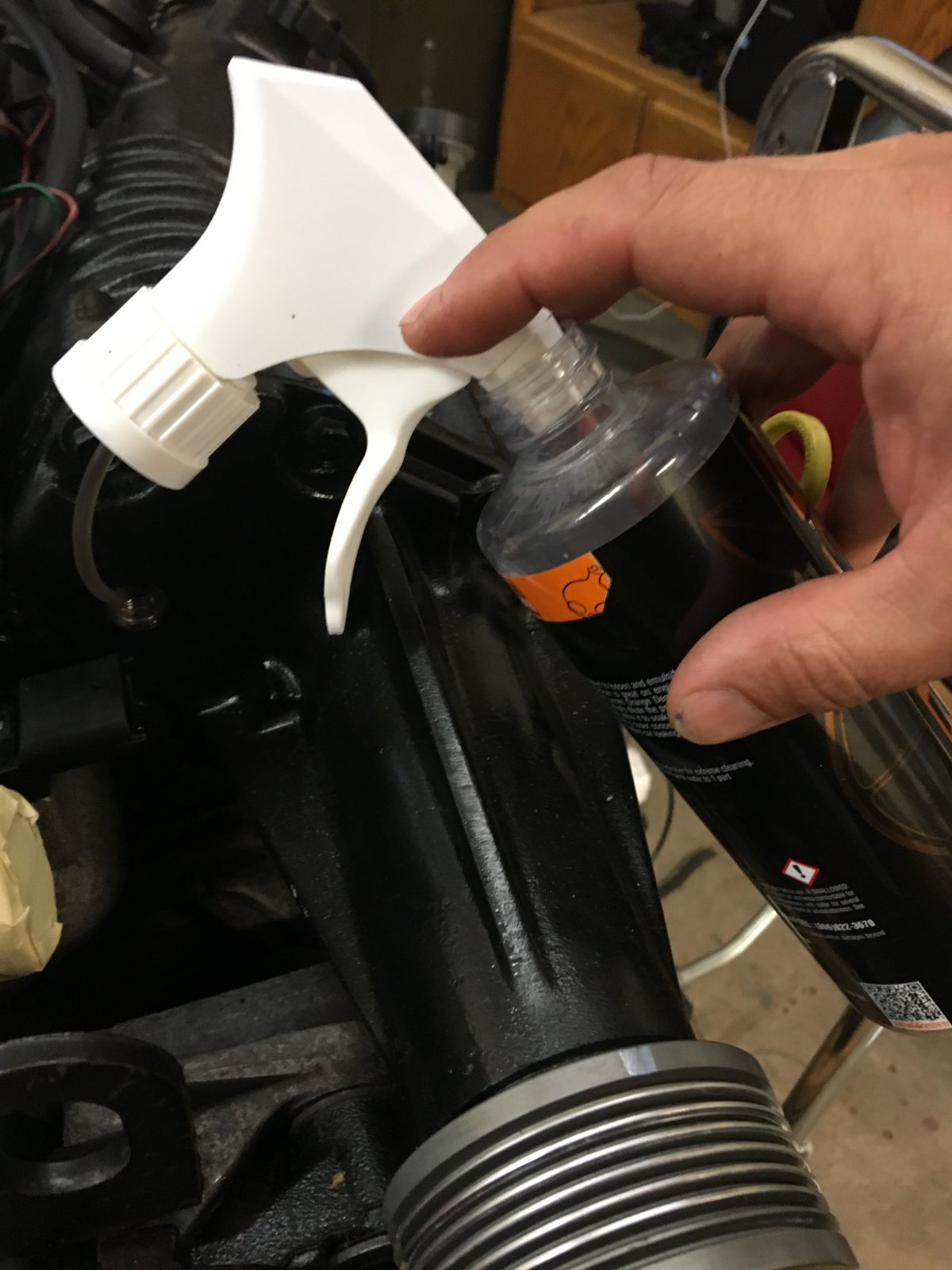

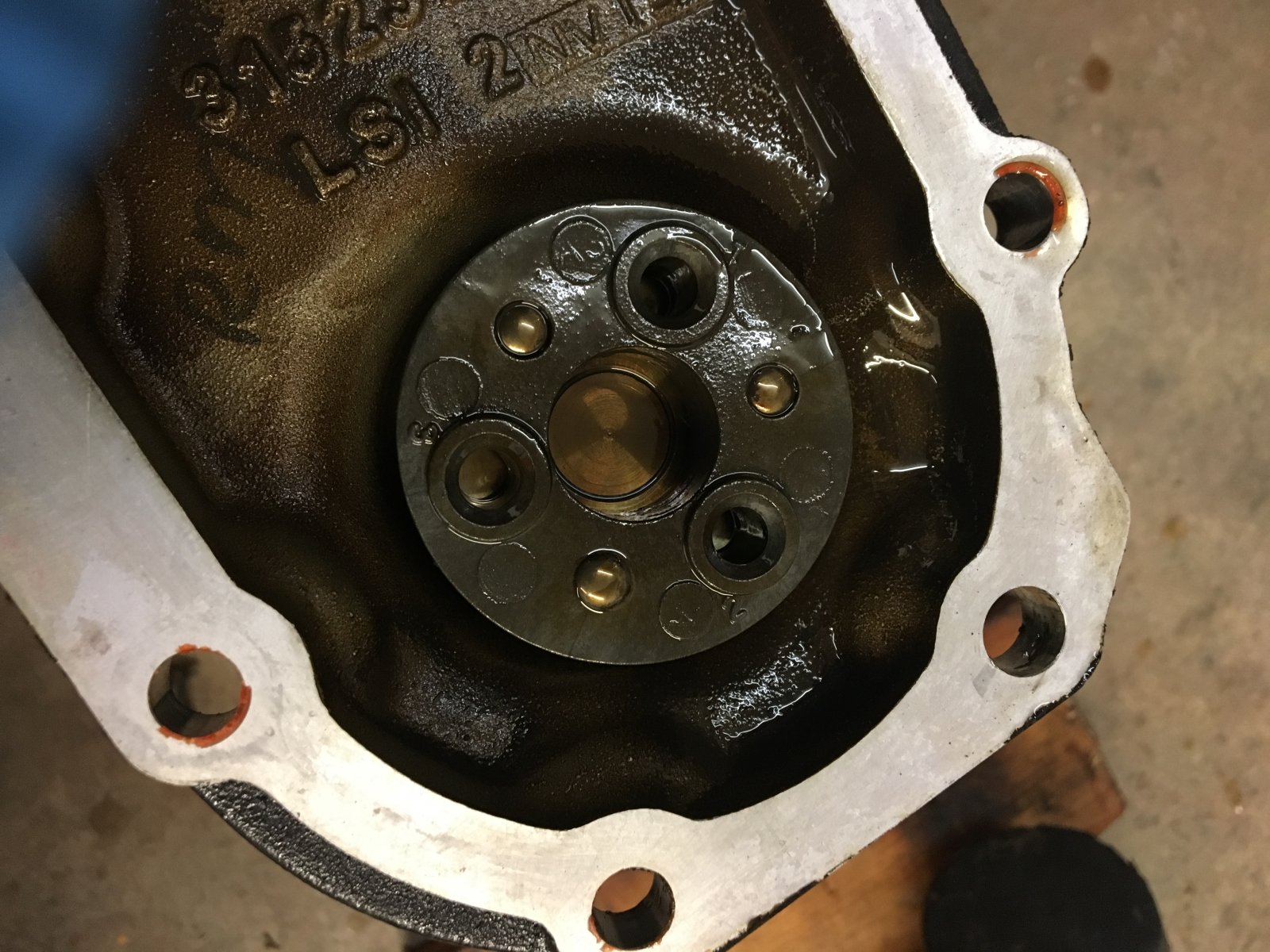

Found the fill hole and pumped the old oil out with a Windex spray nozzle before popping the snout off.
My old oil smelled like stinky blue cheese !

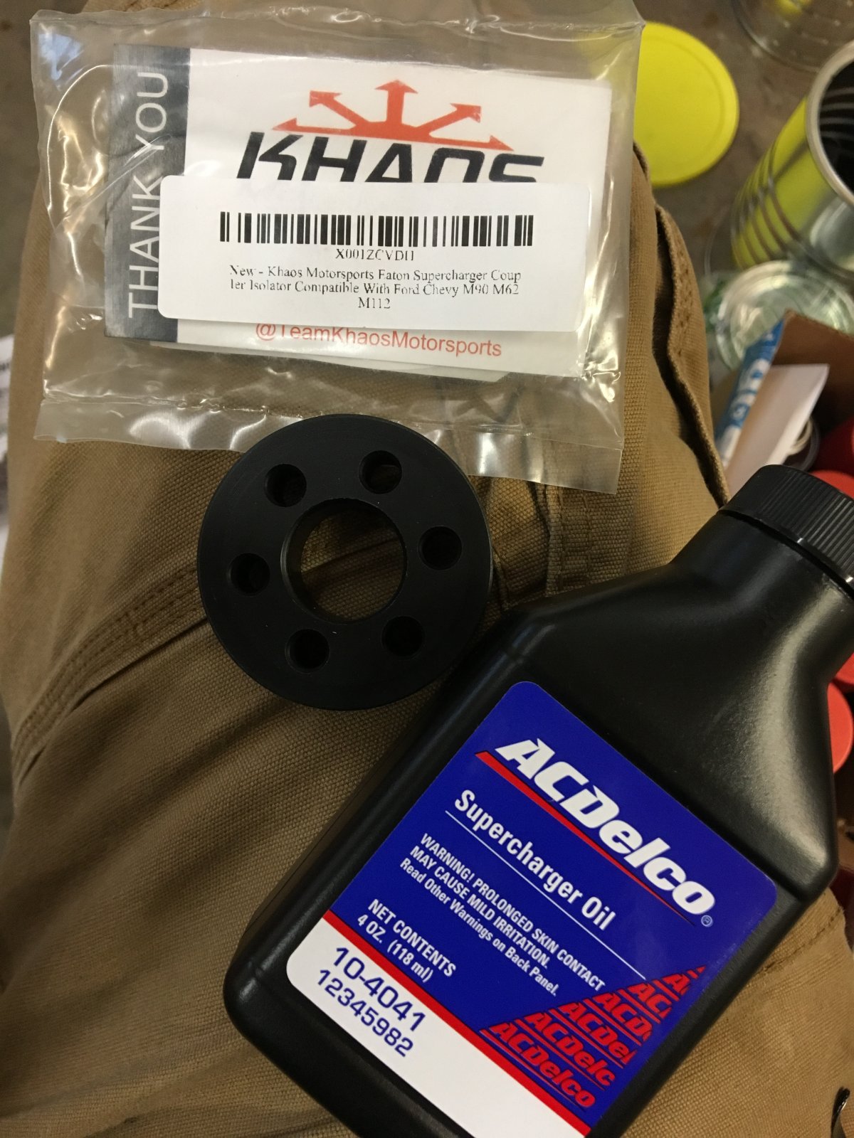

I actually remembered how to loosen the Idler this time to take the belt off but the star nut is starting to look worse for wear.
The coupler was really easy to replace and only cost 10$ I did use two bottles of the supercharger fluid but I may have spilled half a bottle on the floor trying to fill it back up the wrong way. Hopefully this will remedy my noisy supercharger.
