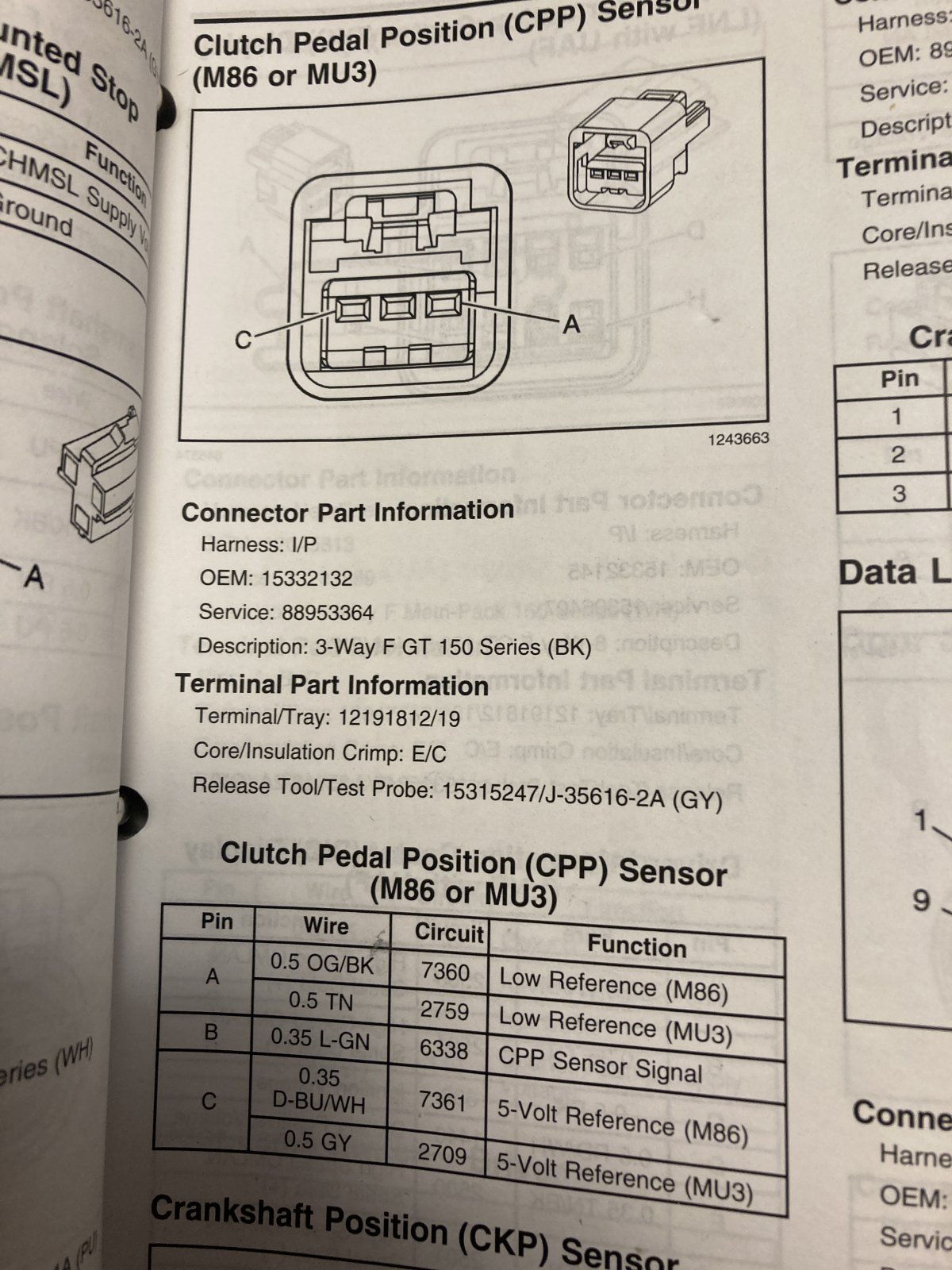

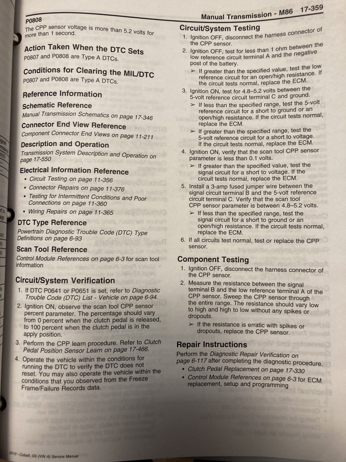

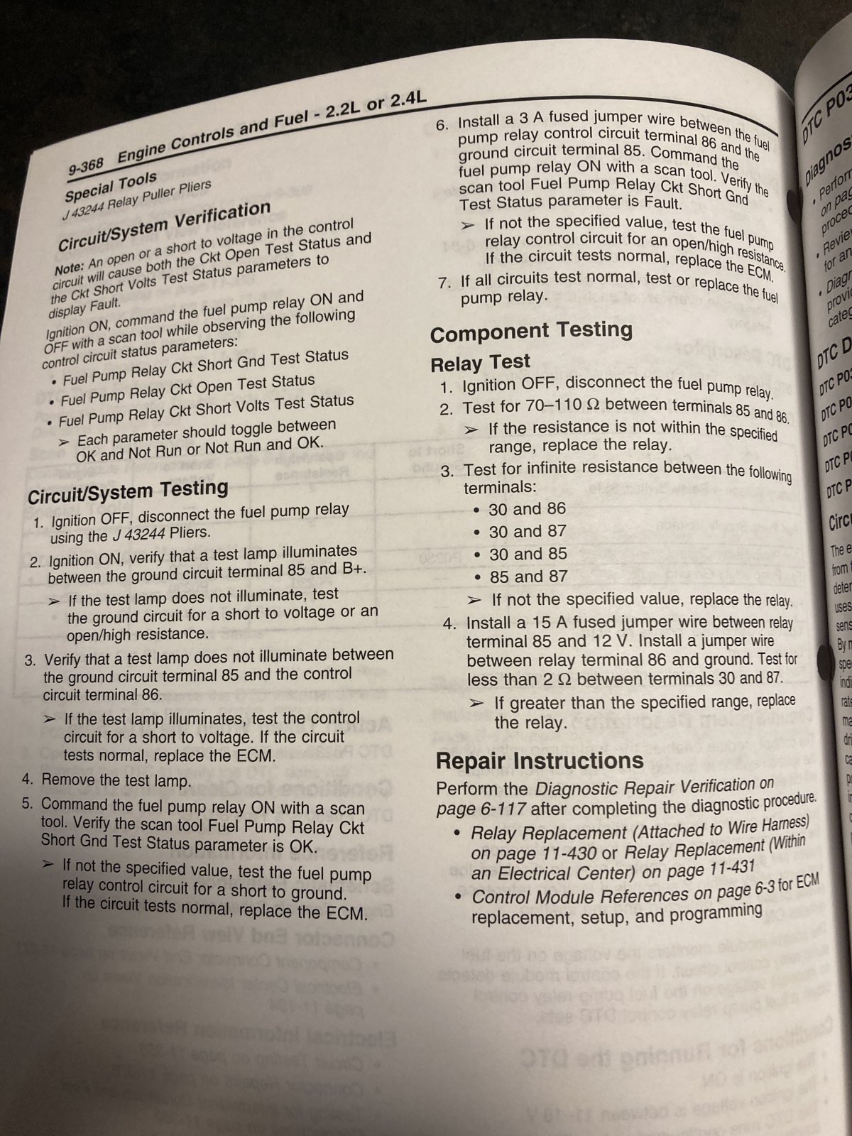

I've got a no crank, no fuel pump problem. I'm getting communication and codes P0230, P0807 and P0808. I can't believe the little clutch switch needs to learn anything, but I've seen dumber things on cars. I've been following ALOT of "no start" "no crank" posts and tried many of the fixes with no luck. I have done a key relearn and fixed a communication problem so I now have 60 ohms between OBDII pins 6 & 14.

You do need to do a clutch relearn if you replaced the switch, but I am not certain it would result in codes if you don't do it.

I've got a battery, a starter and a fuel pump. Just add some wires, maybe even use the factory relays, and I'm there. No?

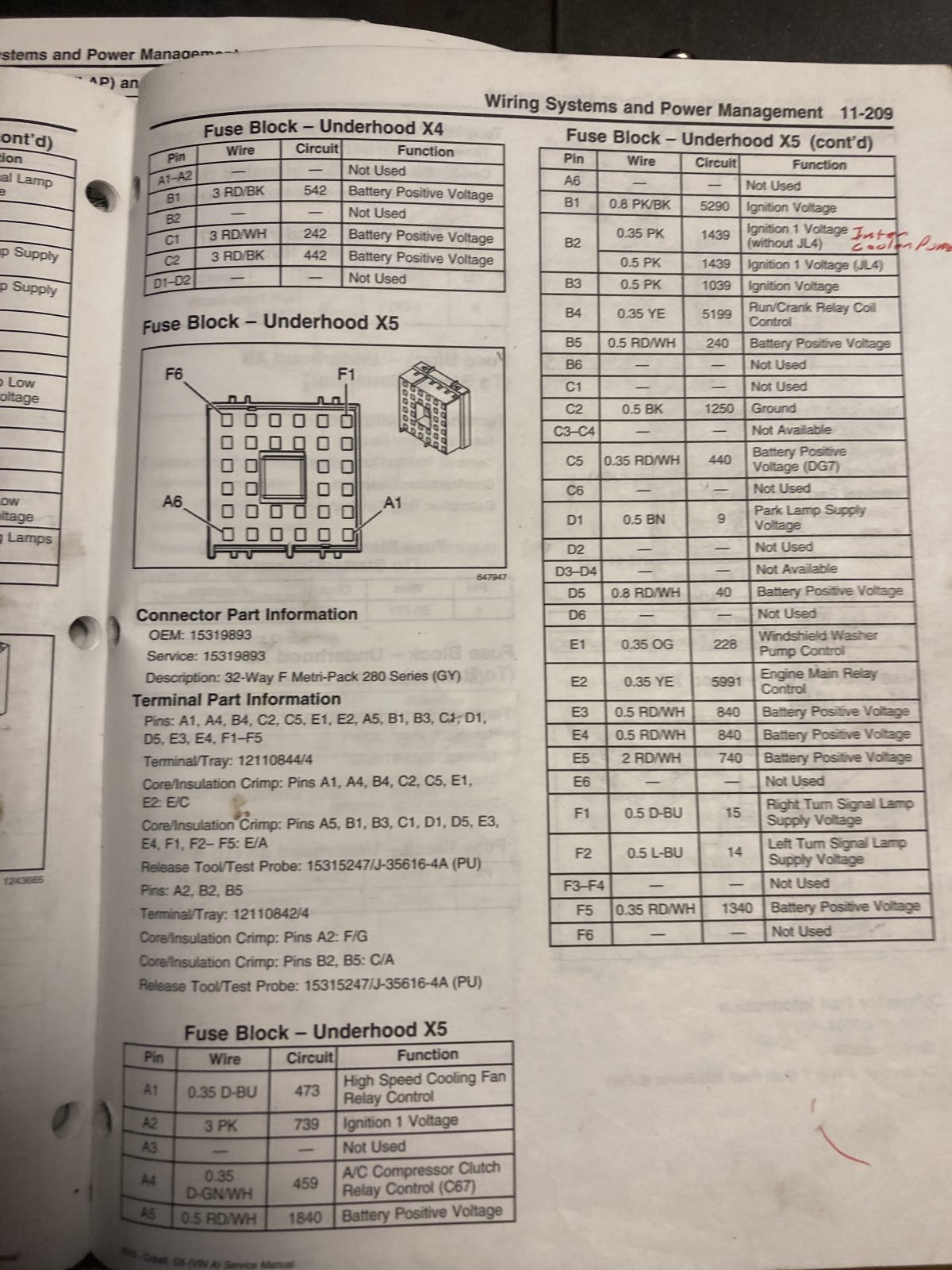

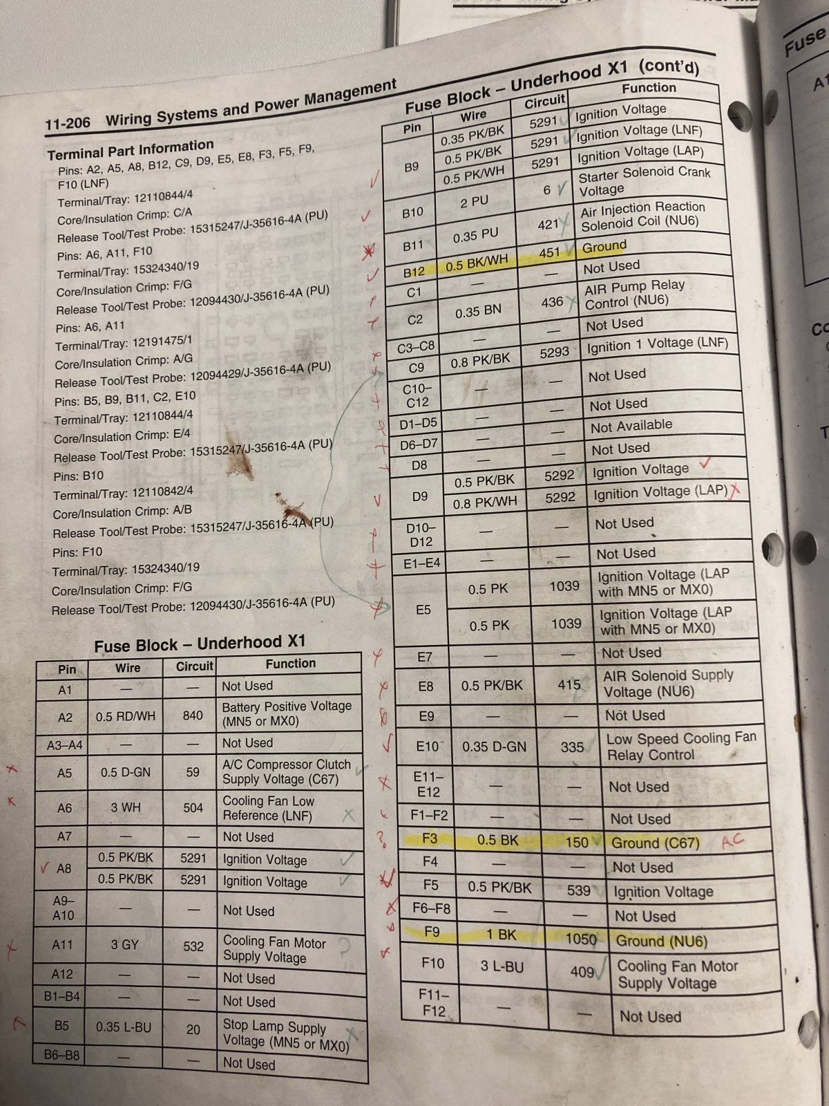

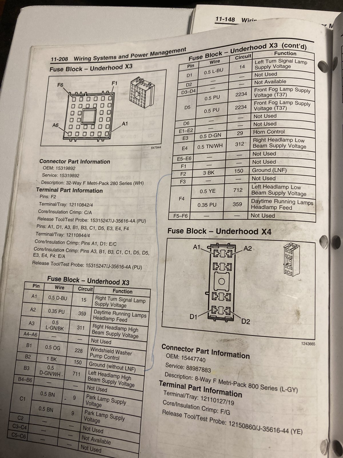

I'm working of wiring information someone posted. "Vehicle>Power and Ground Distribution>Fuse Block>Diagrams>Connector Views" from a 2006 2.0 SC. It's a little different than my 2008 2.2LS.
Does anyone have this info for the 2008? My plan is to check and fix as much as I can and then call a GM tech in. The mechanic where I broke down my donor is pretty good with this stuff. I just want to check and correct as much as I can before I bring him in.
As usual, thank you to everyone who has offered help and support!
Lndshrk Steve
Thank you. A quick look shows the one ground at A6. That's the one I was missing (and I added), but it didn't fix my problem. I'll check the rest to make sure everything is correct. Thanks again!
