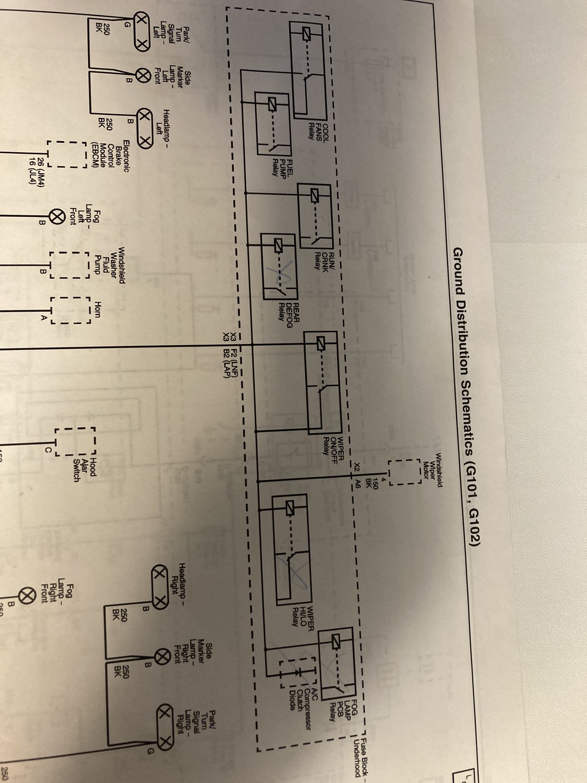

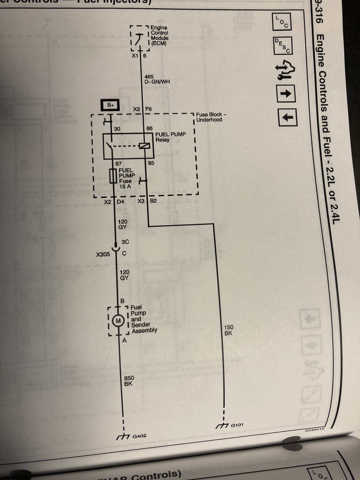

Taking a long shot to help me out. I'm checking what I can and I'm looking for the ground at the fuel pump relay. From what I see it is pin 85 on the relay, which grounds thru F2 @ X or C 3. But F2 (which I don't have a pin in) is for the LNF, for others it is B2 (Ground without LNF). I have no continuity between B2@ X3 and where pin 85 sits. I have no continuity in any of the 4 pins for the relay. Am I maybe missing something? Again, thanks for any and all help.
You should have continuity from X3 B2 to pin 85 of the fuel pump relay. Could be a bad circuit in the fuse box. Are you checking from the pin on the fuse box for B2 or on the wire of the connector?
That X3 B2 ground is tied to a lot of the other relays.

I'm checking at the pin on the fuse box. I can't figure HOW the fuse box would mess up just this ground, or mess up anything. It worked before and everything I look at says B2 at X3 is the ground. I do have ground continuity for X3 at the B2 pin location. I'm stumped. Thanks for taking the time to look into it for me.
Are you checking continuity on the B2 pin or the wire? If the wire then you may need to tighten the wire ind connector.

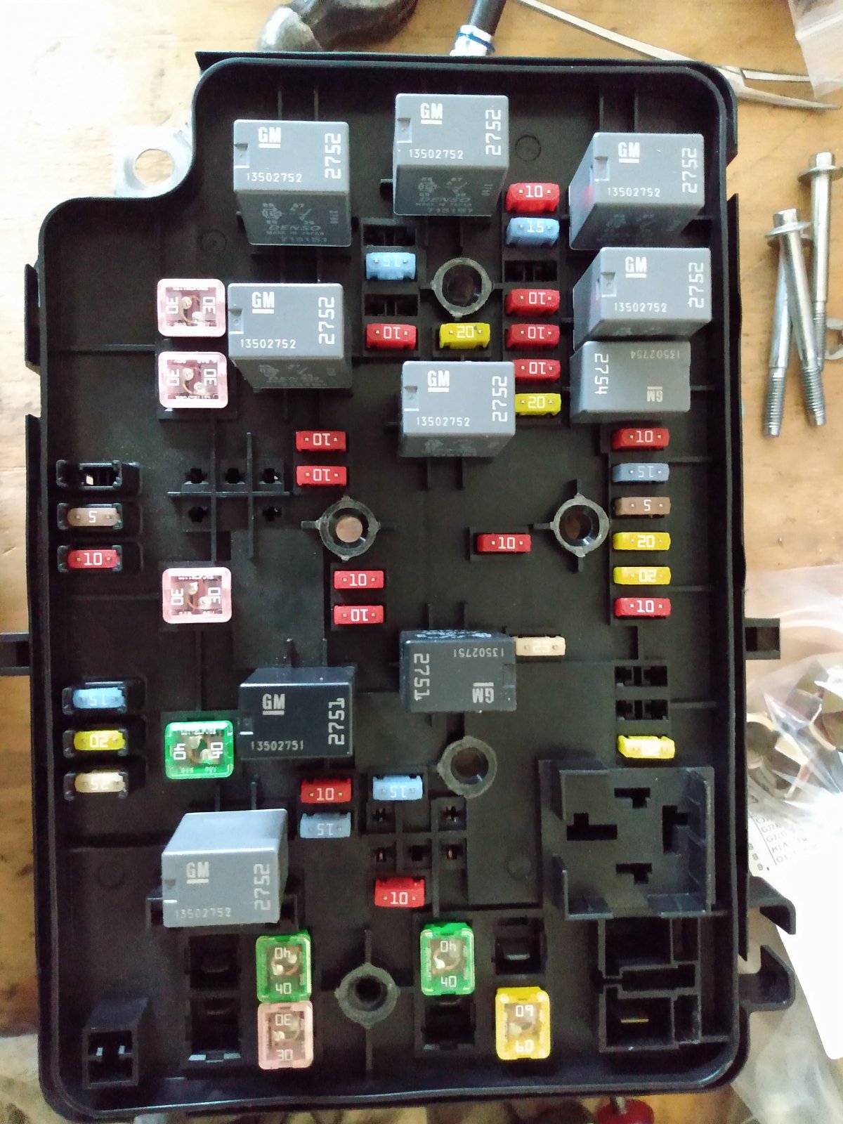

I checked and it seems I have NO grounds on my fuse box. So I pulled the bottom off and that looks good. If I remove all the fuses and relays, can I remove that top piece from the circuit board? I thought I'd ask before I pull everything off.
Lndshrk Steve

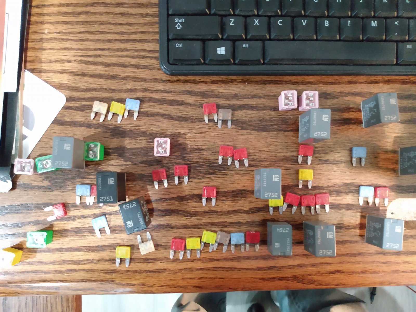

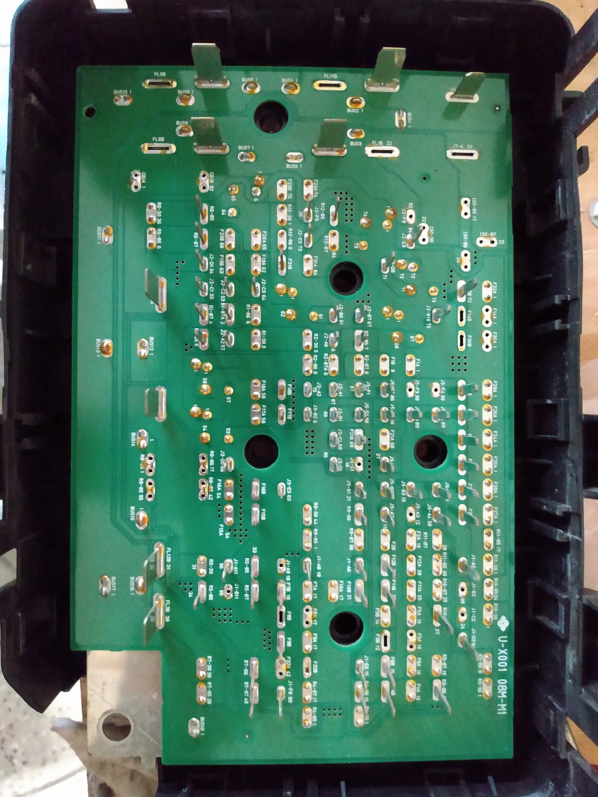

Ok. For those that want to know, once you move the tabs and pull the bottom off the fuse box, all you have to do is remove all relays and fuses . . . . and the circuit board falls out.
Unfortunately, my board looked fine. This doesn't seem to be my problem. I have no idea where my problem is, but it is not obvious here.

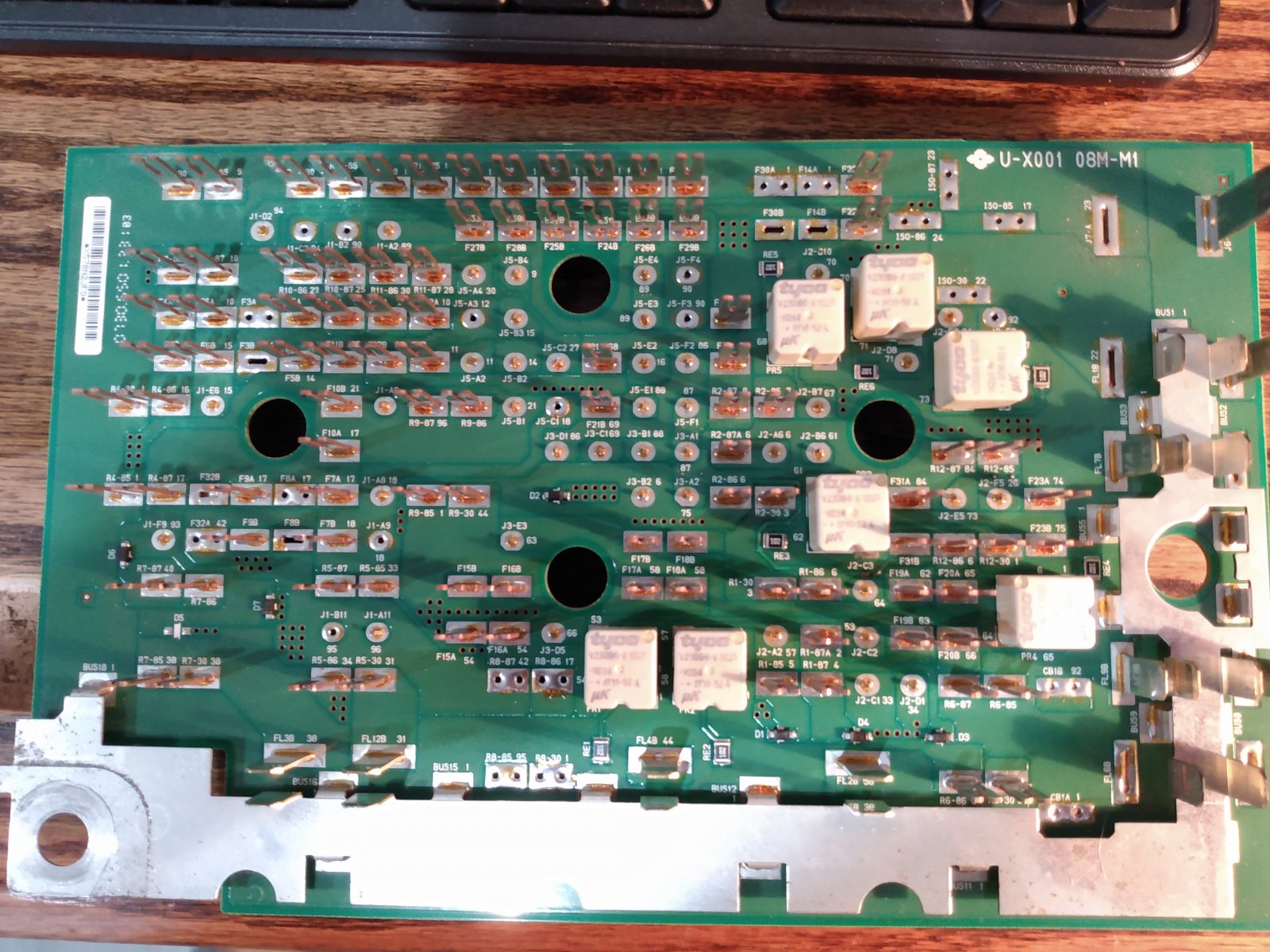

find pin X3 b2 on the bottom of the board and check continuity to the pins for the fuel pump relay on the top. One of those pins should be the ground. I think it will be the one labeled r12-86 but I’m playing with one out of the LNF.
Post 30 edited since I had the wrong label for x3b2. My board doesn’t have that pin.
If you look close you can visually trace the circuit on the board. If you come to spots with holes in the board it transfers to the other side.

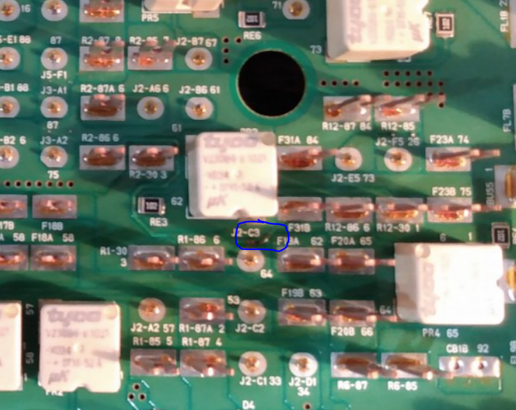

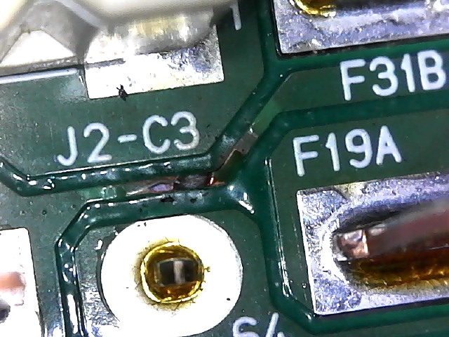

Is that a bad spot on the board circled in blue below, beside the J2-C3 label? I can't quite follow the traces in the picture but it looks like it might trace to R12-86 which should be the ground for the fuel pump relay.
30949
That is definitely a spot on the trace that got warm or worse. The only way to check is to measure resistance at the opposite ends that the trace connect to. You should be reading milliohms (less than 1 ohm) across this spot. Anything higher and it will need a jumper wire soldered point to point t to bypass the bad spot in the trace.
Although it doesn't appear that the board labels are exactly the same it looks like it might be the same spot as burned out here;

Thank you guys for all the information and support! First thing tomorrow I'll pull the fuse box apart and put that spot under the digital microscope (just because I have one). Then we can get a good look and a picture of it. I'll keep you all informed.
If you are going to add a jumper wire, don't try to jump from one side of the burned trace to the other side.
It is easier to find solder joints on each side of the burned trace and add a wire from solder joints to solder joint.
I think I would go to the bottom of the board on the R12-86 terminal and solder a wire and and run it directly to ground or splice it to another of the existing ground wires. Another option would be to solder a jumper from R12-86 to (I think) R1-86.
