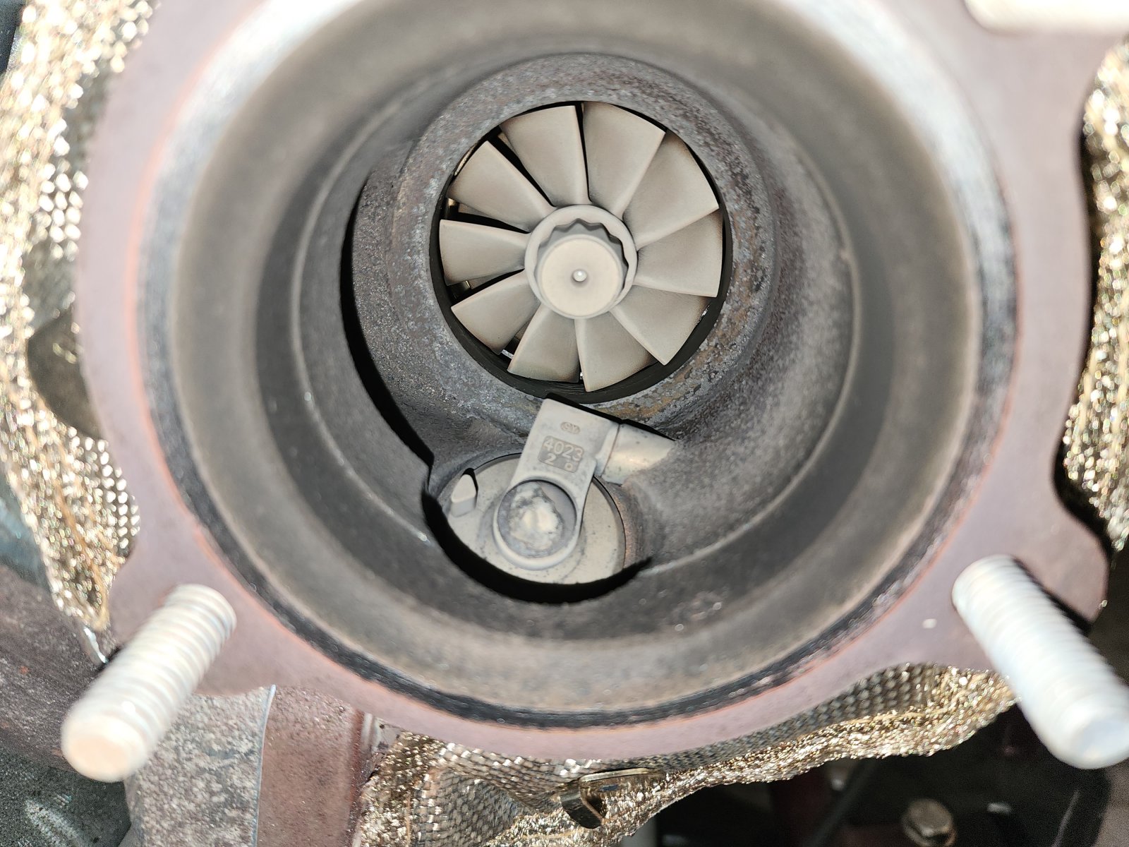

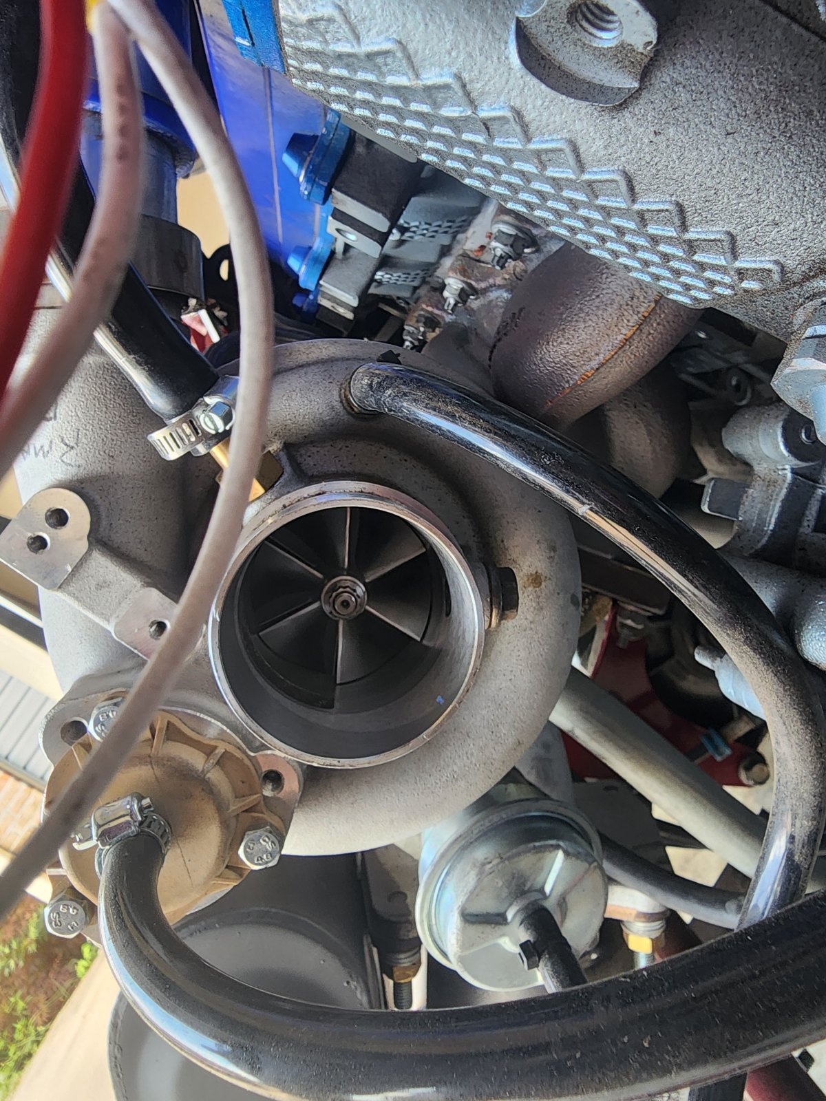

Since you had the intake and downpipe off was there any play on the turbine and compressor wheel? - maybe a slight back and forth in the axle of a 32nd or 64th of an inch. Nothing measurable without a special tool in my opinion. When I spin the wheel I can hear it spinning but nothing I would call unusual but none the less its the one place I might expect to hear nothing when I spin by hand.
Normally if we see the internal bearing structure fail and it dumps oil out the exhaust, we will see quite a bit of oil in the turbine housing, but it looks pretty clean. - This was my first assessment and the reason I took the intake/exhaust components off but I do agree both sides are pretty clean and no obvious failure there.
Do the wheels spin freely and at the same RPM while you spin them by hand? - Yes
Does the wastegate flapper open with movement of the actuator arm? - The flapper is in the close position I did attempt to move the flapper with no luck. However I didnt put much effort into it and moved along. Should I be able to move it easily?

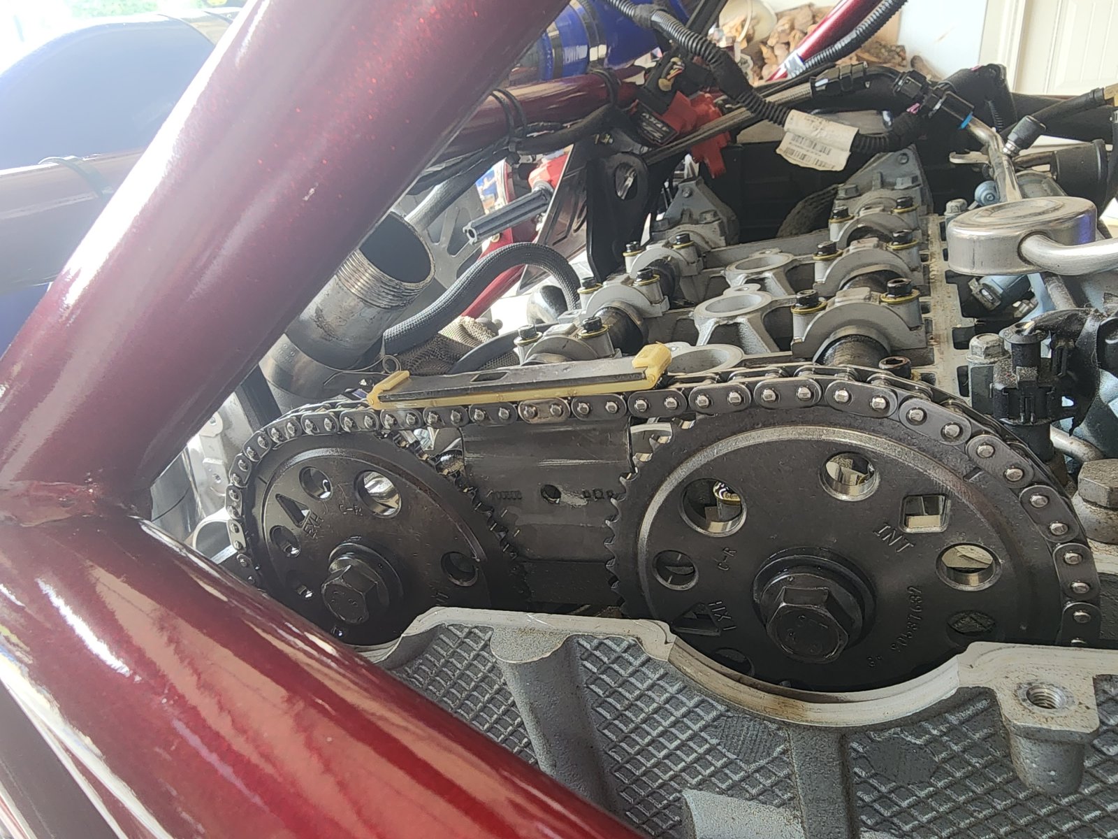

Timing chain or Head gasket both could certainly account for the smoke and no boost pressure! The whining still remains, I did not try to determine where the whining was coming from, I pulled into the garage a turned the engine off ASAP to prevent any additional damage.

My initial assessment was the turbo failed. But due to lack of oil or coolants found I kinda moved on to timing and possibly head gasket.

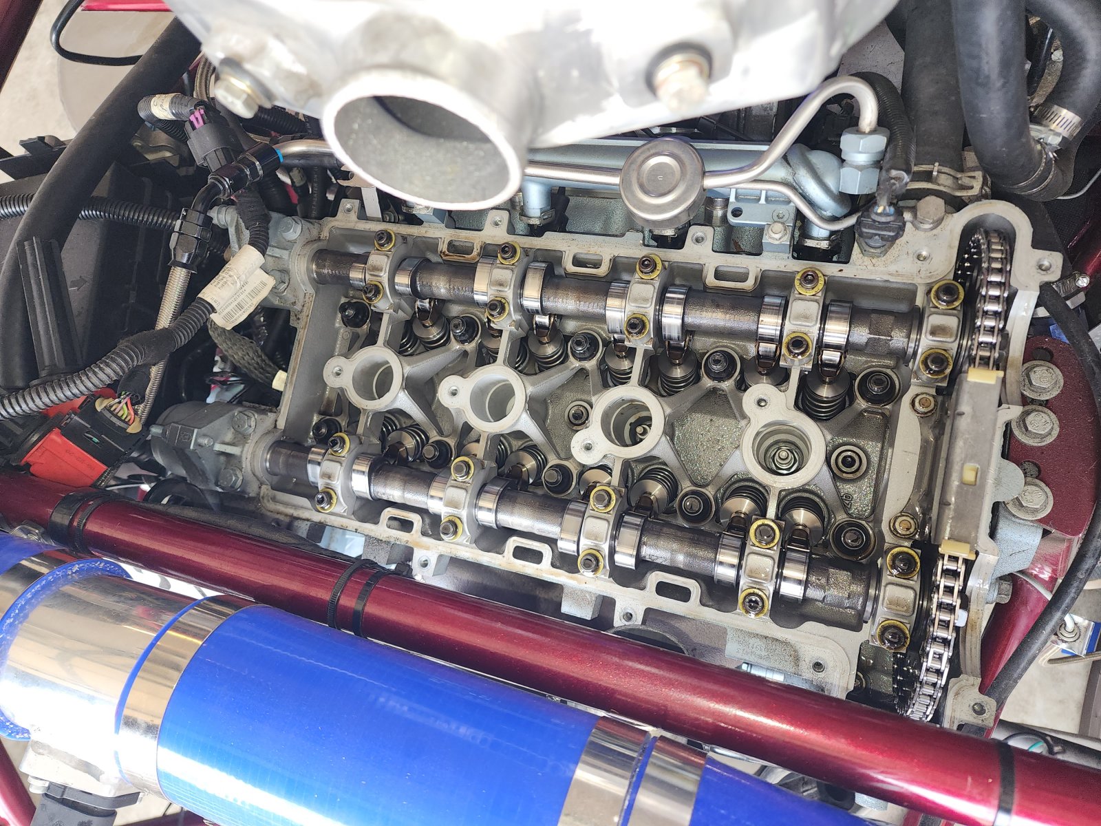

I pulled the valve cover due to easy. But waiting on forum feedback before pulling the head.
