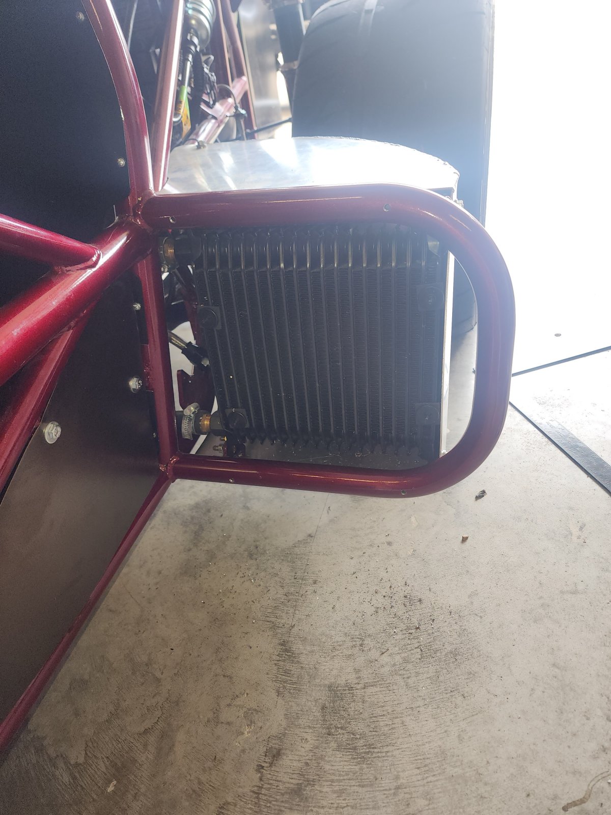

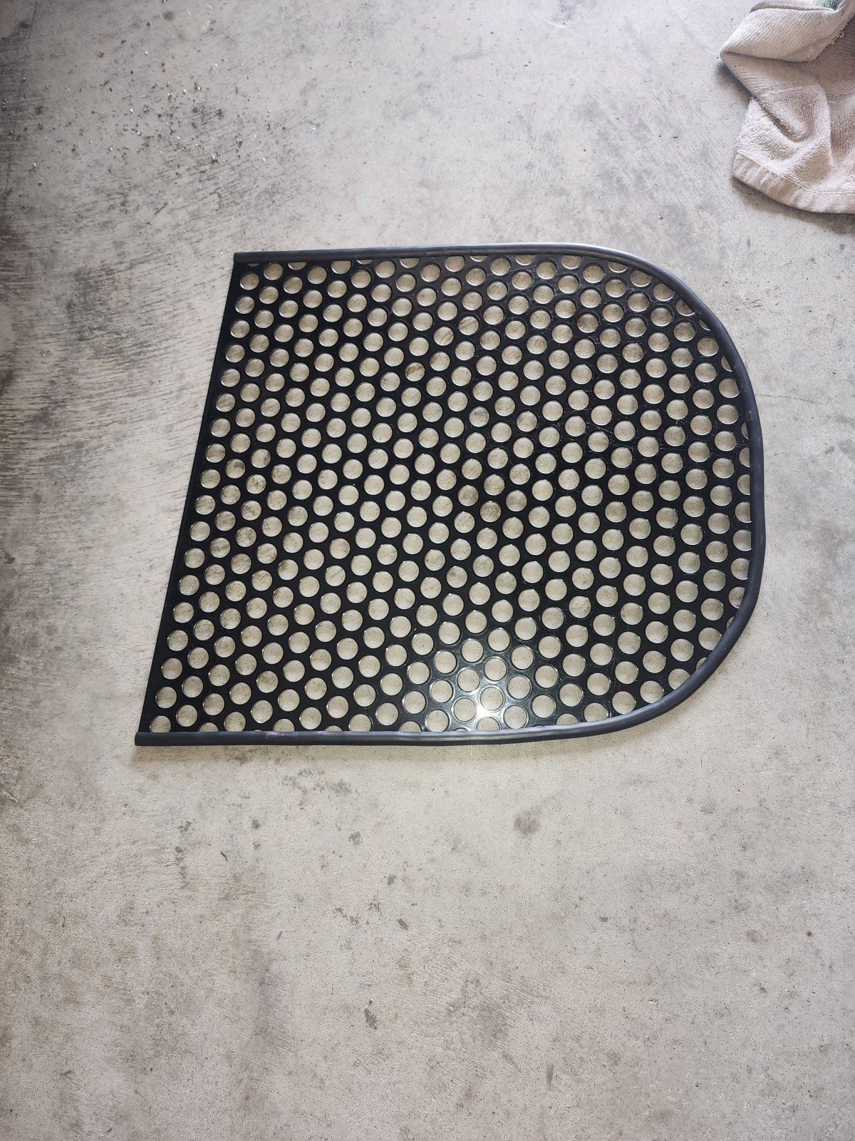

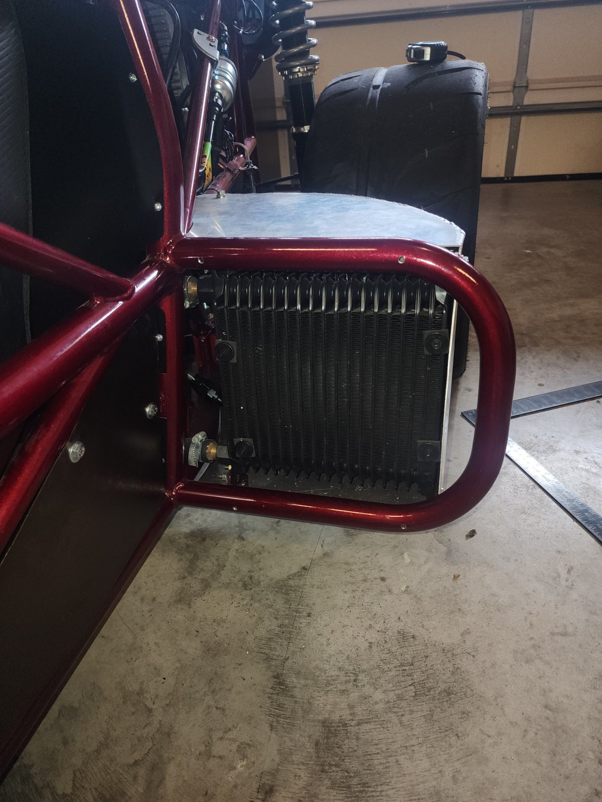

Heat Exchanger protection installed, probably use same for roof?!

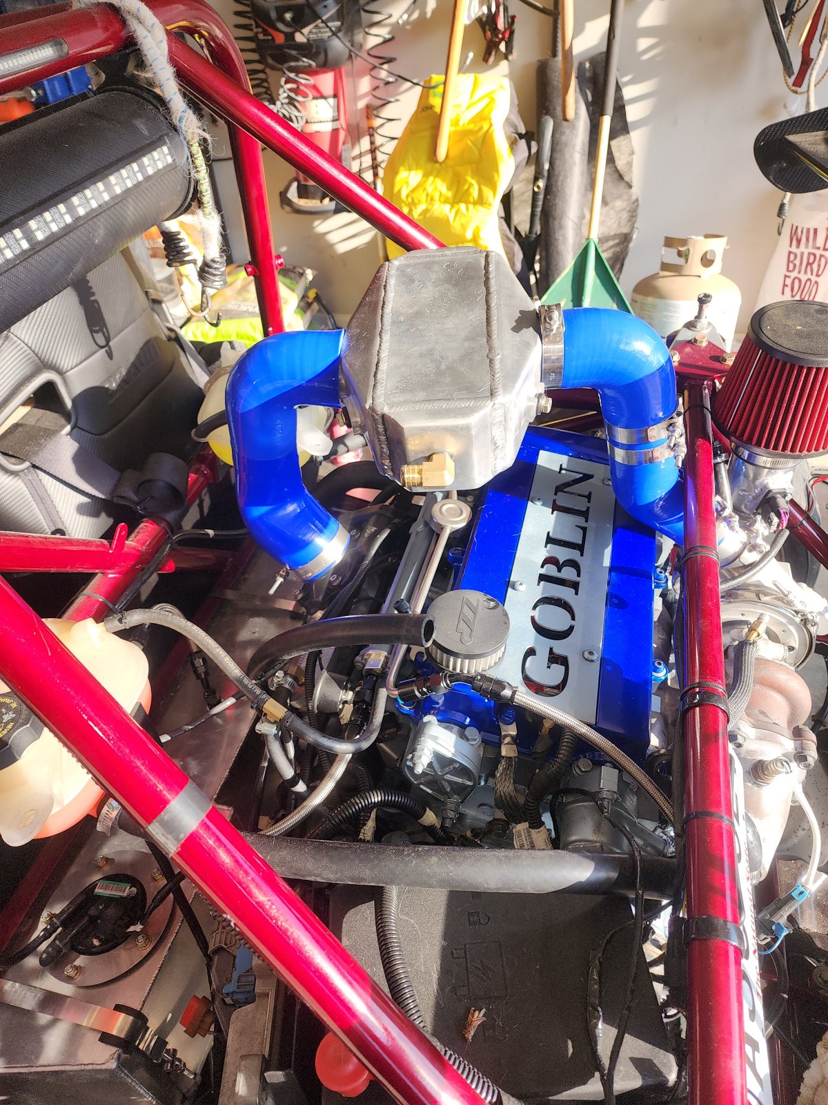

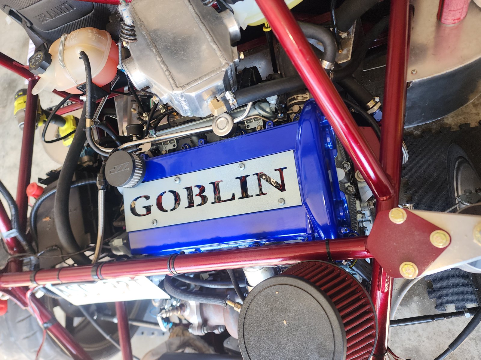

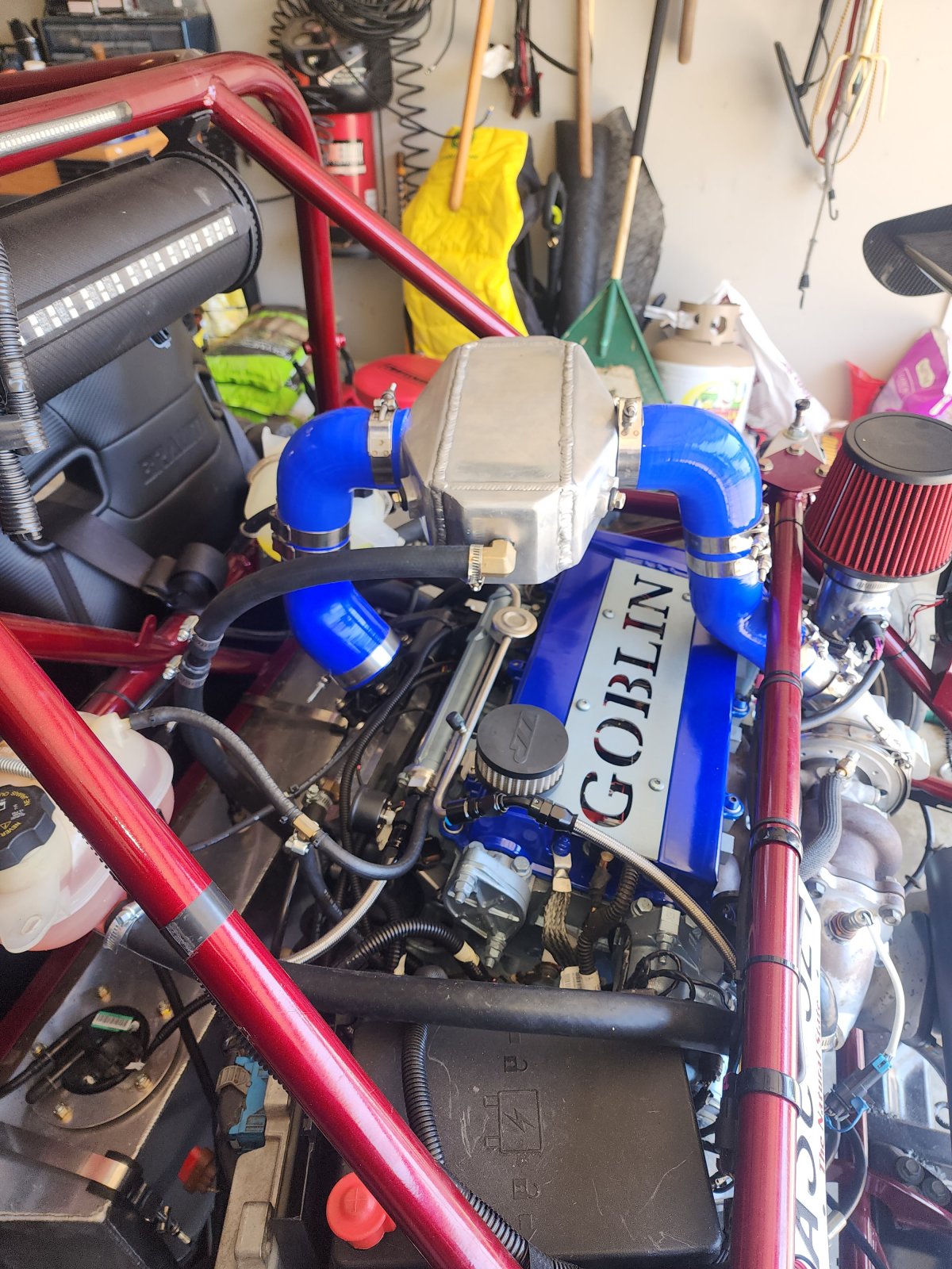

Install valve cover and new turbo plumbing today. Missing a couple T Bolt clamps and 1" heater hose to finish it off. Hood paint is scheduled for Aug 7th!
C
Got the new turbo silicones installed and she starts/idles like a champ. Went to end of the block and back, and struggled to get back to the garage.
