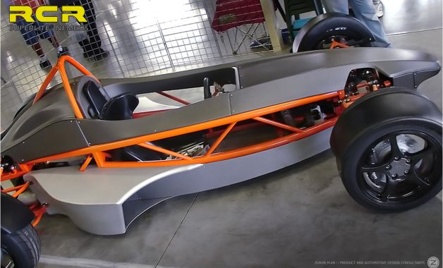

I wonder if we could build some kind of scoops/side panel combo like these to mount twin HEs in? Anyone considered this approach?
Nuker-
Waterdriver
Nuker-

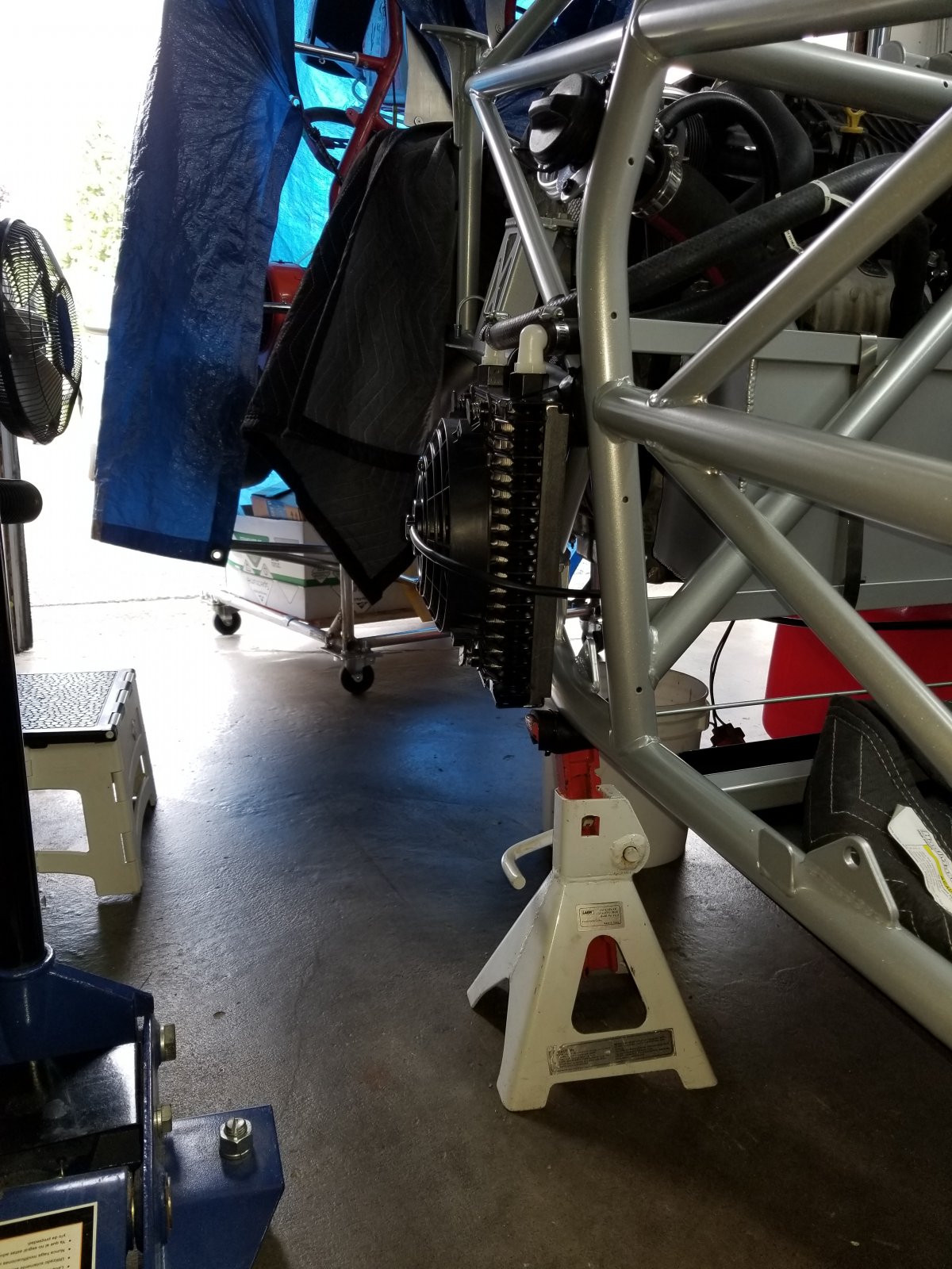

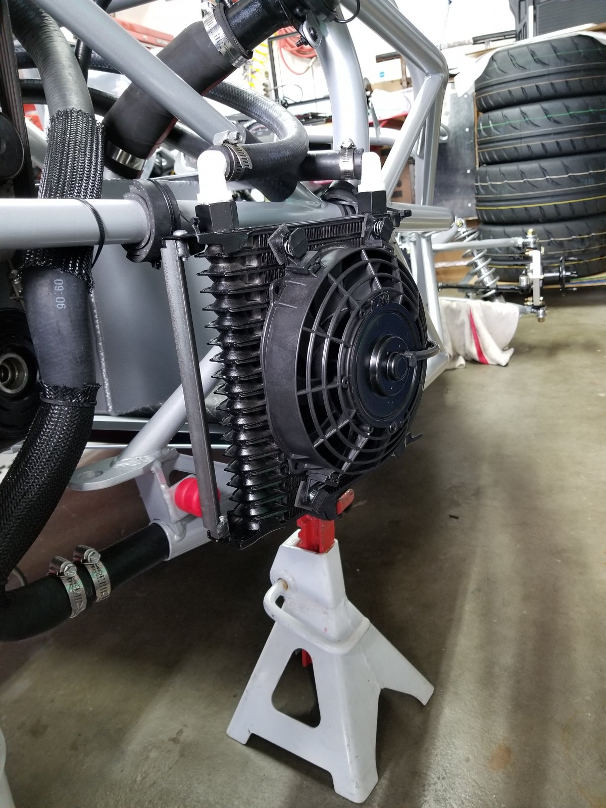

Yes. Working on it now. Lines are ran to the passenger side area of the car, in the scoop area like in your picture.
Working to do a temporary install of the provided HE and fan, for now. Permanent HE will be likely a dual pass shifter kart radiator with single or dual fans.

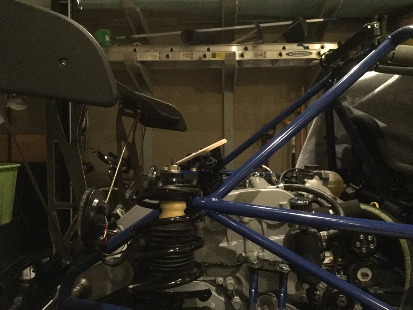

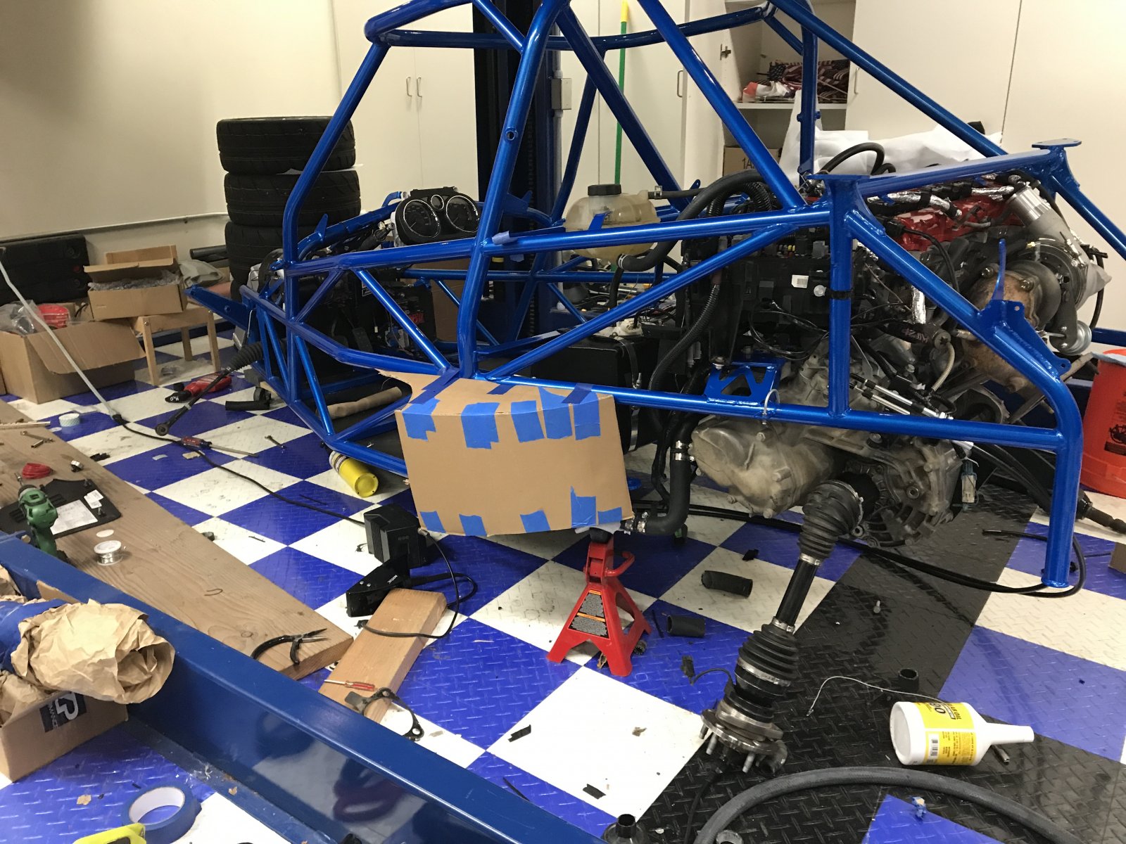

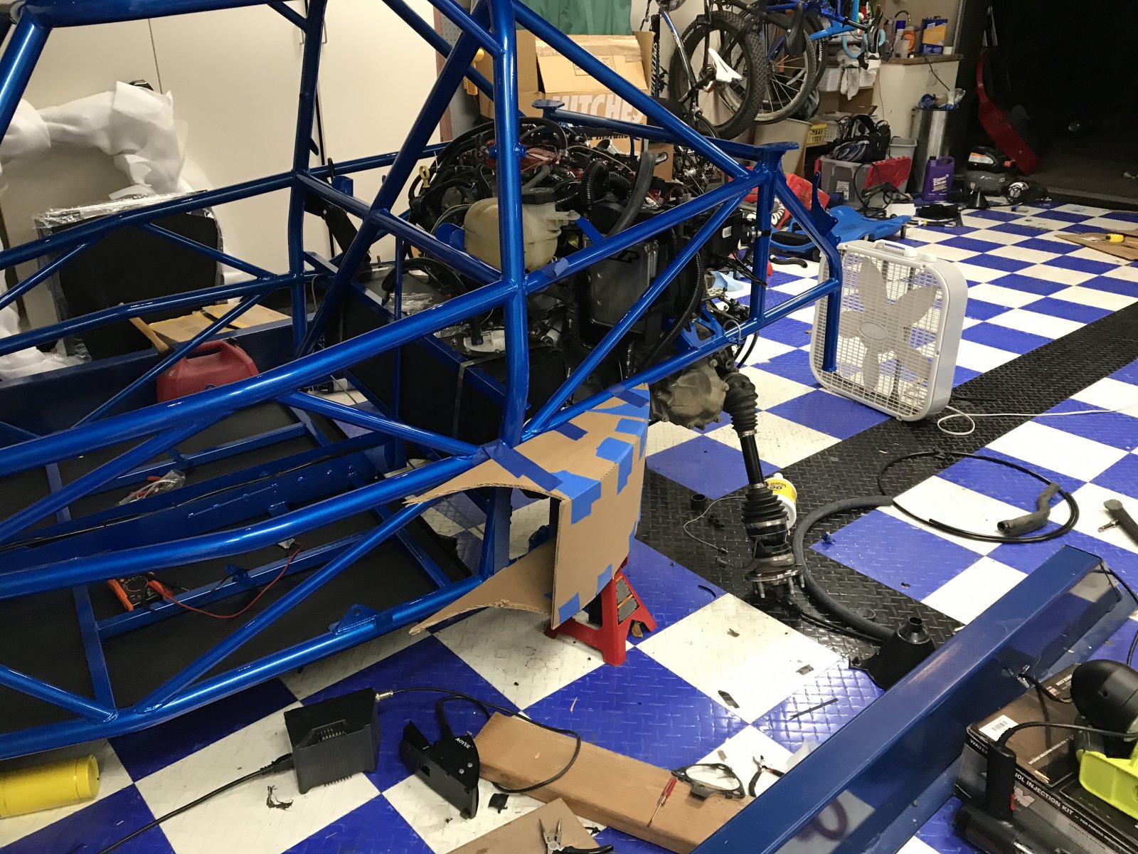

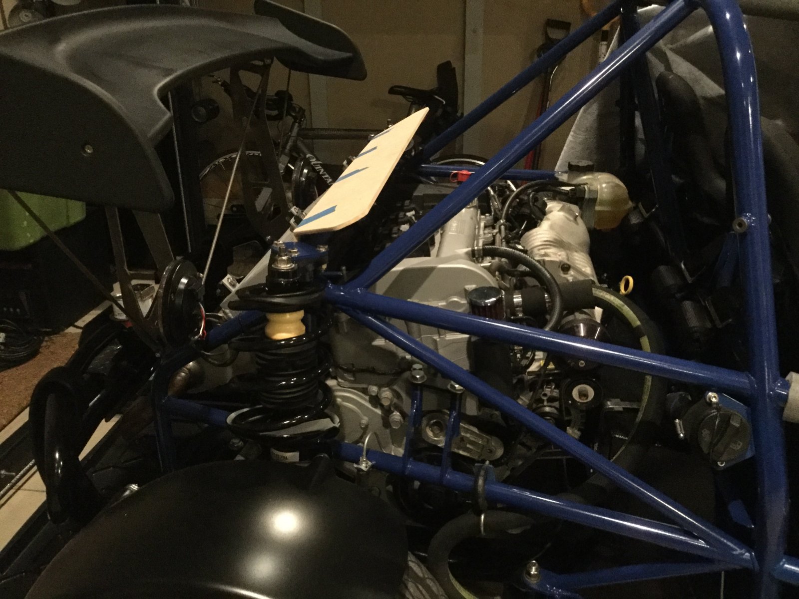

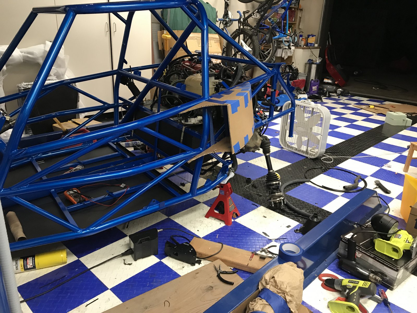

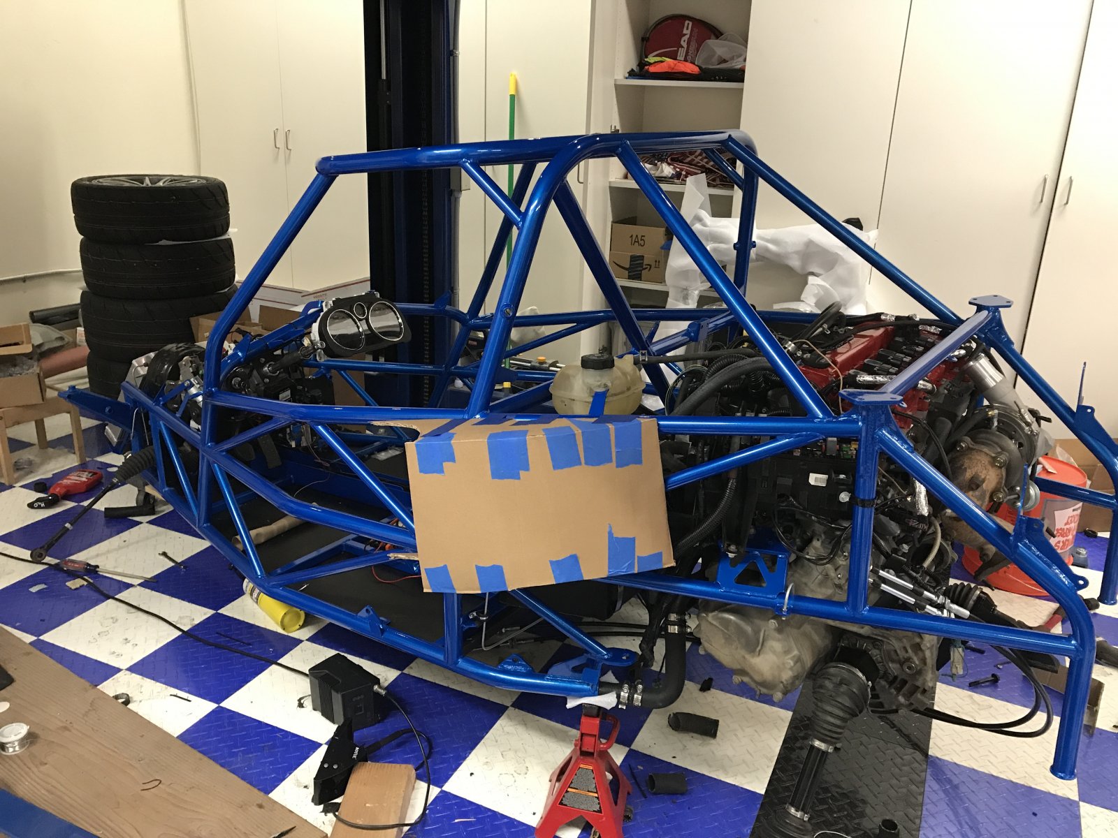

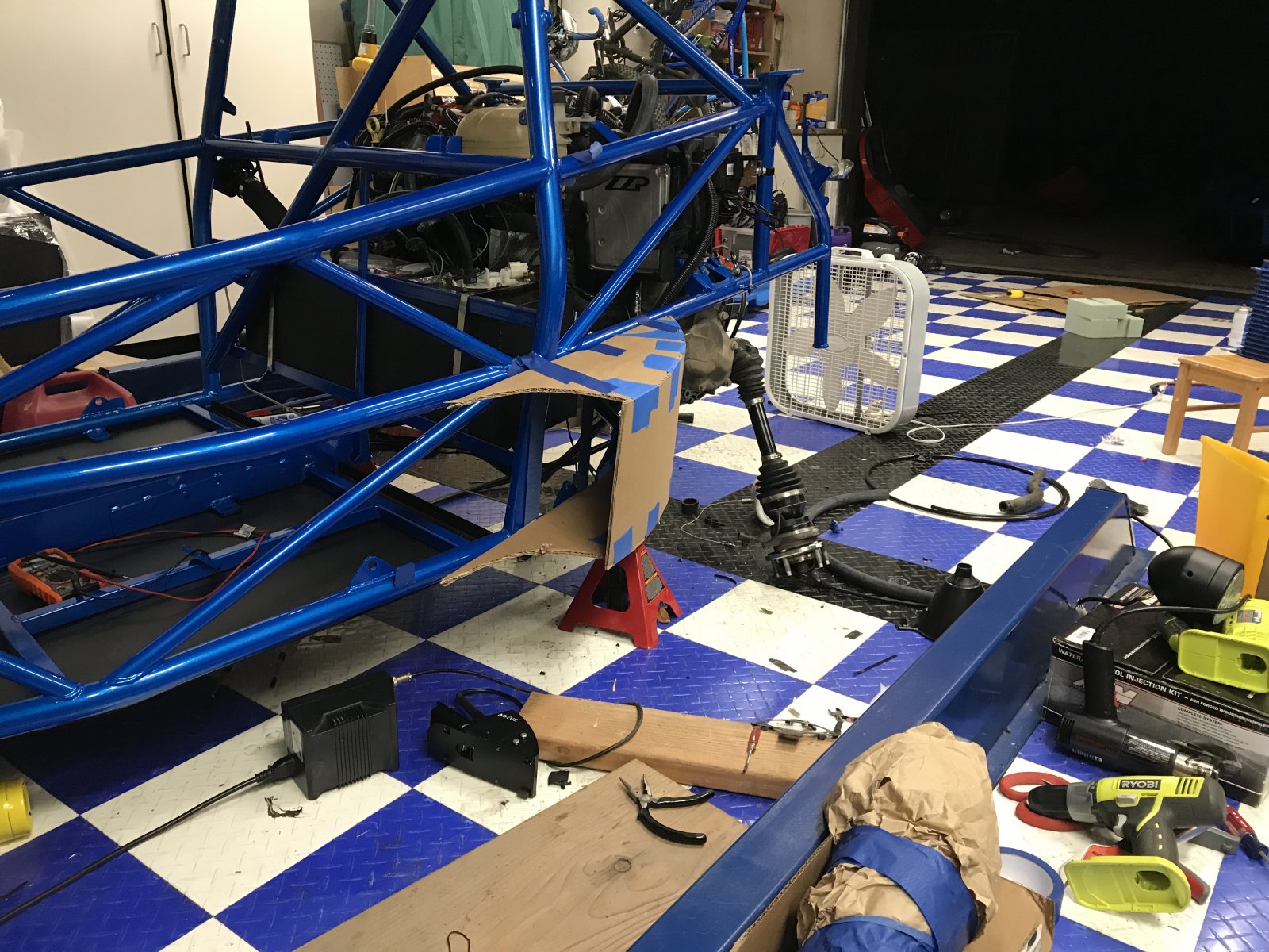

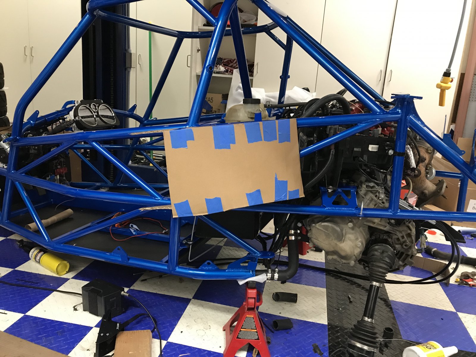

Can't decide which style of scoop is best.
I like the look of the bottom mount scoop better but it would be a massive pain to mount inside of the frame. The amount of rocks flying into the scoop and getting directed into the intercooler could also be a problem. The top mount looks decent IMO, but the install would be very clean and much less debris would go into it. Thoughts?

Waterdriver
To me, the lower scoop looks better.
To combat rocks, you can use wire mesh/ cloth in front of the HE.
With the shifter karts, our radiators sat almost directly behind the front tires.
Some racers would mount the wire mesh in front of their radiators to help protect them.
I never did and didn't seem to have an issue with rocks. It was mainly bee's.
Laying the radiator back at an angle helped deflect the debris as not to take the full impact energy from said object.

Looks good. I’m planning very similar to the upper style. I plan on mounting HE higher where there is more room. Right scoop I may integrate into an air intake using a factory style rectangular paper filter (I’m not a fan of K&N/cotton gauze filters.)

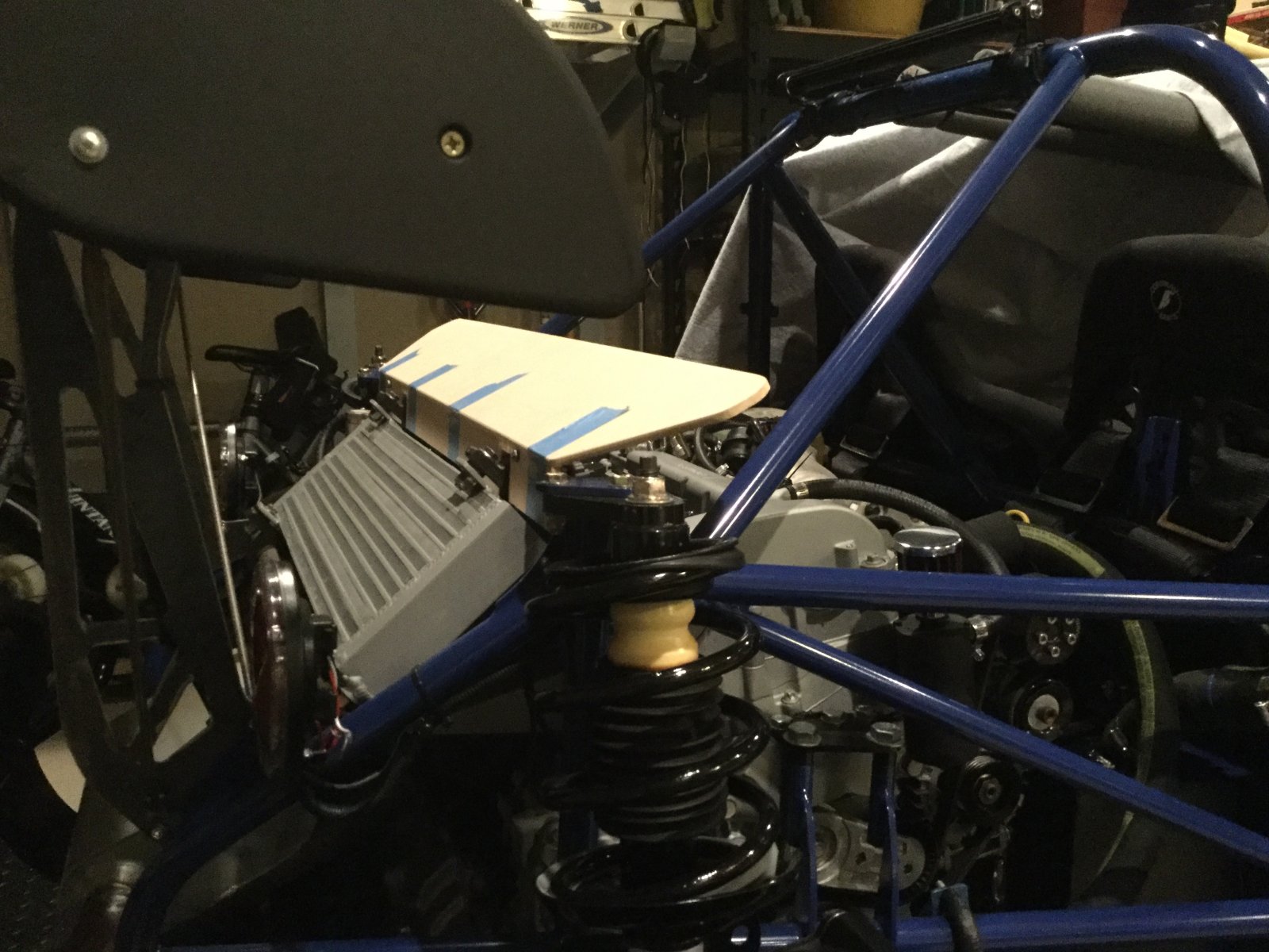

BAR-AIR
Just playing with a small diverter just to channel some additional air through the intercooler. As of right now air flow has not been an issue. But seeing that I can’t use the stock engine cover anyway just playing with different ways to cover the engine and direct as much air as possible to the intercooler.

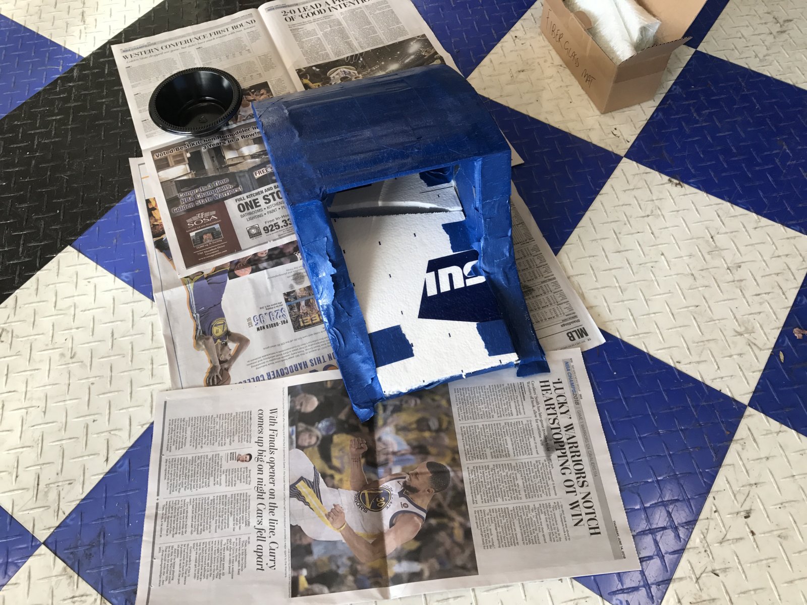

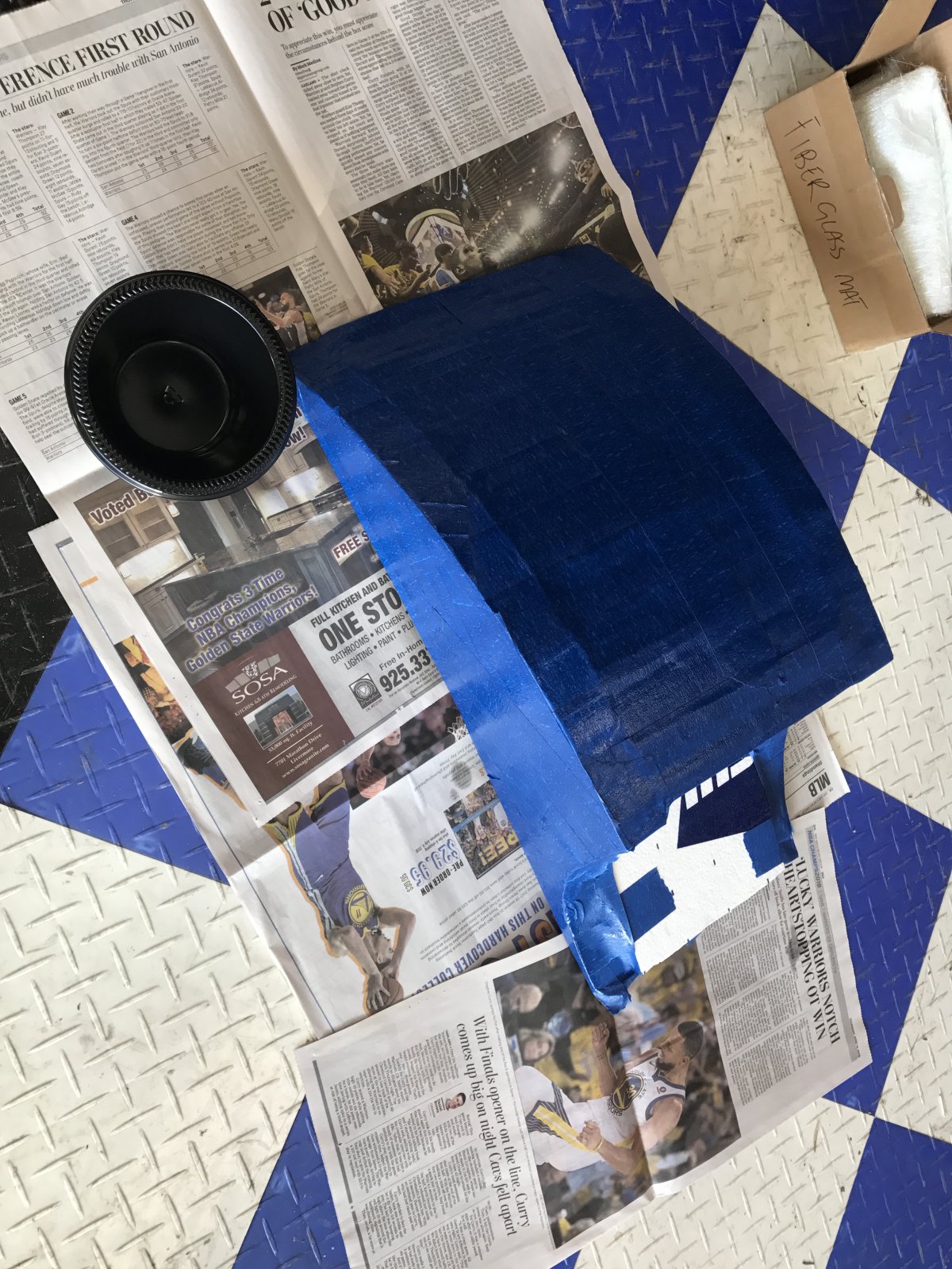

I decided to go with higher up mounted intercooler for conveniences sake. I have spent the last few days screwing around with foam to make a good mold to cover. I started with green foam from michaels and boy, is it a pain. Anytime you think about sanding it or cutting or even touching it a ton of green dust flies off of the foam. I covered about a third of my driveway from the dust when I worked with it. I scrapped the green foam and moved on to styrofoam insulation. It was a lot easier to work with and didn't give headaches. I finished the model and wrapped it with blue painters tape then covered in veg oil for a mold release. In the middle of doing the first FB layer now.
