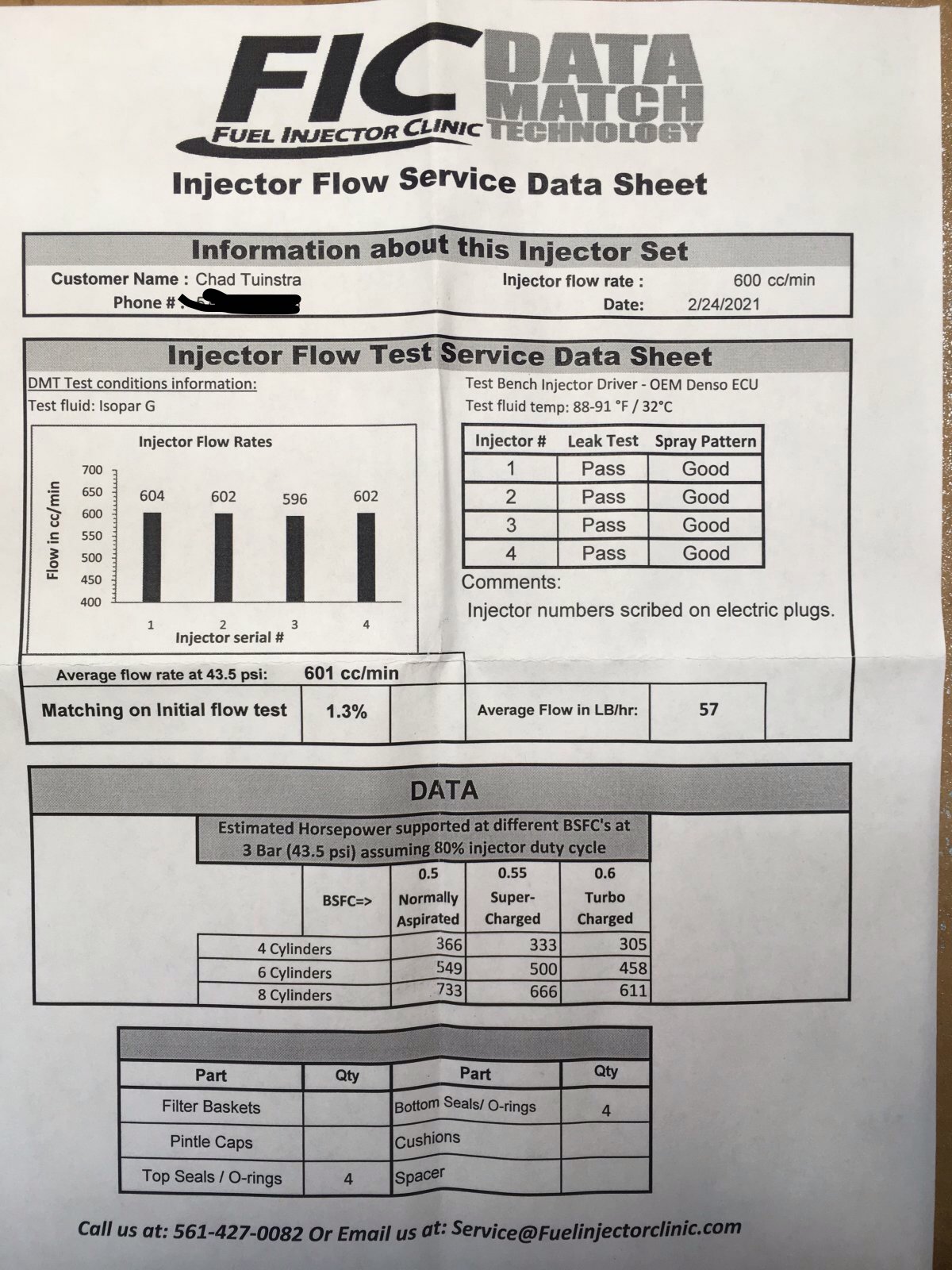

V1 Injector Data
After my fuel pump self-destructed and seems to pump small debris through the system and clog my return filter, I was worried about the new injectors potentially being clogged. So I sent them off for a flow test and cleaning if necessary. They were fine. They were able to provide a flow rate of the injectors and their matching abilities. I just thought this was interesting and thought I would share.
These are 60lbs (rates at 3bar) split injectors. The actual flow at the set pressure of the SS/SC of 4bar (58psi) is much higher, around 78lbs.
Yeah, I saw that just after I posted. If it were in plain text I would remove it immediately but since it's in a photo I was being lazy. I'd like to hope I can trust you all, but just in case, it removed. Thanks.
Don't forget when figure actual flow rate at psi, you have to subtract the boost pressure. So at 10psi boost, the injector is flowing at fuel pressure minus 10psi.

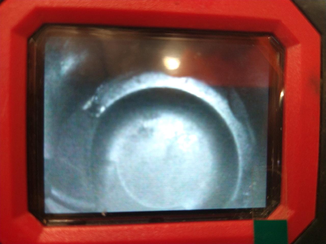

Scoped and #3 has something going on. It looks like it has filings laying on the piston Valve train looks fine on top. Pcv valve is fine, pretty oily in intake runners.

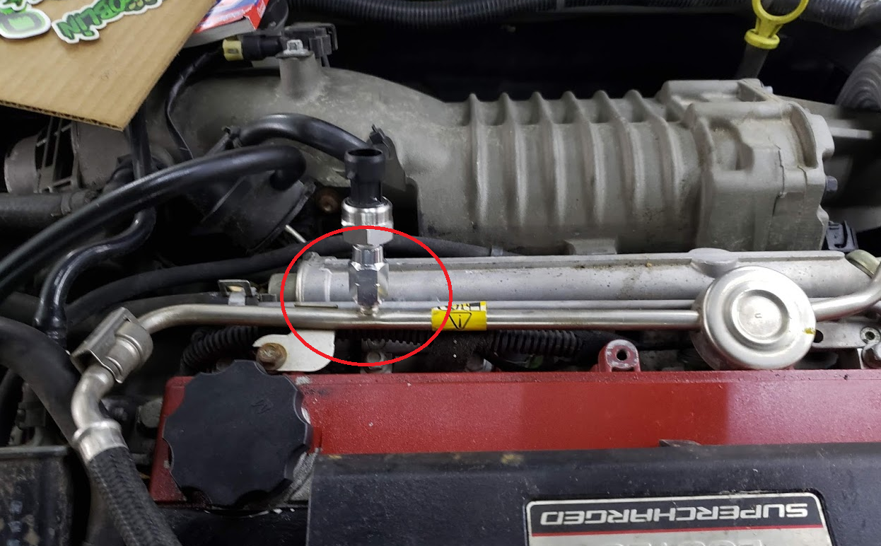

Yikes! Those codes are for fuel pressure too low. Low fuel pressure will cause lean all across the board, all cylinders. First thing to do is get a fuel pressure gauge and plumb in line before the injectors. You should have 4 bar (or 58lbs of pressure), if not N/A. I have one and it has diagnosed problems twice now for me. Maybe I'm just unlucky with fuel pressure. I would not drive the car until you get this under control. You don't want to burn your pistons.

The LSJ has a port on the fuel rail to measure pressure. You can rent a fuel pressure gauge from an auto supply store, for free.

Lots of blow by at idle, and oily intake.... Idle isn't boost blowby. Compression is reasonable, but the blowby has to be coming from combustion.
Rings, valve guide seals, or a faulty head gasket. I would do a leak down test... find out where the blowby is coming from.
